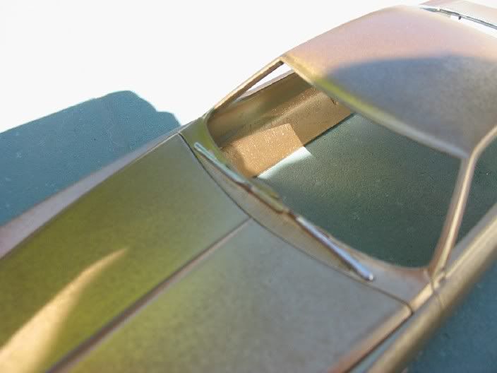

Chillyb1 Posted February 20, 2014 Posted February 20, 2014 It has its uses, I think, but it is not a replacement for BMF. I've been using a different brand (Intertape Polymer Group) but it doesn't appear to be vastly different from the 3M product you've pictured. The tape has a duller finish than BMF and it won't polish to much of a shine; so, if you want that sort of finish, then this tape is great for that. The tape is significantly thicker than BMF, which can have its applications (like the rear window and windshield wipers on the Riviera pictured below or the rocker panels on lots of cars) but it will look out of scale in a lot of places on a model car. The thickness will also inhibit your trimming of the tape; it is actually kind of hard work to trim this stuff and it will eat into your hobby knife blade budget. This tape also will dent (if that's the term I'm looking for) and will hold that dent; that is, if you accidentally run a burnishing tool across it or otherwise cause an indentation, you won't be able to burnish it out or ameliorate the damage. You have to remove the tape and then reapply it. I haven't found the adhesive to be too strong or to cause damage to paint, but you'd have to be very conscious of that possibility. And speaking of adhesive...it does add to the overall thickness of the tape, which can make the tape appear out of scale depending on the location. A couple of pictures:
TooOld Posted February 20, 2014 Posted February 20, 2014 It doesn't look too bad on that rear window but it's definitely too thick for the windshield frame . And it doesn't have much of a shine to it and I doubt it would conform to irregular shapes like the BMF in the photo below !
Baugher Garage Posted February 20, 2014 Author Posted February 20, 2014 Good info guys! Here's how it turned out on the trim of my current project. It's a rust bucket, so keep in mind that I wasn't going for perfection (far from it in the area of body damage shown). I will eventually pick up BMF to try out on more detailed parts.
