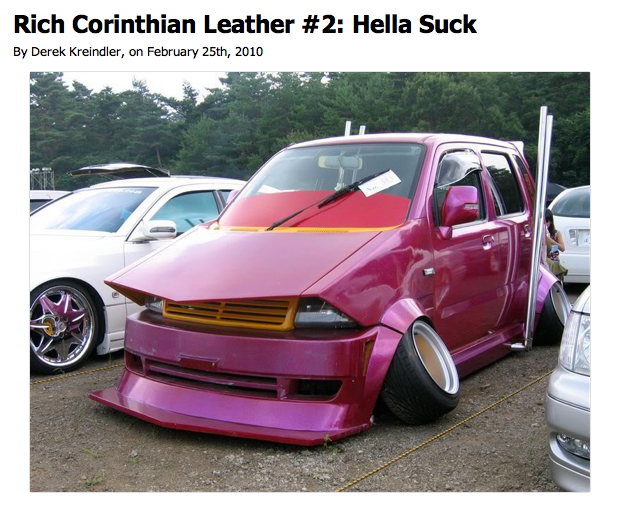

Custom Hearse Posted February 27, 2014 Posted February 27, 2014 Why does this remind me of the cartoons I used to watch as a kid back in the '70s? You know... The cartoon car that was so tired it collapsed? All the guy needs to add is a large tongue hanging out of the grill...
