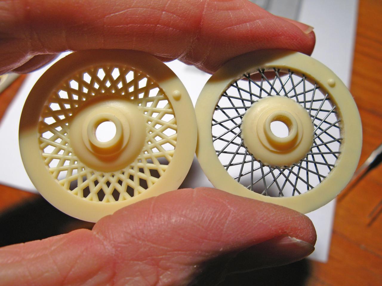

LWBNomad Posted April 5, 2014 Posted April 5, 2014 Here is my first wheel half, completely spoked. And I am stoked! The elation at fitting the last couple of spokes would not be believed until one experiences it.
TomN Posted April 8, 2014 Posted April 8, 2014 Stan Congradulations on your first completed wheel, it looks great! I've actually heard that a pet pedicure tool makes a good drill motor, they are cheap, will have to check one out someday. I just bought the Packard Roadster, wish I could join you guys, but it will have to wait awhile. Tom

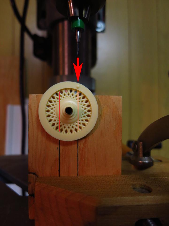

LWBNomad Posted April 9, 2014 Posted April 9, 2014 (edited) I've been fretting about how to drill the rest of these wheels so that they don't take two weeks each. I picked up a Dremel drill press but my old Dremel 270 - which rotates nice and slow plugged into the foot pedal rheostat - won't fit. I then bought a new Dremel 100 to fit the drill press. But it doesn't work plugged into the foot pedal rheostat. Looks to me like the old Dremels are better than the new ones. So I looked again at my floor-standing Delta 14" drill press. The pulleys can be rigged for 460 RPM. The .016" carbide bits I ordered arrived yesterday, they have ⅛" shanks and the big drill press chuck will take them, no problem. Then all one has to worry about is lateral runout, as the carbide won't take any lateral loading. I set up a jig and tried it. Very hard to modulate the feed and I broke two bits on the first wheel half, but the problem was that I couldn't see the action and fed too quickly, breaking the bits. No problem with lateral runout. Then I ditched my safety glasses and put on my magnifying visor so I could get in really close and see the action, and be much more delicate managing the feed. The second wheel went fine. This is working! The first two photos show the jig positioned to drill holes in the rim for "trailing" spokes; once the trailing spoke holes are done, the jig will be re-positioned to drill the "leading" spoke holes. The trailing and leading spoke holes need to be on separate planes; this was an error I made in my first hand-made wheel and I had to re-drill half of the holes I'd done. The last photo shows a wheel half with the trailing spoke holes completed. Edited April 14, 2014 by LWBNomad
TomN Posted April 9, 2014 Posted April 9, 2014 Bravo Stan!!!... very clever. So you're drilling the holes before removing the spokes, nice idea. Hope to see more soon! Tom
BSteinIPMS Posted April 9, 2014 Author Posted April 9, 2014 (edited) Boy, I love it when a good plan comes together! Great work, Stan! I think your drill jig is rather ingenious, besides being more efficacious than my method of drilling the spokes out one-by-one by hand. Took forever! Cheers! --Bob Edited April 9, 2014 by BSteinIPMS
LWBNomad Posted April 9, 2014 Posted April 9, 2014 (edited) Thanks for the compliments! I drilled more holes last night. With practice getting the feed rate right so as to avoid breaking the drill bit, it took just 14 minutes to do 26 holes on my last wheel rim. So I've done all the trailing spoke holes on all five remaining wheels; now I'll move the jig to do the leading spoke holes. I'll still use a pin-vice and a high-speed steel bit to drill the holes in the hubs, but I'll mark pilot holes with the tip of a scriber to make sure the bit can't wander and the holes are properly placed. Having the rim holes drilled makes it easier to cut out the plastic spokes a few at a time and get the positions for the wire spoke replacements correct. However, I don't see any way around hand-work for drilling the hub holes. It's still going to be several weeks before I have a set of wires as nice as Bob's. I have three of these Hubley Duesenberg kits; I want to build at least two of them. This will keep me off the streets for a while... Edited April 14, 2014 by LWBNomad

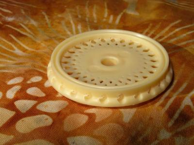

LWBNomad Posted April 14, 2014 Posted April 14, 2014 Here's an inner wheel half with both sets of holes for leading and trailing spokes. The plane of leading spoke holes are just slightly offset from the plane of trailing spoke holes so that they'll all go quietly to the hub without clashing. Because the carbide bits break if you feed them against a surface at an acute angle, the rim was pre-drilled with a small carbide router bit. I'm prepping more than one set of wheels this way (my personal form of madness).
