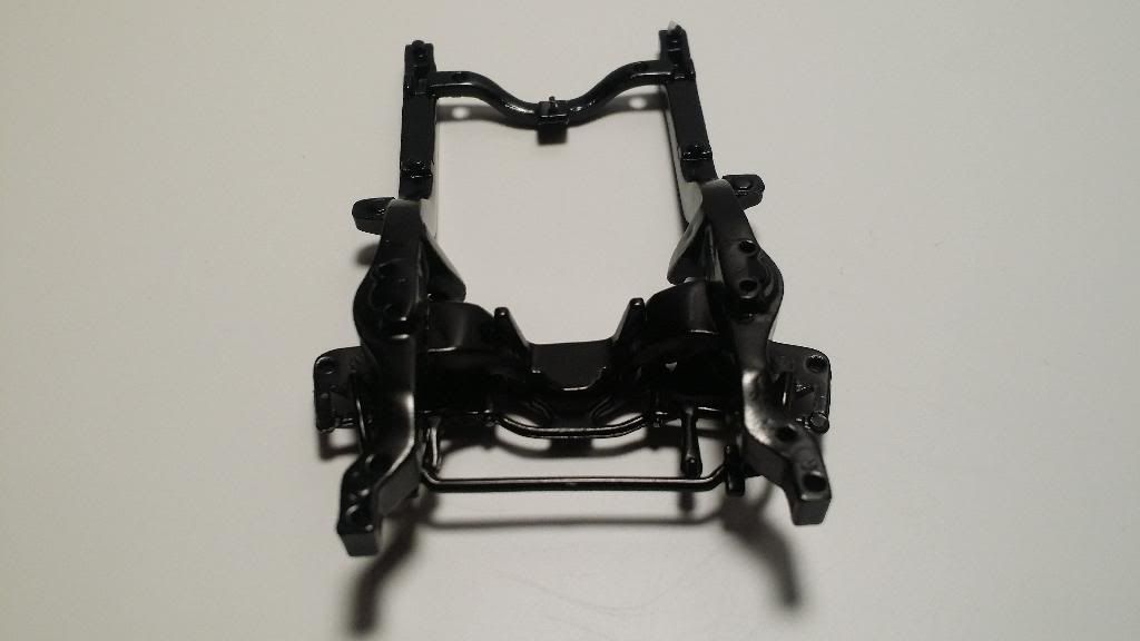

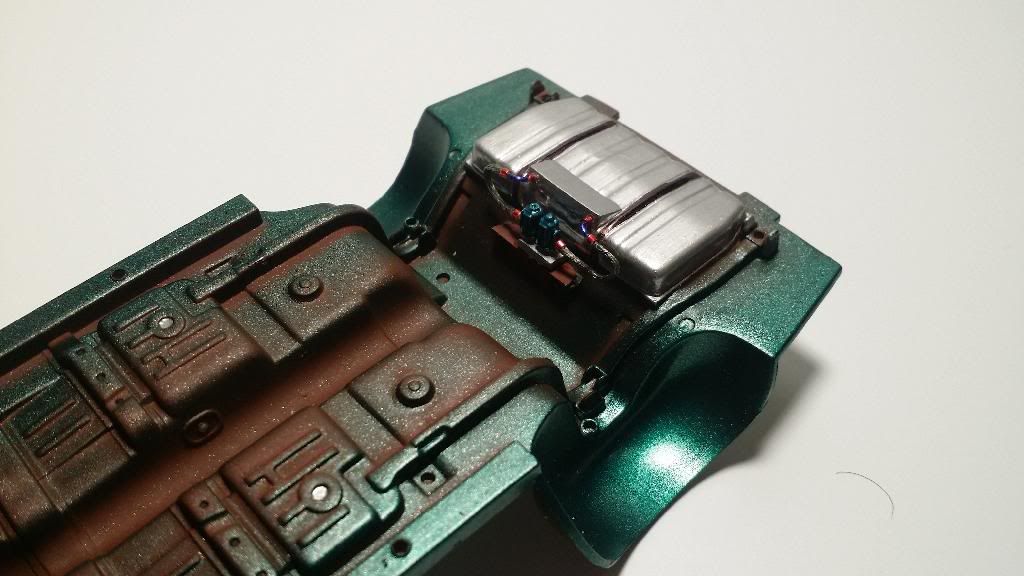

Hey Jason,

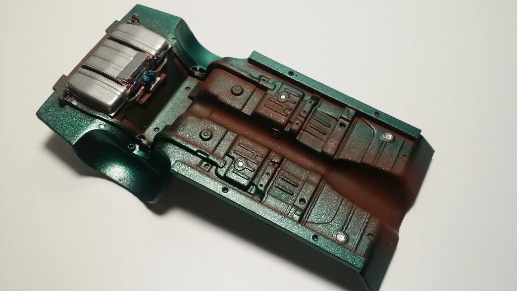

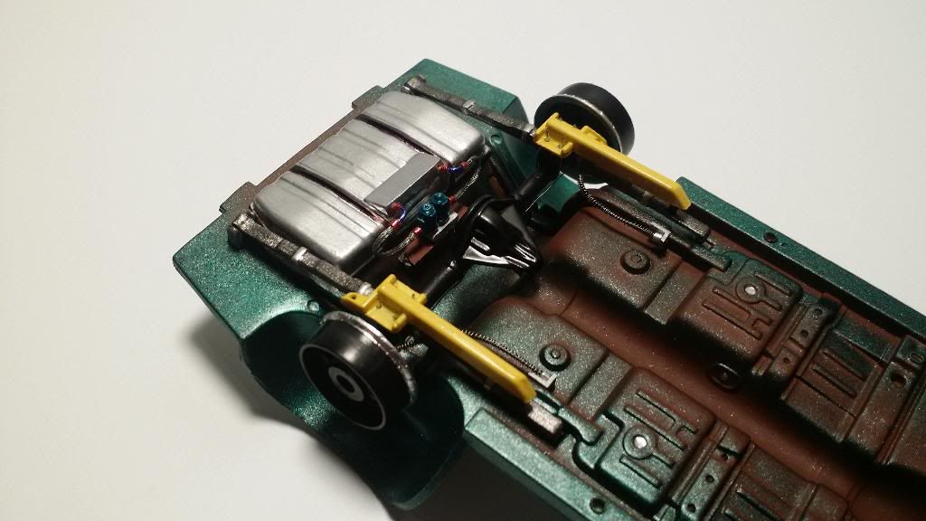

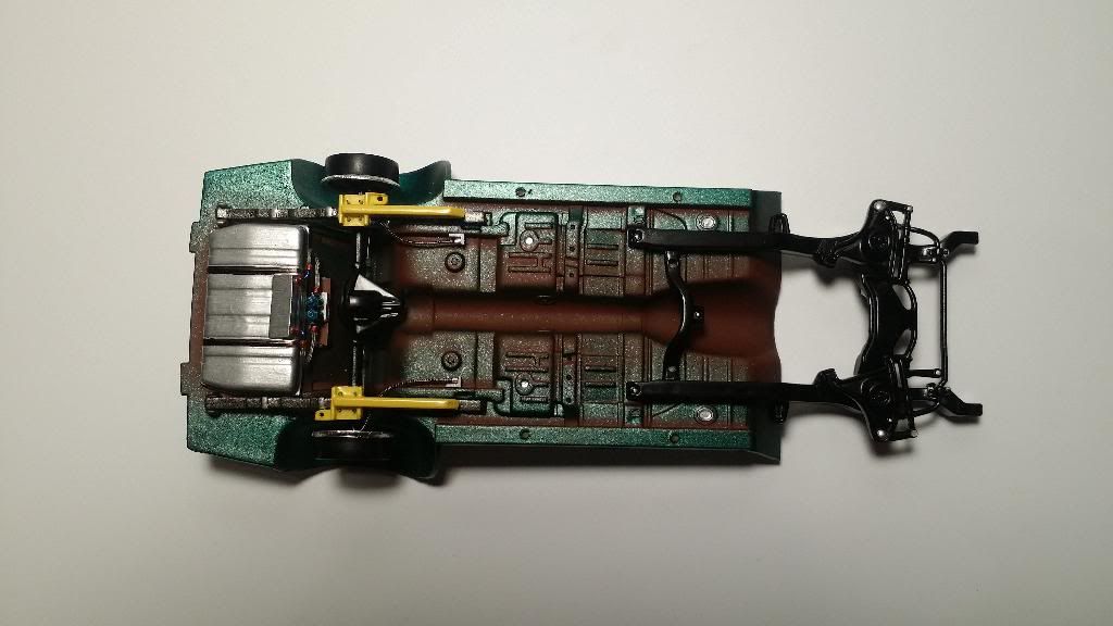

The detail work looks fantastic, first time I've seen e-brake cables that look correct. Is this being built as a street car or drag car? The reason I ask is the placement of the sump on the fuel tank. If this is a street car it may be OK, but if it's a drag car it needs to be turned around and moved further back on the tank.
This is a tank from a Camaro that has had a sump added.
Robert
Link to comment

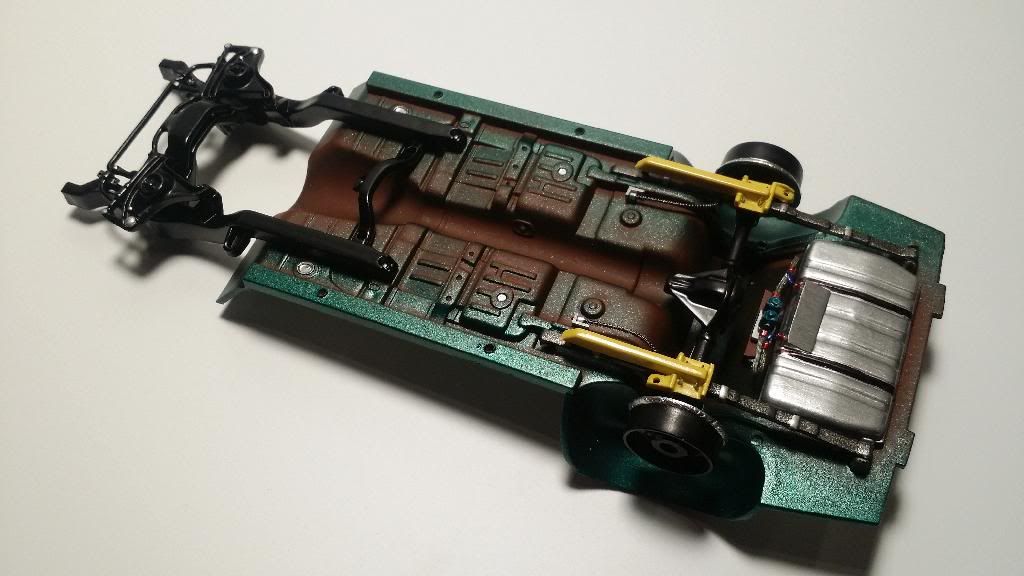

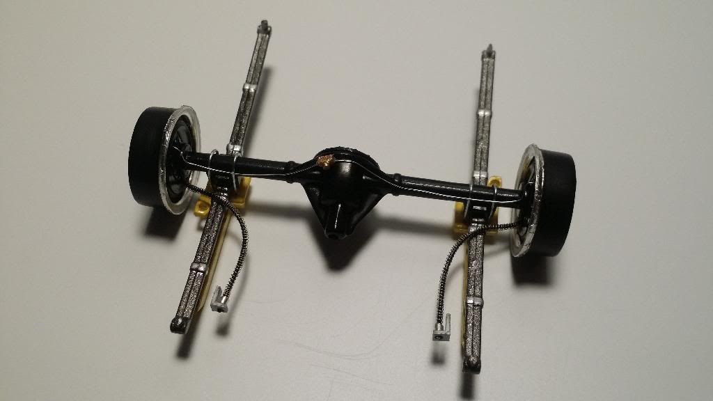

wow that detail on the rear end is awesome. I would also like to know what you used for the e-brake cables and also did you make or find the brake line splitter cause that also looks very nice. good job keep the good work and keep the updates comin
Link to comment
Working on relocating the sump. Shoula realized its on wrong. It will be just a street car but I cant leave it that way I think I may have been up too late that night haha
The e-brake cables are made from 26 gauge wire painted black and wrapped with smallar wire. Ends are crimp beads
Thank you for all your comments I appreciate all of them also for correcting my mistake haha
Jason
