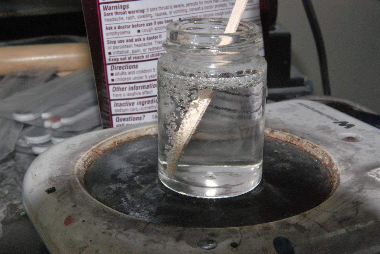

I have the same experience as William. I have not had problems with it. I used all the clears (Dupli-Color clear, Testor's Wet Look and Testor's Ultragloss Clearcoat) and none are as easy to work with as TS-13. I de-can it (look up decant - most use the word decant incorrectly when talking about removing paint from a spray can but only a chemist would know this distinction) and airbrush it cut 1:1 with Dupli-Color lacquer thinner. The Dupli-Color Clear does not yield as good a gloss as TS-13 and is not as hard when cured as TS-13.
The bubbling problem is due to the fact that 20-30% of the volume is propellant (propane or butane). I de-can the paint (note I said de-can) and then de-gas it and NEVER had a paint bubbling problem. The bubbling problem is caused by too much propellant in a film that is too thick.
Here is a picture of my de-gassing process showing the propellant coming out of TS-13.
