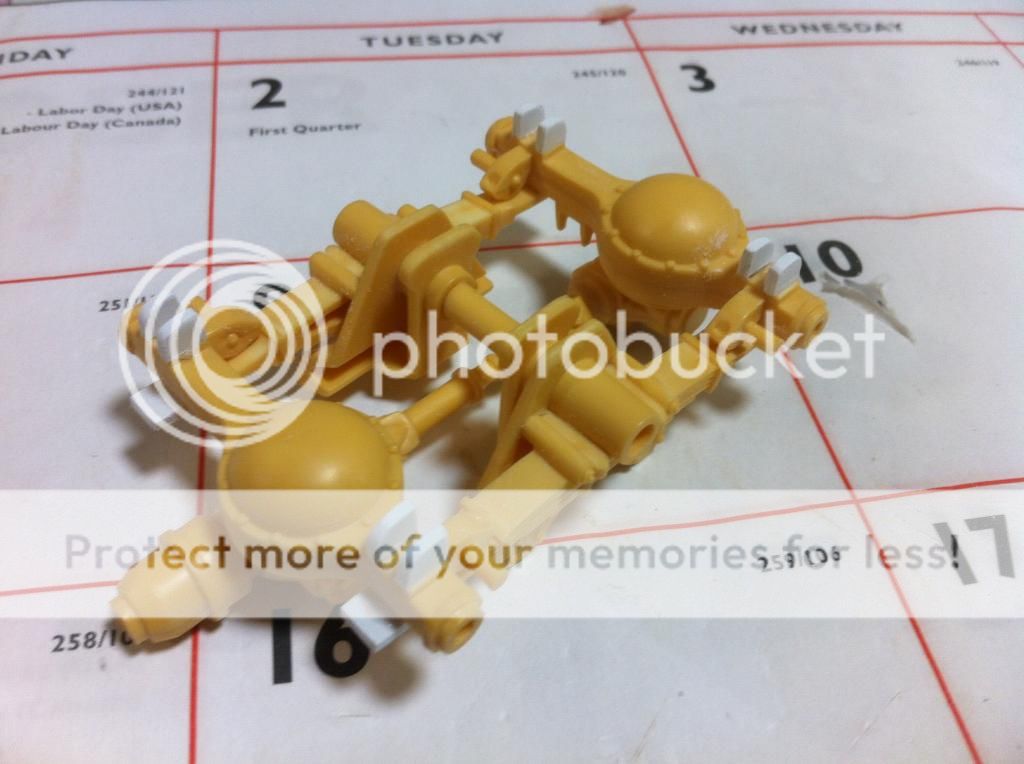

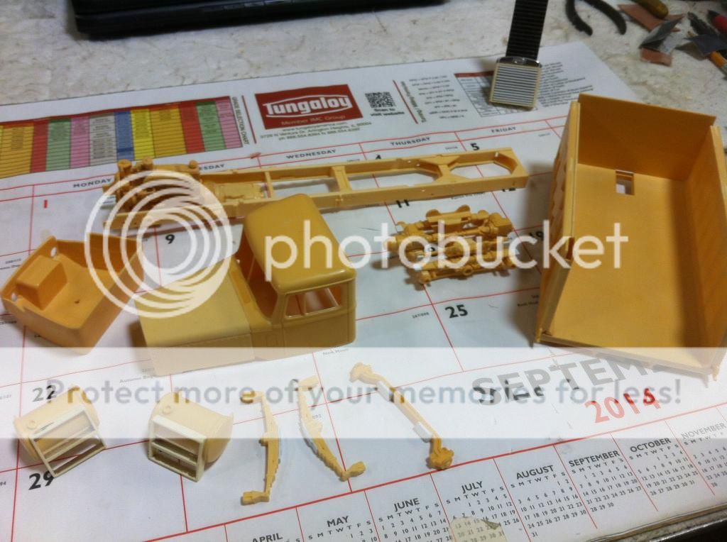

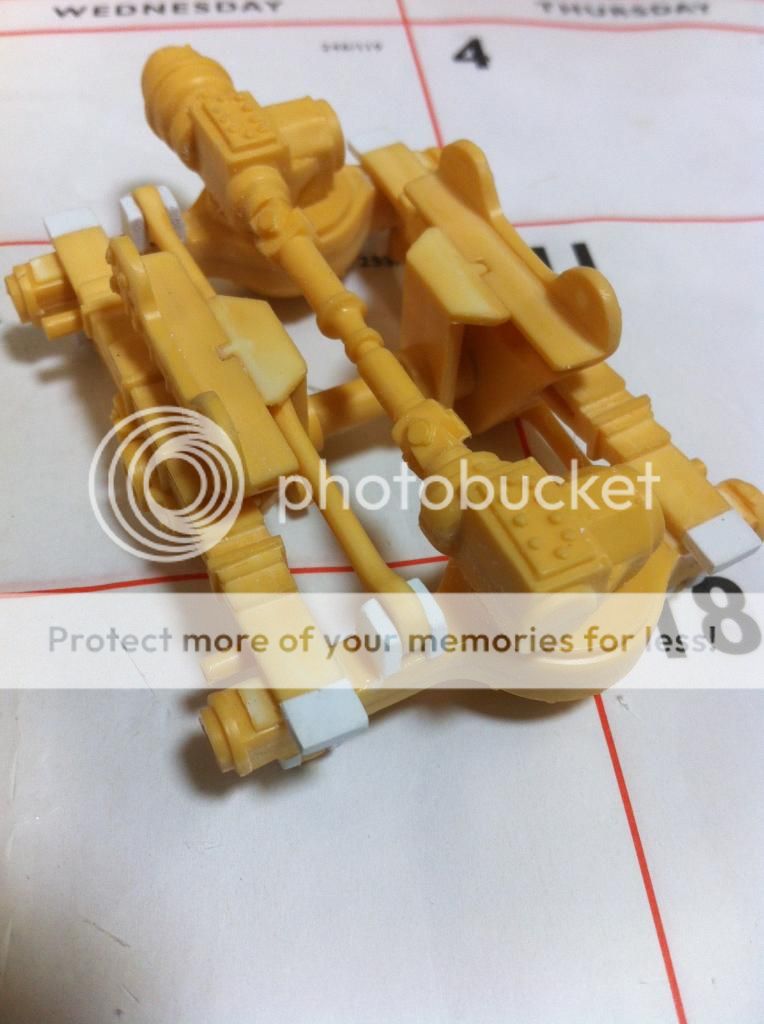

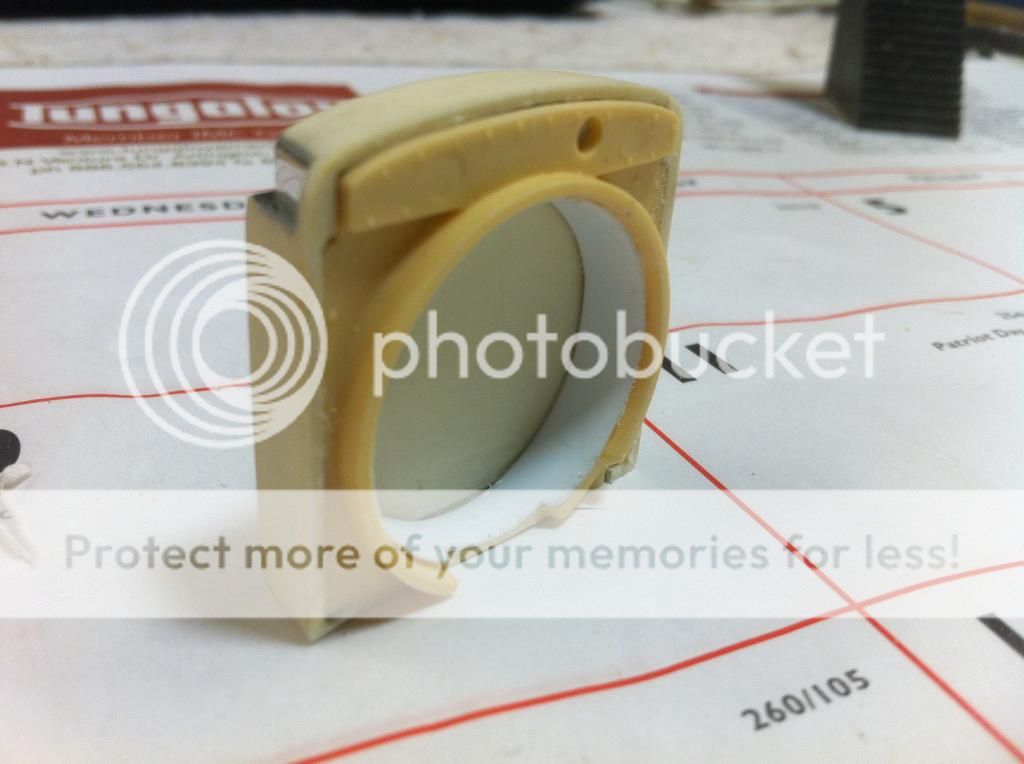

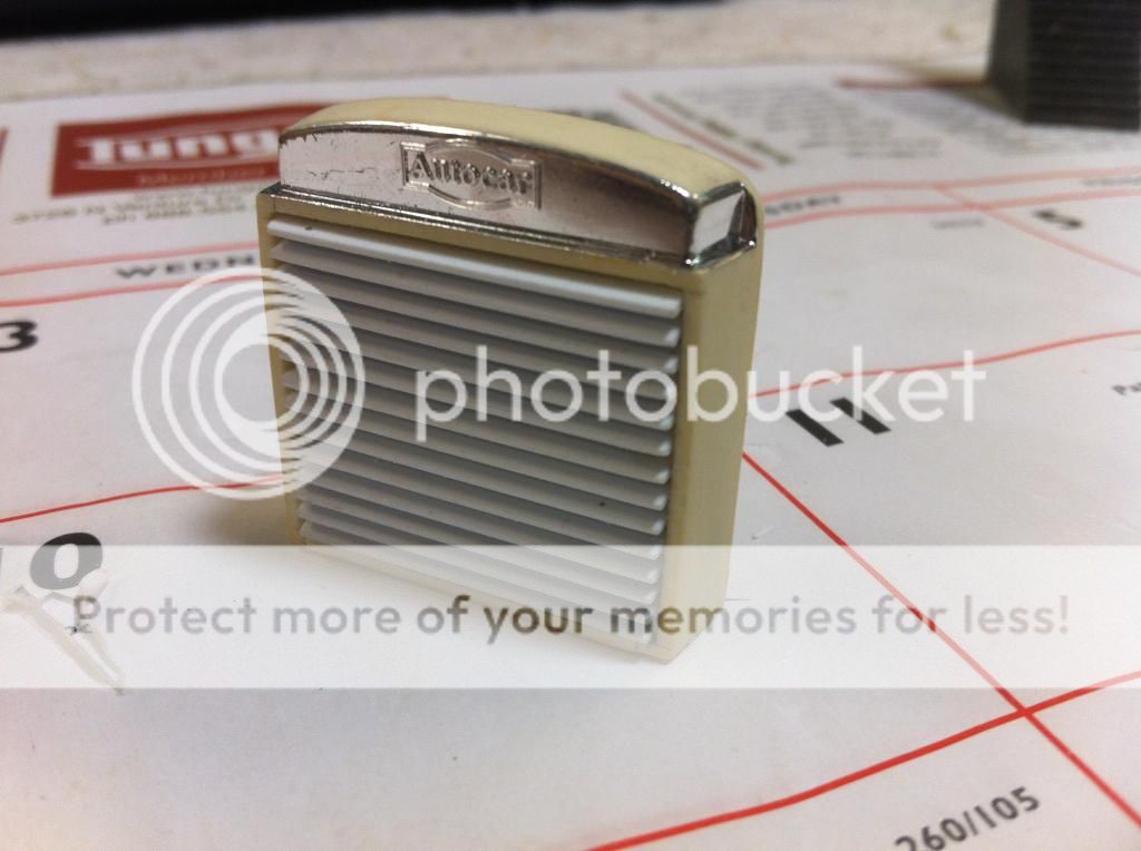

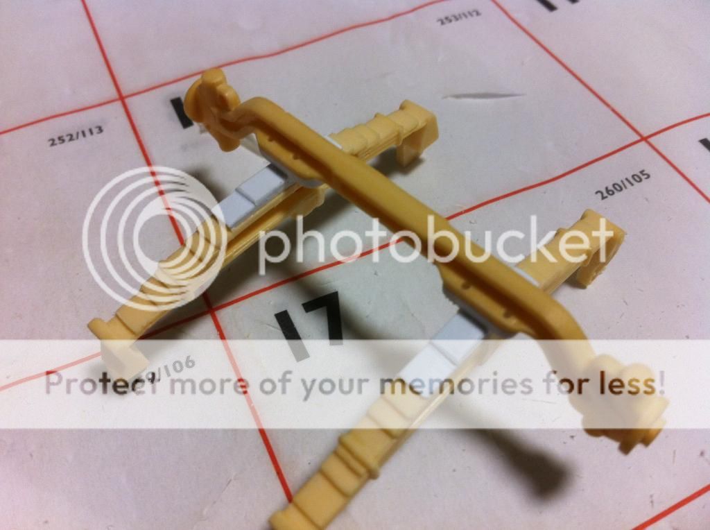

Superpeterbilt Posted September 24, 2014 Posted September 24, 2014 Heres one of my new projects. The plan is to keep it box stock with some better detail. Ive built a bunch of modified Autocars, and resin Autocars, so I wanted to build one off the box. For starters, I modified a grill to a shutter style and moulded and resin cast it.Next, I started on the rear suspension. I extended the leafs, remade some of the mounts, and added blocks and U bolts.

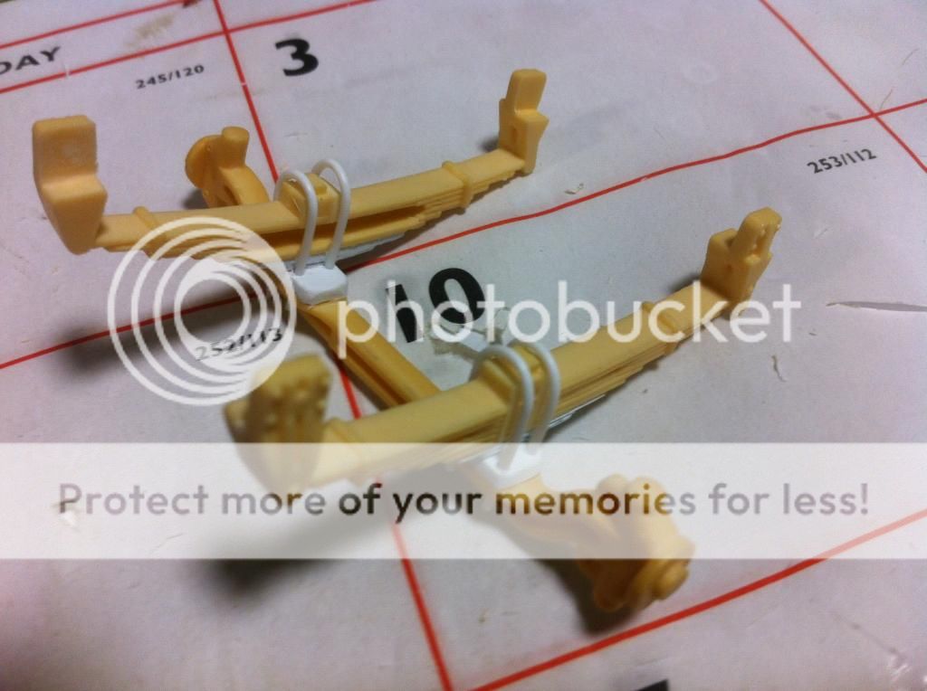

Superpeterbilt Posted September 24, 2014 Author Posted September 24, 2014 Next, I added two more leafs to the bottom of the front springs. I want the truck to sit level. Ive never liked the stance of the kit. Blocks were also added to the front axle to help level it out. The front axle was drilled, and U bolts added. I knotched out the rear cab mount to add a support for the rear of the interior tub. This helps with cab alignment.
Superpeterbilt Posted September 24, 2014 Author Posted September 24, 2014 The grill that I built is a little narrower at the base than the kit. The kit grill is tapered down, mine is straight. This brings the fenders in a little, which affects the bumper. I removed 1/8" from the center of the bumper and mocked it all up. Its coming together great so far. The only other mods will be a set of my resin tires on the kit spokes, move the rear axles back slightley, and raise up the cab guard on the body.

Superpeterbilt Posted September 25, 2014 Author Posted September 25, 2014 Heres a few more shots of the suspension. Heres where the rear suspension is positioned in the kit. Heres where Im moving it to.It looks better centered with the crossmember, and the "T" of rivets on the frame. Also the dump body wont hang over as much.

Petetrucker07 Posted September 25, 2014 Posted September 25, 2014 Im thinkin the box position was a slip, still wrong. Where you put it is the proper place. All the extended leaf hedrickson ive ever seen are centered on a cross member. Unless the frame was shortened and the converted to a dump truck.
