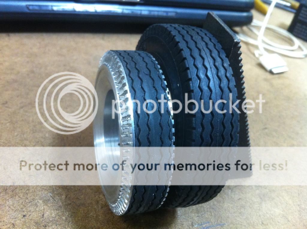

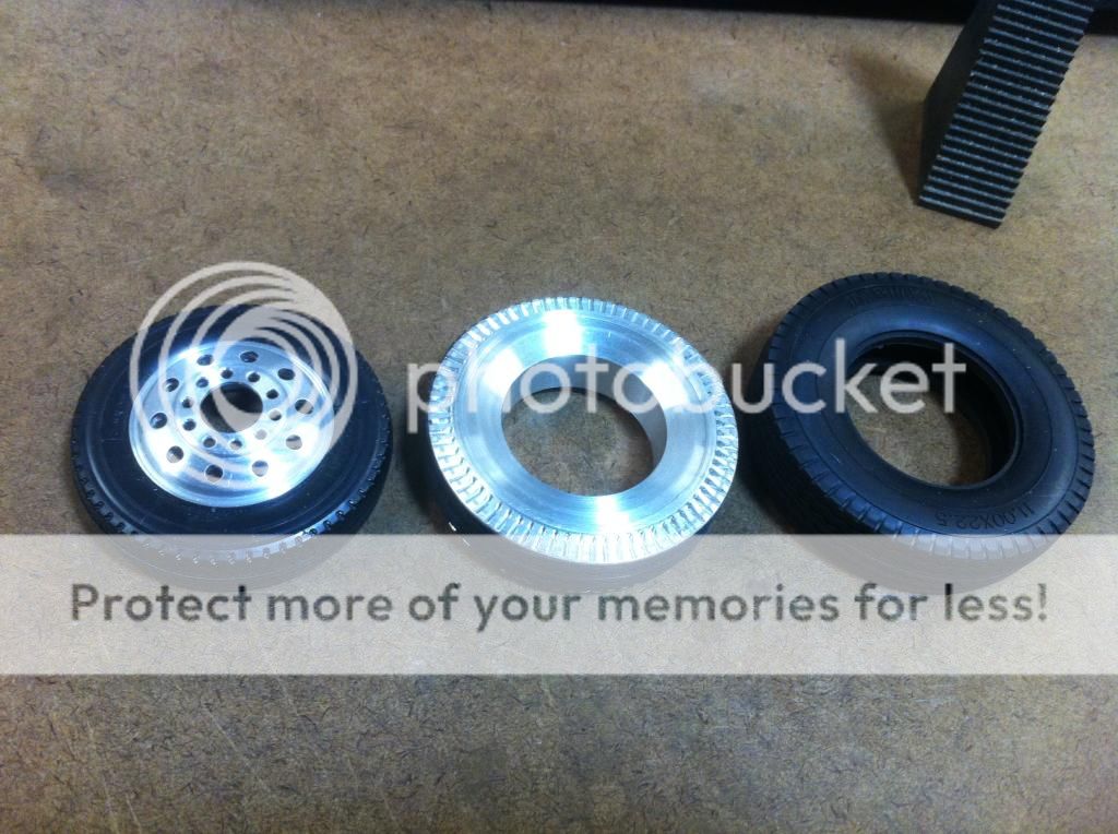

RAT-T Posted February 19, 2015 Posted February 19, 2015 VERY COOL MACHINE WORK TERRY. CAN I ASK HOW YOU DID THE TREAD AREA? THANKS, TOM
Superpeterbilt Posted February 20, 2015 Author Posted February 20, 2015 VERY COOL MACHINE WORK TERRY. CAN I ASK HOW YOU DID THE TREAD AREA? THANKS, TOM Well, after stressing about how I was going to cut the tread I started looking for 1/8 car tires and things like that. I came across some 1/14 RC truck that were perfect. I grooved out the alum tire, cut the sidewalks off the 1/14 tire, and wrapped it in. It worked perfectly.
Petetrucker07 Posted February 20, 2015 Posted February 20, 2015 (edited) Very cleaver Terry. That's usin the Ole noggin. Edited February 20, 2015 by Petetrucker07

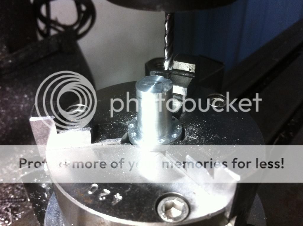

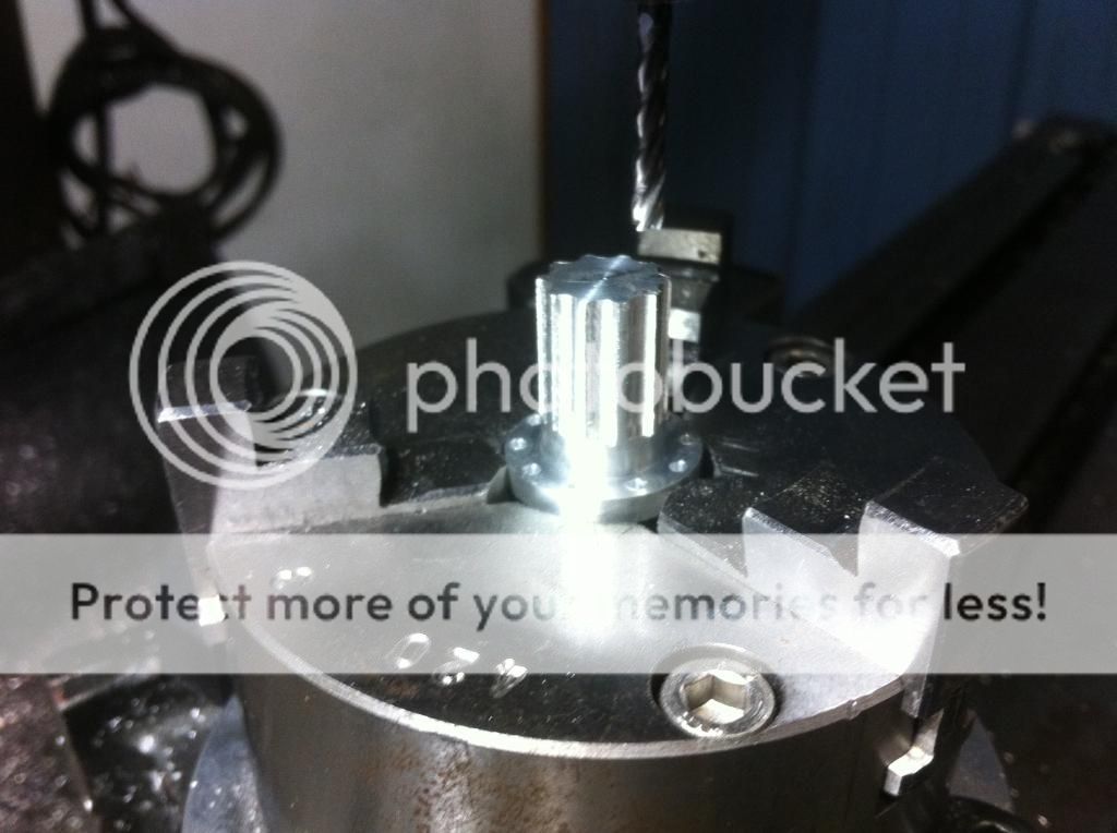

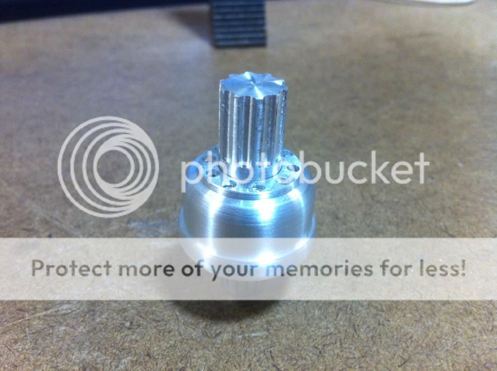

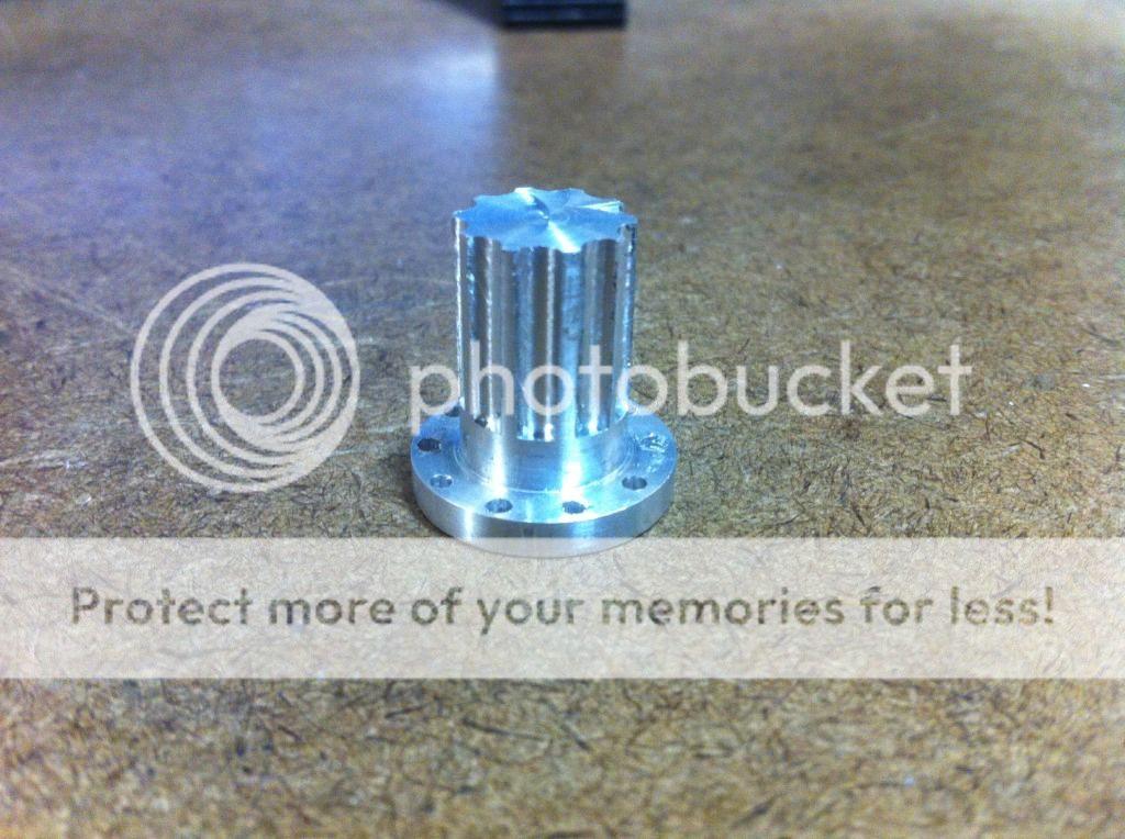

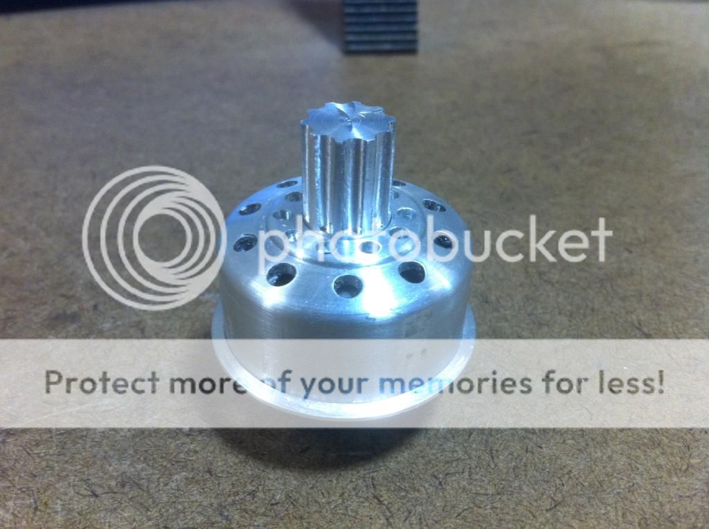

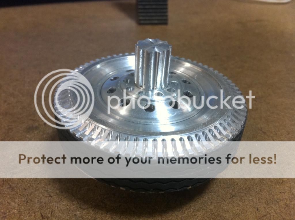

Superpeterbilt Posted February 20, 2015 Author Posted February 20, 2015 More work on the drum, and we have the beginnings of a hub.
RAT-T Posted February 20, 2015 Posted February 20, 2015 Well, after stressing about how I was going to cut the tread I started looking for 1/8 car tires and things like that. I came across some 1/14 RC truck that were perfect. I grooved out the alum tire, cut the sidewalks off the 1/14 tire, and wrapped it in. It worked perfectly. GREAT IDEA TERRY, THANKS

williamchevelleman1972 Posted March 20, 2015 Posted March 20, 2015 i have the 1/16 cummins ntc 400 and the australia 8v 92 t detroit and 8v 71 and the 8v 71 t and 12v 71and the 3406 cat I will be working on a 671 Detroit DO YOU KNOW when you will some of the parts ready for us to get from you .Thank !
Superpeterbilt Posted March 21, 2015 Author Posted March 21, 2015 i have the 1/16 cummins ntc 400 and the australia 8v 92 t detroit and 8v 71 and the 8v 71 t and 12v 71and the 3406 cat I will be working on a 671 Detroit DO YOU KNOW when you will some of the parts ready for us to get from you .Thank ! I dont know definitly. Im still working on the hubs and drums. Somehow my hole pattern is off, so I had to start over. I also am going to make brake shoes.
williamchevelleman1972 Posted March 21, 2015 Posted March 21, 2015 I think the brake shoes would look pretty cool.
