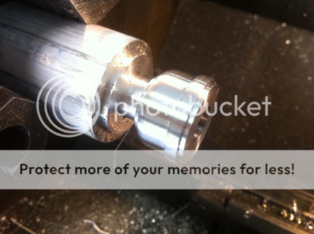

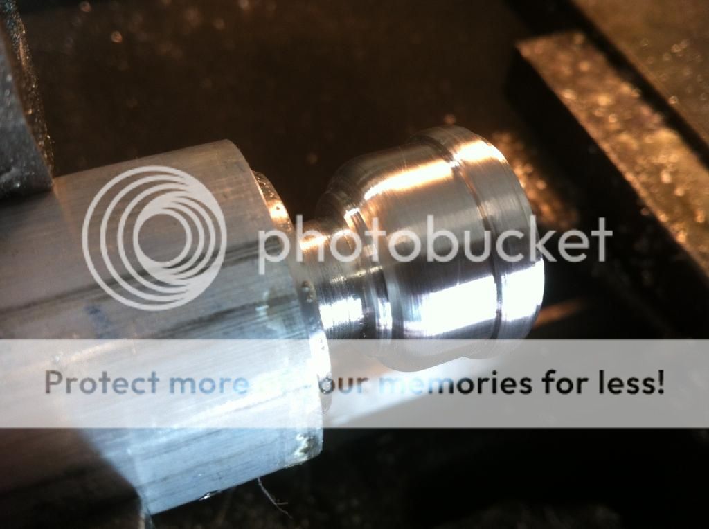

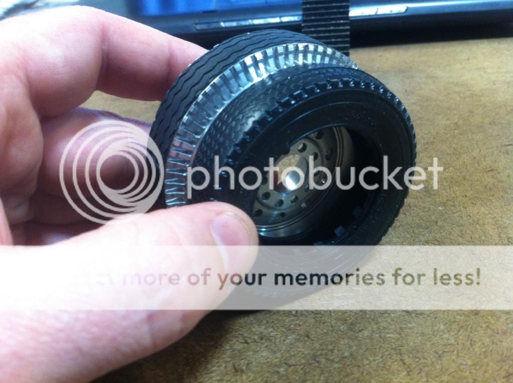

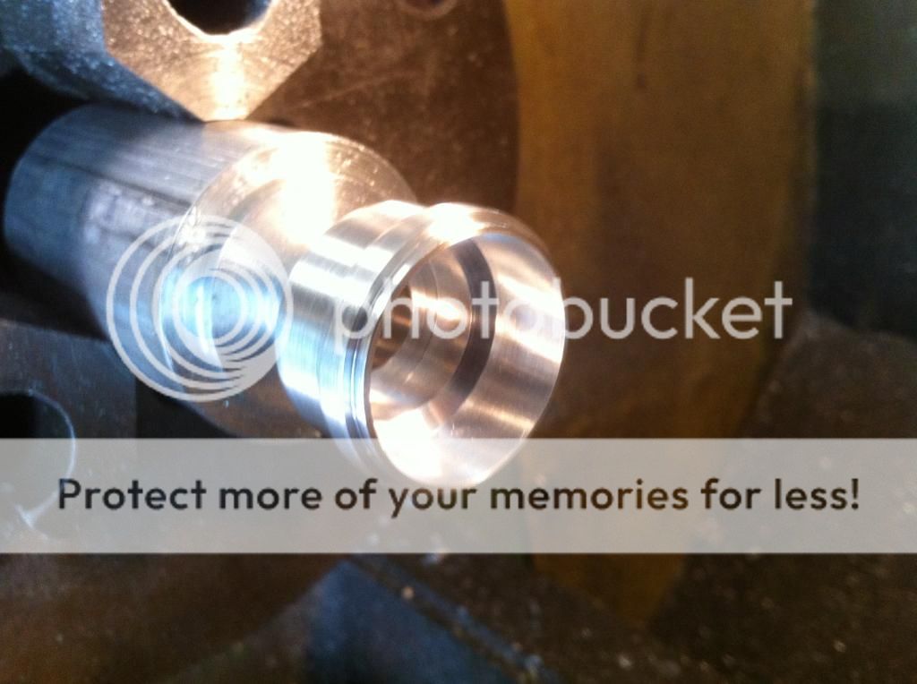

So in my spare time at the shop I decided to try to make a better Alcoa rim for the 1/16 trucks. I recently grabbed a few of the Petes and realized that theres virtually no aftermarket in this scale. I strongly dislike the wheels in the kit, so Im doing something about it. I started with some 1.5 Alum round stock and got to it. This is the start of the rough shape before I radiused it with a file.If you notice the shiney line on the outer diameter, thats how far back Im going to bring the radius.
2C07D9B5-9A28-499E-AC12-3FFCEFCDB60C_zps

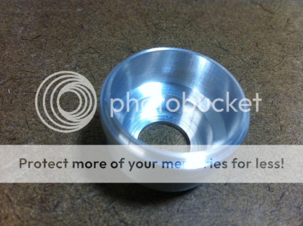

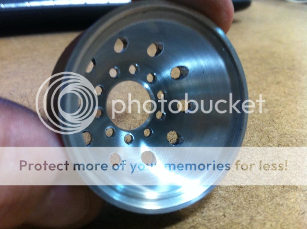

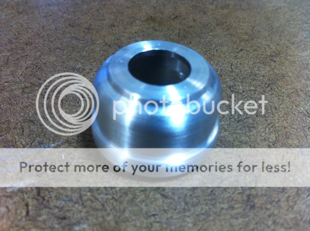

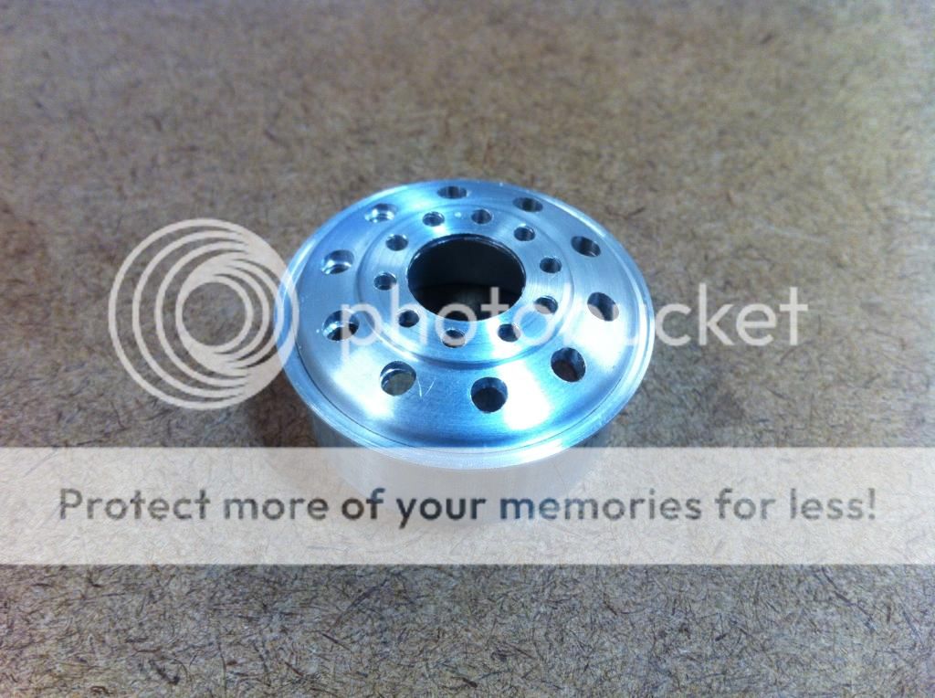

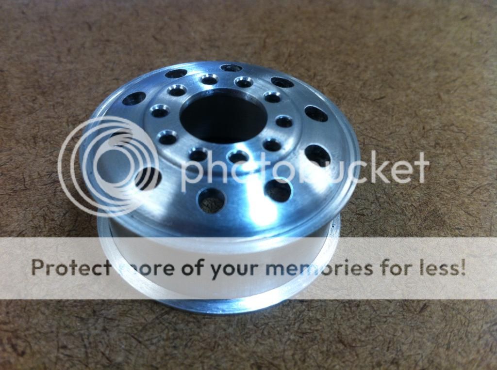

After shaping, parting it off, and hogging out the back this is the end of the lathe work.

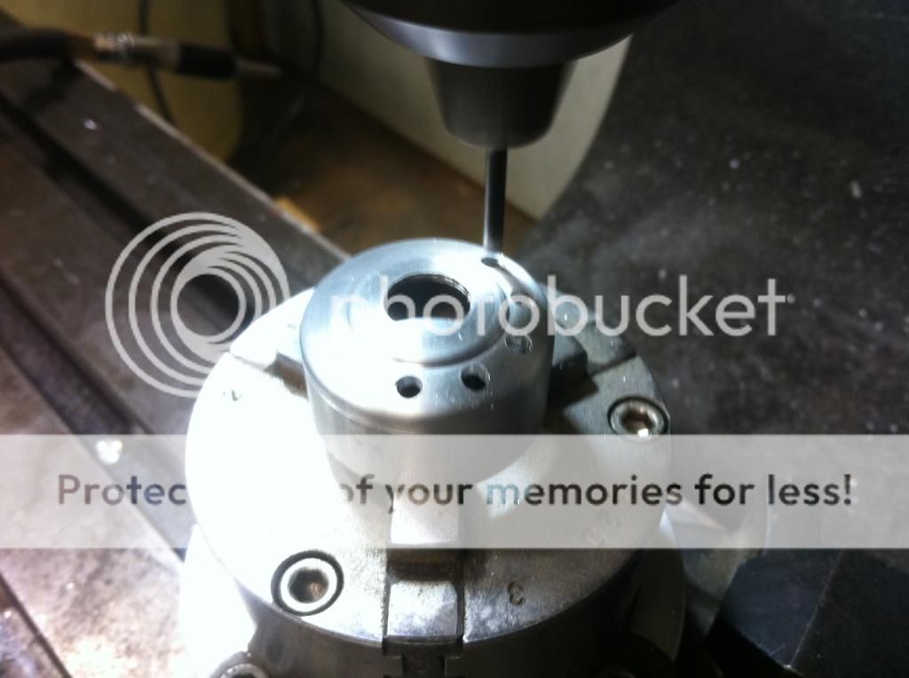

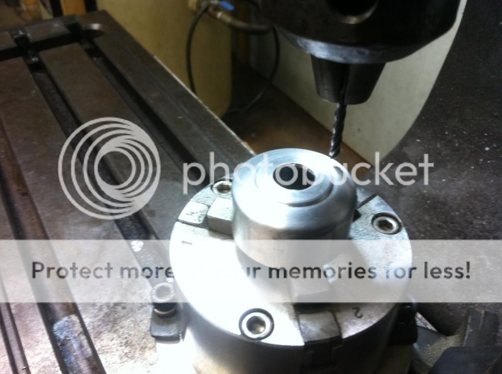

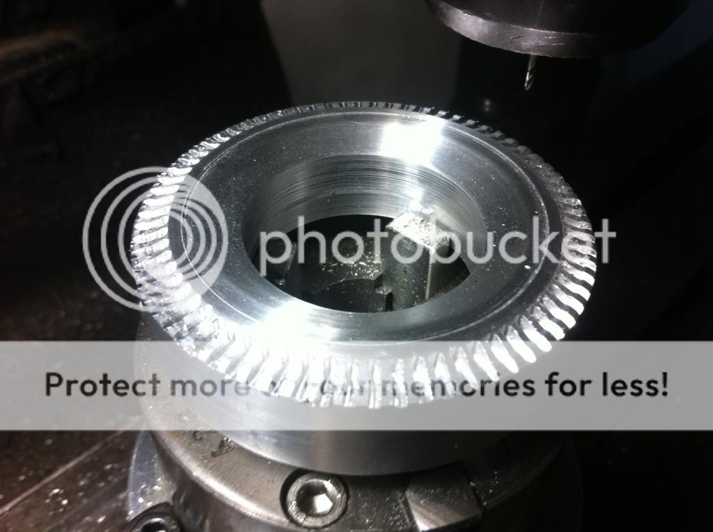

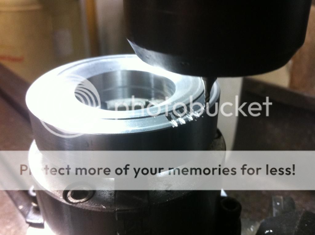

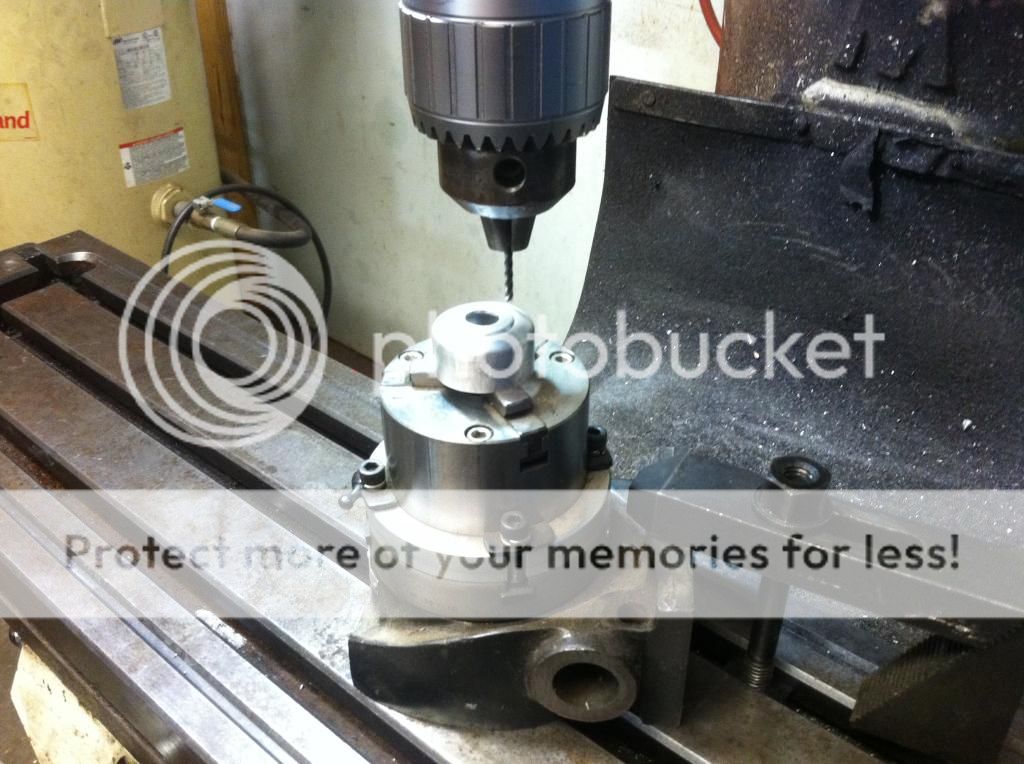

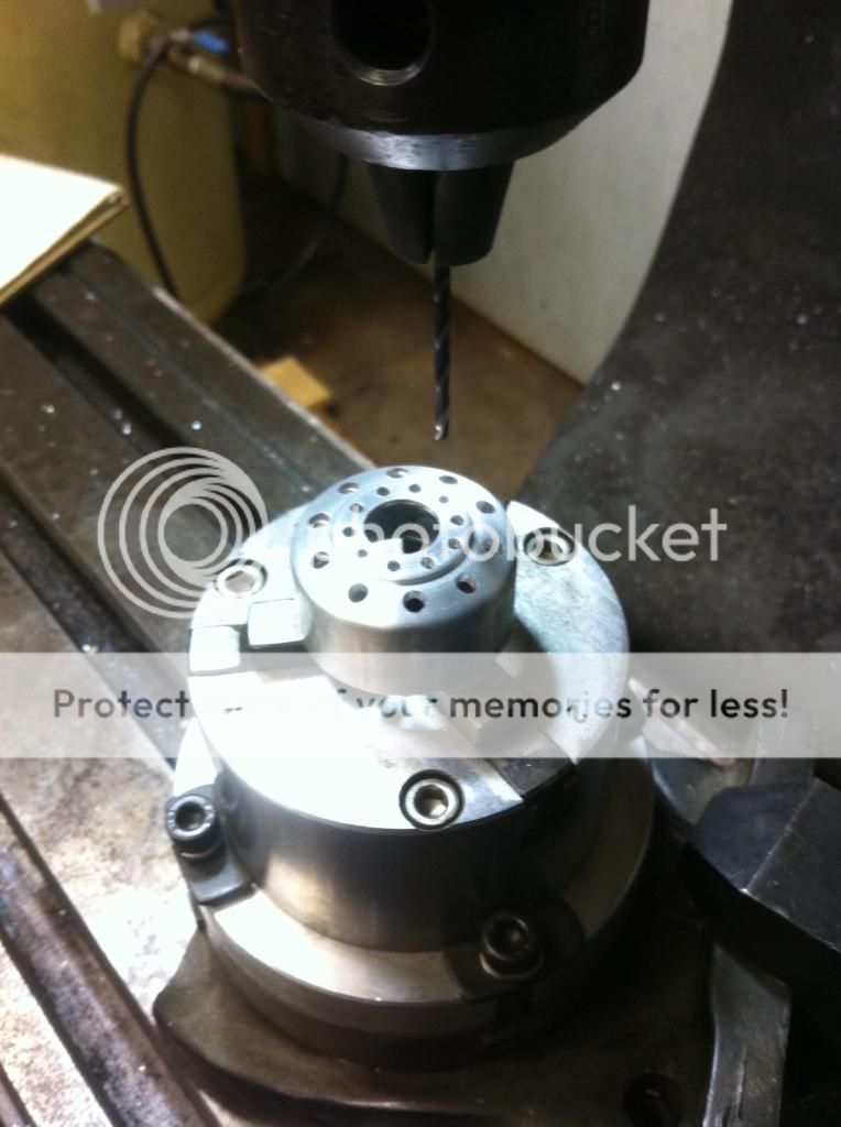

Next, I set my mini rotary table up in the Bridgeport and set up to mill the 20 holes.

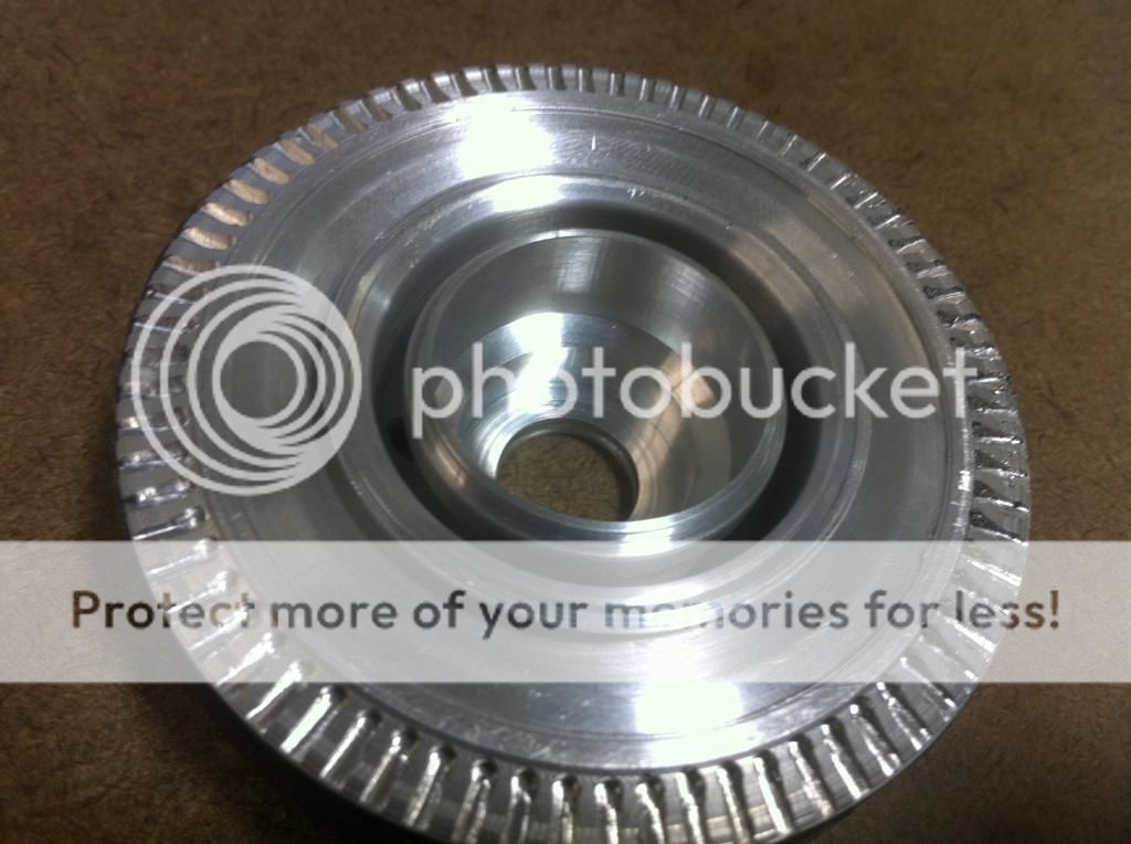

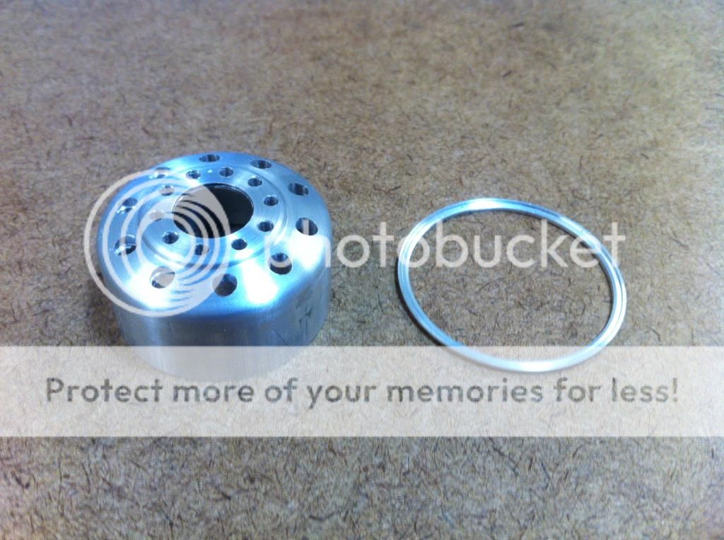

Next, I made the outer rings. I chose to go with the split rim because Im all about the old school.

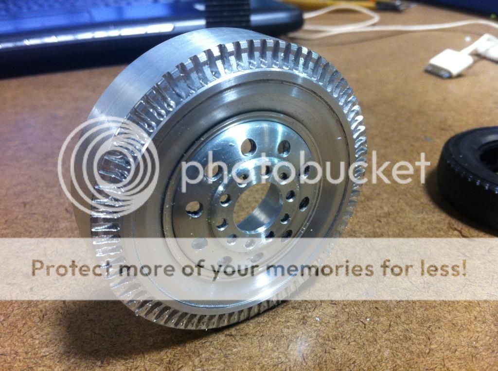

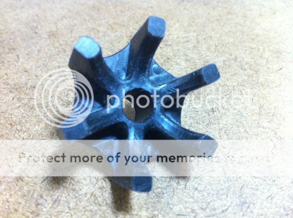

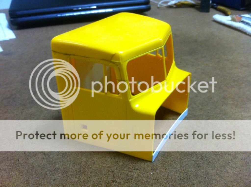

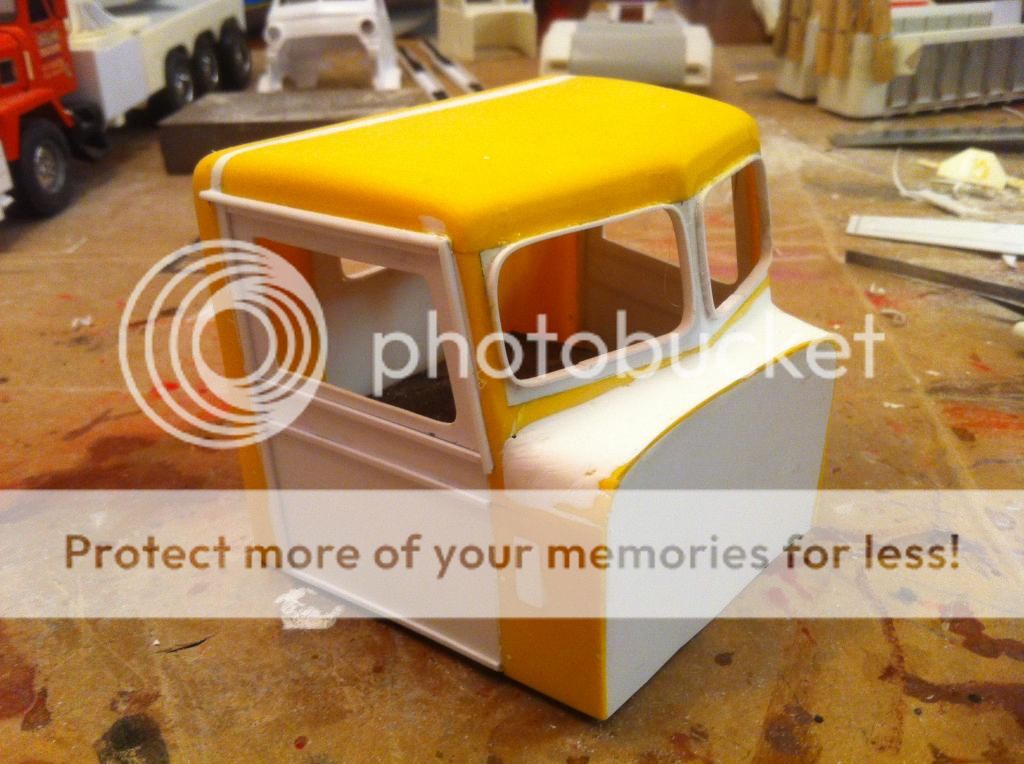

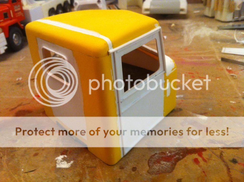

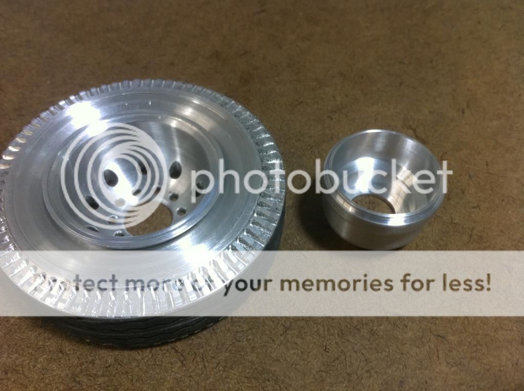

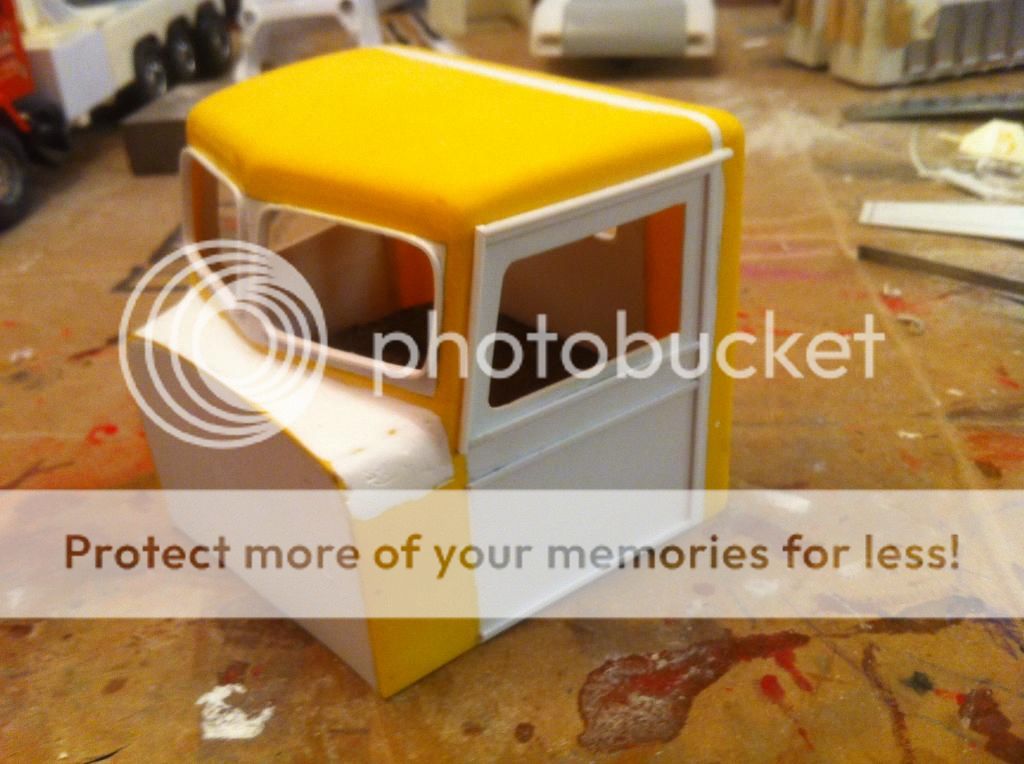

Ive been working on a bunch of other parts to accompany the rims. Tires, brake drums, brake shoes, 6 spoke front and rear wheels, and hubs. The plan is for the hubs to be tapped to recieve scale hardware bolts and acorn nuts. Im also about 80% done backdating a Pete cab to a Unilite little window. I will also be working on a 351 conversion, and walking beam rear suspension. Heres some of the work Ive done.
