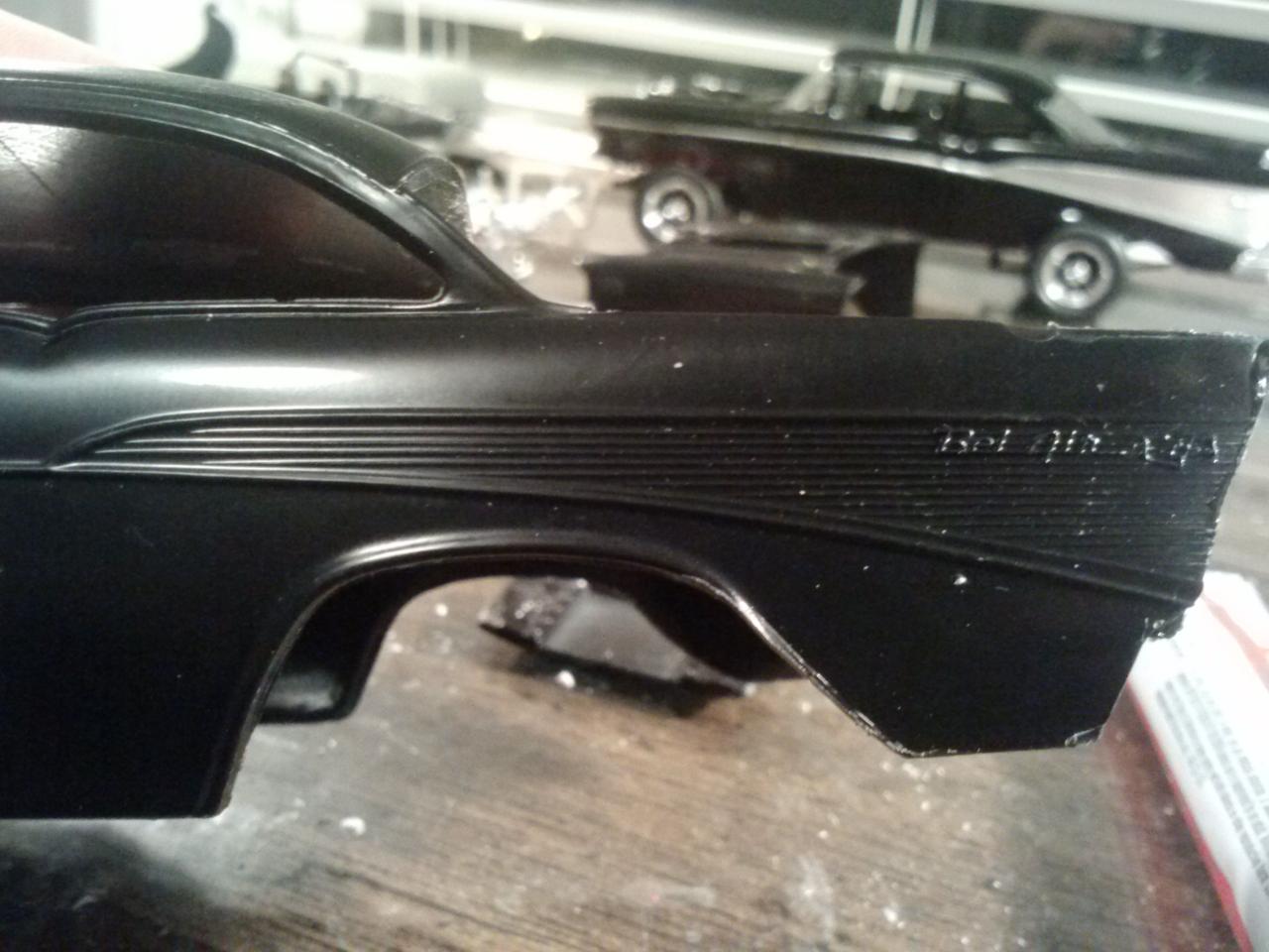

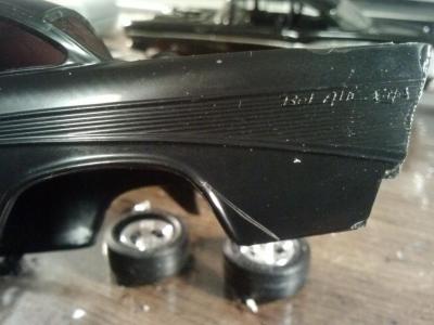

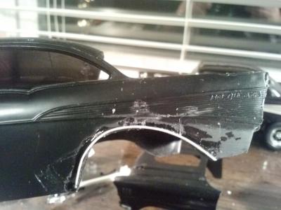

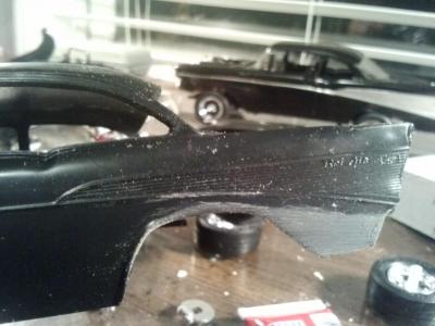

Snake45 Posted October 30, 2014 Posted October 30, 2014 I am going to reshape the wheel wells. The Revell car will NOT line up 1:25 to 1:24 problem. I think I might mark the curve with a curve drafting tool and cut it in by hand. I am going to leave the leading edge of the wheel well alone and just reshape the trailing edge. The ancient Revell kit is 1/25. So would be the '57 Bel Air coupe, but if I had that kit, I'd just use that whole body. Come to think of it, I do.
Trans Am Erik Posted October 30, 2014 Author Posted October 30, 2014 I have the newer Revell kit and the one with opening doors. I have big plans for the first one. Hint: blue with flames, and part tank!

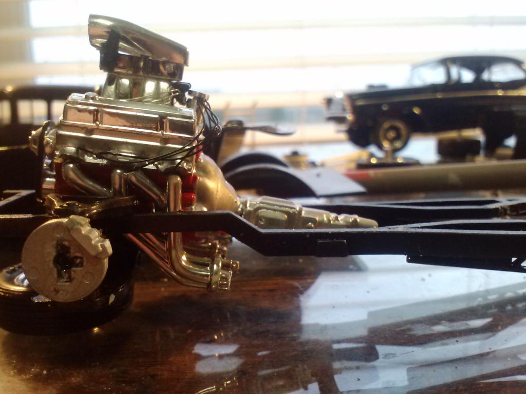

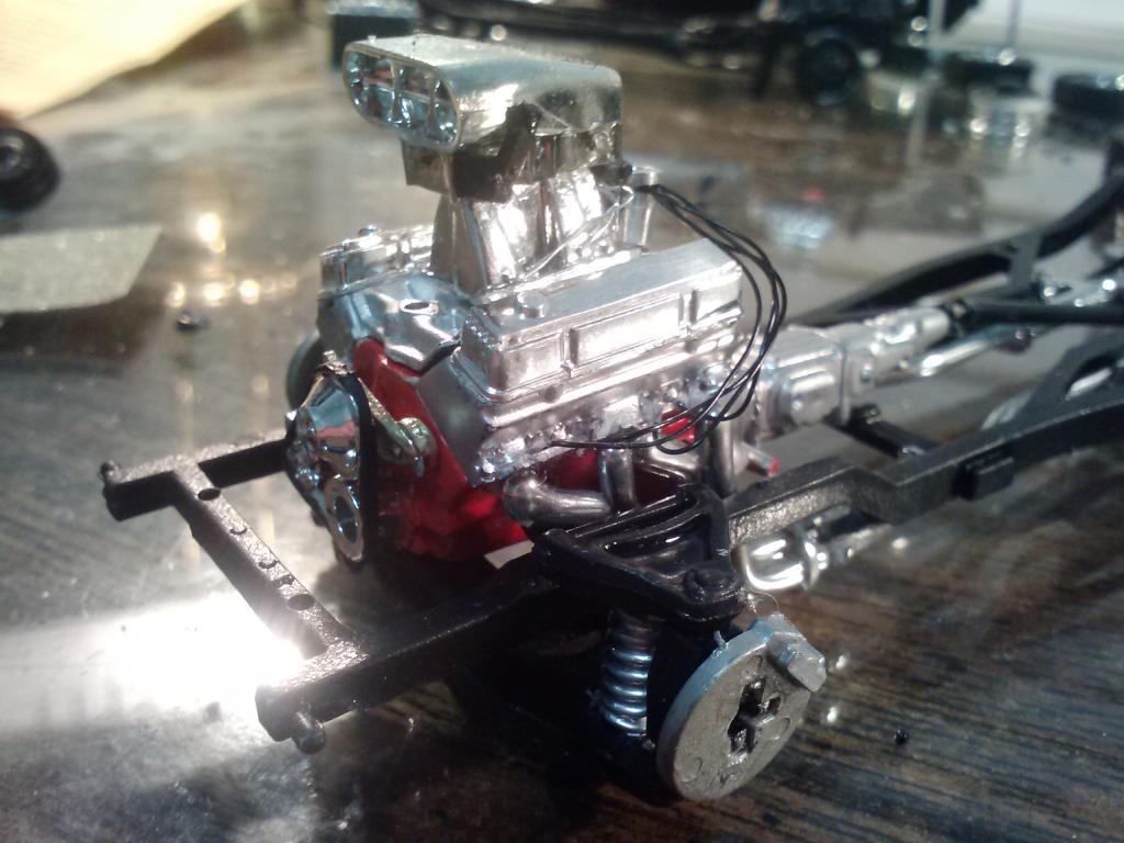

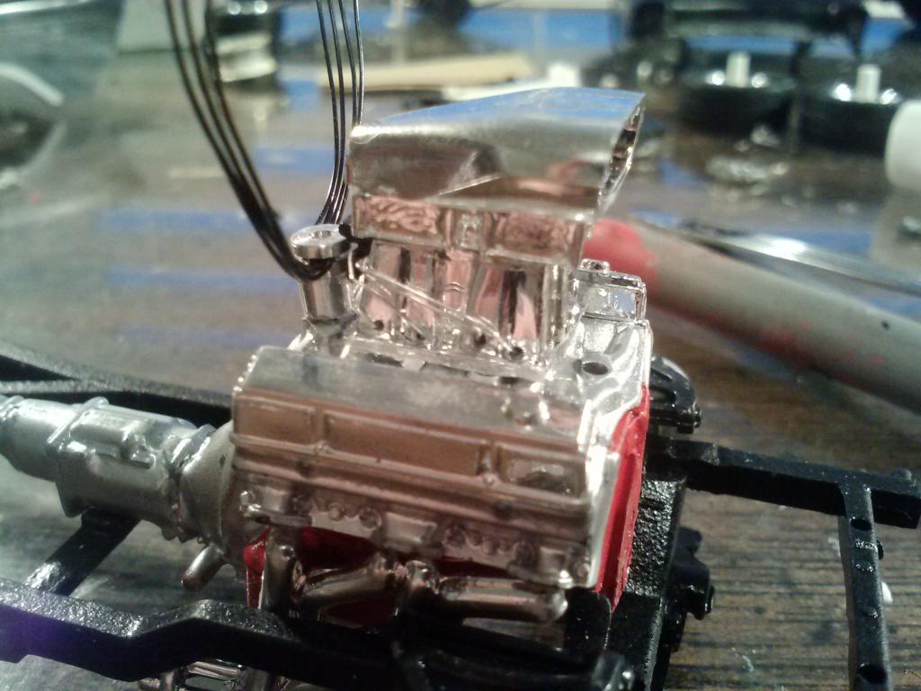

Trans Am Erik Posted November 11, 2014 Author Posted November 11, 2014 Exhaust, and completed 429 small block

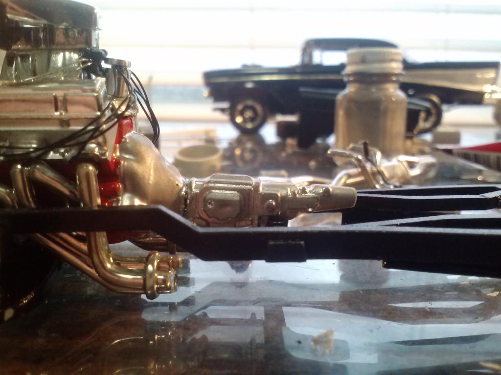

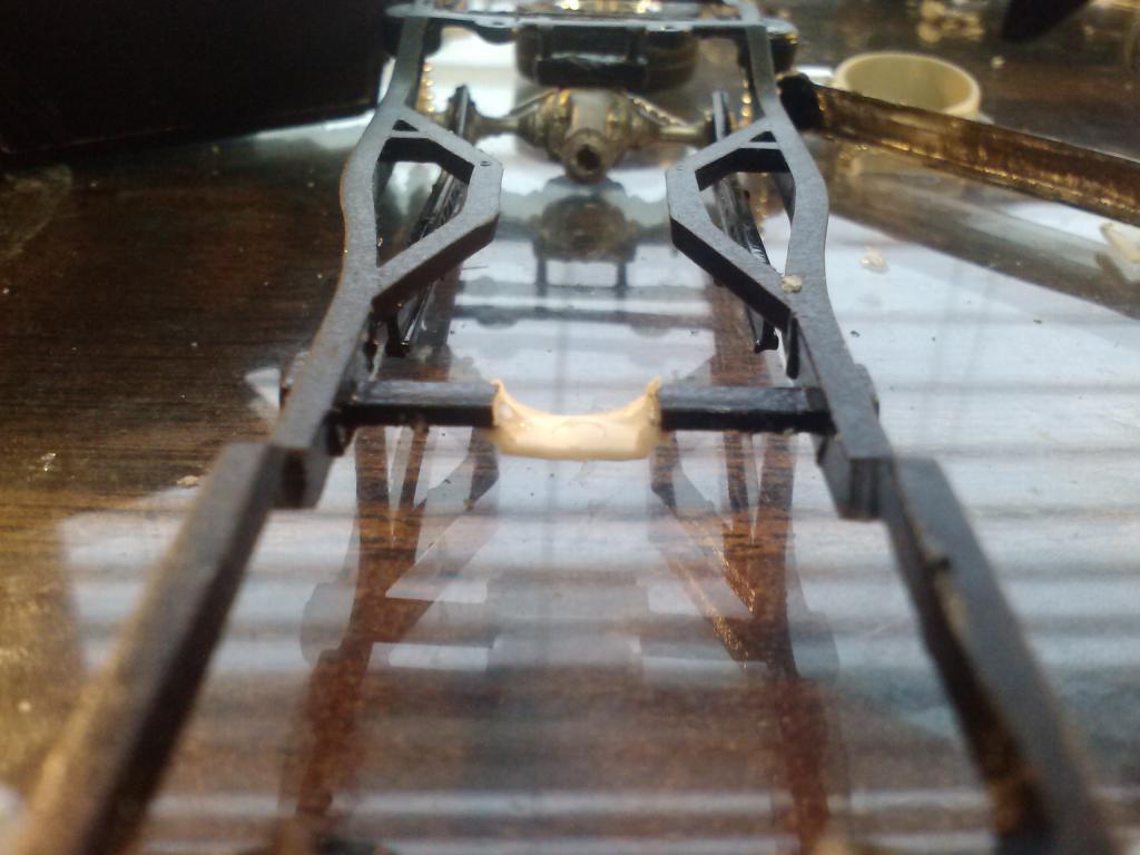

Trans Am Erik Posted November 14, 2014 Author Posted November 14, 2014 When I test fit the body it sat too high in the front. The trans was hitting the trans tunnel and lifting the body. So I got the Corvette chassis I took the suspension from and cut out the center of the trans cross member. Grafting that hoop in dropped the trans and gave the engine the angle it needed for the rake of the chassis.

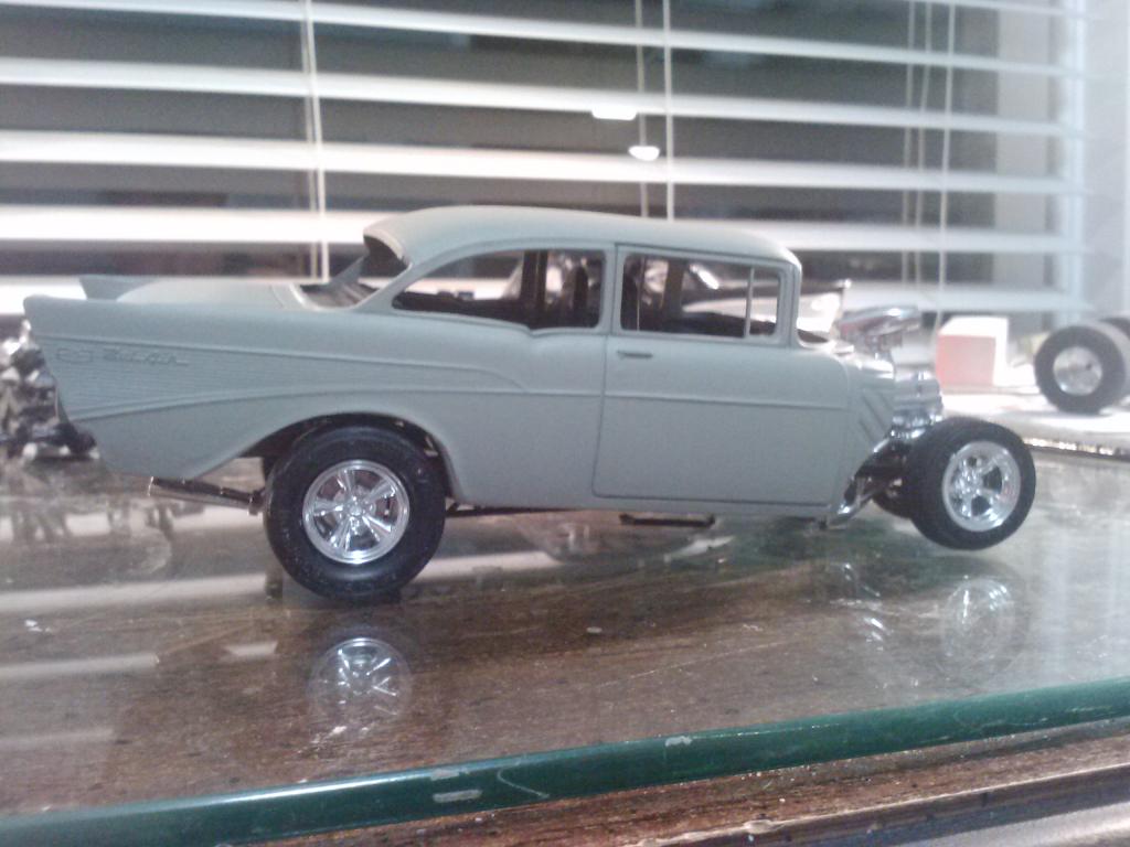

Trans Am Erik Posted November 14, 2014 Author Posted November 14, 2014 Chassis done, fitting up the body!

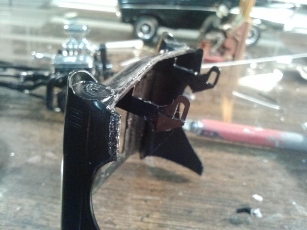

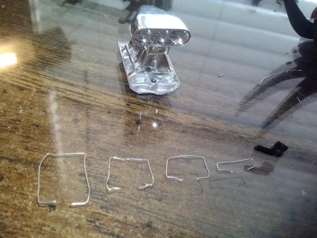

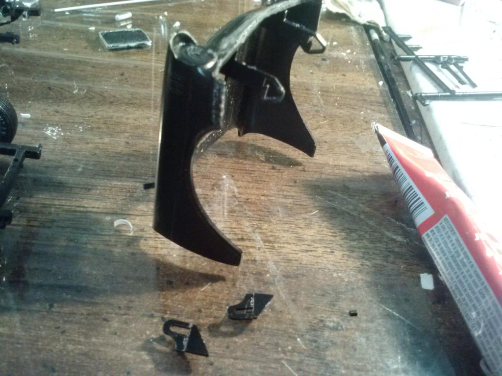

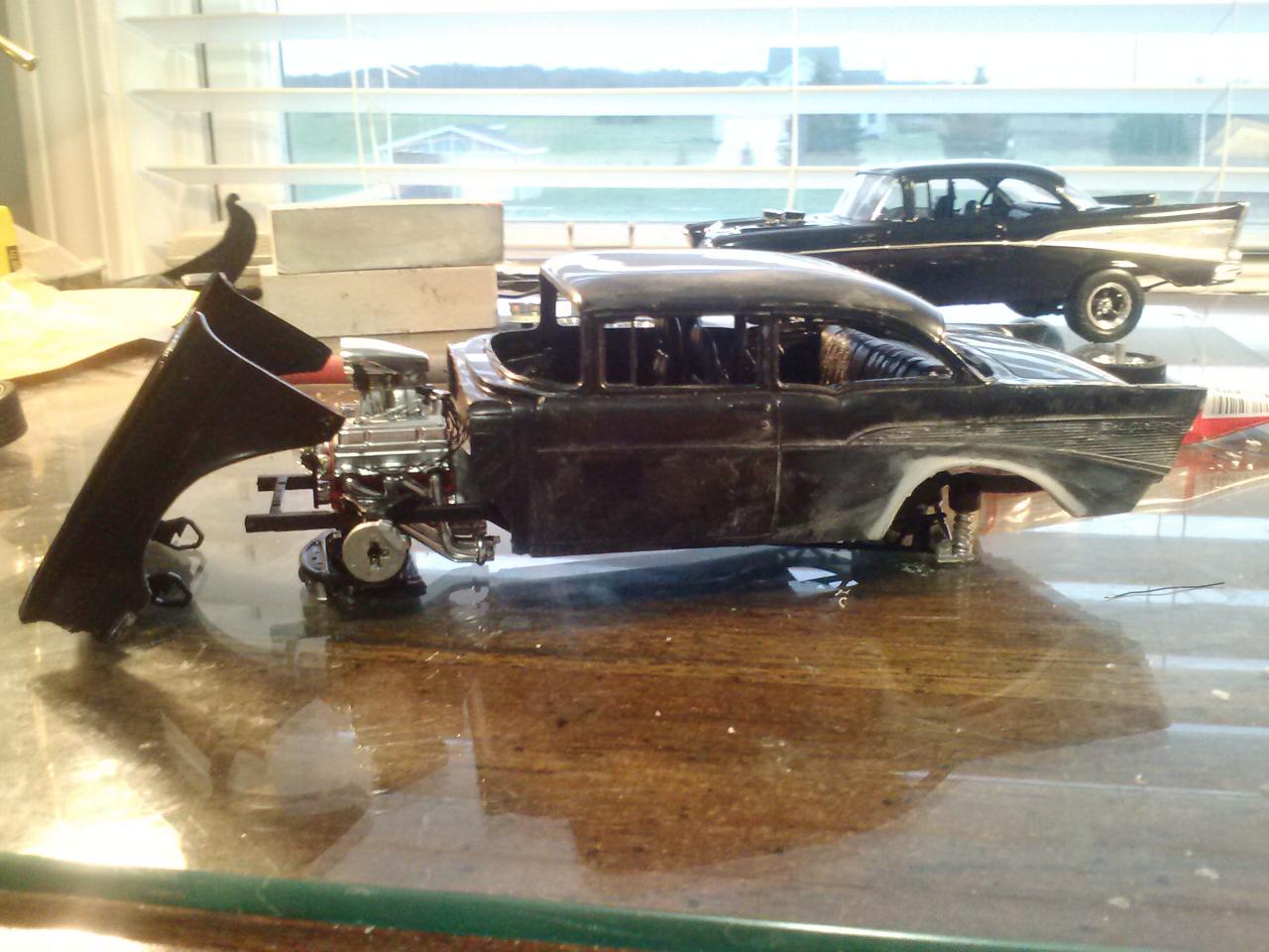

Trans Am Erik Posted November 15, 2014 Author Posted November 15, 2014 New hinges. I don't know what they were thinking with the original ones. I cut and modified the hinges from the tilt nose 53 Ford truck.
Trans Am Erik Posted November 15, 2014 Author Posted November 15, 2014 The front end lines up and tilts. The Crypt Keeper likes it! Now to add limiting blocks to the hinges, reshape the hole in the hood, and smooth it out.
