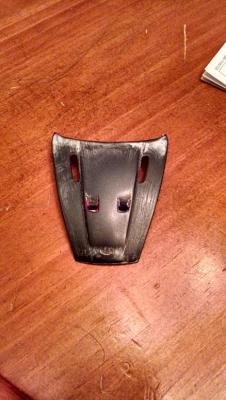

ok guys, here's the hood. It's not done quite yet. I have some more stripping and sanding to do. The little bit of white towards the windshield side of the hood is primer. So far this Citrustrip has done a great job.

Never known of Citrustrip. If it works fast that's a good thing. Did it do any damage to the plastic??
No damage to the plastic. No bubbling, pitting, or warping. The hood does feel a little more flexible maybe? I don't know the science behind plastic and such but I didn't really handle the hood a ton before and I also didn't test the flexibility of the hood, so I can't say with any certainty that its a little more flexible. I have heard that Dot 3 and 4 can cause the plastic to be a little more flexible so perhaps it's unavoidable.
Oh, I spelled it wrong, it's Citristrip.
least it came out looking ok so there was no damg to it that good just needs a bit more sanding then your set looking great so far good job buddy cant wait to see how the rest of it looks when its done
