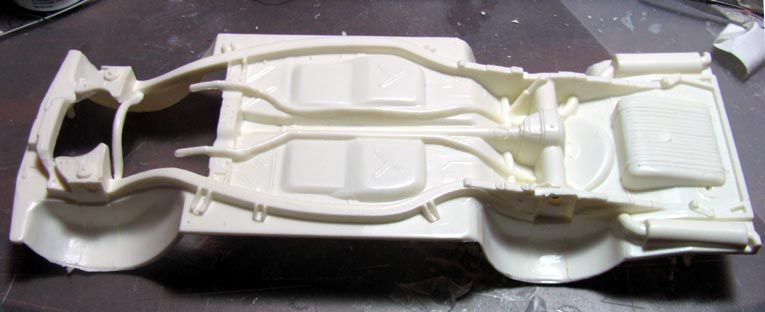

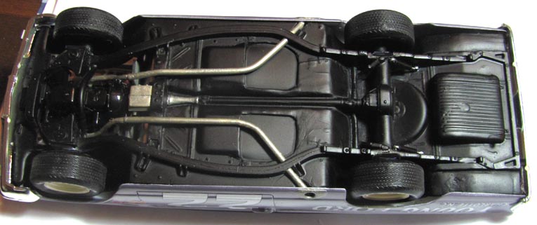

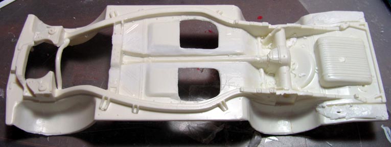

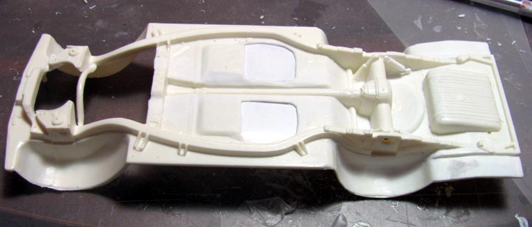

Thanks, Mike. the oil cooler is scratchbuilt from styrene sheet and rod made by evergreen. Thankfully hobby lobby is now selling it again. I'm not sure where I posted the wip on this build. If it was at randy ayers old site or scale auto it is gone. If i remember correctly I had to remove the molded in exhaust and cover the voids with styrene sheet and putty and then install new exhaust using evergreen tubing. . you have to remove the area where rear seat passengers put their feet and replace it with sheet styrene so the pipe can go through the frame . But dont try to drill a hole through the frame just butt the pipe up to the frame on one side and then  continue the pipe through the frame on the other side by butting it up as well . It looks like its actually going through the frame but its a lot easier to do it that way .  just cut a hole in the body where the pipe comes through and  shape it as an oval,  like the real car had it. Thats about it. I found a picture of the 1963 21 ford on its side for reference for the exhaust. If I can find it I will post it here.
I could find no wip but I found some wip photos in my files . Hope this helps, Mike. The first photo shows the molded in exhaust and goes from there. I used sprue cutters to remove the exhaust.
