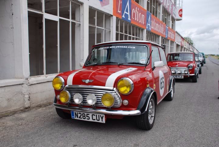

chunkypeanutbutter Posted December 26, 2014 Posted December 26, 2014 Can anybody tell me how to turn clear headlights into yellow ones such as this? Please, no smarta$$ responses. I was thinking some Tamiya clear orange paint mixed with a little yellow... Anybody have anything more definitive that would work, preferably something they've tested?

Longbox55 Posted December 26, 2014 Posted December 26, 2014 I would go the other way around, Tamiya clear yellow with a little orange, as the lenses look more yellow in color than orange to me. Another option would be to use Testors Turn Signal Amber, which is available in 2 different enamel versions and an acrylic. All 3 have slightly different shades, with the Model Master Enamel being the darkest.

chunkypeanutbutter Posted December 26, 2014 Author Posted December 26, 2014 I would go the other way around, Tamiya clear yellow with a little orange, as the lenses look more yellow in color than orange to me. Another option would be to use Testors Turn Signal Amber, which is available in 2 different enamel versions and an acrylic. All 3 have slightly different shades, with the Model Master Enamel being the darkest. I'll have to get some clear yellow next time I get to the LHS. I only was going to use clear orange because that's all I have.I do have some Tamiya clear smoke color.
