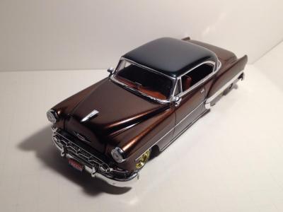

Here's a Camaro I painted and cleared with this stuff a few days ago.
Hey there JD. Your product lived up to exactly what you claimed when I used it on spoons. I tried five different types of applications and three got poor results like most of the comments by some who have tried it. One came out decent and one came out great. As with anything people need to take the time to experiment and find a way to make it work properly. It is different from one coat lacquer of which you can put on a fairly heavy coat. But if the time is taken this can be just as good and cheaper. That said. I can still get the one coat lacquer look, and the same look with this Tree house product with Pledge floor care. which is even a whole lot cheaper. But I have an airbrush and spent a lot of time practicing with it to get the results that I do. Your product is a great product for those without an airbrush as long as the time is taken to play and practice to get the great results. Here is what I can get with floor polish.
