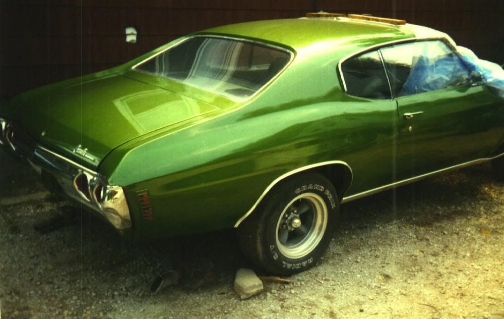

Dave Mikrut Posted February 7, 2008 Posted February 7, 2008 I second the olds 442 W-30 kits chassis choice, lots more detail and as a matter of fact, when doing a frame off restoration of my 1:1 1970 Chevelle at the time, I was able to replace my damaged frame with a 69 Cutlass frame which was in nice condition. So it is a match.

Mike Chernecki Posted February 8, 2008 Author Posted February 8, 2008 (edited) I second the olds 442 W-30 kits chassis choice, lots more detail and as a matter of fact, when doing a frame off restoration of my 1:1 1970 Chevelle at the time, I was able to replace my damaged frame with a 69 Cutlass frame which was in nice condition. So it is a match. Thanks for the tip. There rear section of the frame (behind the rear bumpr) on my '70 Chevelle is all twisted from someone pulling it with a chain or something. A local wrecker has a couple '70 Cutlass hardtops with nice frames. Is that a picture of your Chevelle, looks nice. You says its a '70, but why does it have a '71-'72 rear bumper? Edited February 8, 2008 by Mike Chernecki
