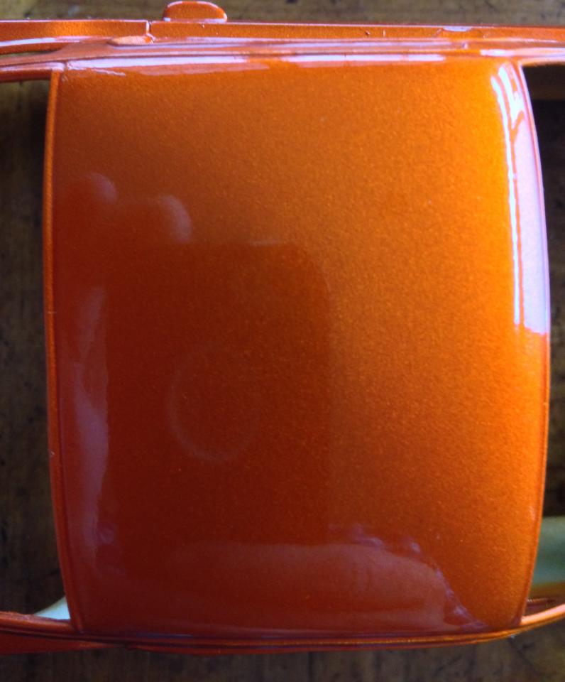

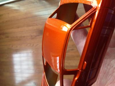

I guess it depends on what your interpretation of "shiny" is. It's one thing to be shiny, but the be glass shiny without any orange peel, is another. I'll let you decide what category this one falls into. Keep in mind I spent about five minutes wet sanding and polishing the roof. Prep and technique has always been the key to a nice paint job, in my opinion.
Tim
post-14604-0-81682300-1422826304_thumb.j
post-14604-0-67849300-1422826307_thumb.j
