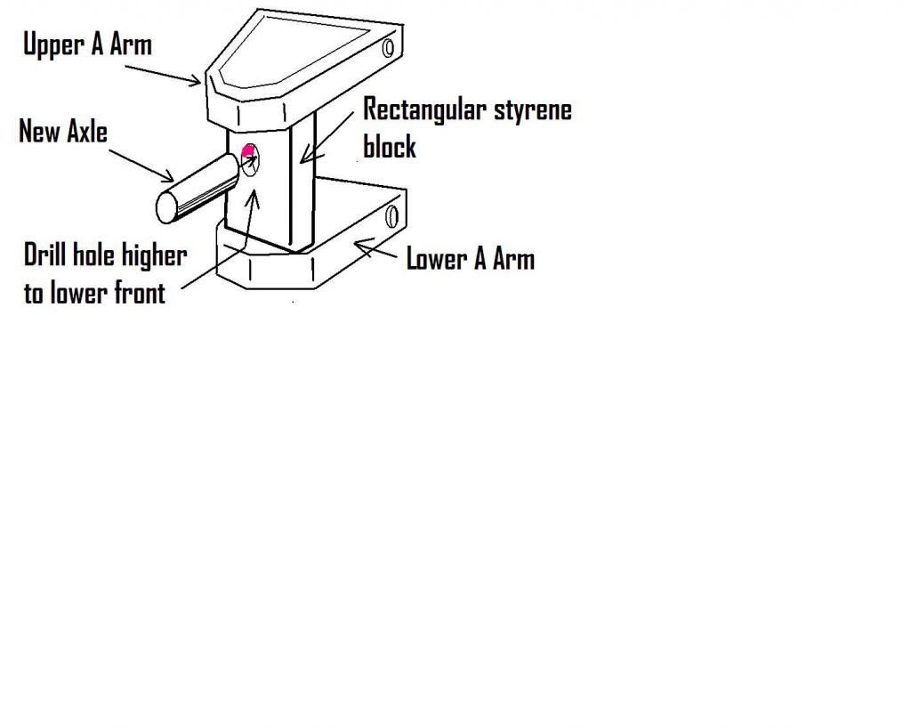

I was also able to get the front suspension cut out to get a closer look at what it will take to lower this thing.
Not sure how I am going to get this lower with the way it's designed.
The front needs to come up quite a bit to get it as low as I want it.
The rear suspension I can probably get to drop 2-3 scale inches fairly easily. It's just the front that is going to be irritating. I've lowered a car before but this is designed funky. The spindles would be a pain to cut out. If cutting them out and extending them is the only way then that's what I have to do. If anyone has any ideas on lowering the front, I'd appreciate the input.

Lowering the front shouldnt be too hard, just cut that round area completely off then get some small rectangular rod and fit it between the upper and lower "a" arms with the wider side facing the outside of the vehicle. Then drill a hole where you want the centerline of the tire to be and glue in some round rod to slide the back-side of the wheel onto. If you have trouble with this description I could draw a diagram for you. Keep in mind when you change one thing it can effect ten, mock up your intended ride height ,then check clearance on things like the oil pan, trans pan and exhaust.
Edited by gonzo64nova, 06 February 2013 - 05:47 AM.
I figured that's about how simple it would be and from what I have mocked up, I don't think I'll have any real clearance problems. If you could post a pic of how you would do the rectangular rod I would appreciate it.

#20 gonzo64nova
gonzo64nova
    MCM Friend
  • PipPipPipPip
  • 166 posts
  • Location:Long Island
  • Full Name:Bill Gonzo
Posted 07 February 2013 - 09:41 AM
This might make it easier to understand....
