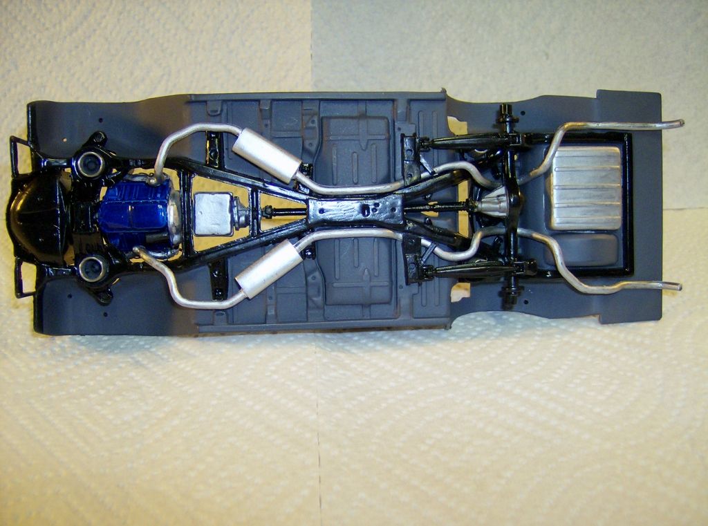

Finally I'm able to post some progress pictures.  It seems like I've been working on this "forever" and not making any progress.  i've been doing a lot of painting of parts, drilling holes, and researching google reference pictures for details.  Today was a GOOD progress day, in that I was finally able to assemble a bunch of stuff.  Here goes...
First of all, here's a picture of the almost completed chassis.  I still have to install the front end/suspension, the rear shocks, the wheels and aluminum tubing exhaust tips.

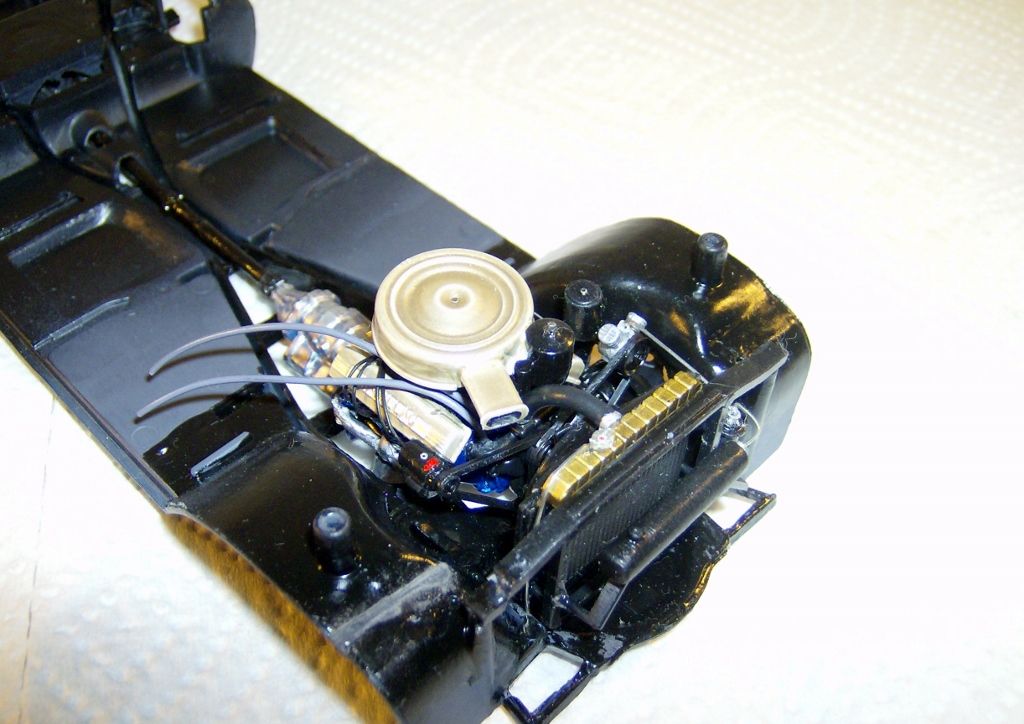

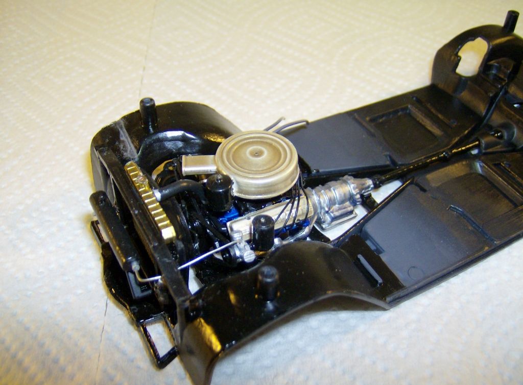

Here's a front shot of the engine and radiator.  I had no idea what the canister looking piece was in front of the radiator support and when I googled some pictures I saw that it is for the A/C system.  Since I was adding extra detail to the engine and engine compartment area, I decided to go a little further and try to add some detail to the A/C piece.  It's not perfect but it resembles what was in the reference picture.
The engine in this kit is not very highly detailed so I added an M.A.D. pre-wired distributor and an oil filler tube (which you can't see in front of the engine anyway).  I added heater hoses along with a radiator hose (because there wasn't one in the kit..!!)  I also added a radiator overflow line and a PE radiator cap, along with a couple of PE bolt heads.  The snorkel on the air cleaner was drilled out and some flat black applied inside. I painted the air cleaner and valve covers the Champagne Gold body color and the rest is detail painted mostly semi-gloss black.
In addition to all this, the firewall is painted and detailed.  I added a resin master cylinder and will also add a brake line when the firewall goes in.  The battery is paint detailed and wired and will go in when it is dry.

The cylinder up front was also used on eldos and caddies for a reservior for the level ride airbag system which was operated by the belt driven compressor on the engine which doesnt make sense on this car because it has coil springs. A lot of caddies with airbags were retrofited to coil springs because of high failure rates. Looking good making me want to start on my seville.

Way cool Rich. That's a car and a half! For a kit with soft detailing yours pops nicely.

That chassis is looking great the PE bits bring it to life . I cant wait to see all your 58 cars in one shot .Keep up the great work
