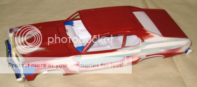

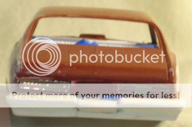

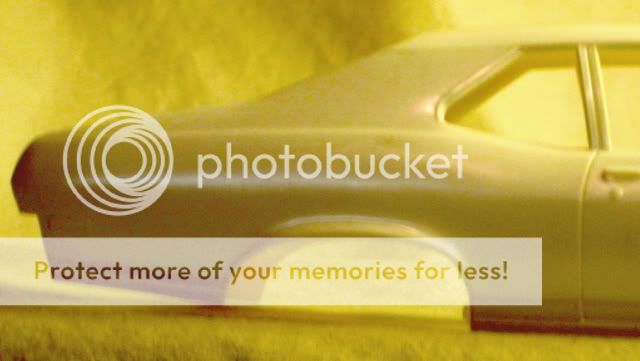

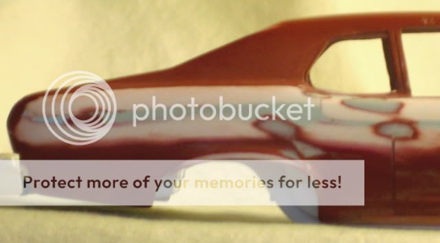

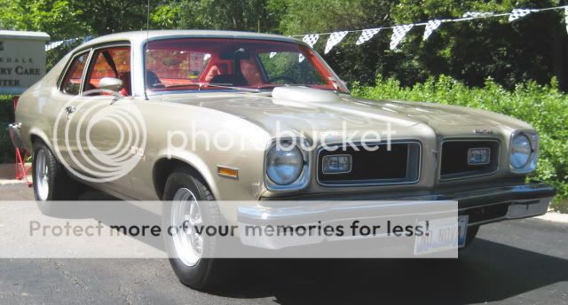

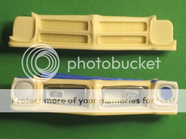

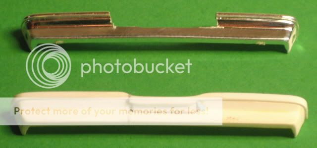

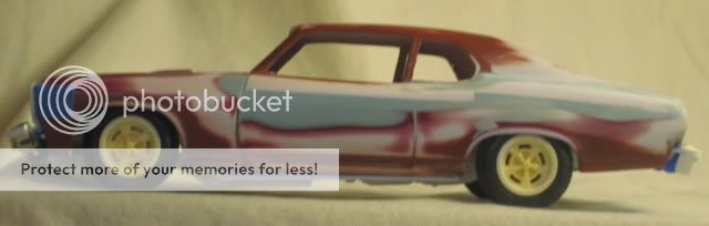

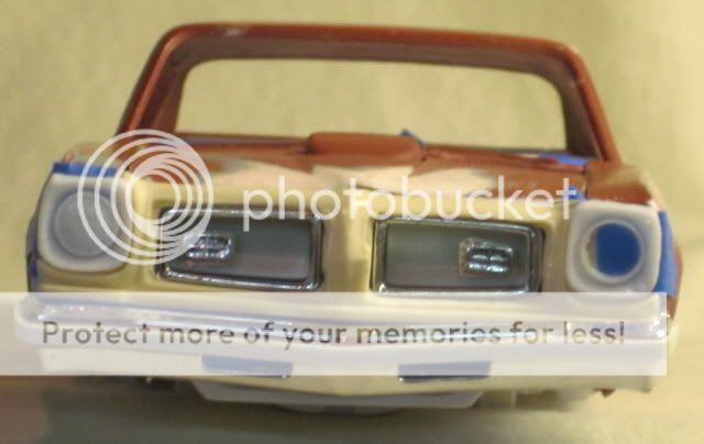

nonova Posted September 14, 2008 Share Posted September 14, 2008 After a long time on the workbench, and nowhere near ready to be completed, I finally talked my daughter into taking pictures of this long-standing project. Thanks to Revell for releasing the new Nova tool. I am using the interior and chassis from the Nova as a foundation for the '74 GTO. I hope you enjoy! 1974 GTO Side View. NOTE: upper quarterpanel and rear side window redone GTO Front View: grilles from AMT 1972 GTO, turn signal lamps from AMT 1965 Grand Prix GTO Rear View: bumper modified from MPC 1975 Ventura rear bumper Nova Quarterpanel: this is the 'before' picture GTO Quarterpanel: this is the 'after' picture (not finished yet) GTO Top View Resin Grilles supplied by Ed Fluck III at dragcitycastings Rear Bumper under construction The Real Deal: Owned since new Quote Link to comment Share on other sites More sharing options...

george 53 Posted September 14, 2008 Share Posted September 14, 2008 WoW, Rick, is that comin out sharp! I like the way you did the tops of the quarters/windows there, It came out REAL nice! Great job on a little known member of the GTO family! Quote Link to comment Share on other sites More sharing options...
modelguy( jeff) Posted September 15, 2008 Share Posted September 15, 2008 i have the 1975 gto i will be building mine soon seeing yours can you tell me does the 75 nova bumpers fit the gto Quote Link to comment Share on other sites More sharing options...

nonova Posted September 15, 2008 Author Share Posted September 15, 2008 i have the 1975 gto i will be building mine soon seeing yours can you tell me does the 75 nova bumpers fit the gto Jeff I used the bumpers from the MPC 1975 ventura kit. I used a strip of Evergreen plastic to replicate the rubber rub strip on the front. And I cut and lowered the middle portion of the '75 Venturas rear bumper and added the same Evergreen strip for the rear. Quote Link to comment Share on other sites More sharing options...

Gregg Posted September 15, 2008 Share Posted September 15, 2008 Rick, you better see this build through, or I'll just to fly up there and give you a good 'ol jawaiian head slap! Seriously, if that's your real car, and from day one, you better finish this, and bring it to a show I will be at. I would be honored to shoot this labor of love and feature it in MCM. There are a few cars of mine that I have owned over the years I will be building replicas of, too bad I don't still own them as well.... Now, back to the workbench, and thank your daughter for shooting pictures as well Quote Link to comment Share on other sites More sharing options...
