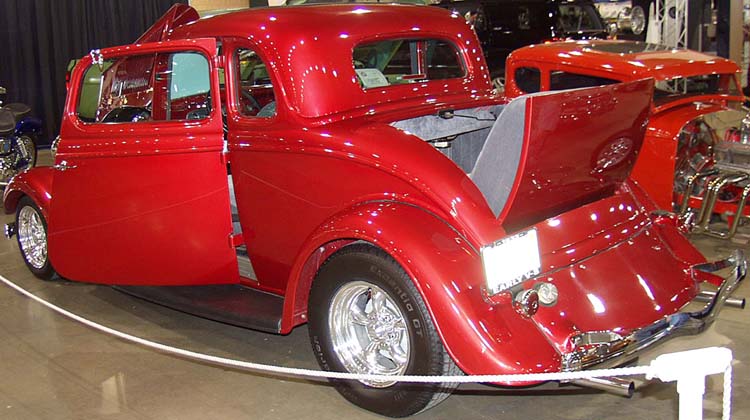

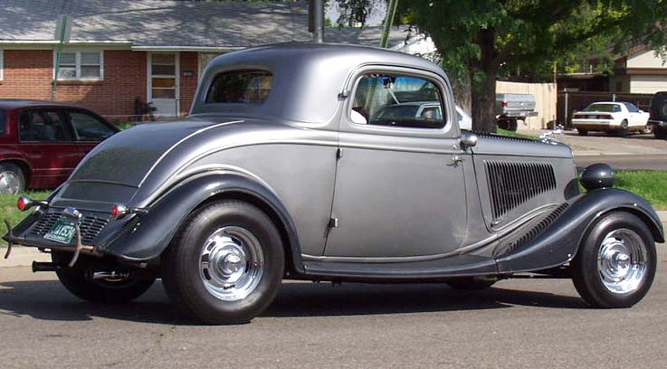

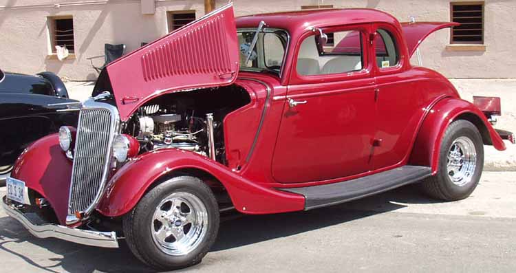

Joe Handley Posted May 25, 2008 Share Posted May 25, 2008 Lookin' Good so far! I have a question, what in the world is that little bit of plastic in the back side of the door window openings for? I've never seen that on any real '33 or '34 Fords Quote Link to comment Share on other sites More sharing options...

Raul_Perez Posted May 25, 2008 Share Posted May 25, 2008 I have a question, what in the world is that little bit of plastic in the back side of the door window openings for? I've never seen that on any real '33 or '34 Fords On the original '34 5 window coupes, the little pices of sheetmetal in rear of the window opening is there because of the way the window opened. It would first slide back about an inch, almost like an early version of a vent window, before it would begin to roll down. Some guys who have put power windows in their Coupes have removed the feature and the piece of steel in the opening when they change them over to a different system, partially explaining why the box art photo doesn't have it in the picture. Either that or the builder thought it was wrong or maybe just didn't like it and took it out. Who knows??? The 3 window coupes also had this feature, but it's more visible on the 5 window coupe, being a bit more pronounced. Check www.carnut.com for photo references. Regards, Quote Link to comment Share on other sites More sharing options...

Joe Handley Posted May 25, 2008 Share Posted May 25, 2008 On the original '34 5 window coupes, the little pices of sheetmetal in rear of the window opening is there because of the way the window opened. It would first slide back about an inch, almost like an early version of a vent window, before it would begin to roll down. Some guys who have put power windows in their Coupes have removed the feature and the piece of steel in the opening when they change them over to a different system, partially explaining why the box art photo doesn't have it in the picture. Either that or the builder thought it was wrong or maybe just didn't like it and took it out. Who knows??? The 3 window coupes also had this feature, but it's more visible on the 5 window coupe, being a bit more pronounced. Check www.carnut.com for photo references. Regards, Gottcha, that's for the response! I noticed it on a door that was being modded in the current Rod & Custom that I was assuming might have been a real car that was being cut up. Quote Link to comment Share on other sites More sharing options...
