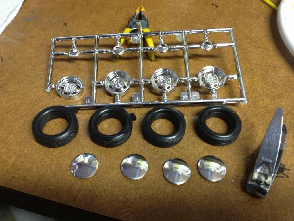

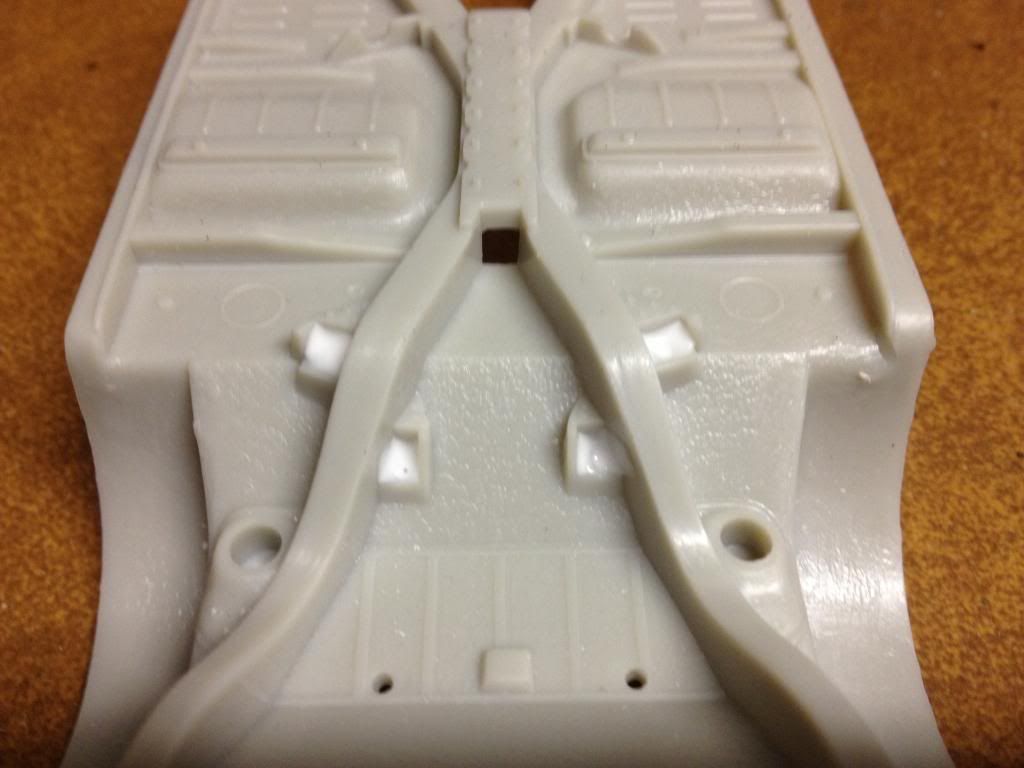

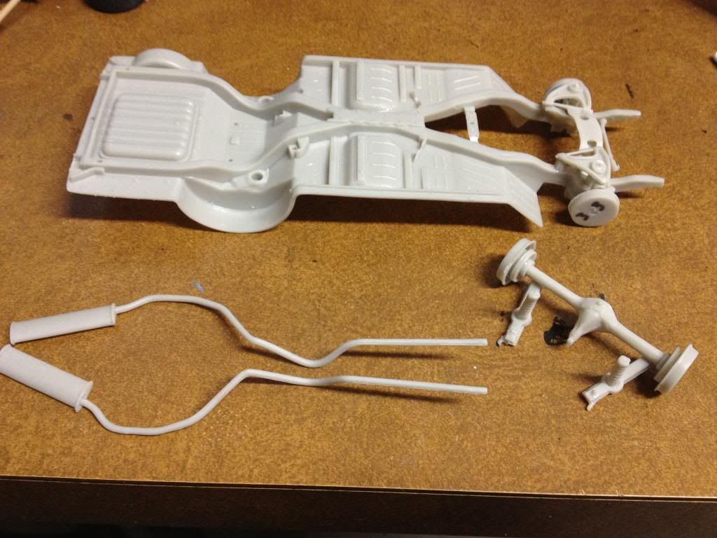

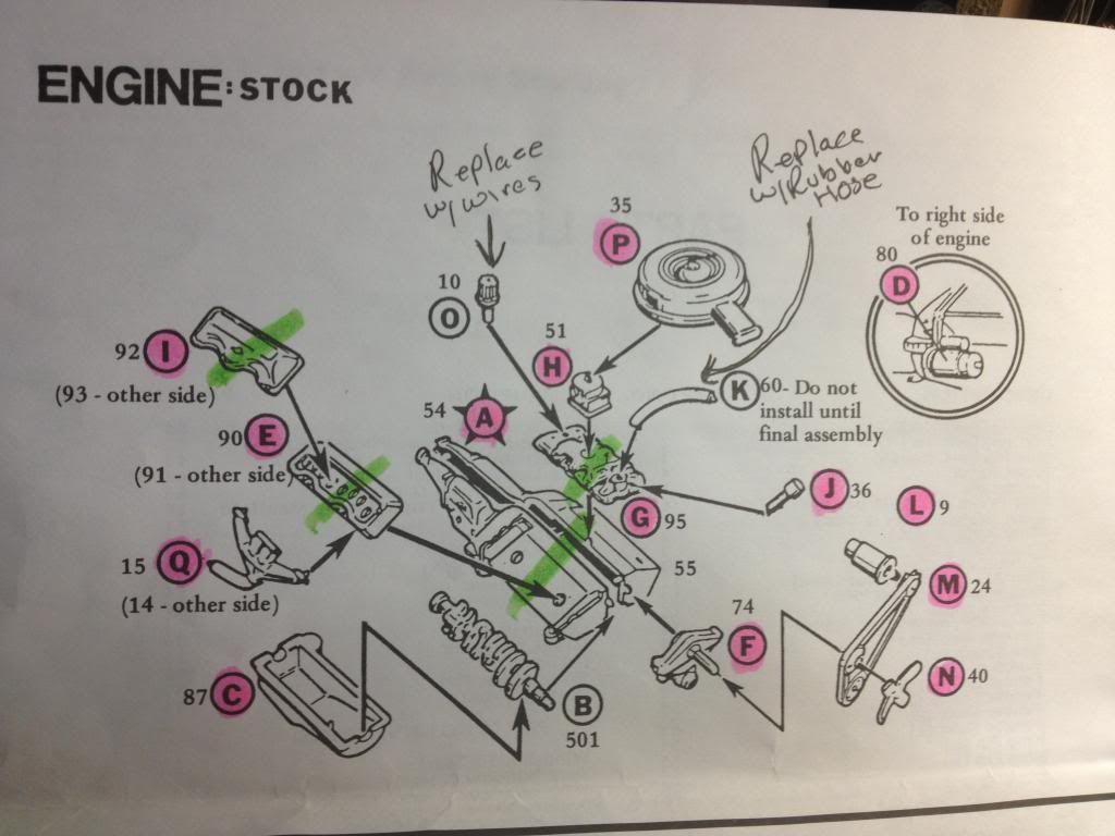

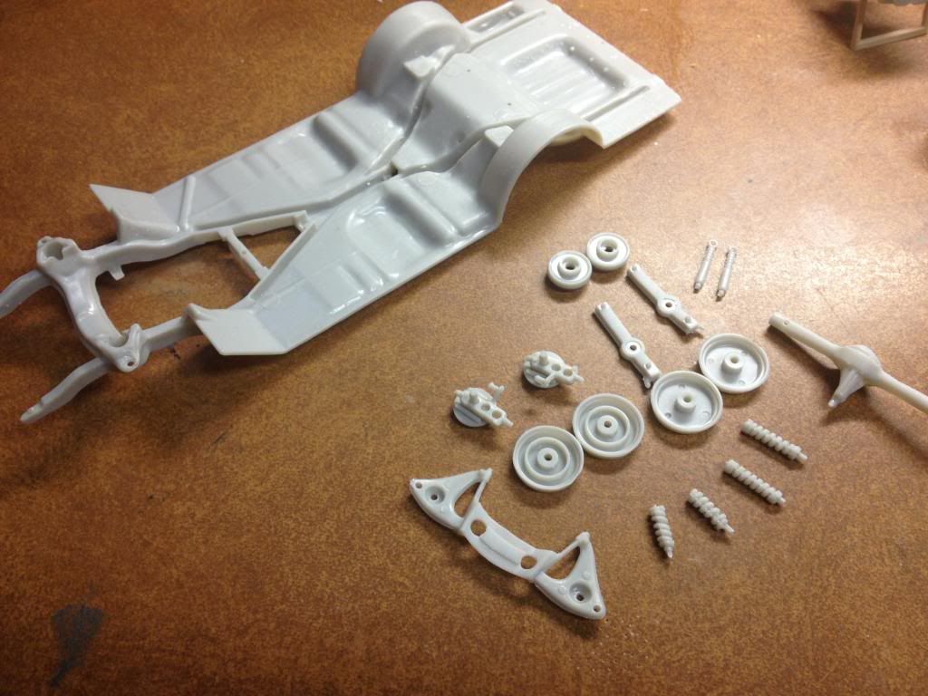

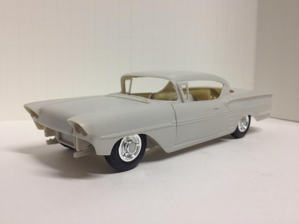

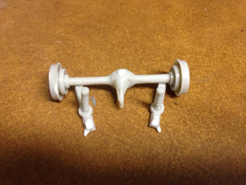

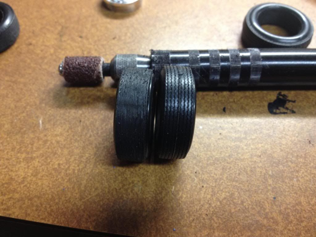

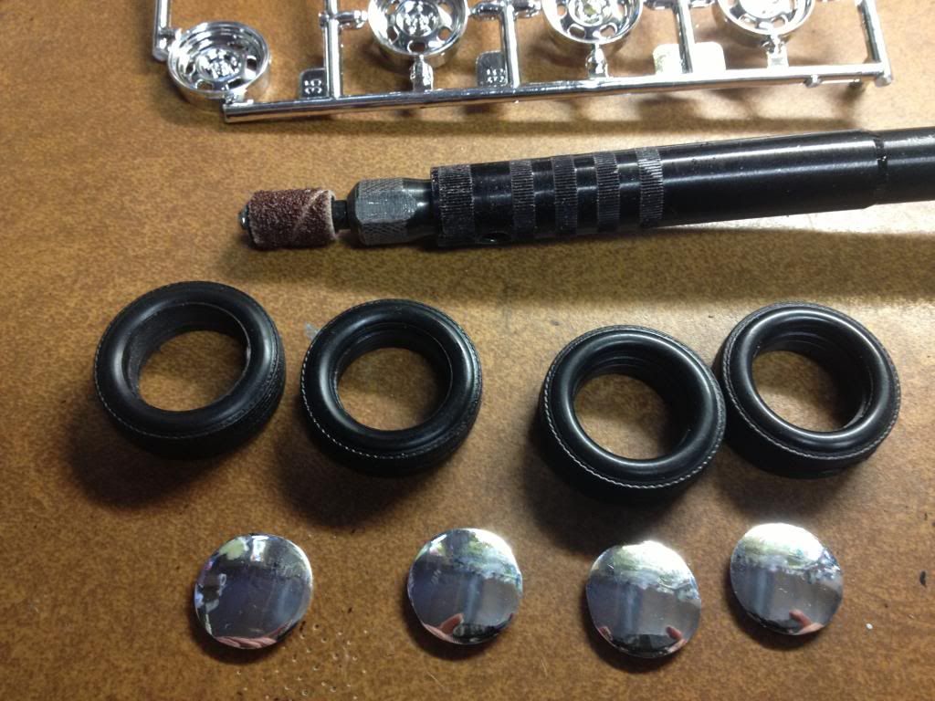

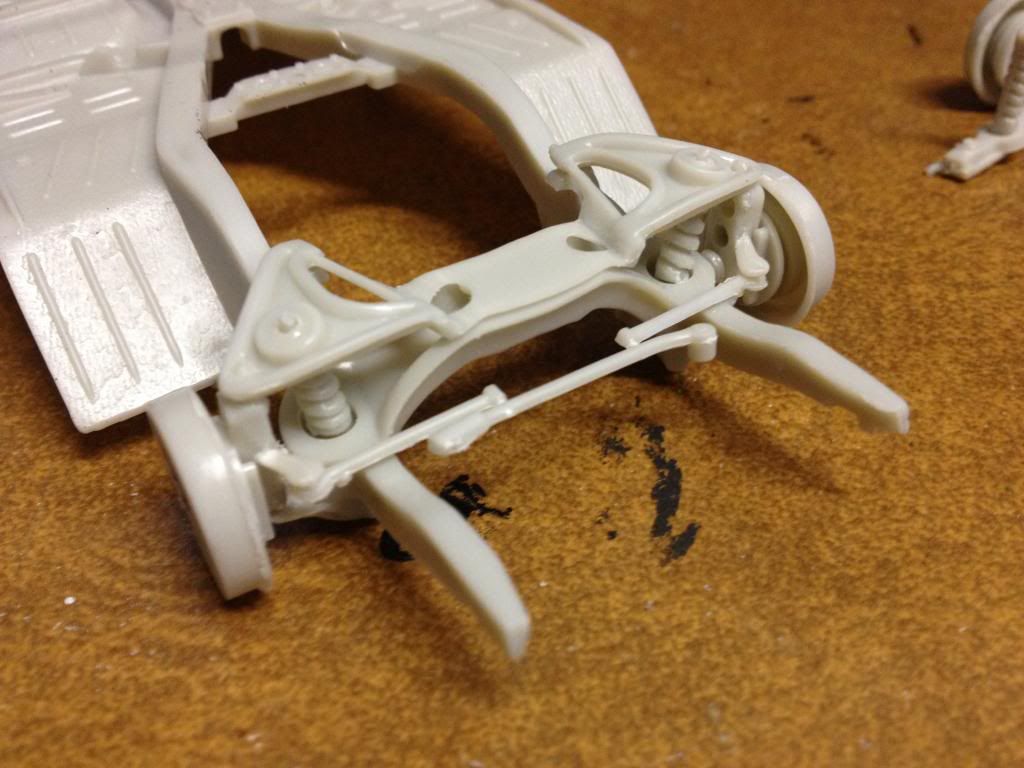

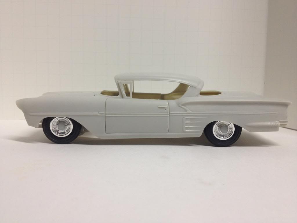

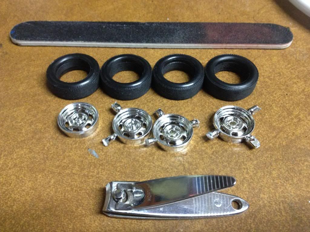

cchapman195 Posted January 1, 2014 Author Share Posted January 1, 2014 Well it has been bit since I added a new progress report. I decided that the majority of you will know how to sand and prep your parts so I did not want to fill up this by putting a bunch of material that most are familiar wit. I did all ready cover how I do my prep previously if any newer builders needed assistance. So I spent the last week and a half prepping all parts and getting them ready for paint to move ahead. So on to my progress as of this point. I like to mark in pink each part that is done with all sanding and gap prep. I then mark sub assembly pieces that were put together in green so I can keep track of what I already glued together. I will now start to put the chassis together. Some parts will be mounted others will be assemble but installed at a later time. Front suspension assembled and attached to the frame. Chassis is ready for paint. A quick mock up assures the body fits. All tires sit on the ground. I am using tires and wheels out of my parts box. This is so I can use the disk wheel covers. It required me to use my dremel to open the inside of the tires so the new rims will fit. I also use the dremell on the tread of the tires to show wear and tear. Again I use toe nail clippers to remove the nubs from the rims I then use a sharpie to color the bare plastic showing where the sprue was attached. http://i1166.photobucket.com/albums/q604/cchapman195/1958%20Chevy%20Impala%20MCM%20build/IMG_1781_zps52f81b3e.jpg I use a file and sanding pen by 3m to remove the chrome plating were the glue will attach the parts together http://i1166.photobucket.com/albums/q604/cchapman195/1958%20Chevy%20Impala%20MCM%20build/IMG_1782_zps94a3e495.jpg Tires and wheels are finished. http://i1166.photobucket.com/albums/q604/cchapman195/1958%20Chevy%20Impala%20MCM%20build/IMG_1783_zpsbe17301f.jpg Time for the interior. I put the front seat in and used a brown sharpie to mark the outside of the front seat. Then I put down masking tape. http://i1166.photobucket.com/albums/q604/cchapman195/1958%20Chevy%20Impala%20MCM%20build/IMG_1784_zps2dd1f70c.jpg I then cut out the tape leaving the inside of the seat area. This way I can put on the flocking but still have a flat clean srface for the seat to sit and the glue to weld the seat to the floor pan. http://i1166.photobucket.com/albums/q604/cchapman195/1958%20Chevy%20Impala%20MCM%20build/IMG_1785_zps86d4d69c.jpg After sanding and matching everything up on the doors I used Plasti weld to weld the door panels to the exterior door pieces. http://i1166.photobucket.com/albums/q604/cchapman195/1958%20Chevy%20Impala%20MCM%20build/IMG_1786_zpsbd9221cc.jpg Interior parts are ready for primer. These will be primed as I will be doing some taping and want to make sure the paint grabs tight http://i1166.photobucket.com/albums/q604/cchapman195/1958%20Chevy%20Impala%20MCM%20build/IMG_1787_zps4e4b28a2.jpg Now that most parts are ready for paint I will stop now and return after I have some painting done. Thanks again for tagging along. Quote Link to comment Share on other sites More sharing options...

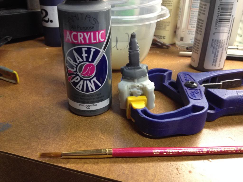

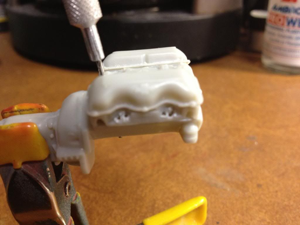

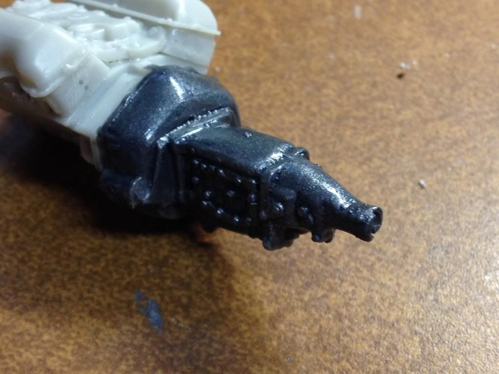

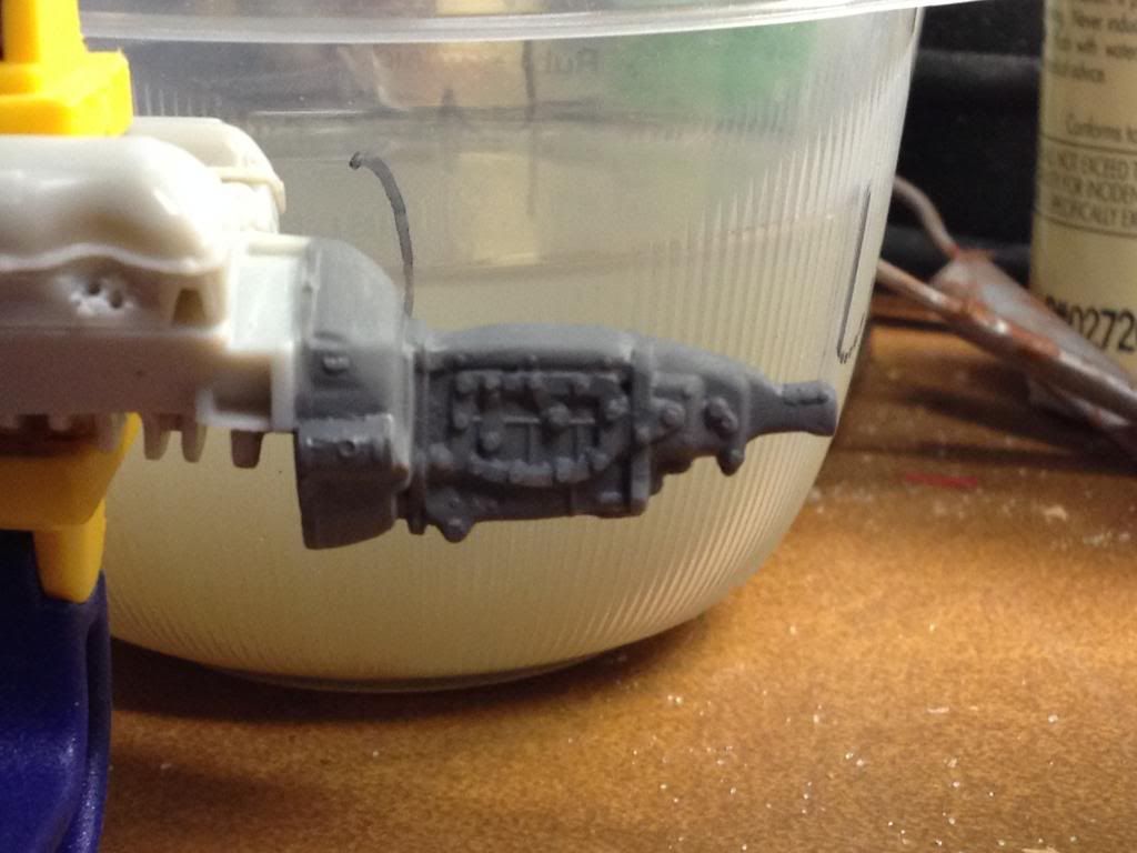

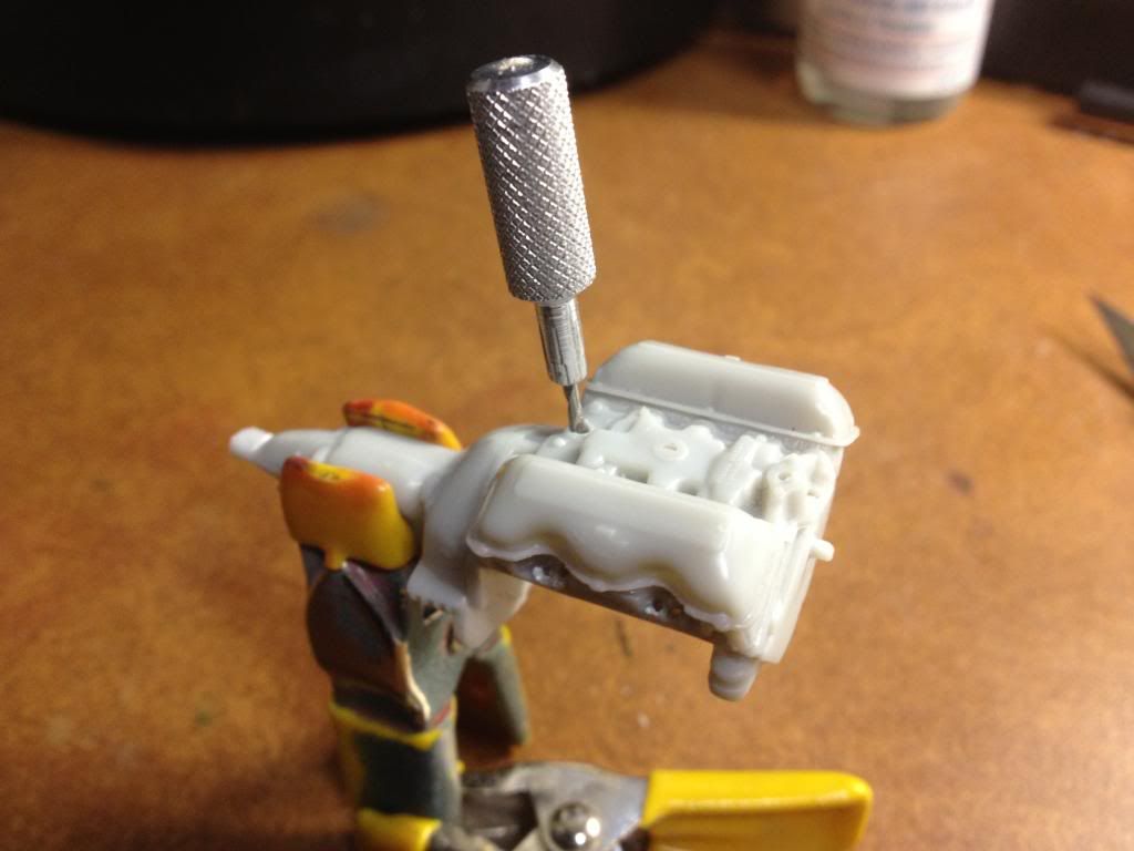

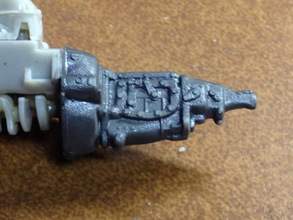

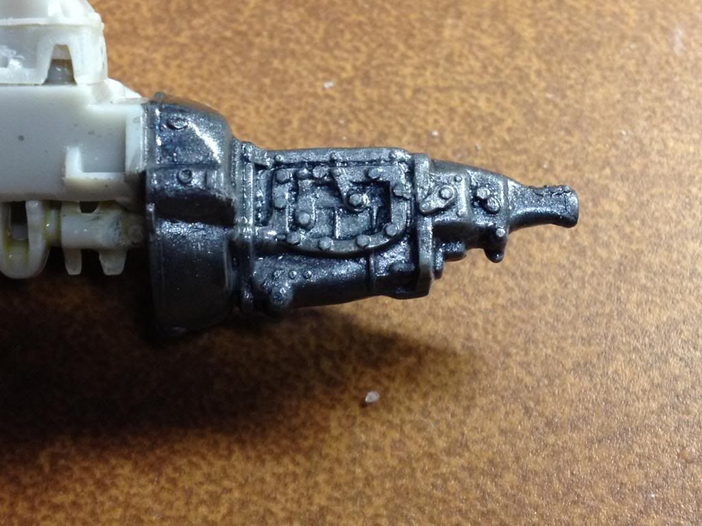

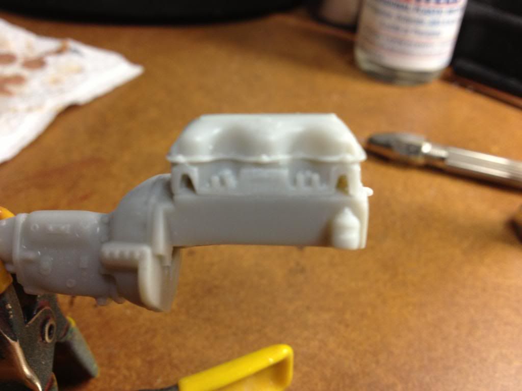

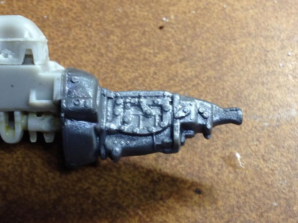

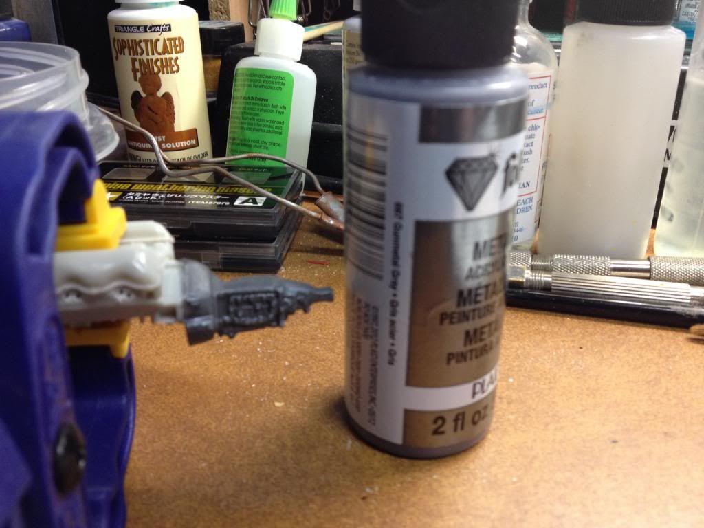

cchapman195 Posted March 18, 2014 Author Share Posted March 18, 2014 Okay people. It has been a while since I did and update. My comp crashed and I am just now able to continue. I must however, mention I lost a lot of my pics but have video's from my you tube channel to fill in the lost segments. I do hope this will help and some of you may have already seen them. Sub assembly on motor is done I drill a hole for my distrubitor Ready for plugs. Transmission is ready for paint I start with medium gray I then use a sterling silver wash I dry with hairdryer I put a satin polyurethane coat on another black wash final results Quote Link to comment Share on other sites More sharing options...

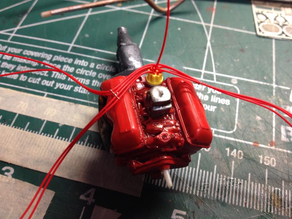

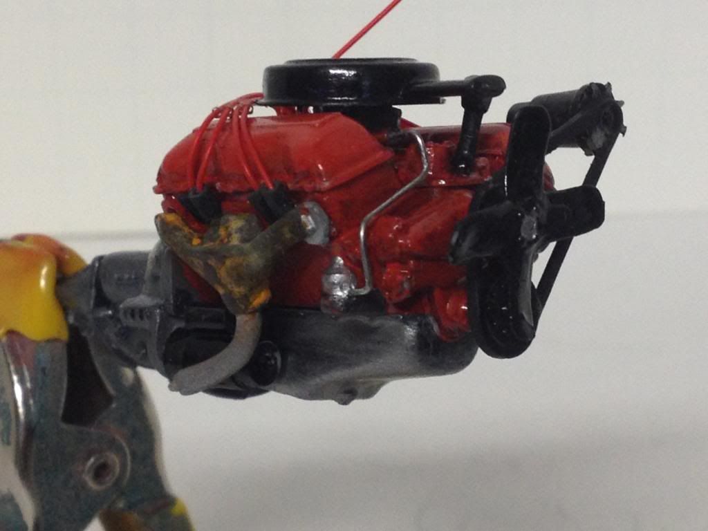

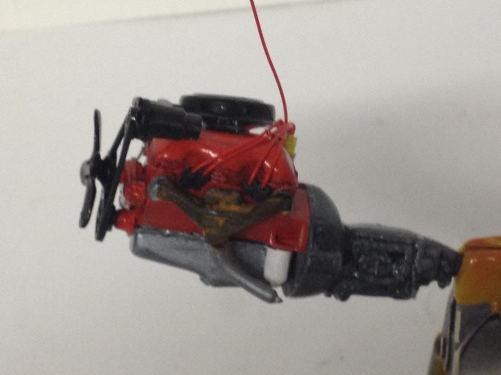

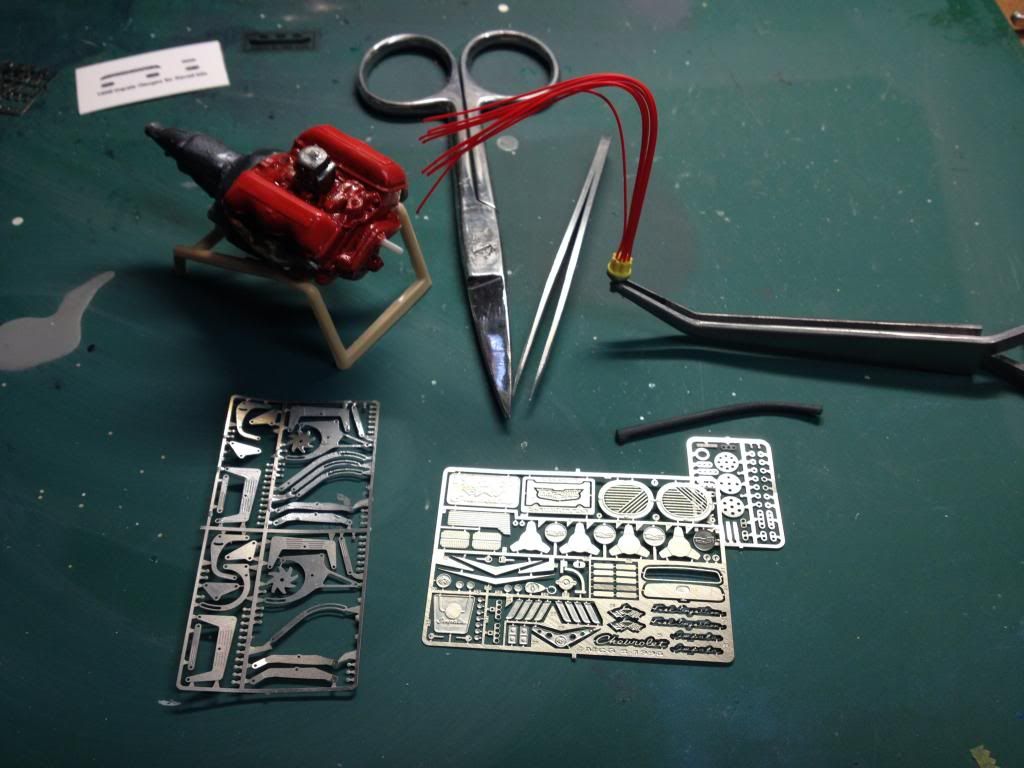

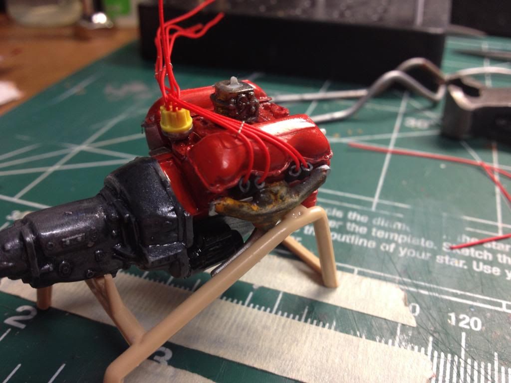

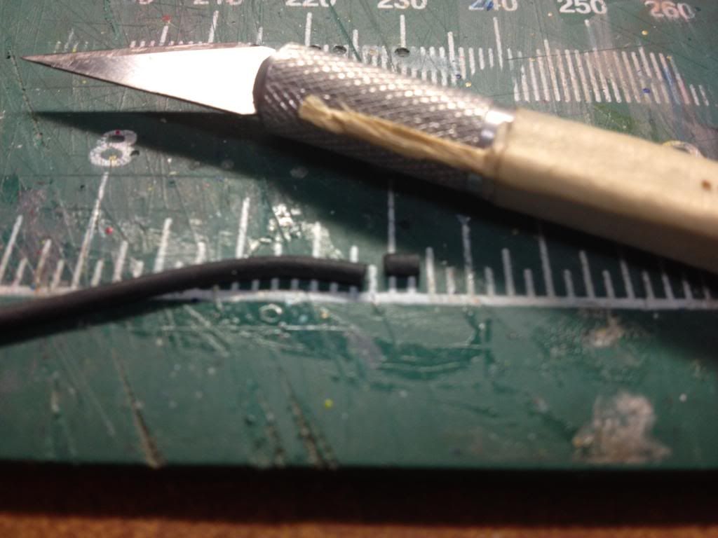

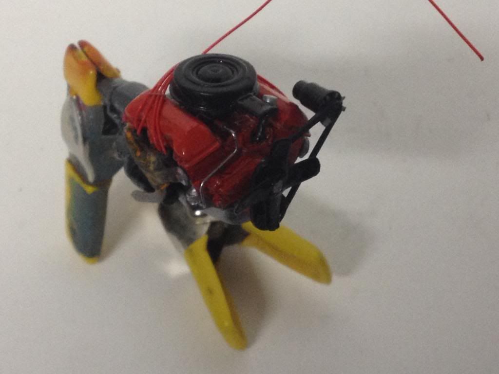

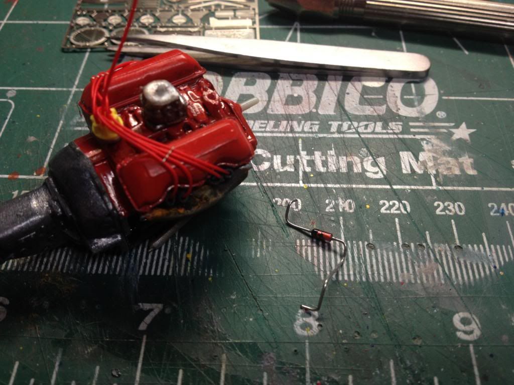

cchapman195 Posted March 18, 2014 Author Share Posted March 18, 2014 Okay. Time to start with the motor. I painted it motor red by Apple Barrel. Time to detail the motor Plug boots Wire ties from the Photoetch set. applied into pre drilled holes Exhaust manifolds are now ready for paint Different browns and flat black make up for a used exhaust Exhaust manifold added A few completed motor pics. Now a fuel line and filter will be added Completed Fuel and spark plug wires. http://i1166.photobucket.com/albums/q604/cchapman195/1958%20Chevy%20Impala%20MCM%20build/IMG_1844_zps845cba9b.jpg Well that does it for the motor for now. Up next Chassis. Quote Link to comment Share on other sites More sharing options...

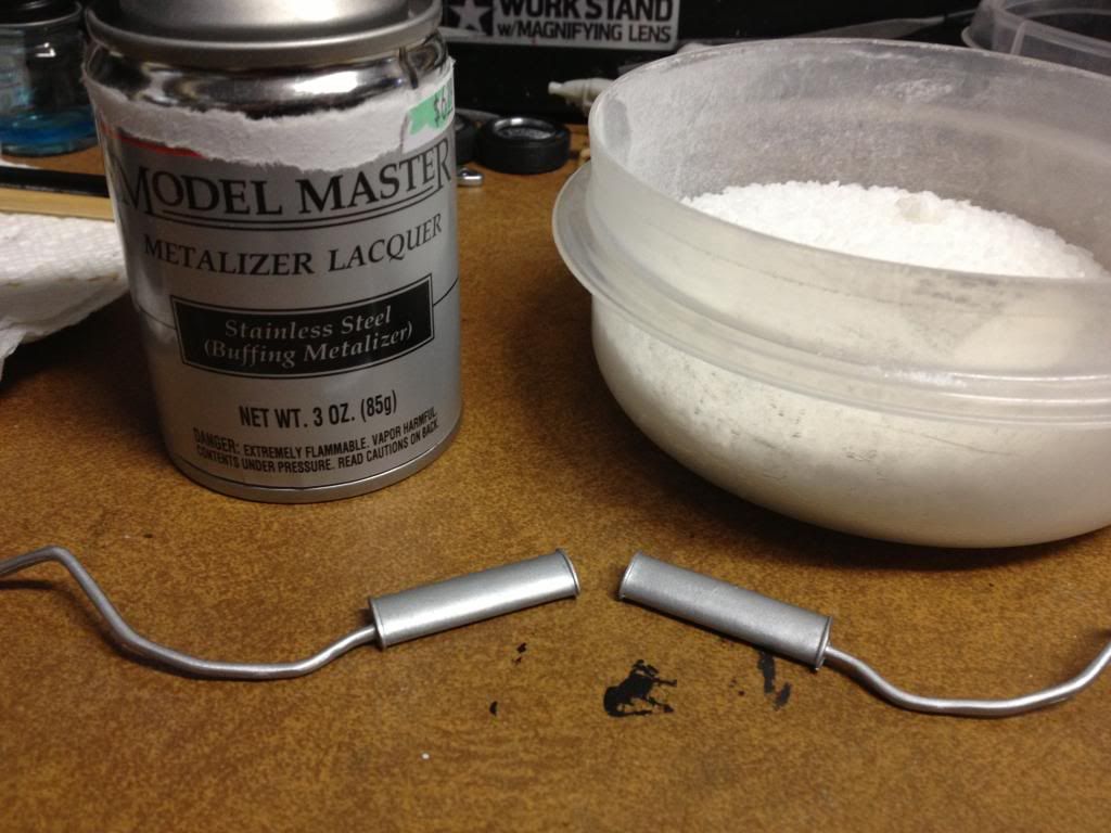

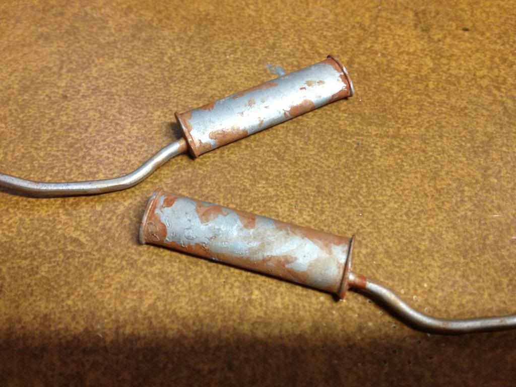

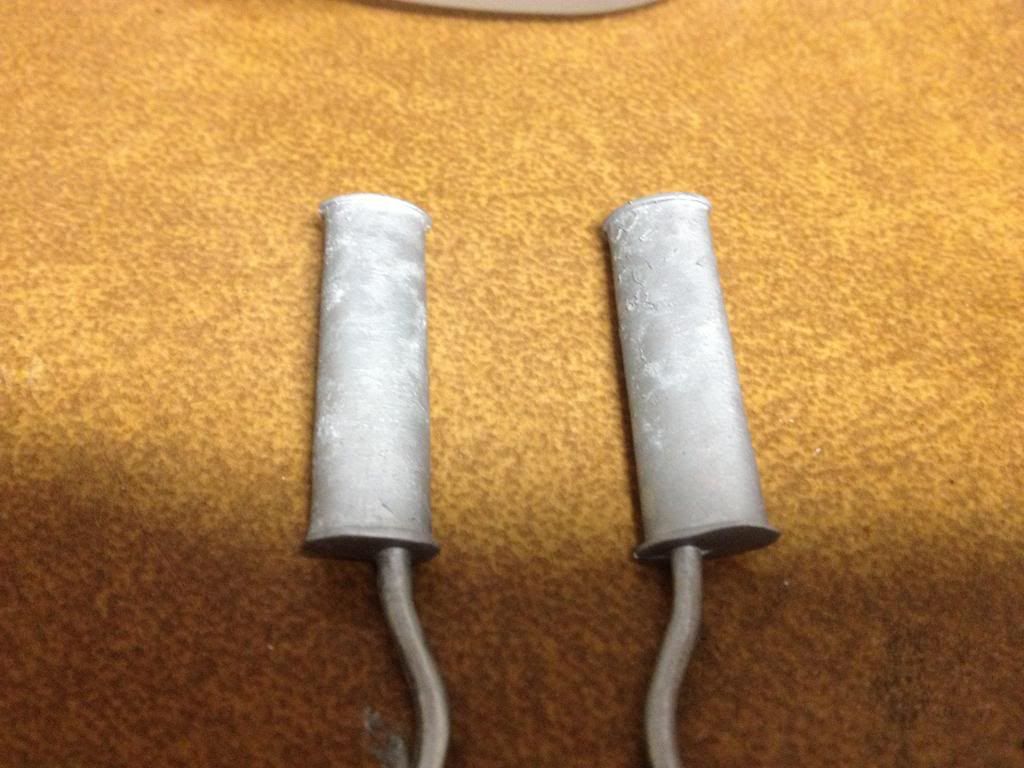

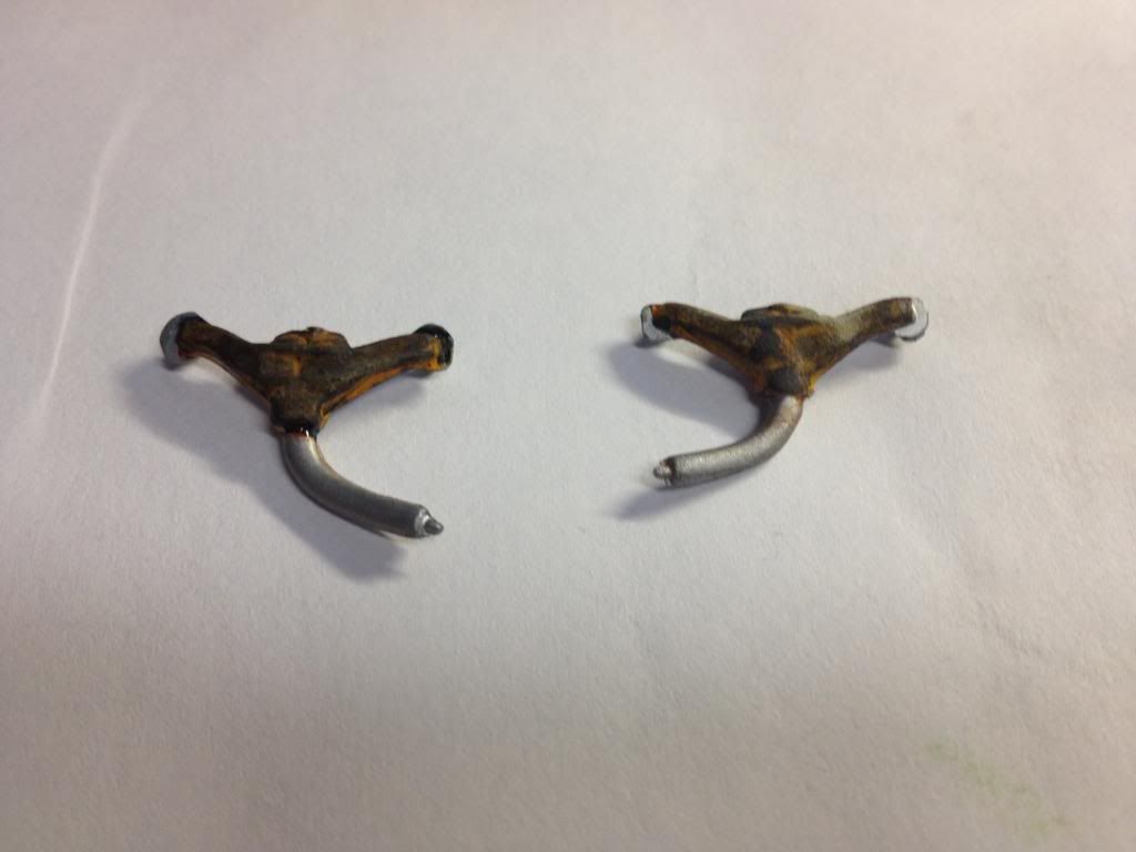

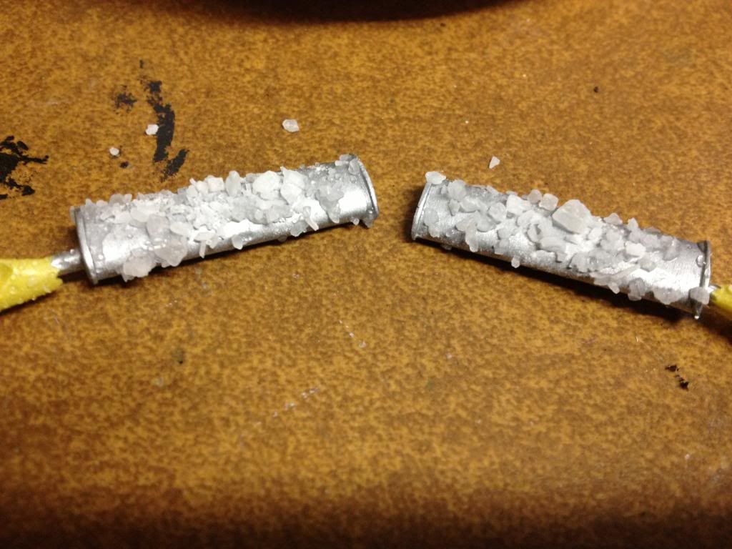

cchapman195 Posted March 19, 2014 Author Share Posted March 19, 2014 Time for chassis and installing the motor. Time for chassis. I spray stainless steel onto exhaust parts I use the salt method Water and salt Then light mists of satin clear Remove salt under running water It now looks oxidized A little earth brown acrylic thinned with water. White glue placed so I can remove after paint so it has a clean plastic for the glue to stick. Rear suspension in sub assembly. Sub assembly complete White glue placed for glue line. http://i1166.photobucket.com/albums/q604/cchapman195/1958%20Chevy%20Impala%20MCM%20build/IMG_1792_zpsa1f4ebc8.jpg Flat and gloss black paint for chassis http://i1166.photobucket.com/albums/q604/cchapman195/1958%20Chevy%20Impala%20MCM%20build/IMG_1795_zpsd2ddb13f.jpg Mix ratio of flat black and Floor polish for thinning. A 50/50 ratio seems to work well. http://i1166.photobucket.com/albums/q604/cchapman195/1958%20Chevy%20Impala%20MCM%20build/IMG_1796_zps43adbbf6.jpg Have to spray the bottom of the interior tub to match chassis. http://i1166.photobucket.com/albums/q604/cchapman195/1958%20Chevy%20Impala%20MCM%20build/IMG_1798_zps8cf15fc4.jpg Spray at 23 PSI http://i1166.photobucket.com/albums/q604/cchapman195/1958%20Chevy%20Impala%20MCM%20build/IMG_1799_zps4641e0f8.jpg I use a hair dryer to dry after painting. http://i1166.photobucket.com/albums/q604/cchapman195/1958%20Chevy%20Impala%20MCM%20build/IMG_1800_zps6c387b2d.jpg Rear housing, suspension and chassis all painted. I have removed the white glue so I have a clean place to glue the parts together. I do this by rubbing it off or using a toothpick to scrape it off. http://i1166.photobucket.com/albums/q604/cchapman195/1958%20Chevy%20Impala%20MCM%20build/IMG_1802_zpsc301ec4c.jpg I now use chalks to weather the chassis http://i1166.photobucket.com/albums/q604/cchapman195/1958%20Chevy%20Impala%20MCM%20build/IMG_1817_zps3c4e5891.jpg That will take care of this segment. Up next will be what I have for the interior. Be back soon. Quote Link to comment Share on other sites More sharing options...
