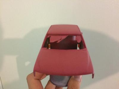

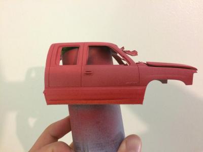

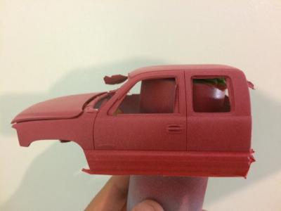

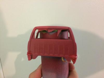

addicted2modeling Posted September 19, 2014 Share Posted September 19, 2014 Hello, I just applied a 3rd, "light mist" coat on my Silverado model kit. It has been primed with duplicolor's gray primer and base coated with 3 light mist coats of duplicolor's GM, victory red paint. For some odd reason, it appears to be pinkish after drying. Is this normal for the 3 light mist coats that I've applied? Would it be red after a heavy coat application? I sprayed it on as red in the light mist coat phase and it dries up as pinkish. Quote Link to comment Share on other sites More sharing options...

Chuck Most Posted September 19, 2014 Share Posted September 19, 2014 Right now its been raining like crazy here. That might be the problem- humidity will cause the paint to "blush" like what's happening in the pics. The paint will dry dull and several shades too light. Quote Link to comment Share on other sites More sharing options...
my80malibu Posted September 19, 2014 Share Posted September 19, 2014 Tony, You Might want to try, and find a place to paint with Lower Humidity. High humidity can cause paint problems, of course in Houston Theres probably not many dry rooms, around this time of year. I dont Know if thats what you have going on with this paint job. The coverage does look very Even, so maybe the Heavier coats might work. Quote Link to comment Share on other sites More sharing options...
slusher Posted September 19, 2014 Share Posted September 19, 2014 That might be the problem- humidity will cause the paint to "blush" like what's happening in the pics. The paint will dry dull and several shades too light. Chuck has a great point and grey primer will change the color sometimes. Tamiya white primer is the best and works with Duplicolor.. Quote Link to comment Share on other sites More sharing options...
