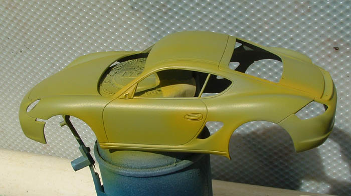

ismaelg Posted April 13, 2007 Share Posted April 13, 2007 Hello, Last time, we were here: I forgot to take a pic of the primer ready for color. But basically, I don't move forward until the primer is perfectly even and smooth. I sand it smooth to an almost polished finished. I used Plastikote T235 followed by a coat of Cobra Colors Moon Mud primer. I have seen top end shops applying colored primer between the initial primer and color. What I did was to lay a very light color coat that will be the foundation for all other color coats. I also did something different this time: I "spot painted" the areas I know are succeptible to rub throughs while polishing. I am usually very aggresive in polishing, resulting in rubbing thru clear, paint and primer and having to start all over again. These areas are the door handles, A pillars, wheel well bulges (both back and front), fuel filler door and the back hatch ridge. I will now start color coats, but since this is red plastic, I'll take it very Very VERY easy to slowly build up color and prevent any bleeding. Let me know if you like these in progress installments... Thanks, Quote Link to comment Share on other sites More sharing options...

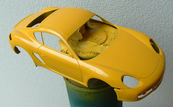

ismaelg Posted April 19, 2007 Author Share Posted April 19, 2007 Not much progress this week. The body has 6 color coats. A few more will be added before final inspection and correction of any problem before clear. Thanks, Quote Link to comment Share on other sites More sharing options...
hookedonplastics Posted April 19, 2007 Share Posted April 19, 2007 Izzer, is that paint laying down flat? Quote Link to comment Share on other sites More sharing options...
ismaelg Posted April 19, 2007 Author Share Posted April 19, 2007 Yes Russ. Lacquer usually lays down flat. The important thing is to have it smooth and even, not shiny. Polishing will bring it up to life eventually. Thanks, Quote Link to comment Share on other sites More sharing options...

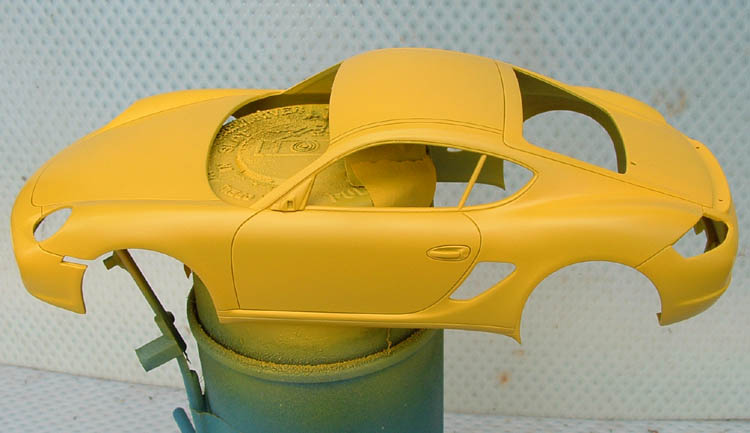

ismaelg Posted April 26, 2007 Author Share Posted April 26, 2007 Hello, Not much progress this week in this or any other model for that matter. About 7 or 8 color coats, gave it a few days to dry and inspected over the most powerful light you can get; the tropical sun at mid Morning with polarized sunglasses. A few minor teeny weeny micro flaws were found and fixed, then went all over the body with a 6000 polishing cloth and plenty of water. Then a good "shower" under tap water and let it air dry/ bake in the sun for about 10 minutes. Then... one final coat of color with 50/50 thinned paint. Now it is ready for clear... No sign of bleeding so far. The body is red plastic and the spoiler, mirrors and grilles are black plastic. Color is uniform in all parts. Thanks, Quote Link to comment Share on other sites More sharing options...

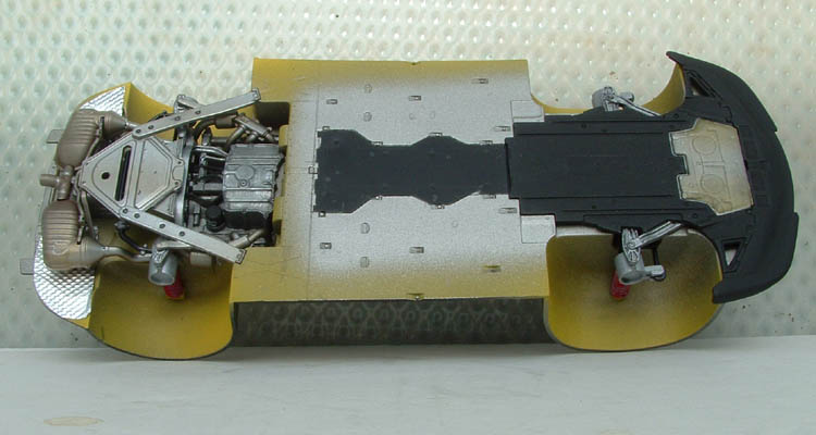

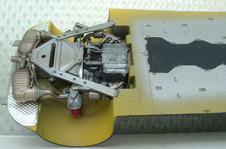

ismaelg Posted May 7, 2007 Author Share Posted May 7, 2007 The body was cleared and it is taking a nap of at least 2 or 3 weeks before polishing. After that I started working on the underside of the car. These cars have panels covering the bottom, so they are pretty much all black. But if those panels are removed, you can see some overspray from the painting process. I painted this model as if some panels were removed. I also added heat insulation over the mufflers. Now it is on to brakes, followed by interiors Still a long way to go, but slowly getting there... What do you think? Thanks, Quote Link to comment Share on other sites More sharing options...

hookedonplastics Posted May 9, 2007 Share Posted May 9, 2007 Izzo, how did you do the pattern on the heat shield? I am lovin this build! Quote Link to comment Share on other sites More sharing options...
ismaelg Posted May 9, 2007 Author Share Posted May 9, 2007 Thanks guys! Russ, the heat shield is a piece of heavy aluminum foil. Trimmed to shape and then pressed over mesh material so the pattern gets embossed. A drop of superglue keeps it in place. Other than that and the parts box oil filter decal, the rest is 100% box stock. Currently working on the interiors. I'll post pics soon. Thanks, Quote Link to comment Share on other sites More sharing options...

MrObsessive Posted May 10, 2007 Share Posted May 10, 2007 Excellent job so far Ismael! What did you use for the exhaust insulation? The interior looks so good, at first glance I thought it was the 1:1! Quote Link to comment Share on other sites More sharing options...

MrObsessive Posted May 12, 2007 Share Posted May 12, 2007 Trimmed to shape and then pressed over mesh material so the pattern gets embossed. Okay, I see..........very clever trick! I have to give that a try sometime........ Quote Link to comment Share on other sites More sharing options...
