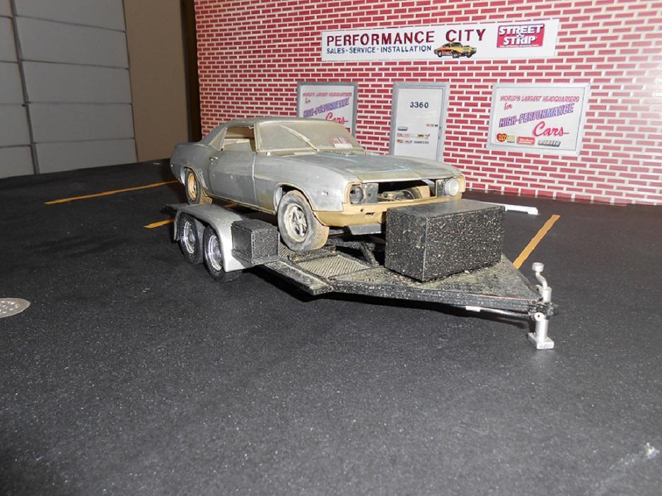

Yenkocamaro Posted January 11, 2016 Posted January 11, 2016 (edited) This is the best product I have found, to get the effect your looking for. Here is a pic of a barn find Camaro I did, including the trailer, using the Tamiya weathering kit. Not sure if this would work for your application, but I found a small spray bottle, and mixed the product with some water, and sprayed it on the car. Cheers, Lance Edited January 11, 2016 by Yenkocamaro
