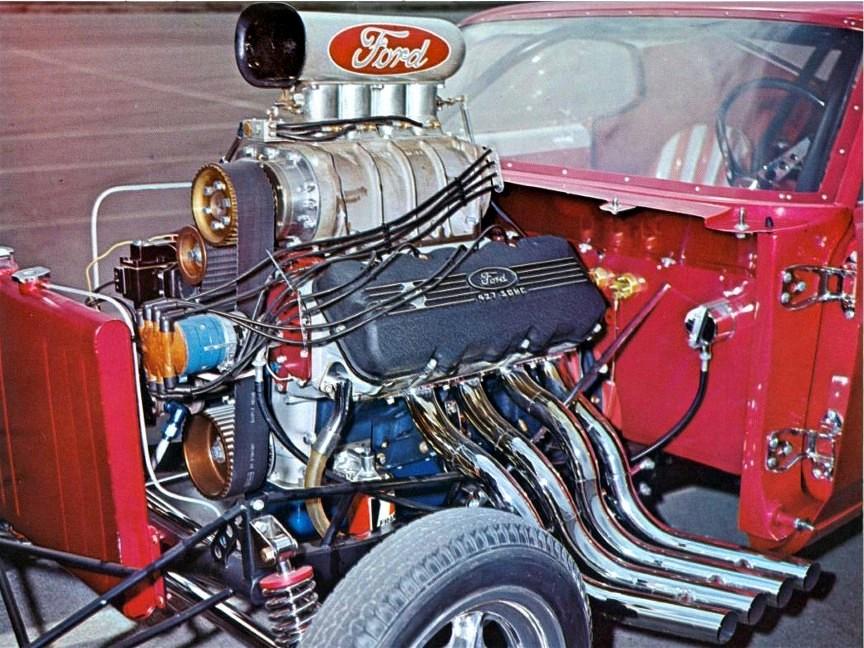

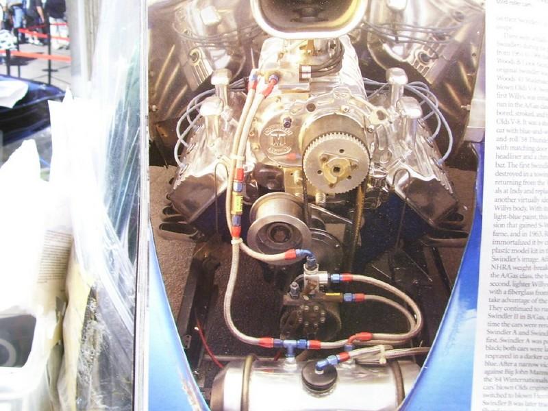

Somewhere between 1967 and 1971 the NHRA made radiators optional in supercharged applications. Keep in mind that NHRA was not the only game in town. There were many gasser groups and associations that had their own rules. Some even ran nitro!
If you look at some of the AA/GS cars you'll see that the "radiator" is actually a water tank with tubing connected to the engine block or cylinder heads. The supercharged cars did not have to idle or drive to the starting line, therefore water circulation was not necessary.

Blown_SOHC.thumb.jpg.f537d583d7d229b9ed2This Ohio George car has a tank "radiator"

Blown_392_fuel_system.thumb.jpg.73158d1dStone, Woods & Cook Has no cooling system. Match race trim?

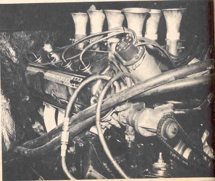

I guess it's possible to run a belt driven fuel pump and keep the water pump in place, but I have not seen pics of that. Another option is to switch the injectors for carbs and use a mechanical fuel pump but I'm not sure where those are located on a 392 hemi.

_Chain_drive_Hilborn_pump.thumb.jpg.ec5fChain drive Hilborn pump on a 426. You could do the same thing with a 392.
