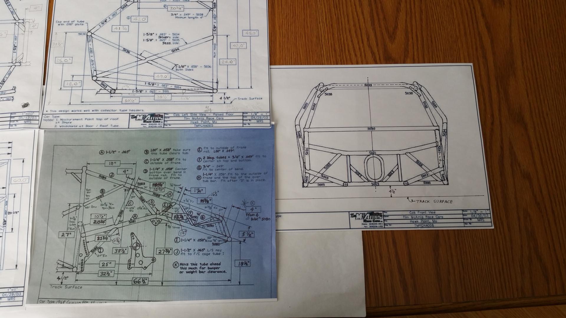

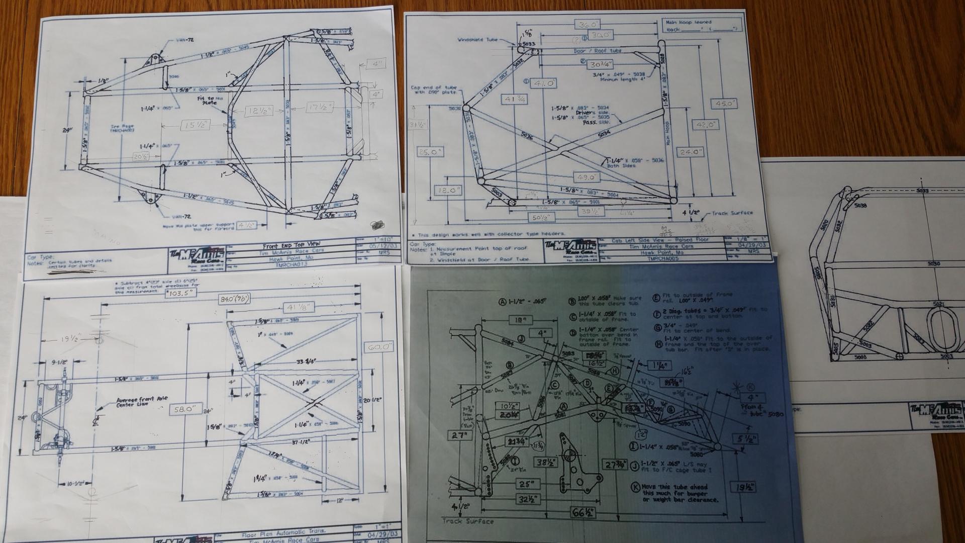

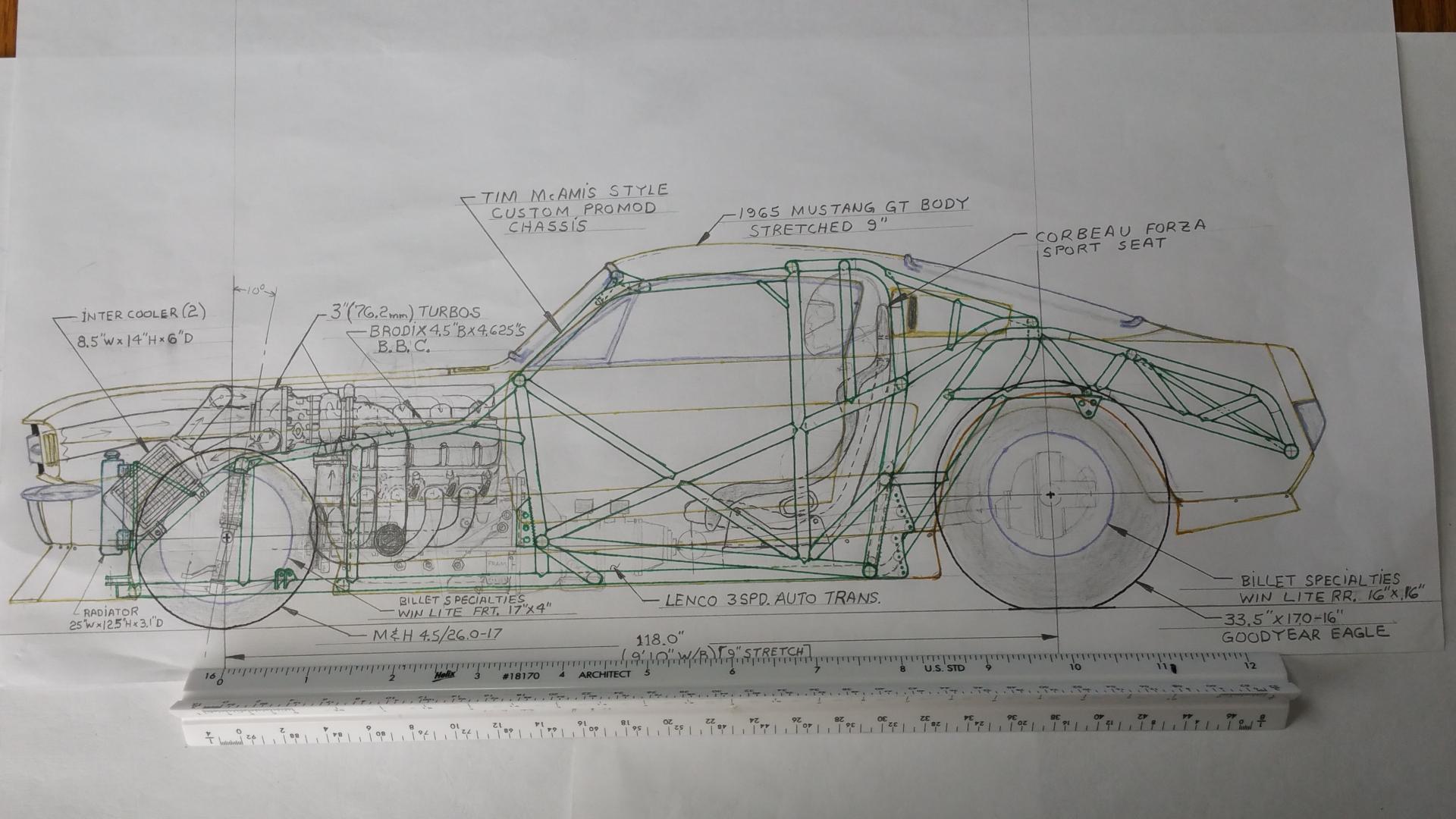

ShakyCraftsman Posted May 8, 2017 Author Posted May 8, 2017 (edited) Hey all OK...here is the new set of drawings. I think I have it figured out but, I won't know until I get the motor and turbos, they are being printed at Shapways as we speak. They are from Ron Olsen at 3d Specialties. I'm hoping they will be here by the end of this week. The first photo is a side view showing the 9"stretch.These last 2 are photos I downloaded off of the Internet. So look em over and let me know what you think. Thanks RonG Edited May 8, 2017 by ShakyCraftsman
comp1839 Posted May 8, 2017 Posted May 8, 2017 ron, before you stretch the body UN-neccissarily, you may want to check out photos from frank pompilio's '68 10.5 mustang. it may help.
ShakyCraftsman Posted May 8, 2017 Author Posted May 8, 2017 ron, before you stretch the body UN-neccissarily, you may want to check out photos from frank pompilio's '68 10.5 mustang. it may help.Hey Dave I can't find that post. I'm pretty sure I need to stretch it, there just isn't enough room with the components I'm using. I did several drawings at the stock length and no mater how I configure the turbos there isn't enough room to get it all in. I won't cut it until I have all of the components on hand.Thanks RonG
ShakyCraftsman Posted May 9, 2017 Author Posted May 9, 2017 Hey Dave Yup from that photo I can tell that I will need alot more room then that. But like I said I won't be doing anything till I have all the parts on hand. Right now I'm waiting on Shapways to finish printing them.Thanks RonG

Xx RUSTY xX Posted June 19, 2017 Posted June 19, 2017 How much power u think the quadrupole turbo would make 1,500hp???? More
ShakyCraftsman Posted June 19, 2017 Author Posted June 19, 2017 Hey Xx Rusty XxWhat quadruple turbo? The motor I'm using has 2 turbos not 4. With the right combination you could theroiticly make in the neighborhood of 2500 hp.RonG
