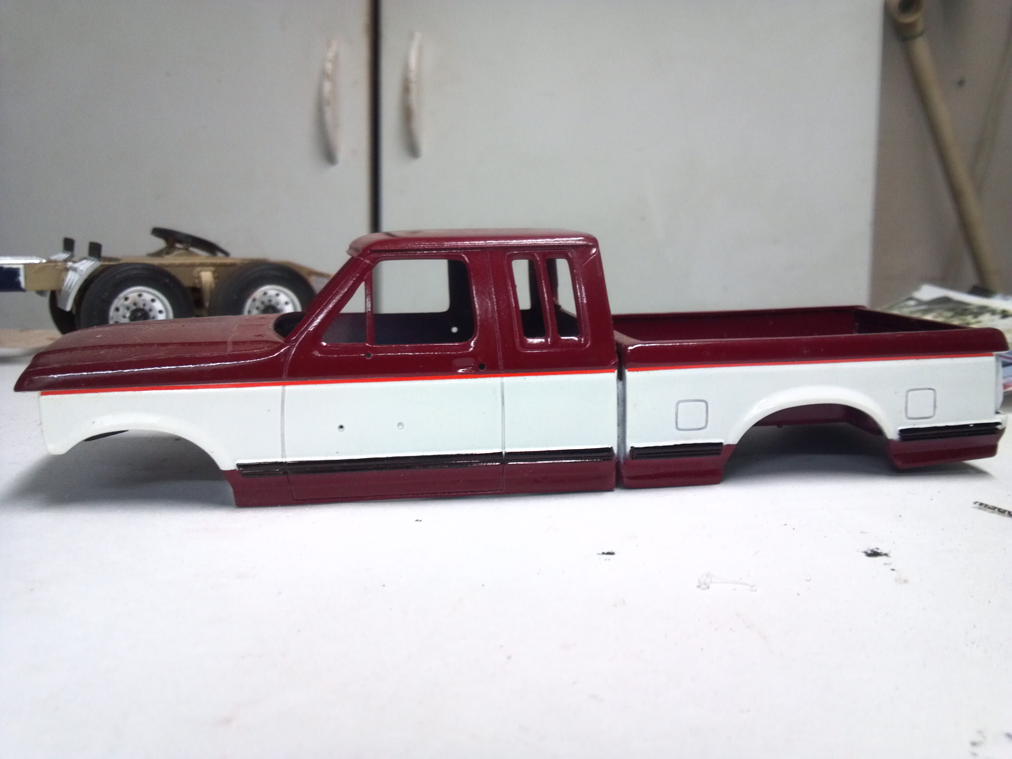

Is there an aftermarket cab out there to convert the Monogram F-350 from an extended cab to regular cab?
If not I’ll take a shot at cutting the kit cab down; anyone have any preferred techniques for neatly removing the extended cab area?

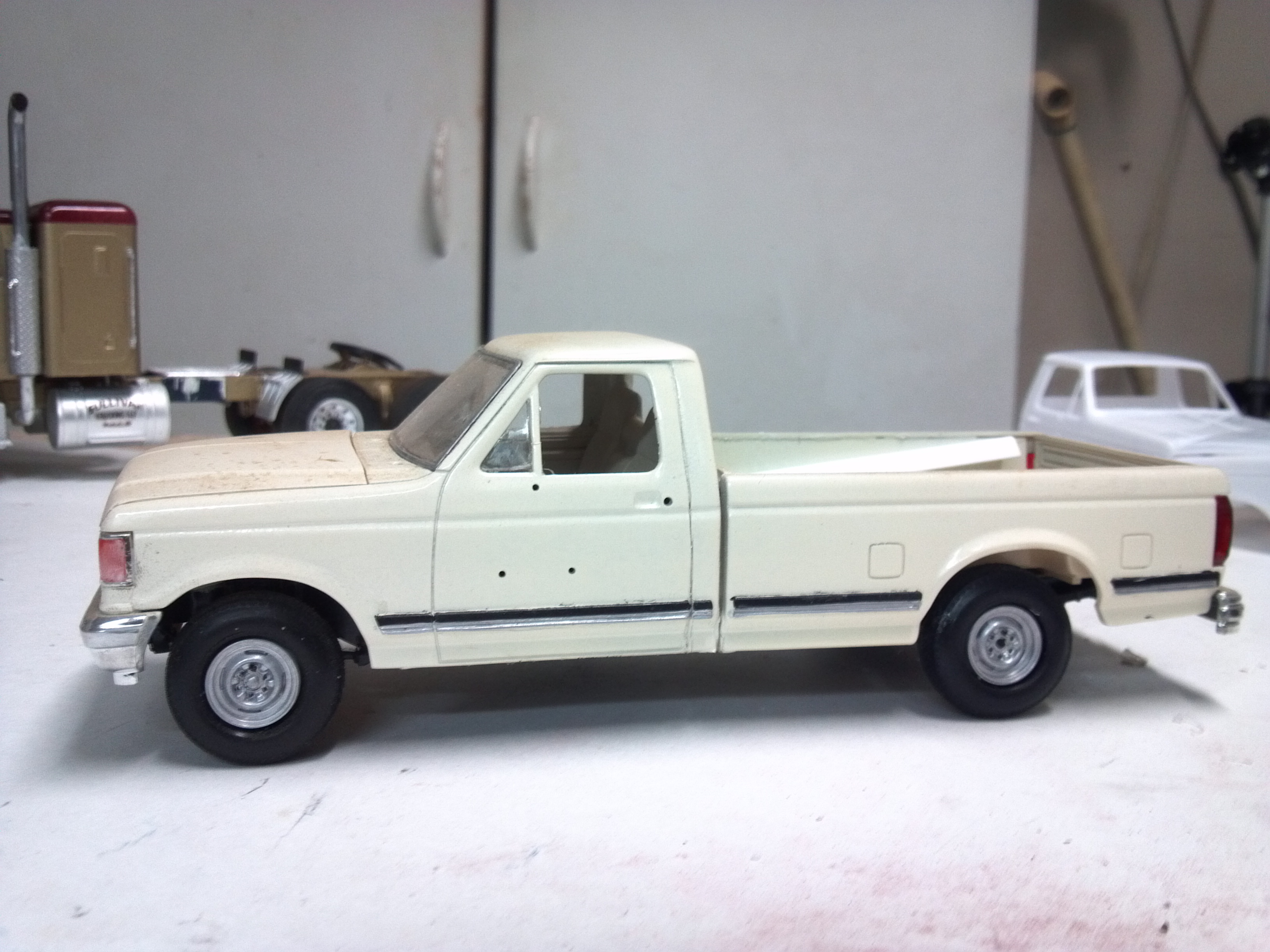

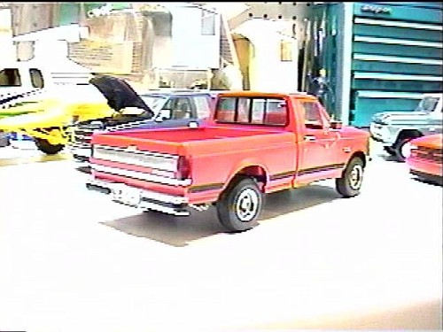

I’ve seen a resin crew cab for it but never a standard cab. I built this one when the kit originally came out in 1990 I think it was. Had to shorten the cab, the interior, the bed, the chassis, the exhaust and the fuel tank. Sorry for the really bad pics, they were taken with a potato. :)
If we ever get a sunny day here, I’ll take better pictures of it.
Edited by Ben
Ben, great job on the conversion and thanks for the photos.

I’m gonna try to get some better photos today if the sun comes out. If I do, I’ll post them here.
I just added new pics of the regular cab, short bed Ford F-150 to the album, Under Glass Pickups.

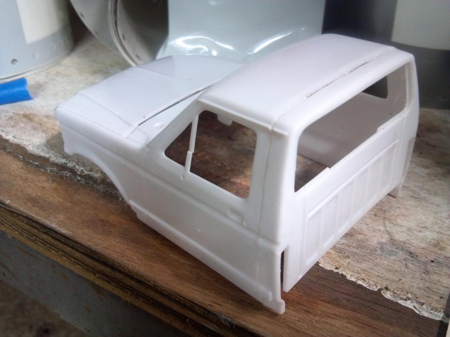

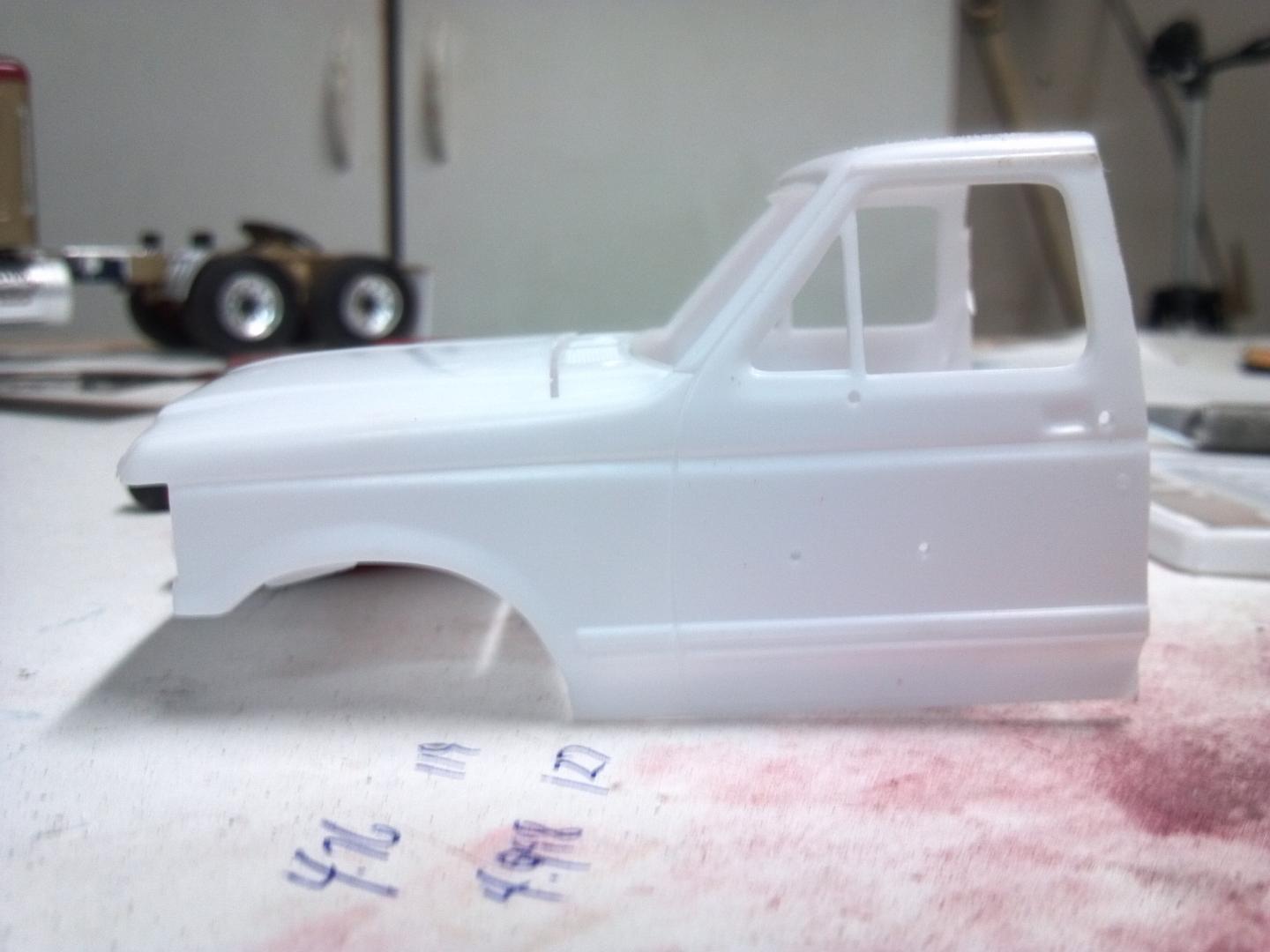

 I just cut it at the door line, that way all i have to fix isa little cut across the roof. Got a couple of reg cabs and a swb started
Edited by signguy2108
wording
Forgot to add the other cut is at the rear of the side window molding, just cut to match the door line. And chris, if u need ambulance pics (inside and out) of one of these, i've got a friend that's got a 95 model in his fleet, same cab. i'll get some pics of it tommorrow
