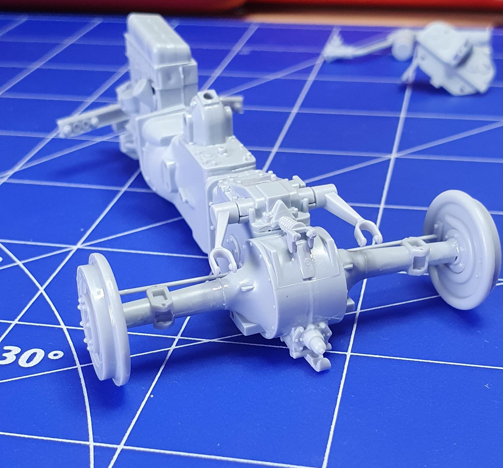

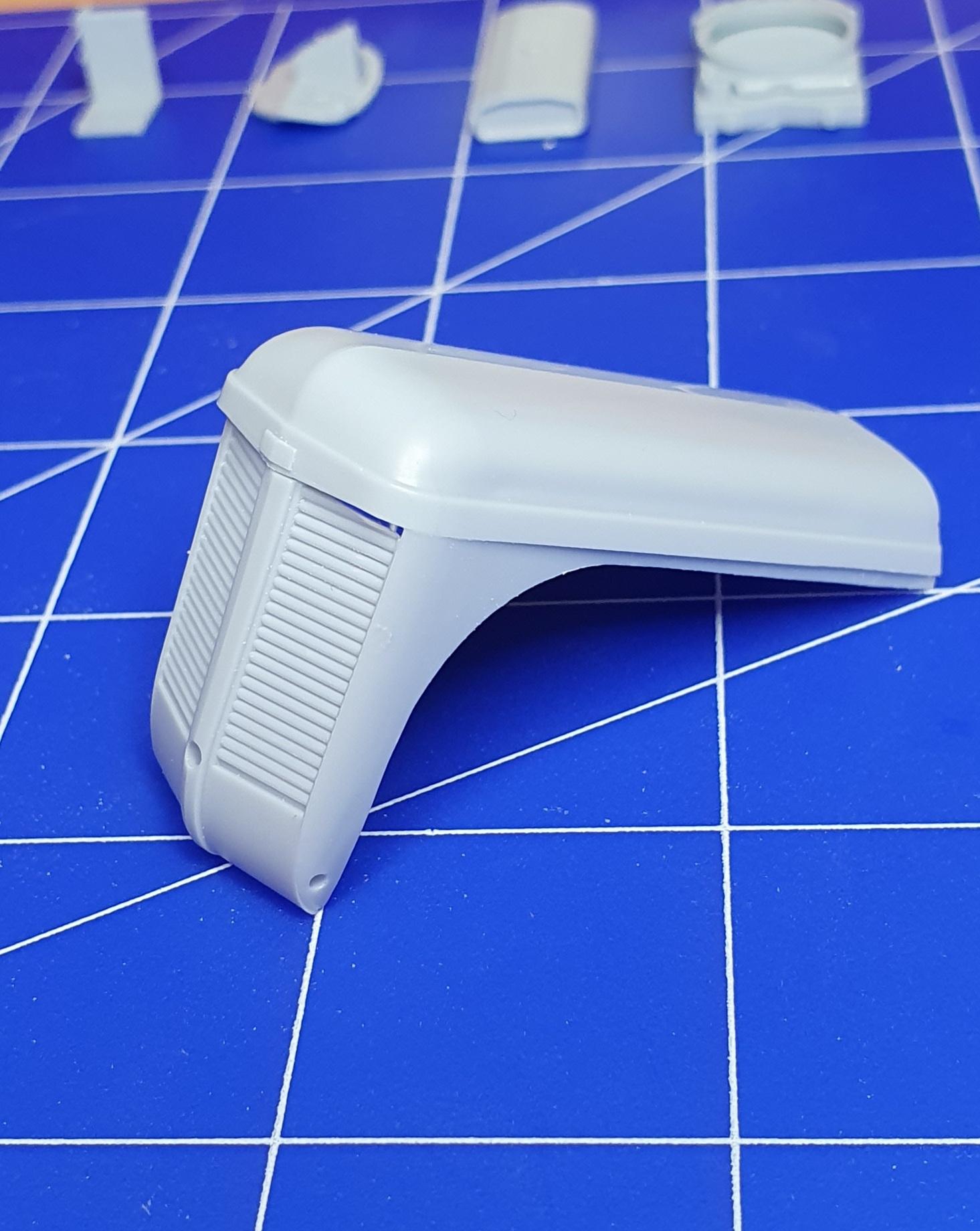

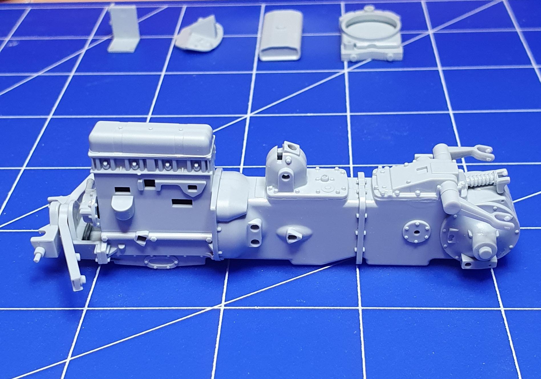

GeeBee Posted November 2, 2020 Posted November 2, 2020 With airbrushing on hold until I get the new workshop sorted, I decided to make a start on this one
kilrathy10 Posted November 3, 2020 Posted November 3, 2020 Looks like you're getting off to a very crisp start... Just that one assembly looks so clean... Awesome...

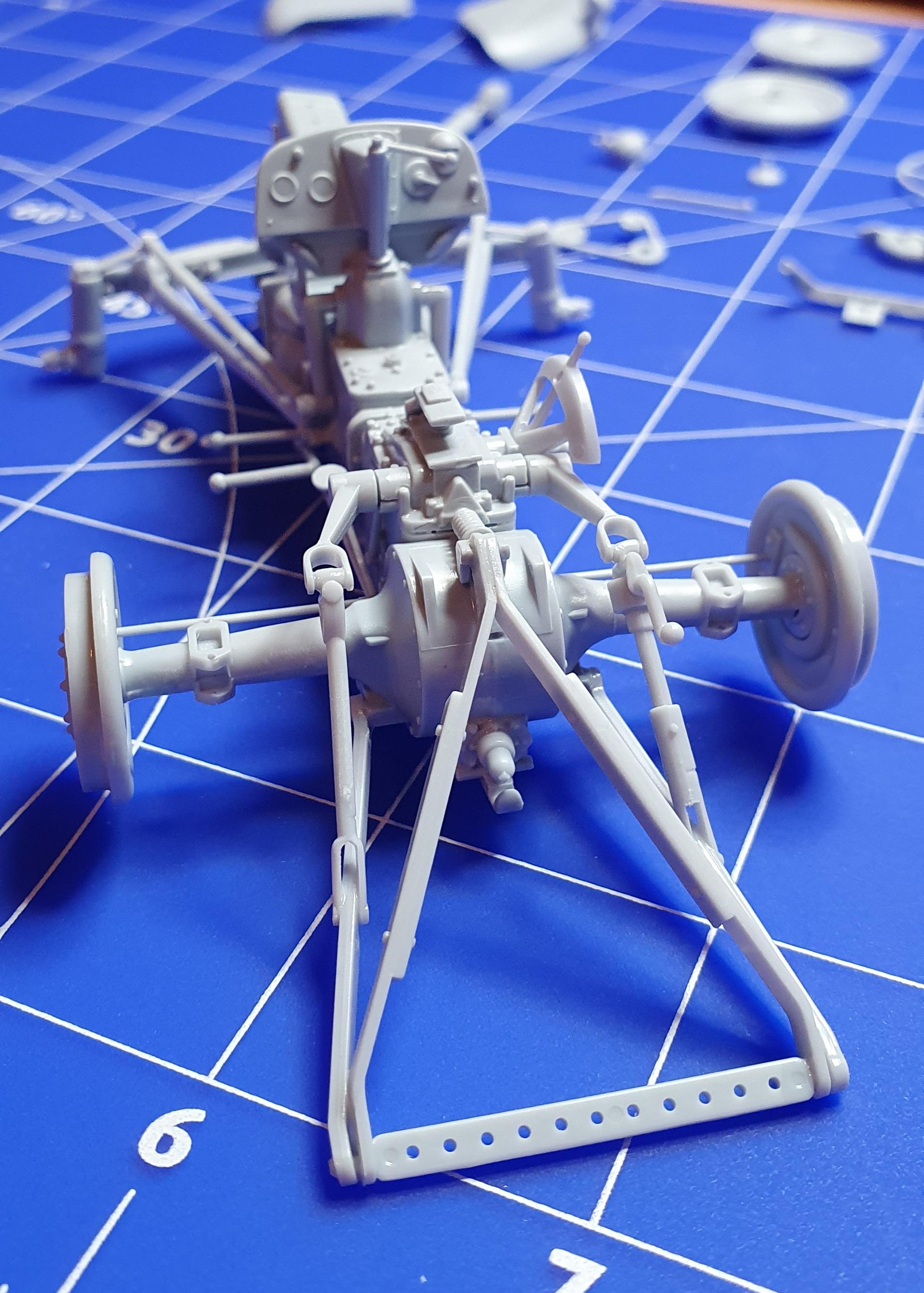

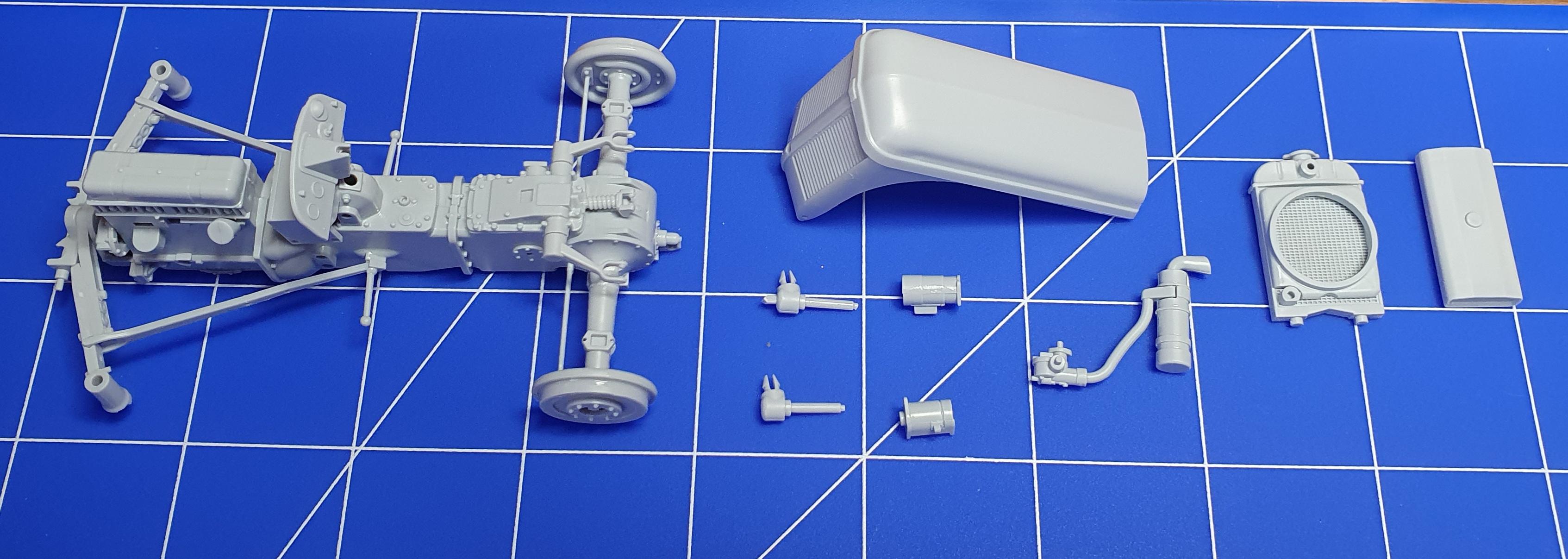

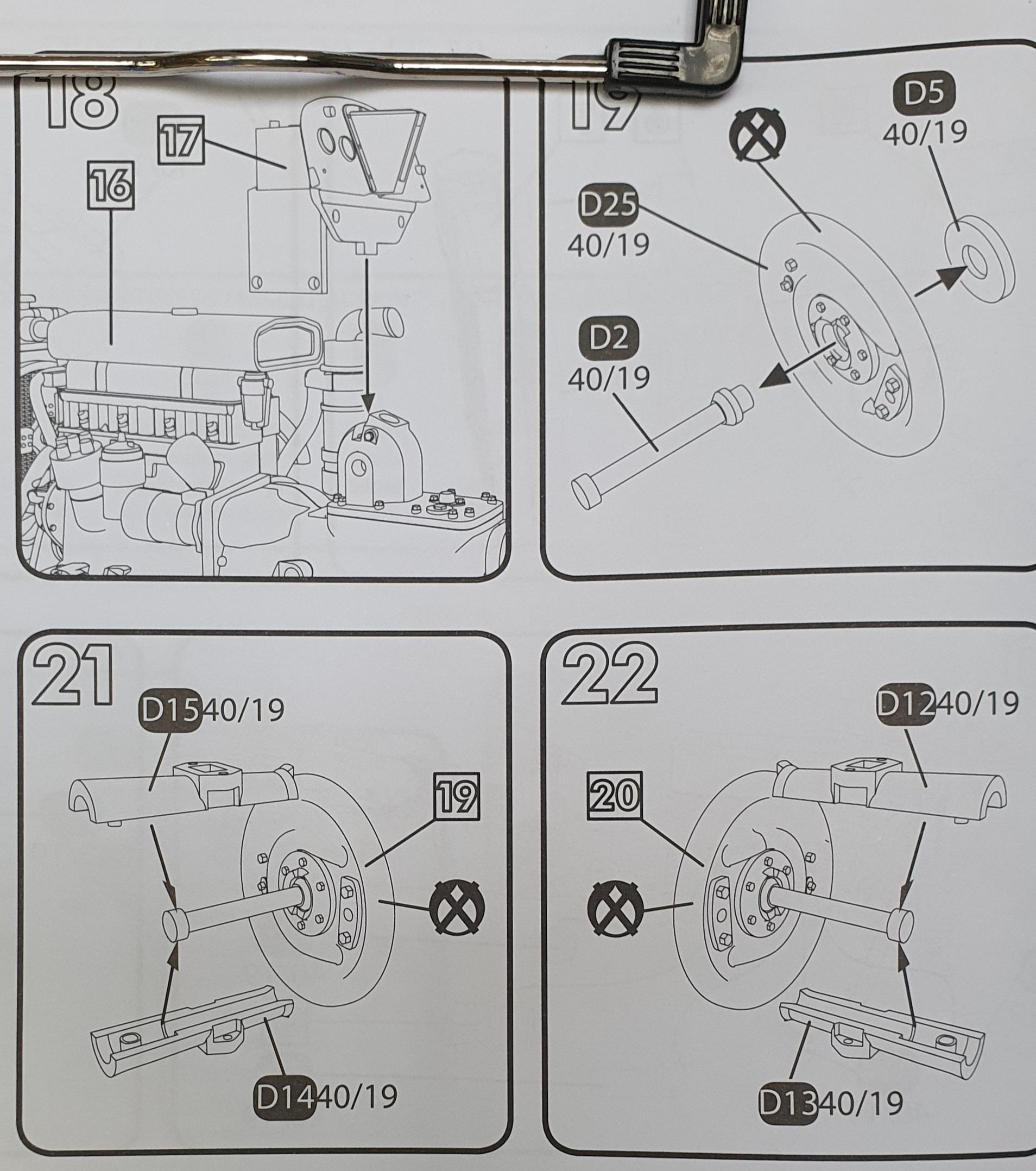

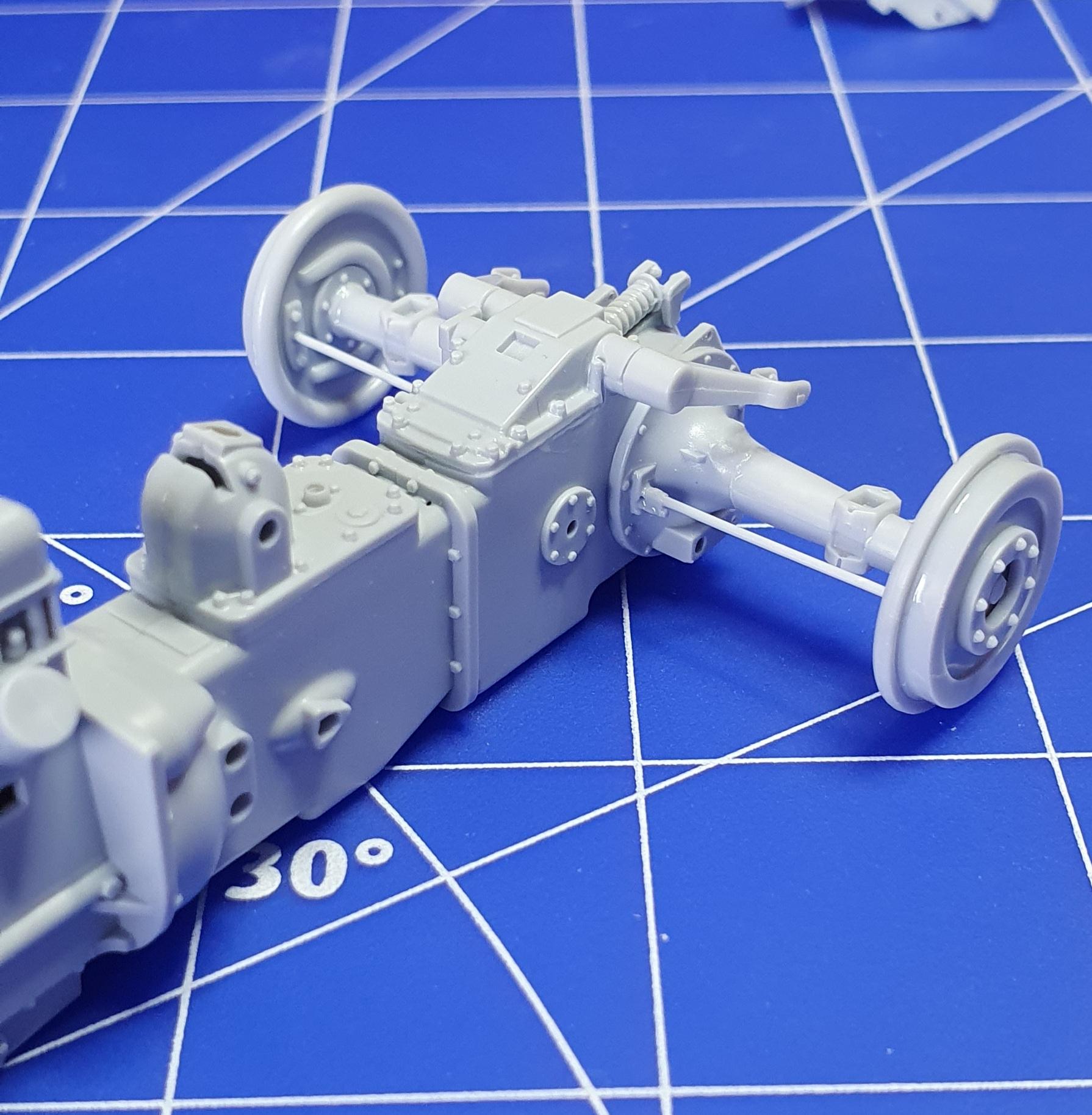

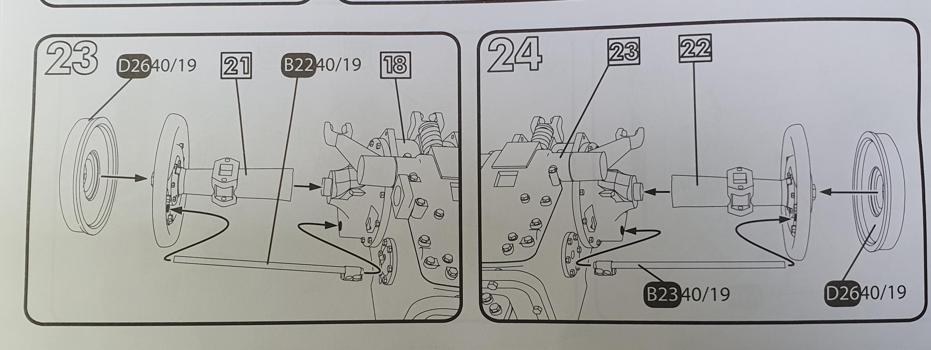

GeeBee Posted November 4, 2020 Author Posted November 4, 2020 A little more progress, while building the other Ferguson TE-20 I found that some of the instructions have been written incorrectly, for sections 23 and 24, swap the parts over, otherwise the mounting for the wheel arch and brake rods will be in the wrong place, it's the same with the front axle.

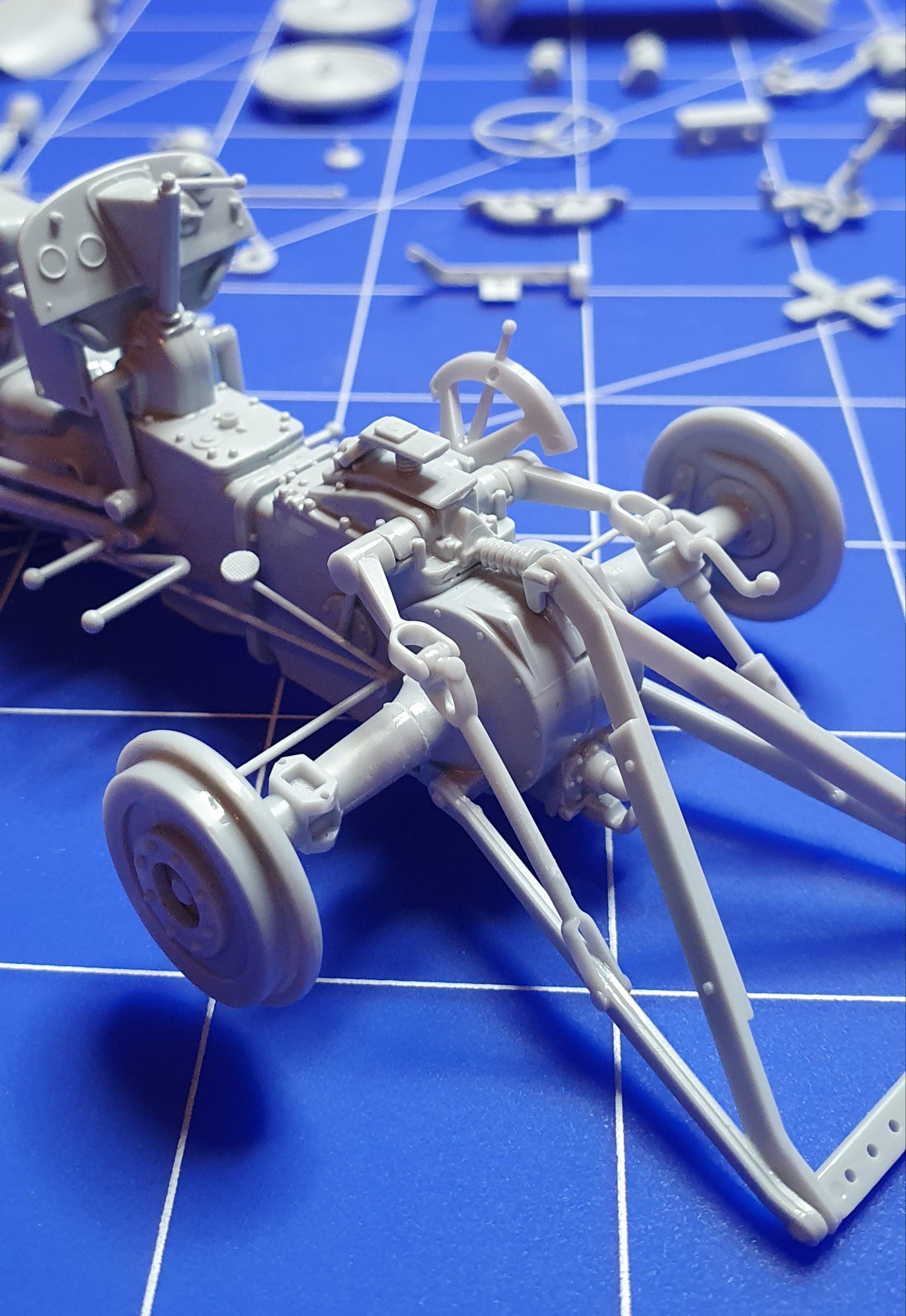

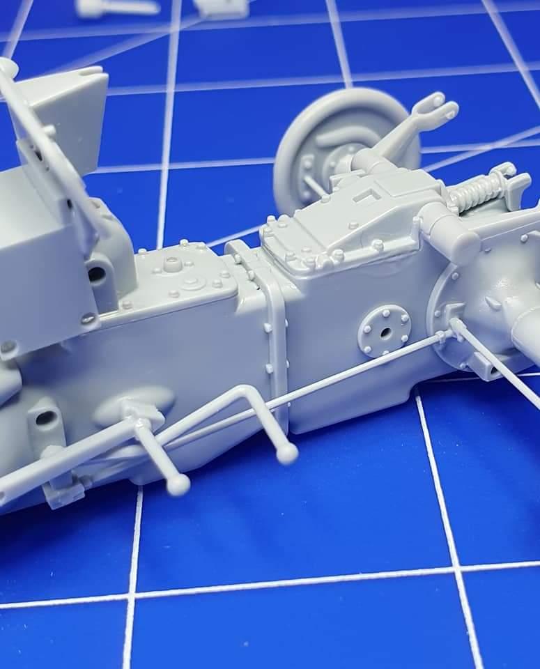

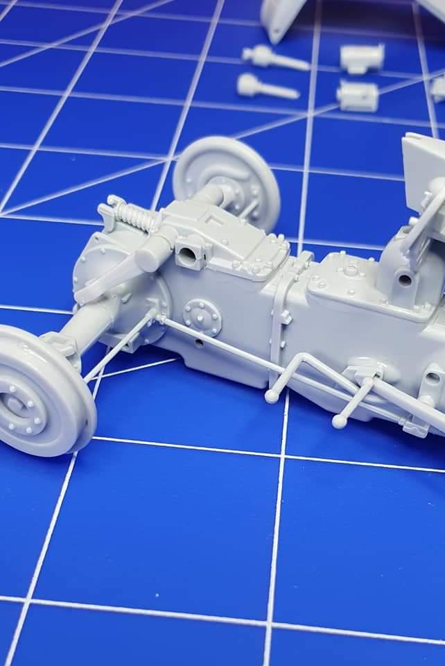

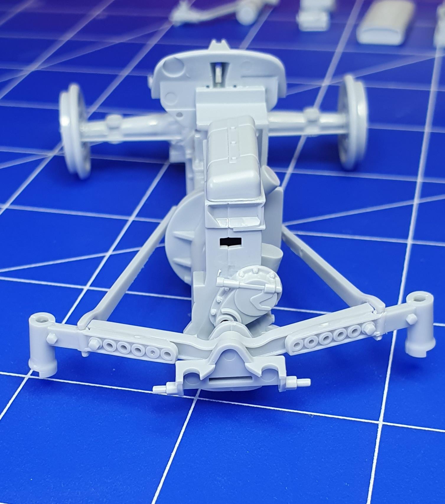

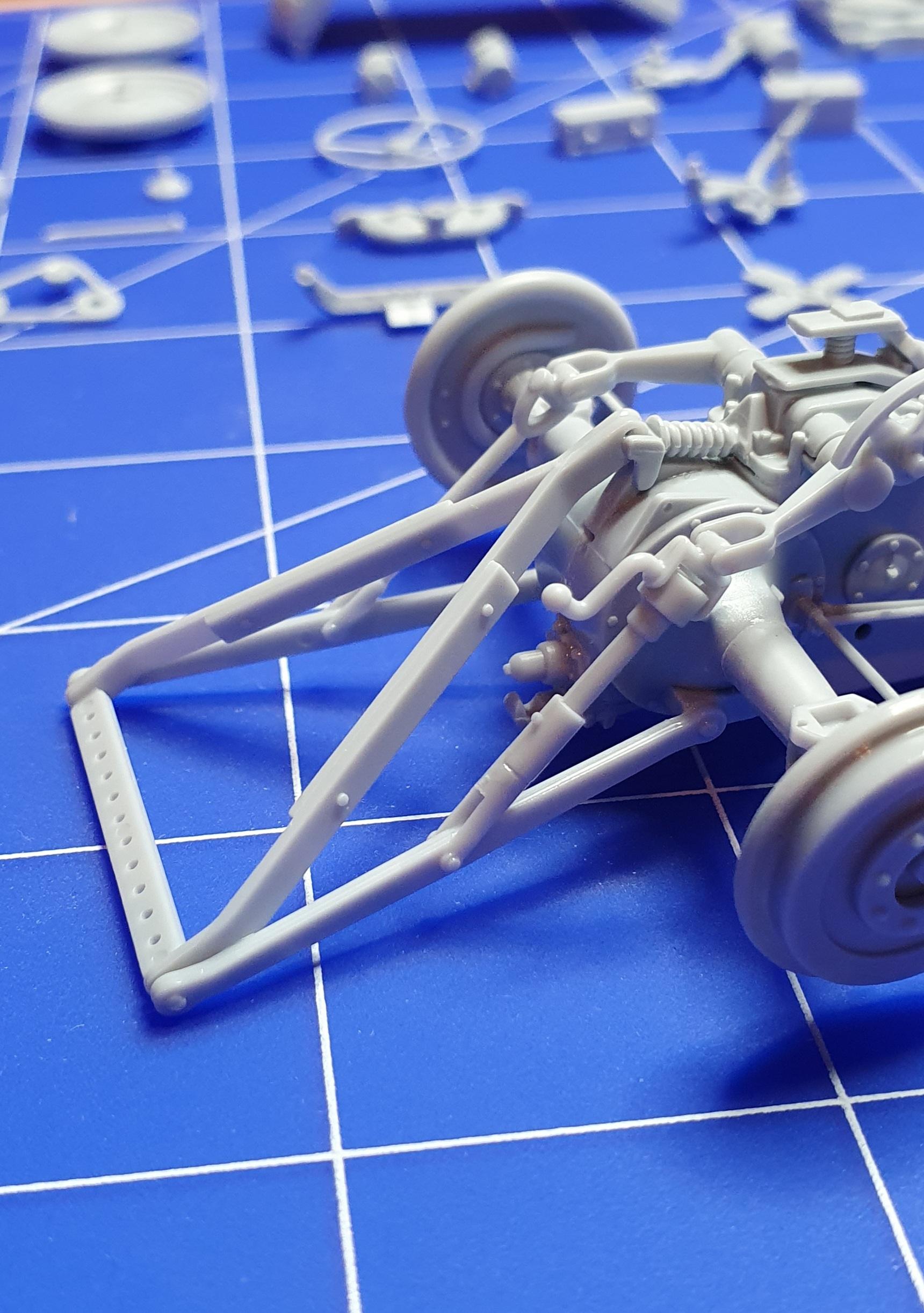

GeeBee Posted November 5, 2020 Author Posted November 5, 2020 Brake rods and pedals fitted, these are items i deviated slightly from the instructions, they tell you to build them all together and then fit them to the model, I dry fit the foot pedal then add the rod, first gluing it first to the base of the pedal and then to the rear axle casing, and then a few drops of liquid cement to the pedal and pushing it flush with the chassis using a pair of tweezers, I also fit them after fitting the front axle support rods, and not before, doing it this way helps holding the pedal assembly in place as it gets trapped between the chassis and support rods.
kilrathy10 Posted November 8, 2020 Posted November 8, 2020 This looks to be a very well appointed kit... You're doing an awesome job on it... The instructions look very usable, though... Drawn up quite well, it seems... Your photography of this build thread is amazing... Very nice...

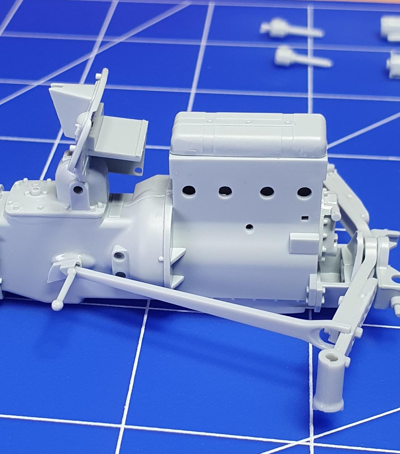

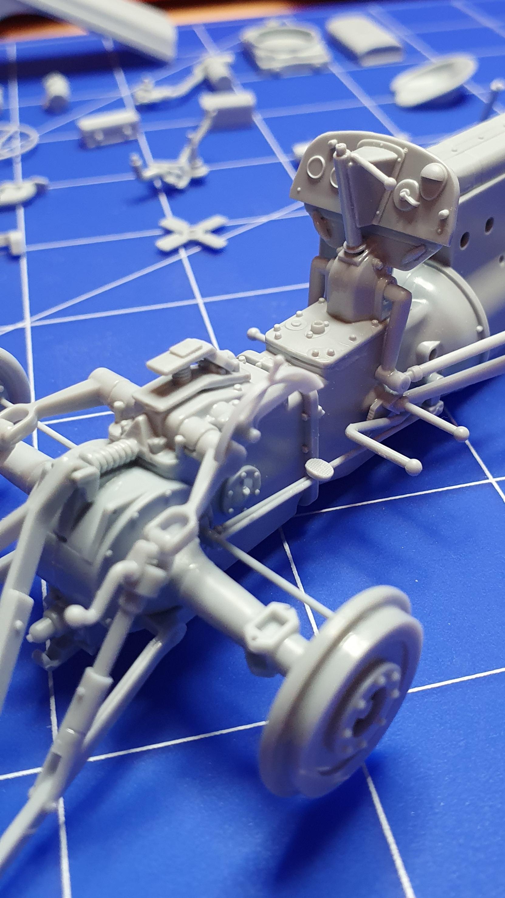

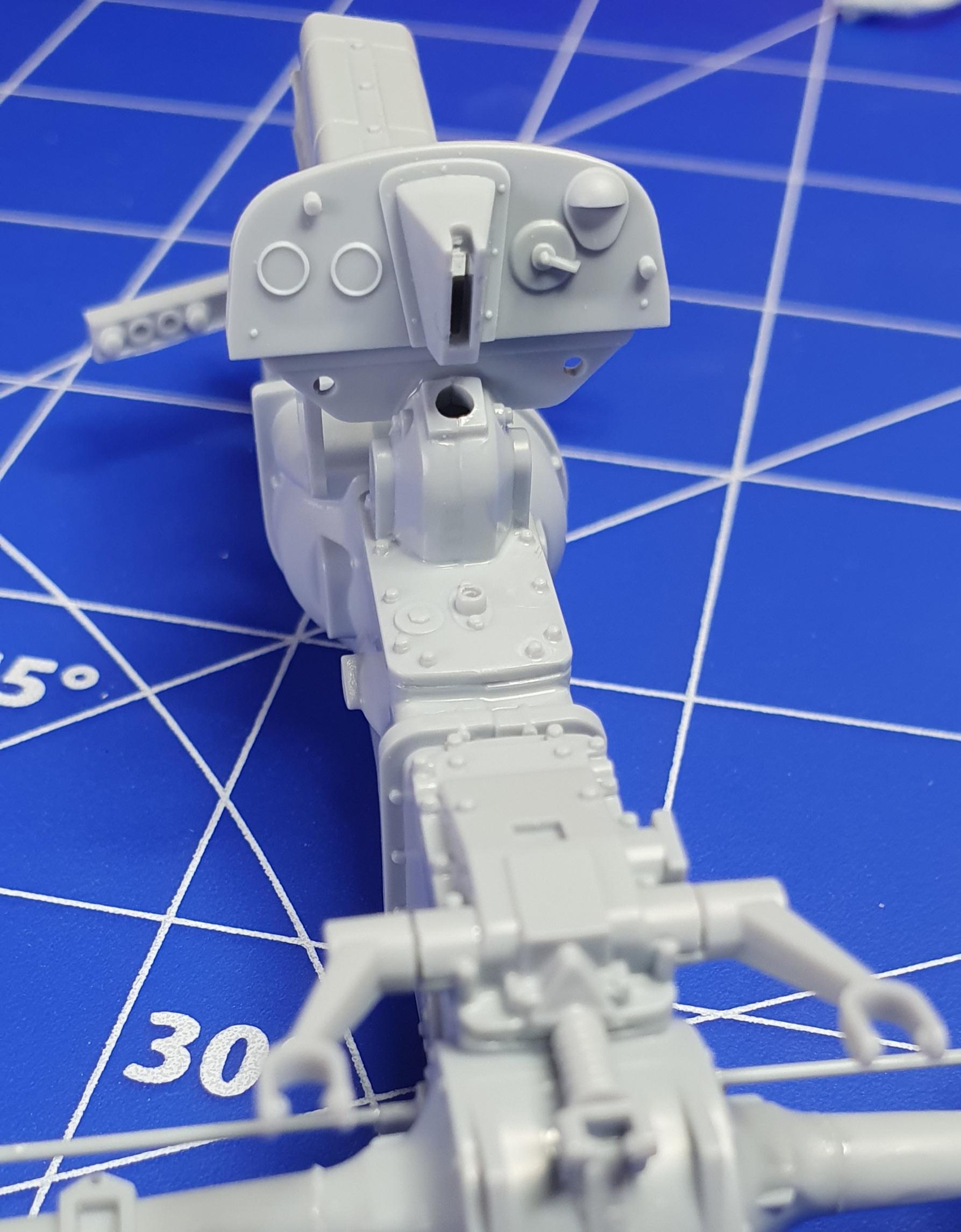

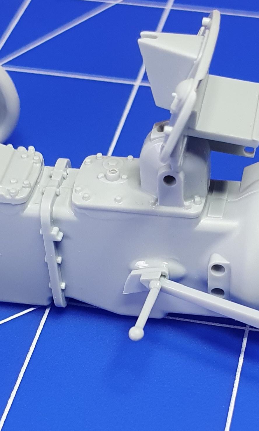

GeeBee Posted November 9, 2020 Author Posted November 9, 2020 Rear linkage fitted to the Ferguson, so many parts, 7 to be precise, and pretty tricky to get them all lined up.

GeeBee Posted November 10, 2020 Author Posted November 10, 2020 On 11/8/2020 at 2:33 AM, kilrathy10 said: This looks to be a very well appointed kit... You're doing an awesome job on it... The instructions look very usable, though... Drawn up quite well, it seems... Your photography of this build thread is amazing... Very nice... Thank you, the instructions are well drawn, if you study them and look at the parts in the next few sections it's easy enough to work out that the parts need to be swapped over, with the photography, I cheat a little as that's my day job.
GeeBee Posted November 10, 2020 Author Posted November 10, 2020 12 hours ago, CRUSADER2 said: You are doing a great job on what looks to be a really nice kit, everything looks to be there and really clean moulding, following this build with a special interest because it was the first tractor I ever drove, I must have been about 11 or 12 years old, looking forward to more photo's. It really is a nice kit, the parts are really well moulded, the instructions could be better though, I've never even sat on a tractor, but I got interested in them when I worked for the Classic Car weekly magazine, travelling to all the Classic car and transport shows where there was always a good selection of classic tractors on show.

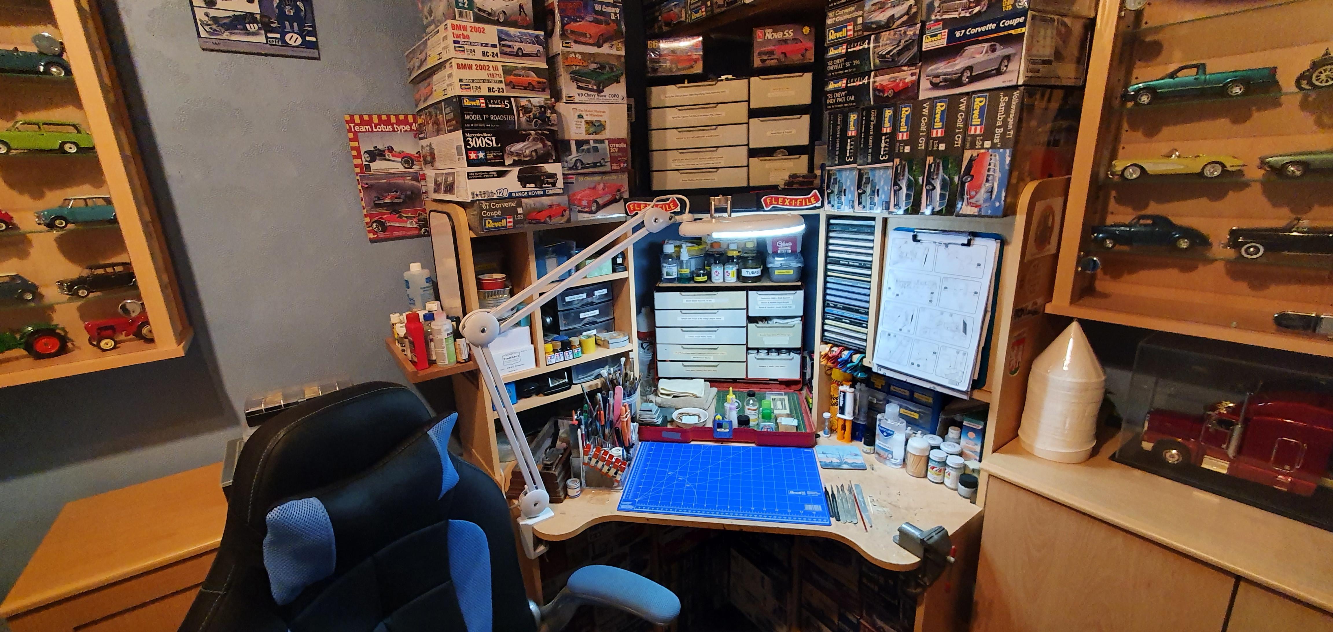

tbill Posted November 10, 2020 Posted November 10, 2020 Cool looking build , I have one of these kits, eventually to be a load on a lowboy trailer. I only see one issue with your progress so far....., you seem to have an over abundance of work space...., I have a 6 foot long by 3 foot deep table with a large hobby mat, yet I have a 6 inch by 6 inch work area?
GeeBee Posted November 10, 2020 Author Posted November 10, 2020 2 minutes ago, tbill said: you seem to have an over abundance of work space...., I have a 6 foot long by 3 foot deep table with a large hobby mat, yet I have a 6 inch by 6 inch work area? I only have a small building bench, but I can't stand or work in clutter, as I'm working on getting my new spray booth up and running, I'm unable to get any airbrushing done, so tonight I had a tidy up, bench is nice and clean now.
tbill Posted November 10, 2020 Posted November 10, 2020 Mine has never been that tidy, even when I moved the table into the room ....., haha. I try to maintain a tidy work area , but in about 15 minutes it looks as though a small bomb went off..... the tractor looks fabulous so far.
