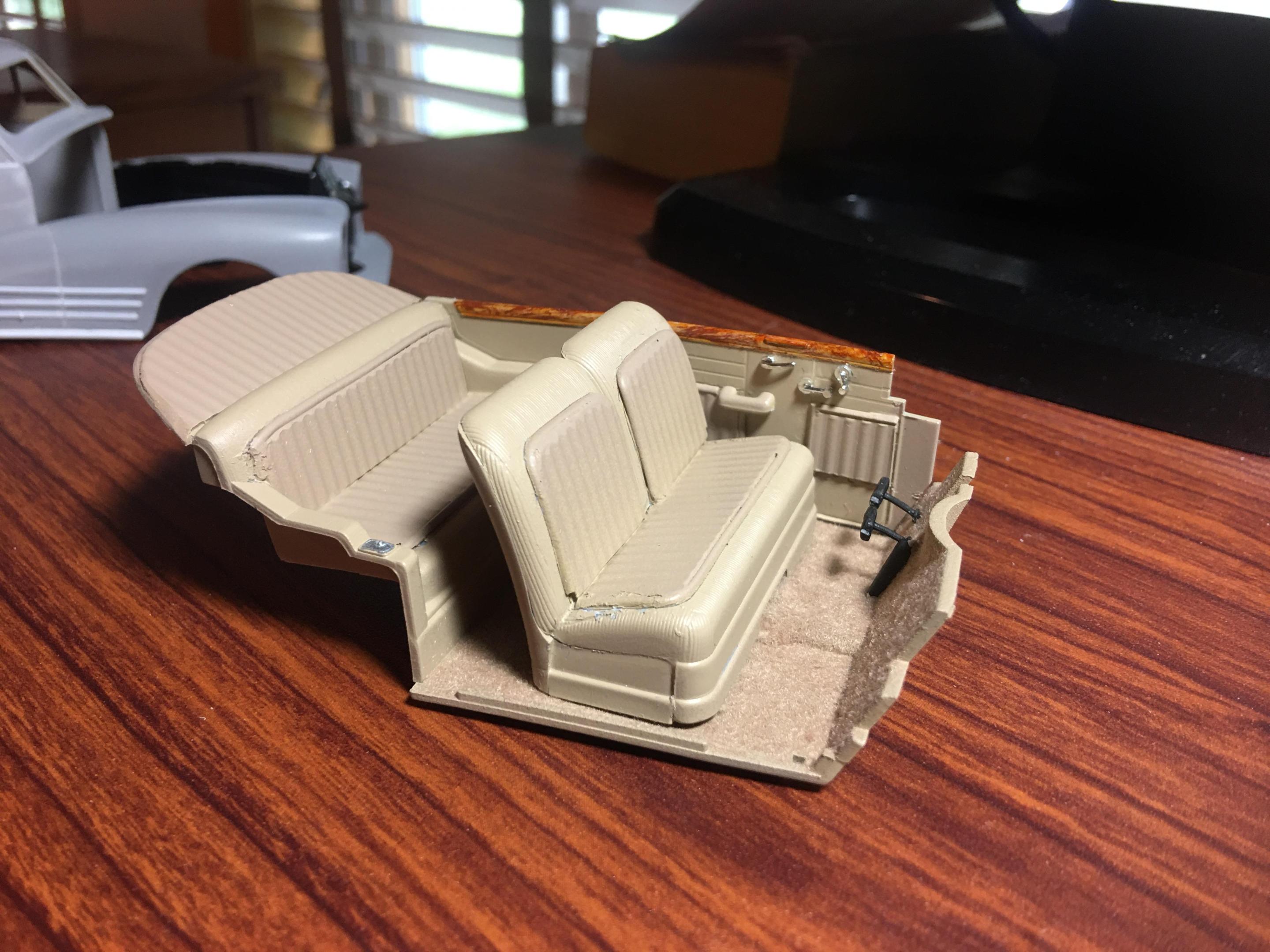

Plowboy Posted September 23, 2022 Share Posted September 23, 2022 Len, how would it work to scribe in the pleats on your door panels? A few years ago, I scribed in some diamond pleats on the door panels of a '51 Chevy. It's actually pretty easy to do. 1 Quote Link to comment Share on other sites More sharing options...
