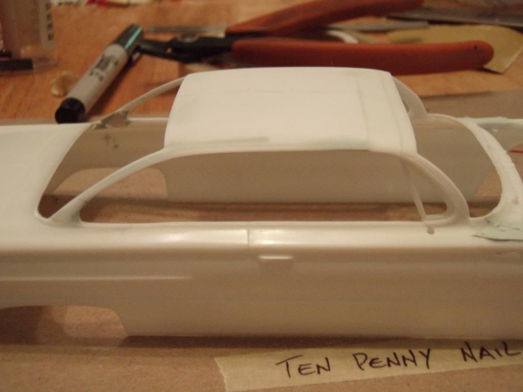

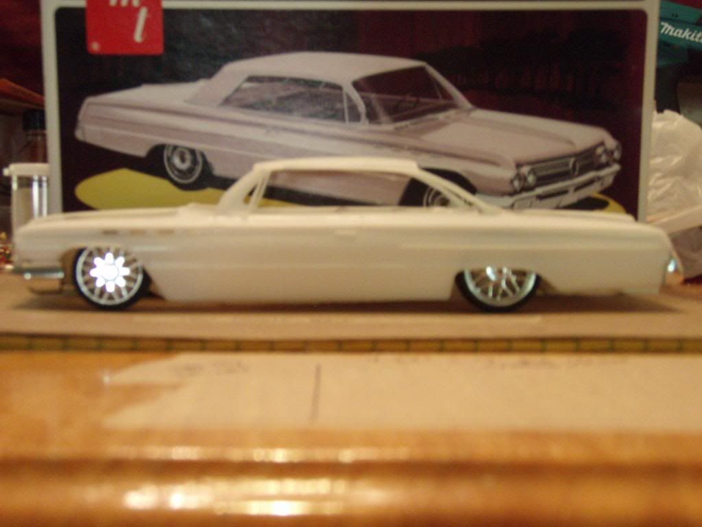

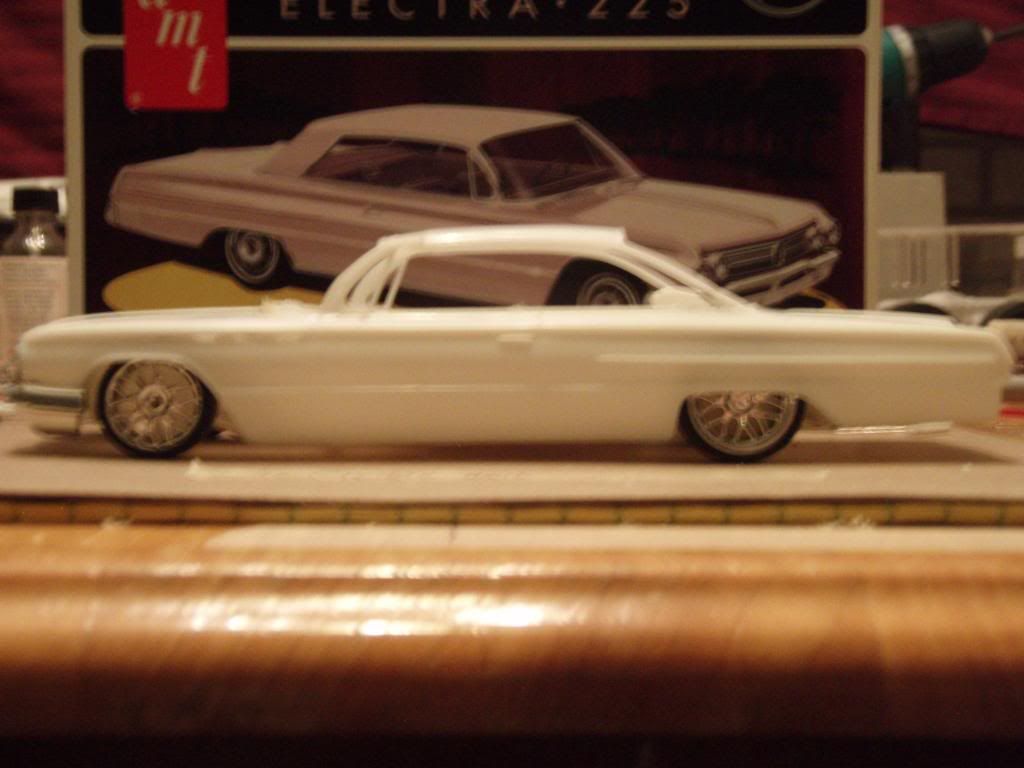

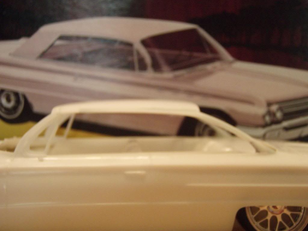

whale392 Posted August 15, 2010 Share Posted August 15, 2010 As a member of the BSAC (Buckeye Scale Auto Club...in Columbus, Oh), we have a 'same kit' build that 'started' on the 5th of August (some started earlier, but I think it was officially started on the 5th as that is when the remainder of the paid for kit were brought to the meeting and some spares for us who didn't get in on the initial go). The kit we all agreed upon was the 1962 Buick Electra 225 reissued by AMT/Round2. Let me tell you, whoever thinks that the 60s are the 'Golden Era' of kits (maybe in subject matter, but not in detail/quality of casting) is slightly Rosey. This kit is a hotbed for casting flash, misaligned mold plates (leaving pretty good sized casting lines in the body), sink marks, ejector pin marks, and ill-fitting parts. Now, don't get me wrong, I do love the 60s kits; but I will confess to being spoiled by todays higher quality standards and overall detail improvements. Anyway, enough of my bagging on and critiquing the reissue. On to the build, or something like that. Now, I haven't done a lot picture-wise, but I have done quite a bit to the kit. First, I believe the squared-off C-pillars are sexy for Grandma and Grandpa but are less than flattering for this body style. In that vein of thought; I chopped the top from a spare 1960 Chevy Impala kit I had, narrowed it, cut most of the roof from the 62 Buick, added a slight forward-biased rake to the roof, and grafted the modified 60 Impala roof to the 62 Buick body. I am not completely happy with the look (should have used a 1962 Bubbletop Impala roof, but I didn't have one spare), but it makes the Big ol' girl flow better in my opinion. The C-Pillar area I added some lift to to give the roof the rake; before it was actually tail-raked (the roof was lower at the rear than at the front). I still have a boatload of filling, sanding, and re-making of the trim, but this will give an idea of what was done. I am also using Pegasus Hobbies M5 wheels in 19" size, but I am sticking the rears into their 23" stepped sleeves and having a set of 21" sleeves manufactured for the front (so that they too will have a more realistic lip). The nose of the car suffers from what I call 'anteater syndrome'; where the headlights and grill stick out too far from the terminating ends of the fenders/hood line. I cut the buckets back flush with the fender ends and hogged out the headlight bucket area (so thick with plastic that it could hide Jimmy Hoffas body) to get the headlights/grill to sit further back. I like the way the hood lip and front bumper profile now match and the grill/headlights sit back in from too far out. I still have to modify the radiator locator/bulkhead/screwholes to get the bumper to sit square with the body. next order of business is to get the front wheel arches to line up with the newly relocated rearward front bumper (this will clean up the 'too cavernous' look I believe the front wheelwell openings exude). I also shaved the 'ELECTRA 225' moldings and the chrome ribbed panel in front of the rear bumper on the lower quarters (makes them too 'busy' looking to me) in preparation for material removal to tuck the rear bumper tighter to the body. Taillights I am taking a second set and through cutting/pasting making the original housings about half again as tall, so that the taillights can actually be seen on this car. Anyway, enough talk from me; back to work (I have cut the tranny from this kit and grafted it to the Nailhead in the AMT 39/40 Ford kit for a better looking Nailhead engine. I will post more when it happens. Hope you liked my introduction to what I am calling my 'Ten Penny Nail' project. Quote Link to comment Share on other sites More sharing options...

CrewDawg15 Posted August 15, 2010 Share Posted August 15, 2010 Looks promising Bradley. I do like that roof a lot better than the original one...Good Choice! Jimmy Quote Link to comment Share on other sites More sharing options...
brett Posted August 15, 2010 Share Posted August 15, 2010 I really like where you're taking this one, and that new roofline looks great. Quote Link to comment Share on other sites More sharing options...

Modlbldr Posted August 15, 2010 Share Posted August 15, 2010 Bradley- Looking good with that new roof swap. The work you did on relocating the grille/headlights makes it look a little more like a 64 Caddy from the side (at least to my damaged brain ) Take it easy. Later- Quote Link to comment Share on other sites More sharing options...

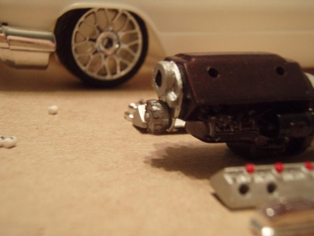

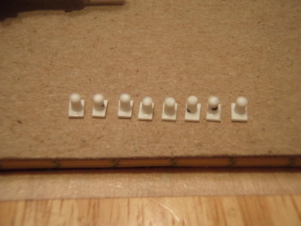

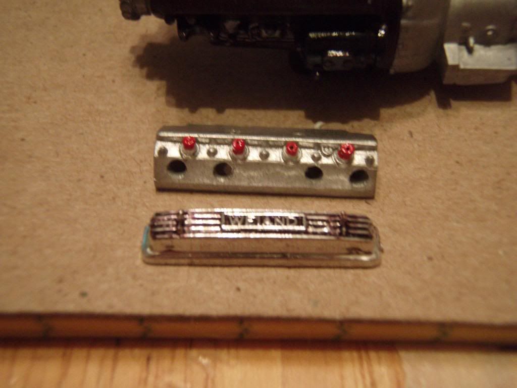

whale392 Posted August 16, 2010 Author Share Posted August 16, 2010 As promised, some update pics. Now, I am converting this to run EDIS and GM LS1/2 coils, so I have been working on that set-up. Some preliminary pics of the Tone Wheel and the very beginnings of the Coils: , , Also got the heads semi-complete (waiting for the plug wires to be added) and the valve covers painted. Added the kit trans to the 39/40 Ford AMT Nailhead engine for a better looking Nailer. , I should have the front wheel sleeves here and on by the end of the week, and the heads/valve covers/coils/wires done by Friday. That's all I have for this episode of 'TEN PENNY NAIL' Quote Link to comment Share on other sites More sharing options...
1972coronet Posted August 16, 2010 Share Posted August 16, 2010 Cool Buick ! It's interesting to see what looks to be the ol' "Slim Jim" Roto-Matic trans behind that NailHead ! Quote Link to comment Share on other sites More sharing options...

whale392 Posted August 16, 2010 Author Share Posted August 16, 2010 just took the kit tranny, cut it from the kit engine, and them cut the tranny from the AMT 39/40 Ford kit and mated them together. Whatever trans was supplied with the kit is what I am using (I will be the first to admit I do not know Buicks very well. Mid-60s Mopar B-Bodies and FOX Chassis Mustangs are my areas of consumed brainpower). I will have the front wheel sleeves by Friday morning, so they will be ready to test fit and have the front inner wheelhouses modified for them. I will also be adding inner fender detail as this kit has none. Stay tuned for more of "TEN PENNY NAIL" Oh yeah, color choice is Model Master Laquer Dark Cherry Pearl (GM color) with the hood center depression shot in Testors One Coat Laquer White Lightning. Interior will be two-toned White and Light Gray. Still deciding if I should leave the wheel centers Chrome of finish them in some other color. Quote Link to comment Share on other sites More sharing options...

Tony T Posted August 18, 2010 Share Posted August 18, 2010 Nice progress. The roof swap is a great look! Quote Link to comment Share on other sites More sharing options...

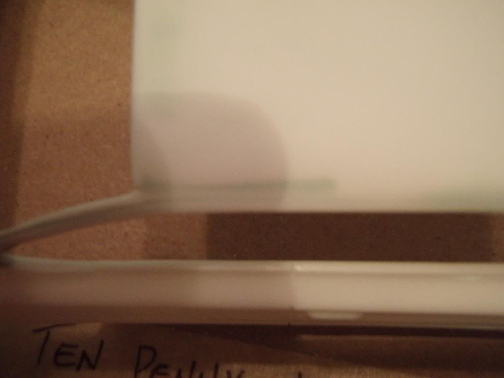

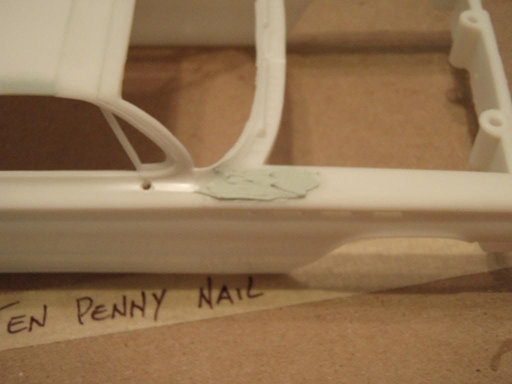

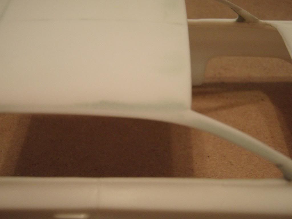

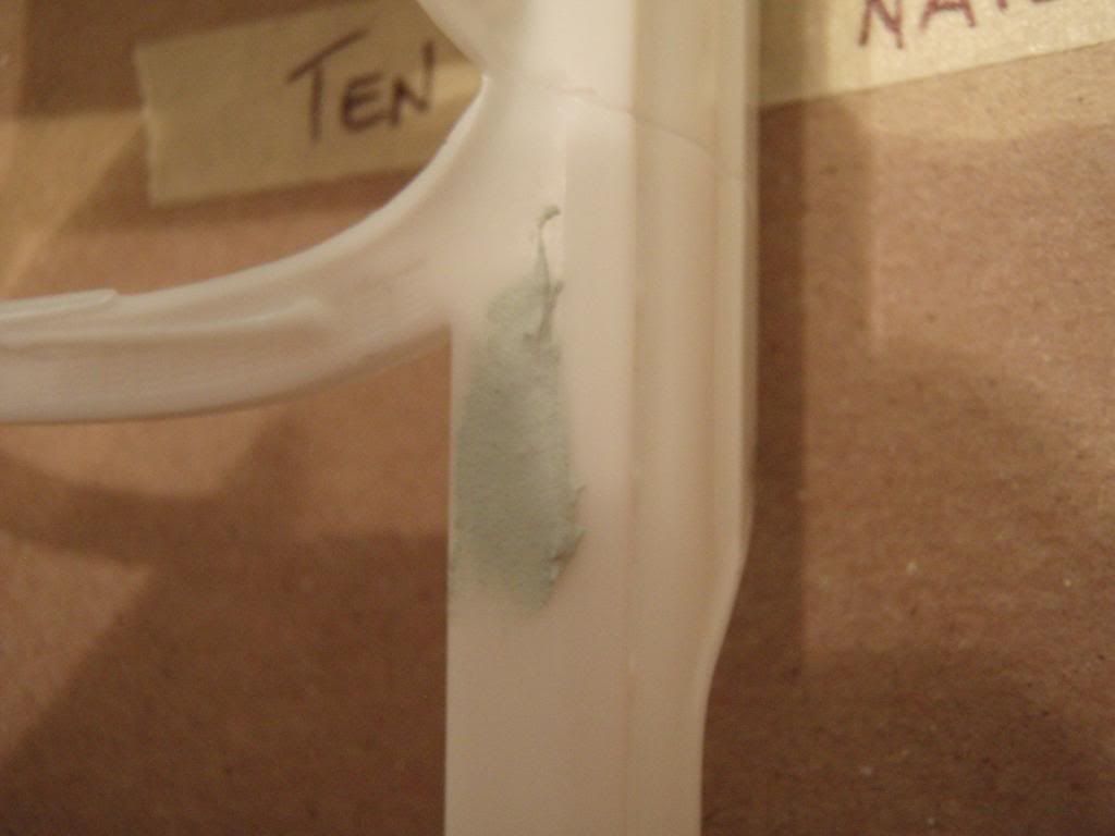

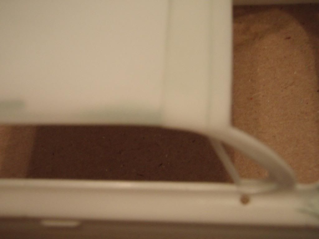

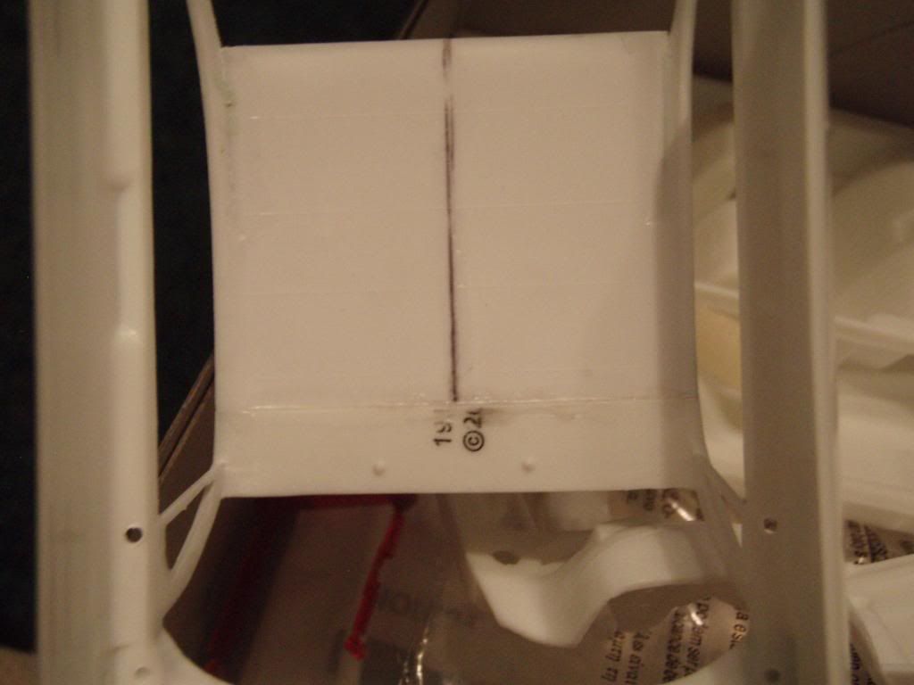

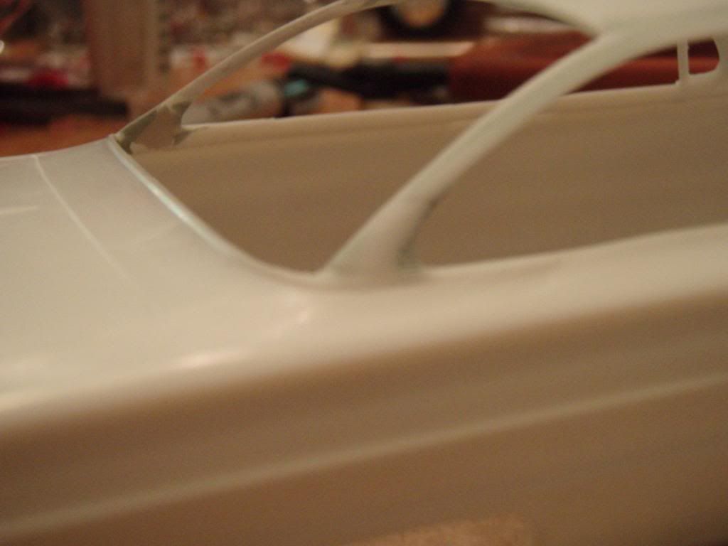

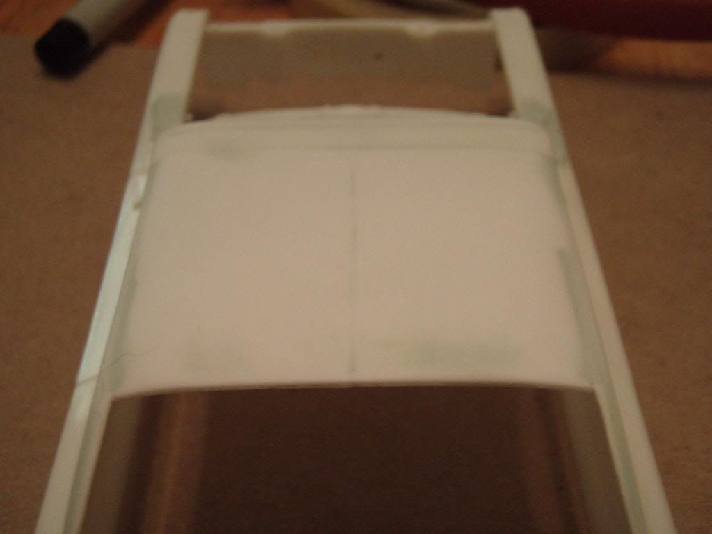

whale392 Posted August 19, 2010 Author Share Posted August 19, 2010 (edited) Well, never one to leave well enough alone, I broke her tonight trying to correct a little 'flaw' in my plan (why I wanted the Bubbletop roof to begin with). When I looked at the car from the rear, the back window upper arch just looked HUGE and out of place. So what do I decide? Well, I am going to slightly pie-cut the roof sheetmetal to bring the upper window frame down and more squared-off with the roofline. Yeah, great idea except the C-Pillars were too weak (well, drivers side was anyway) to take me hacking on the roof. SNAP!.....drivers C-Pillar lets go at the body line. A few choice words later, I glue it back together and add some plastic bracing inside to hold it all together. Finished sectioning the roof and got it pushed down in/glued. Waiting for the glue to fully dry so that I can get the Evercoat on the roof and smooth all of this mess out. So much for a positive update huh?! I will be hacking the roof (or at least supervising her while she does it) on the girlfriends build for the same purpose this weekend. Maybe I'll have the filler all done and the body in primer by Sunday. I have stopped with the LS2 coils, as you won't see them once the engine shield is in place. Now, once this Buick is done, I have something 'Special' planned to go with it. Edited August 19, 2010 by whale392 Quote Link to comment Share on other sites More sharing options...
whale392 Posted August 25, 2010 Author Share Posted August 25, 2010 Well, I guess it's pic time. Not a whole lot to report, but it has been riding in a bag back and forth to work with me for the last week waiting for me to fix the C-pillars. Well, I did..........but I am still unhappy with the overall backlight upper arch (I will leave it though, as I do not feel like fixing the pillars again). This is how she looked all last week! This is how the backlight arch looks now....a little lower (I want to take more out, but am afraid to break it again!) , , , , , , You can see the Frankenstiening the roof took (is still taking) to get it to the point it is at today. I have a lot more to do to it, but I am happier with it now. Have to add in the rear window chrome trim upper and C-pillar pieces, and add the drip railing (although I almost like the smoothed railing look!). Quote Link to comment Share on other sites More sharing options...

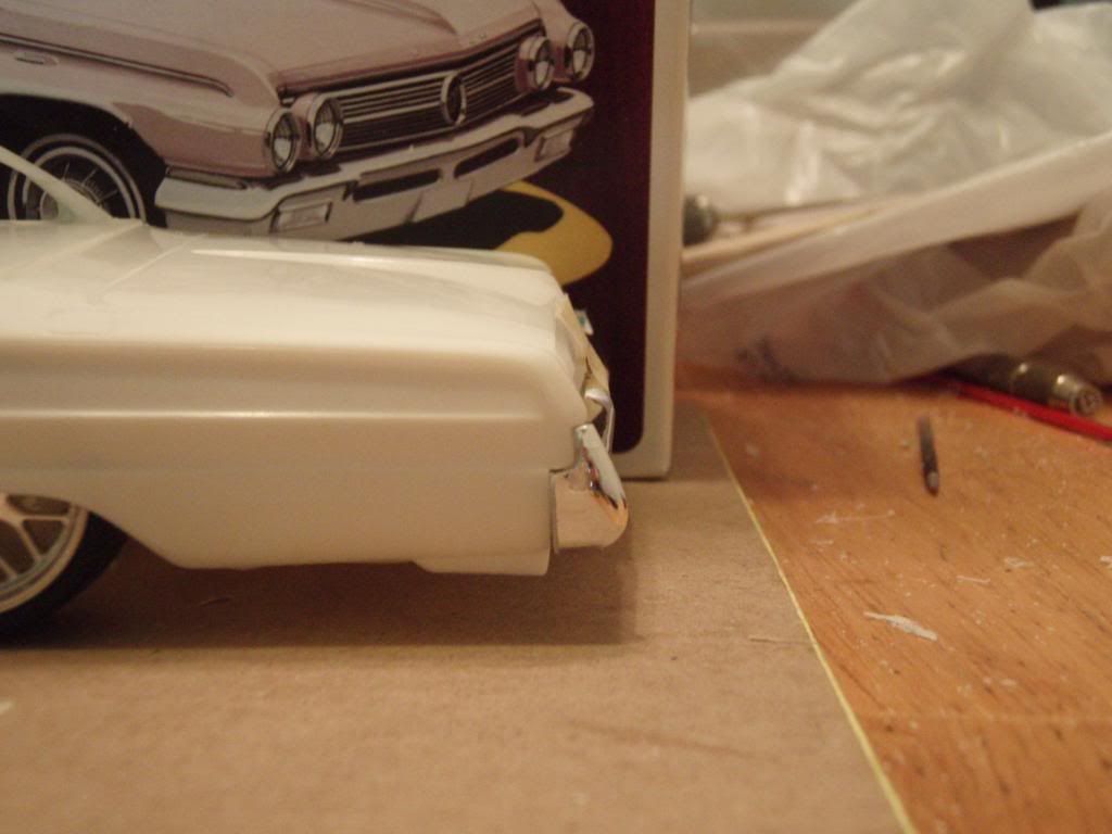

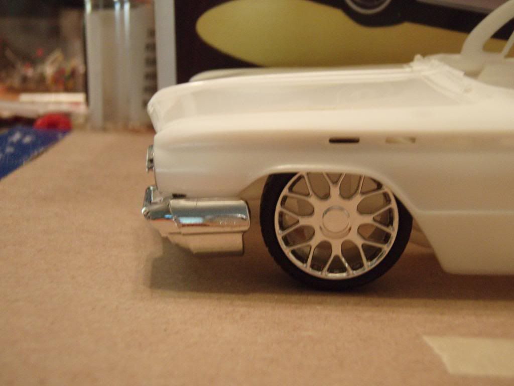

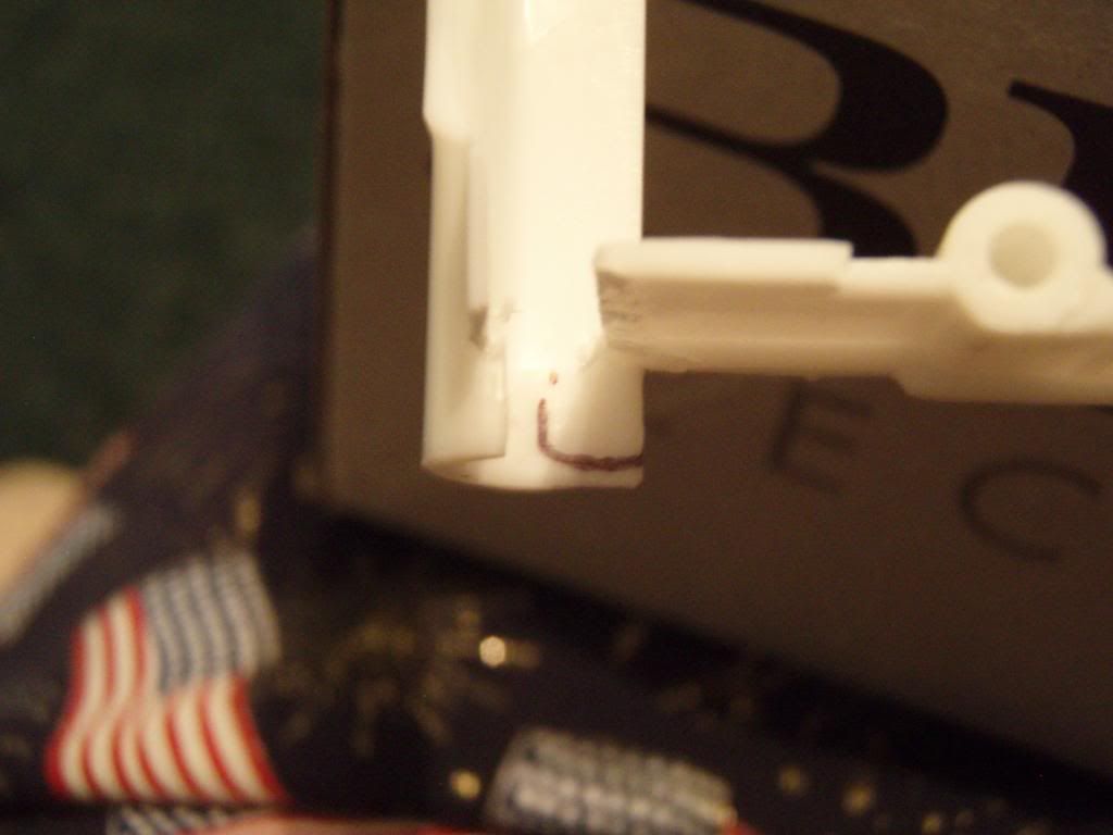

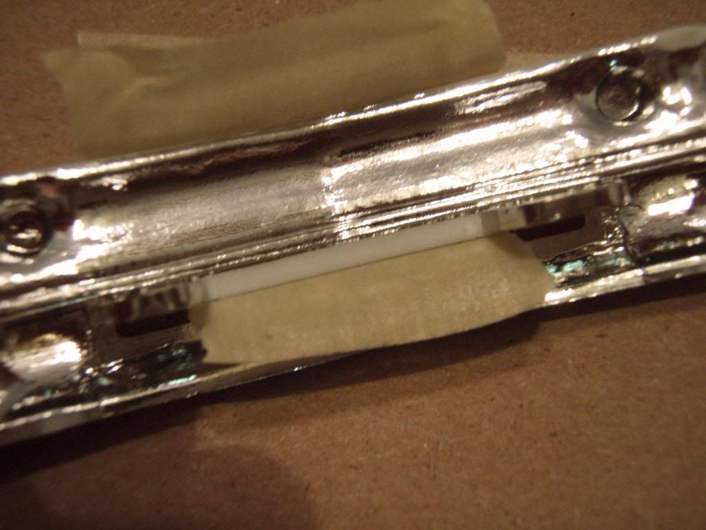

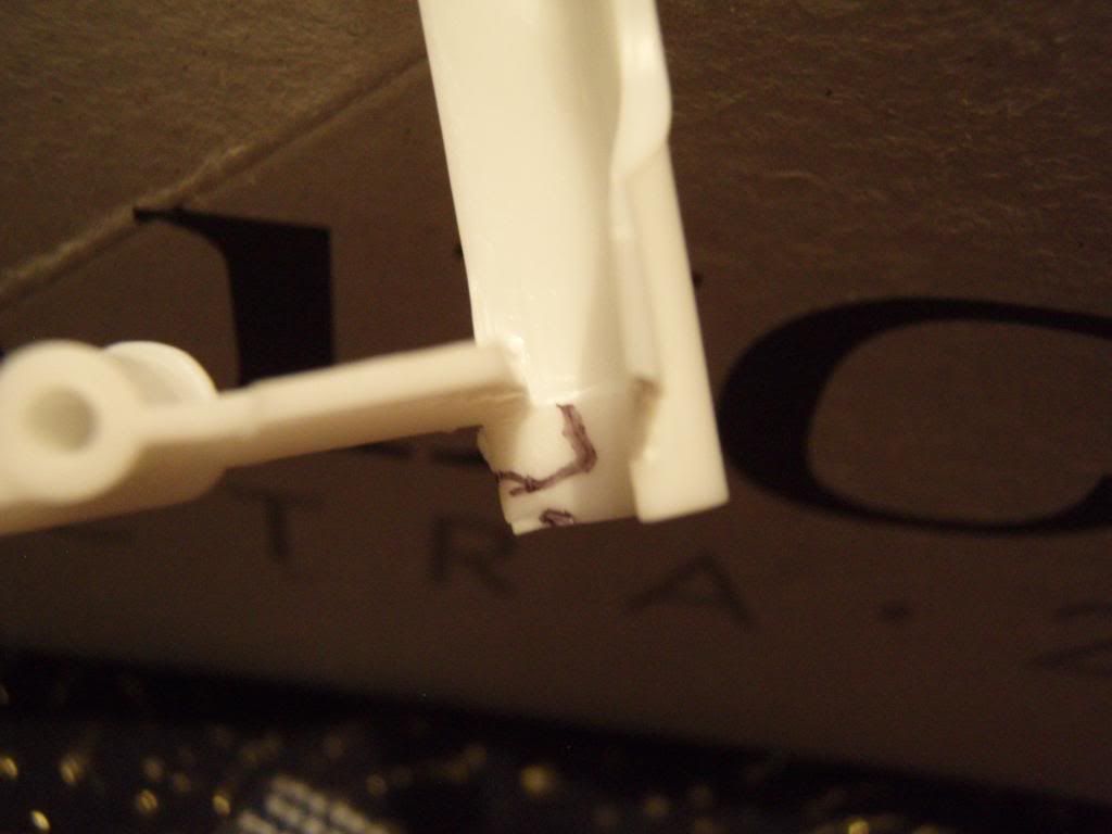

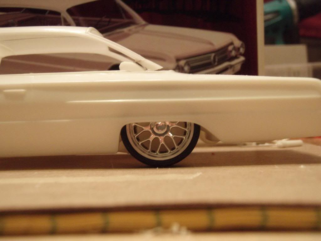

whale392 Posted August 25, 2010 Author Share Posted August 25, 2010 Ok, I also had to shave the grill support bar (cast into the rear of the grill) to get it to sit flush with the recessed headlight buckets; and remove some of the area behind the buckets to get the grill upper ledge to tuck into the front end of the body. , , , , . Now I have to fill in the front of the front wheelwells to match it up/re-radius it to the wheel profile and bumper tip. I will wait to do this until I get the 21" sleeves from the machinist so that I know exactly how much material to add. I also am finding/filling most of the sink marks on this (so much for a 'quick build').....lots of them on this one. Two deep recesses are in the front fender tops where the molds came together. With the addition of core (mold) shift, they are a problem. Nothing filling and sanding won't cure though! , Got the rear bumper area smoothed, fitted, and the bumper test-fit as well. Overall........she is slowly coming together (spare time is a little in short supply right now. Quote Link to comment Share on other sites More sharing options...

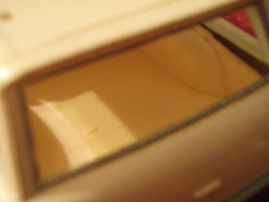

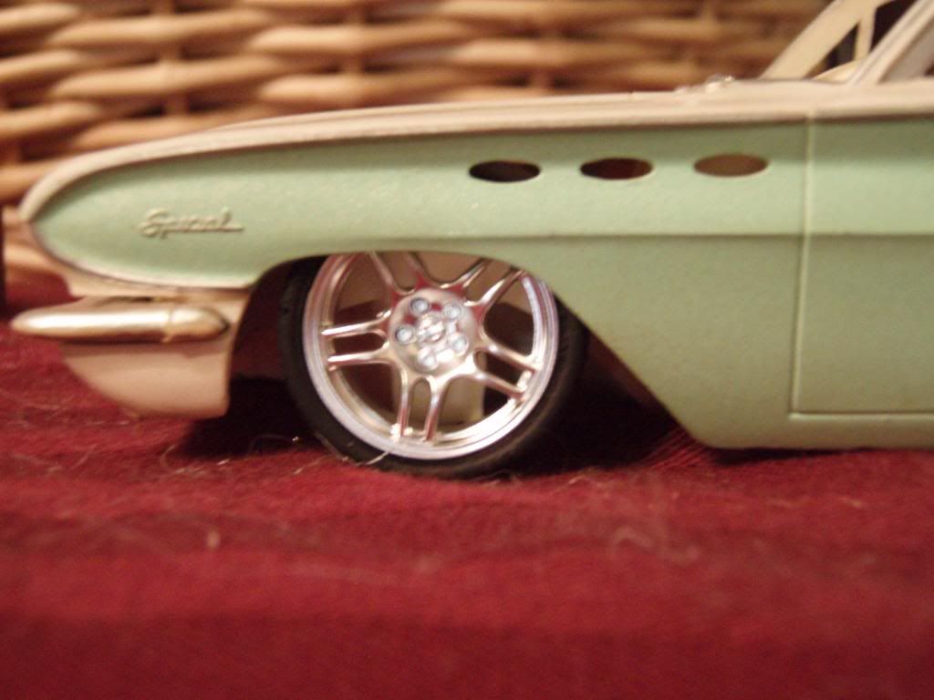

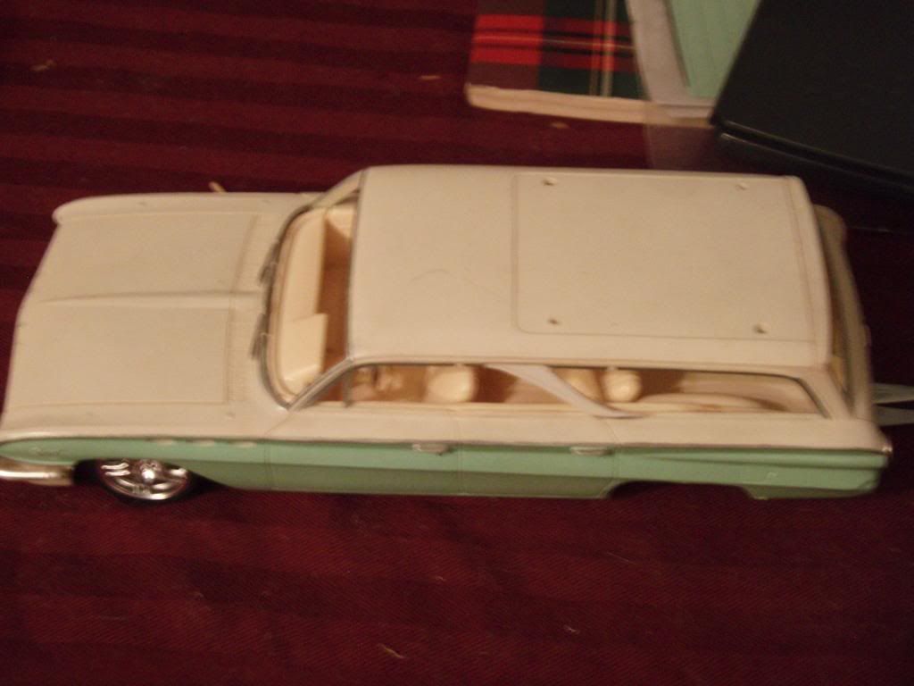

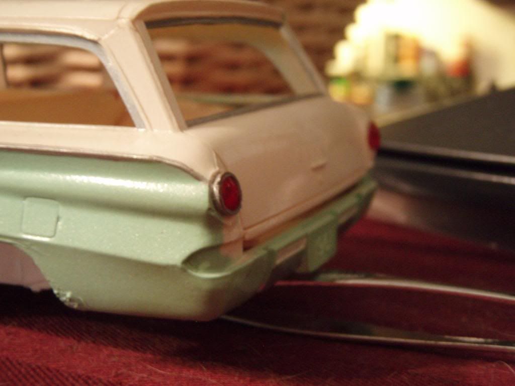

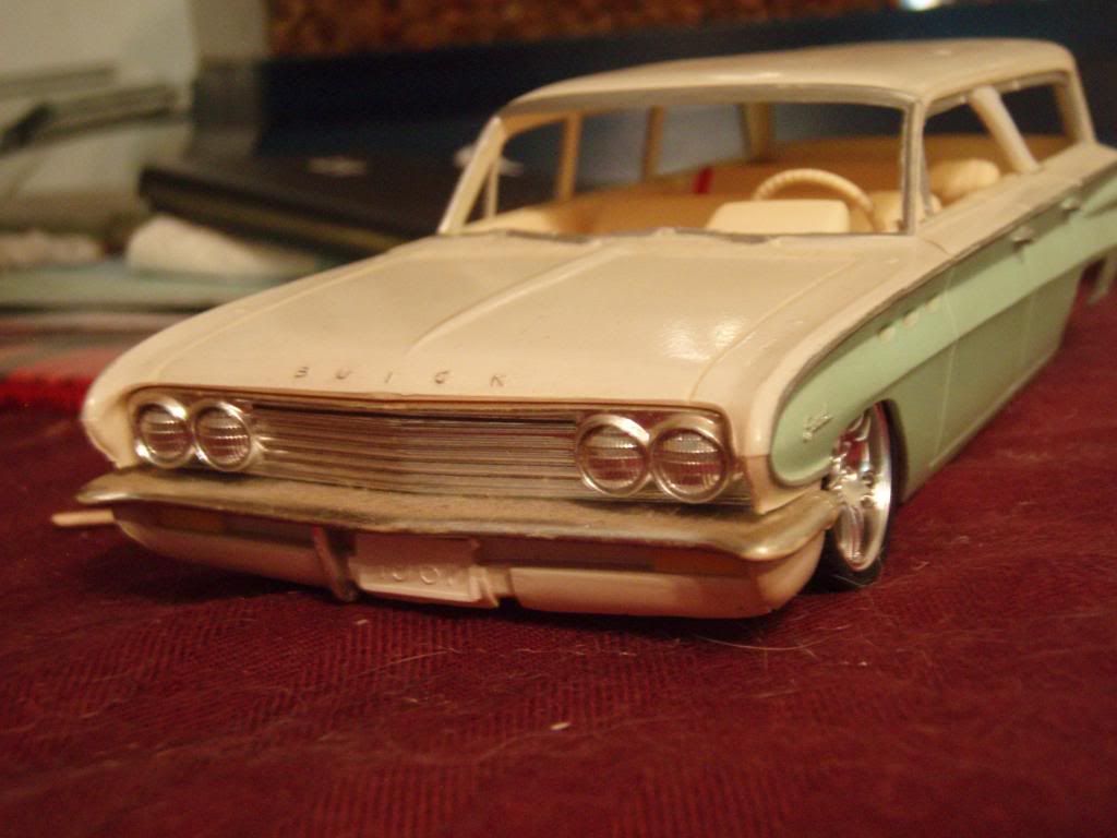

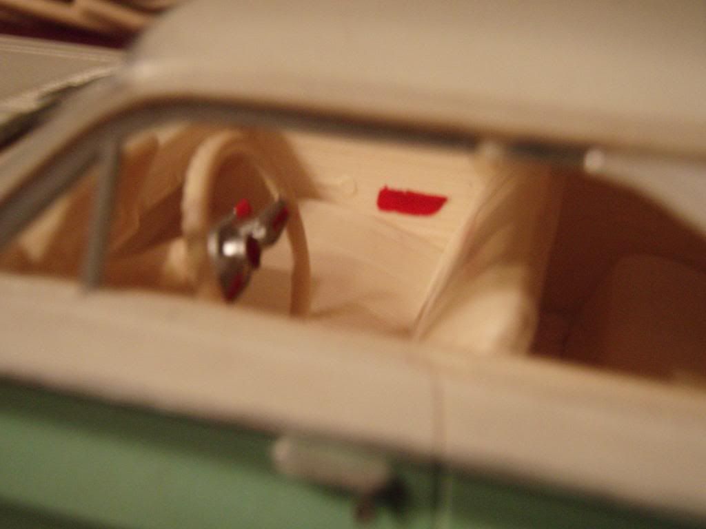

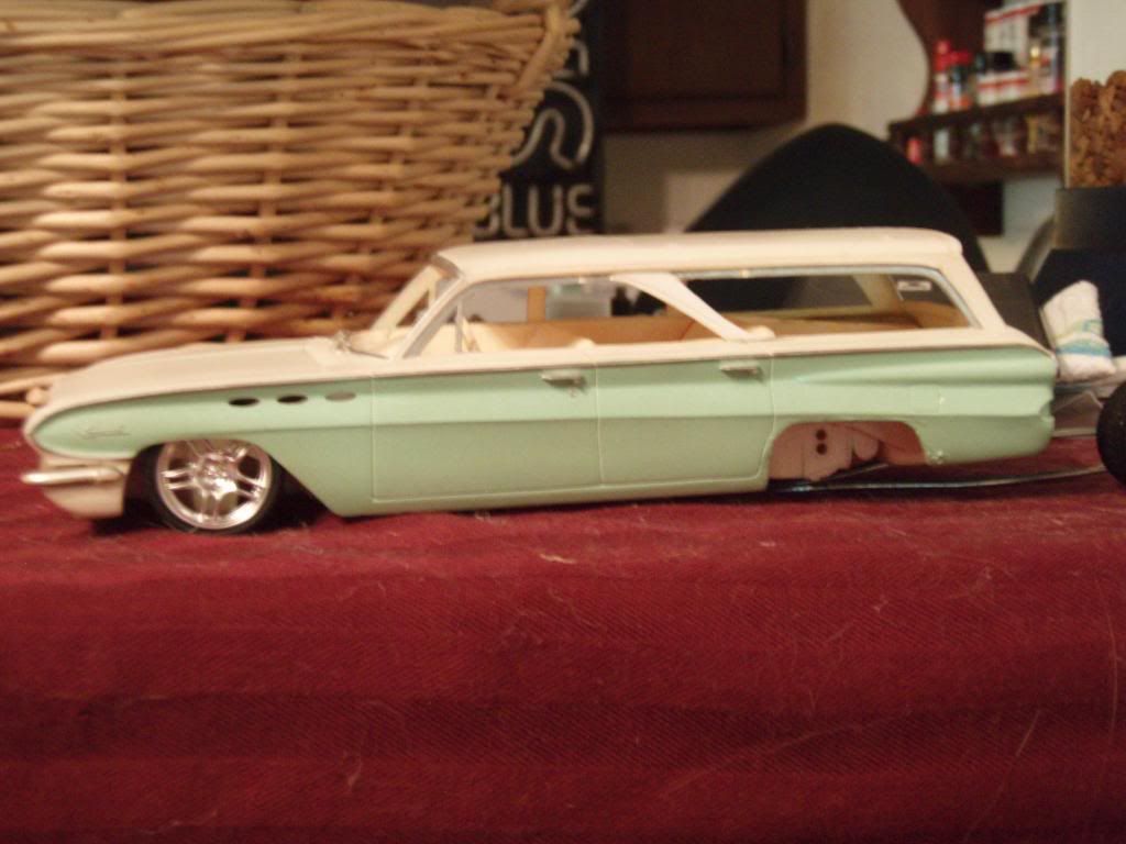

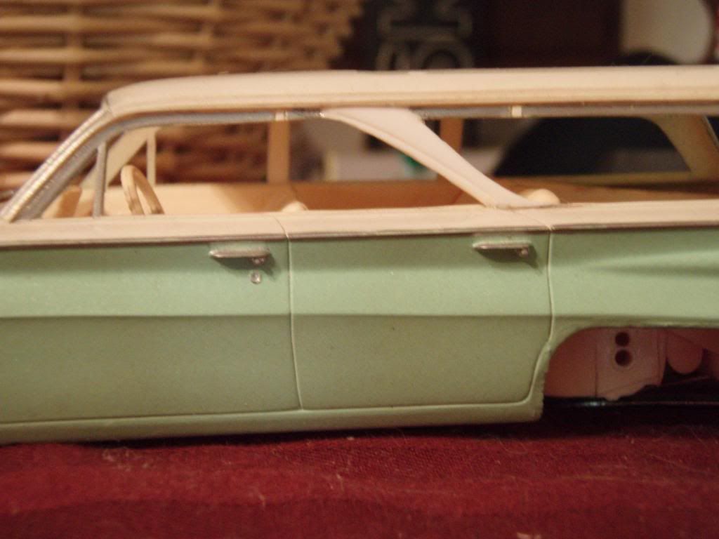

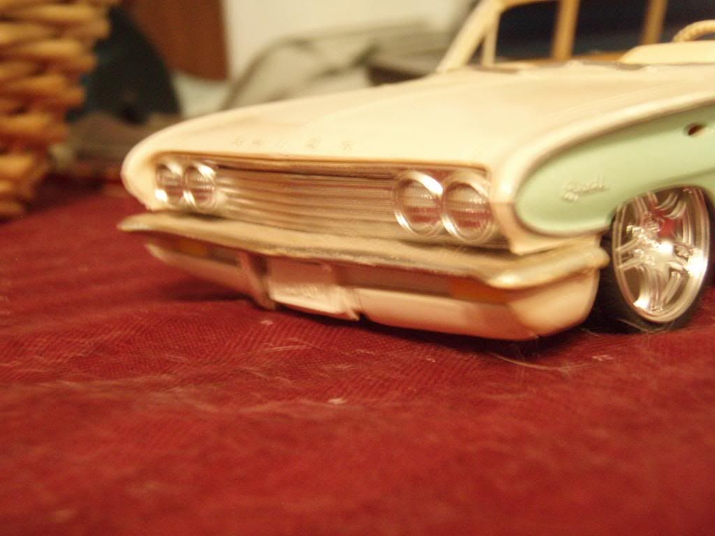

whale392 Posted August 25, 2010 Author Share Posted August 25, 2010 And since I mentioned the 'Special' at the end of last installment, I figured I'd at least let you see what I am starting with. , , , , , , , , She is a 1961 Buick Special Station Wagon kit. Glass and rear bumper are MIA, but mostly all there. Someone had started to add some goofy pillar into it, and I will correct this with .040"x.040" styrene. However, she will be 2-doored and the rims you see under her are from a Nissan GTR33 Skyline and will be staying. I have a spare C6 drivetrain I was thinking of transplanting into her (once I open the hood). Color undecided, but that will come with time. Quote Link to comment Share on other sites More sharing options...
59 Impala Posted August 26, 2010 Share Posted August 26, 2010 Lookin good Bradley. I like the 61 Special too. I had one of those way back in the early 60's when they came out. Including the trailer which both are long gone now. I haven't touched my Buick since I found the sink problems. I think that I fixed them but other projects have taken front door for now. Dan Quote Link to comment Share on other sites More sharing options...
whale392 Posted August 26, 2010 Author Share Posted August 26, 2010 Dan, the sinks can be overcome easily. If I can do it, I know you can! Thanks for the words on the 61'. I still have the trailer, toolbox, and A-frame cherry picker this kit came with somewhere. The working pullies and hooks for the picker were awesome and stunningly done for a 60s kit. Anyway, I want to see yours done and at the meeting. The girlfriend and I can't be the only ones bringing finished kits to the meet (assuming I finish this one!) can we? Quote Link to comment Share on other sites More sharing options...
CrewDawg15 Posted August 30, 2010 Share Posted August 30, 2010 Nice save on the roof Bradley. It definitely feel it flows a lot better than the original slab sided one Quote Link to comment Share on other sites More sharing options...
