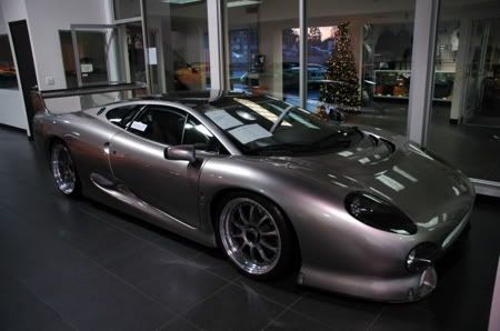

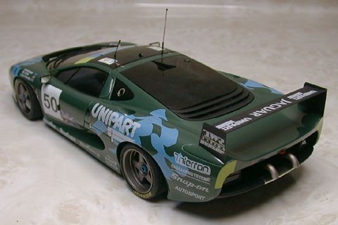

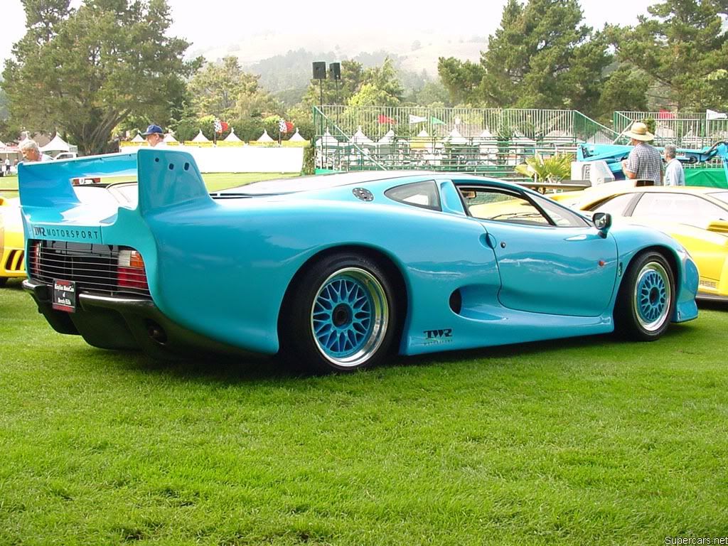

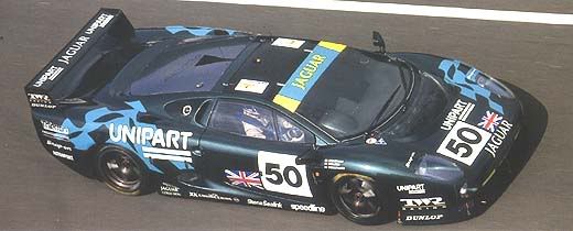

B_rad88 Posted September 25, 2010 Posted September 25, 2010 hey guys, um i need a bit of help with performing plastic surgery on a window............ im tring(well atleast i hope i can) to make a naca style air duct in the engine cover window of a jaguar xj220....... here are some pics of what im tring to replicate: my concern is making the cut into the window, and making it look proper. can anyone shed some how-to's on this please? Thank You!

B_rad88 Posted September 25, 2010 Author Posted September 25, 2010 (edited) Tinted glass and a dark recess... EASY! Cut the hole and place a black painted hollow, correctly shaped, beneath it. If it just HAS to be clear... vac-form and tint the scoop below. The third option is to make a mold for the whole darned glass and vac-form it. But the first solution is always the simplest. J thank you jairus for the tip, but 1. i don't own or have access to a vacuform machine or anything like it, also 2. my problem is still cutting the plastic, im not sure on how to go about it, since i have only 1 window, i don't want to mess it up badly. if you catch my drift. i also have no other detailed pics of the window with the duct, like inside of the window, or other views, those 3 pics is what i got to go from, so measurements, position, ect. im so not sure about, so its like guessing in the wind. Edited September 25, 2010 by B_rad88

B_rad88 Posted September 26, 2010 Author Posted September 26, 2010 Well, Harry I feel it filters out the rubbish what most of the Internet has become sadly. You call it fun, I call it needless distraction... Nice project there Brandon. Could you show us what you are starting with? I have no idea what the Jag kit looks like "unmolested". (Now there is a Google search sure to bring hours of fun....) thank you, it was a project that was supposed to be for the "drift car" build off, but sadly it was stalled for this very reason why im posting this thread, i didn't know how to make the duct. also i don't have the proper decals i need to finish the body.......... but i have been thinking of bring it back out of the stalled stack and working on it a little bit. This is what i am/was tring to replicate: TWR Jaguar XJ220: yes i know there is alot of work. im using the AMT/ERTL jaguar xj220 model kit (YES, i know this is the bad one of the 2 kits, but i didn't want to mess up my tamiya jaguar xj220 for this yet!) here is my kit: My AMT TWR Jaguar XJ220 DRIFT CAR follow the link, thats what has been done so far to it before it stalled.
