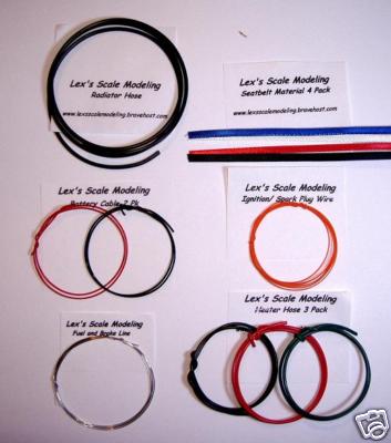

Tom Geiger Posted October 18, 2013 Share Posted October 18, 2013 First time out, I'd look to the aftermarket to buy the items you need. Once you see the products, you may want to seek alternative (and maybe cheaper) sources. Go to eBay model car section and search for wire/hose. I found this starter set for $12: I don't have experience with this vendor, but this gives you an idea of the different sizes we use. Also, I bought radio diodes from Radio Shack (many in a pack) that look like clear glass fuel filters with line attached. You may also look for prewired distributers, which are a little more money, but save you a lot of time and effort. Quote Link to comment Share on other sites More sharing options...
southpier Posted October 18, 2013 Share Posted October 18, 2013 that looks like a pretty complete kit - and for 12 bucks a good deal Quote Link to comment Share on other sites More sharing options...
