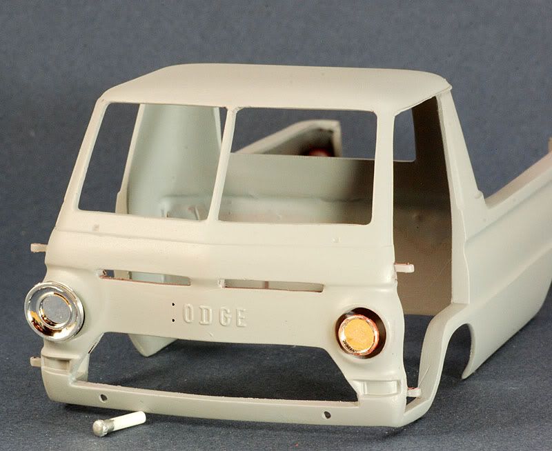

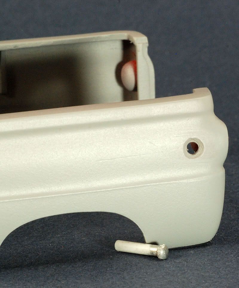

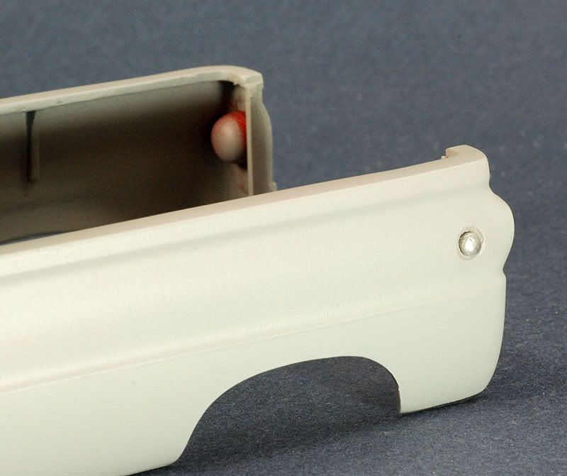

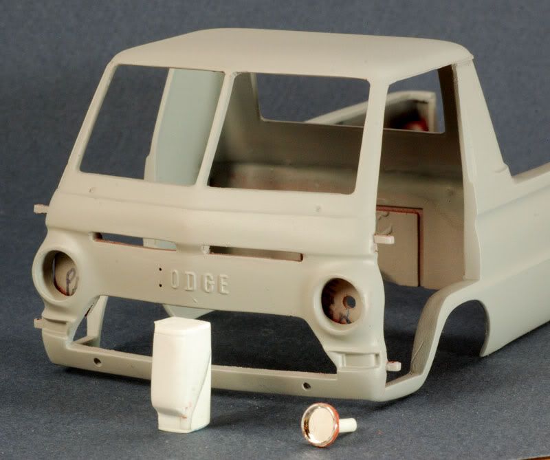

Foxer Posted November 12, 2011 Author Posted November 12, 2011 (edited) I've been slowly, but steadily progressing. The first shot shows the left headlight ring missing. I just sanded away the ring and put a plastic rod on the back as a pin to go thru the door hinge to hold it in place. Next photo shows the headlight sitting out. I couldn't locate a photo of a 1:1 with the ring removed so I'll just fake it. It screws into something .. tabs probably. The white thing in the 2nd photo is a piece I made to go in the trunk behind the gas intake as I've seen in 1:1 photos. The front slotted vents were also opened. They still need a thin vertical vane at the centers. This was just another primer coat to check the bodywork. Next is the gas cap made from a chunk of sprue with another plastic rod locator. I sanded a crown on the sprue and used a thin edge of a file to gauge around the edge for the "finger grip". I drilled a hole in the body for the rod and enlarged and dished it slightly with a twist drill. Thanks for looking and comments are welcome. Edited April 4, 2015 by Foxer

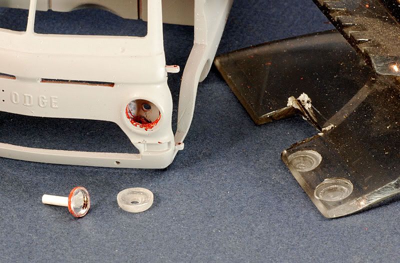

Foxer Posted November 18, 2011 Author Posted November 18, 2011 After looking more at the photos Casey supplied I decided the headlight bucket HAD to be done. I looked far and wide but could not locate a cone to use anywhere. The tip of my 3/8" twist drill looked close to the right slope and the diameter was right, so last years ice scraper donated it's blade and received a few conical dents. The area was cut out and ground down to fit the headlight opening. It looks like some more grinding to thin it so it recesses more into the bucket and the body is ready for paint!

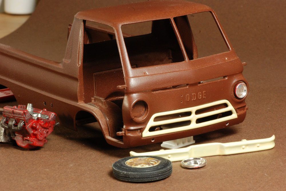

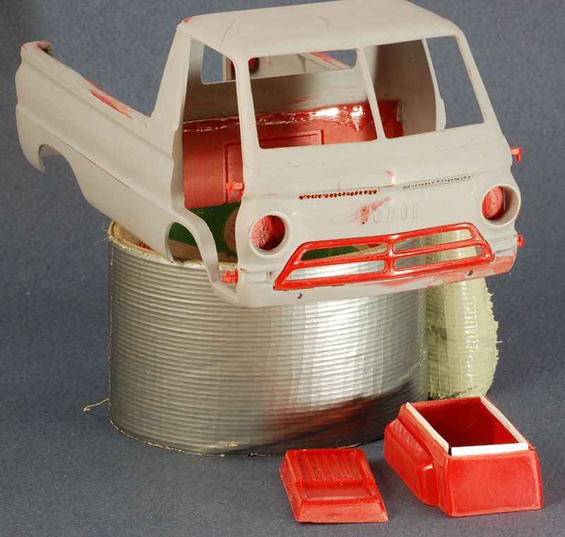

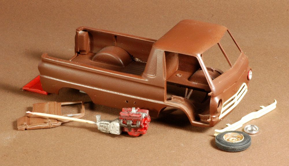

Foxer Posted April 4, 2015 Author Posted April 4, 2015 I was looking at BBodyBlues' A100 Van build and it got me to thinking about the A100 pickup that I had even gotten to paint stage before getting left for something more exciting at the time. The body got it's first coat of rust color before some hairspray and has been sitting next to my photo booth for over a year waiting for a shot! So, I did take some photos and maybe will get my buttt moving on this. At least it shows the piece in the rear left corner of the bed I made that encloses the fuel filler pipe. Looks like I got the cream color for the grill and bumpers on too. I started grinding out some rust areas and I'm going to go some more along the sides of the bed
MGL Posted April 4, 2015 Posted April 4, 2015 Thanks for posting this, I wasn't able to find a picture of the cover in the left rear of the bed and just made something like I've seen on other trucks. Yours makes more since considering how close the gas cap is to the corner. Nice job so far on this, I hope you get back on it so we can see the finished product.
Foxer Posted April 4, 2015 Author Posted April 4, 2015 (edited) Thanks for posting this, I wasn't able to find a picture of the cover in the left rear of the bed and just made something like I've seen on other trucks. Yours makes more since considering how close the gas cap is to the corner. Nice job so far on this, I hope you get back on it so we can see the finished product. I remember it taking a long time to find a photo of an unmodified truck but this is what I found and based it on .. actually, looking at those fender wells and paint, it may be a custom. Edited April 4, 2015 by Foxer
