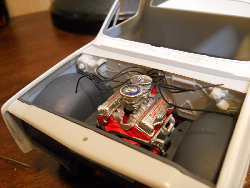

Engine swap for a 409 (thanks Bill_R).

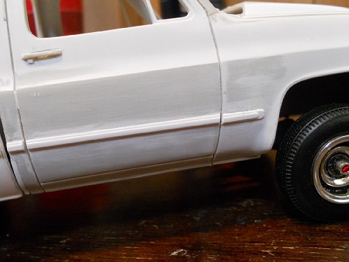

Added side trim and made a hood scoop.
The trim is stacked Evergreen #104 for the bottom and #8104 for the top.
Scoop was cut on 3 sides lifted and made a smooth bend to it.
Planning on adding screen mesh to the scoop opening.

Lookin' good James ! I love the old 409 instead of a standard big block .
Nice mods too , especially like how you did the side molding . I missed the article on diamond plate , can you show what you're doing ?

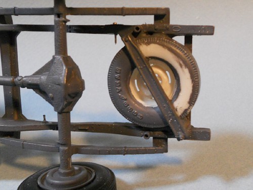

The chassis shocks looked plain Jane to me , so I coiled some wire
around them for a coil over shock look.Added straight pins for mounting
pegs..On a side note..both axles got reenforced with straightened paper clips
and super glue ..they looked weak and Fra-Gil-Le..hahahaha
The grill needed a lot of sanding to get is to sit right on the front.
Looking at the side profile ...looks like the front axle needs to be moved
forward a sconch ( technical term...look it up) to center the wheel.
Made a grenade shifter for giggles..not going to use it tho..installing
the B&M shifter instead..well after a lil' modification that is.
That is all..
