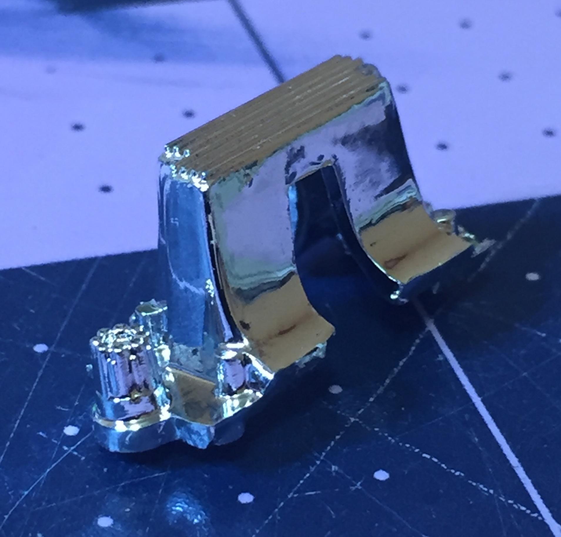

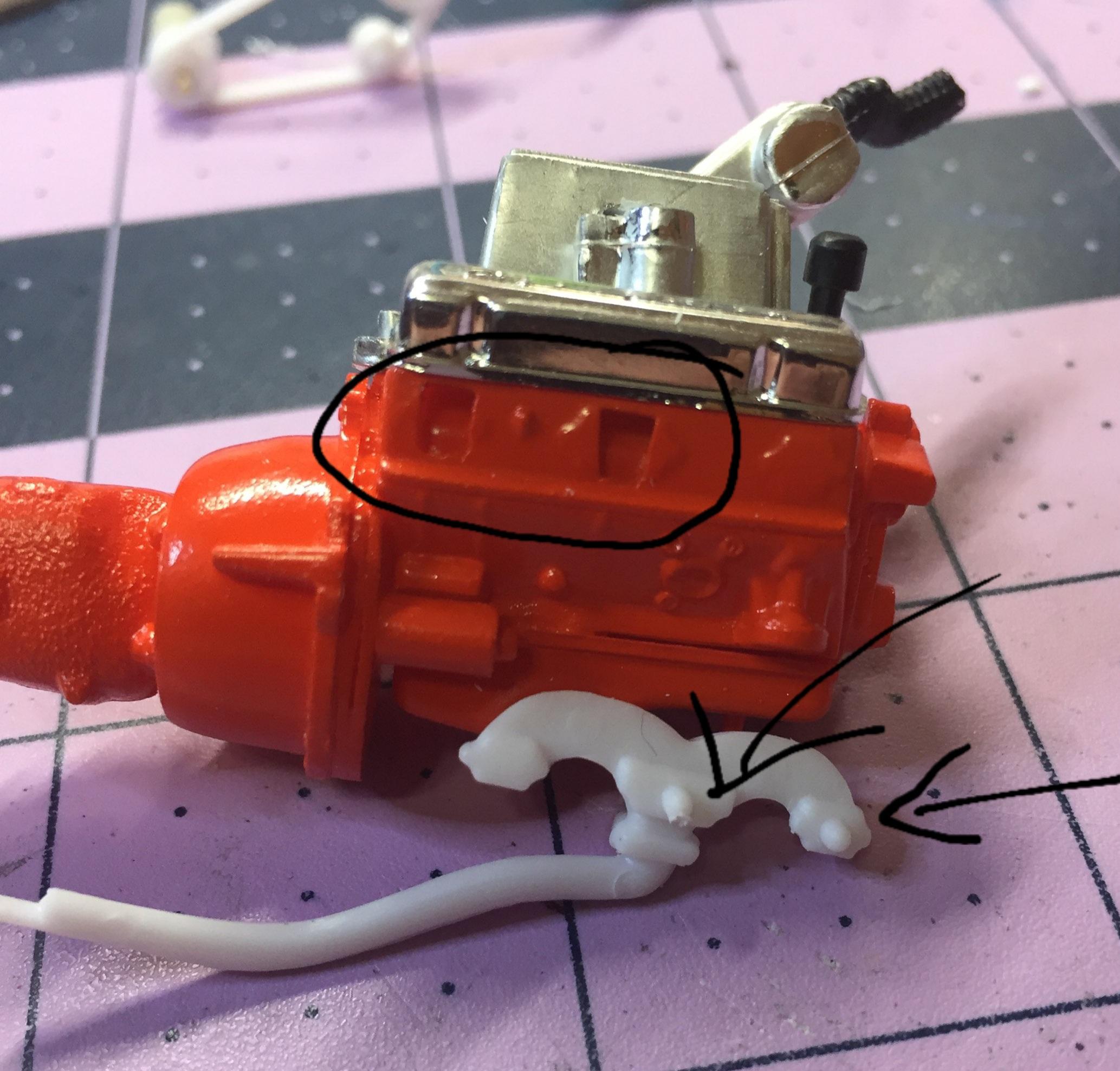

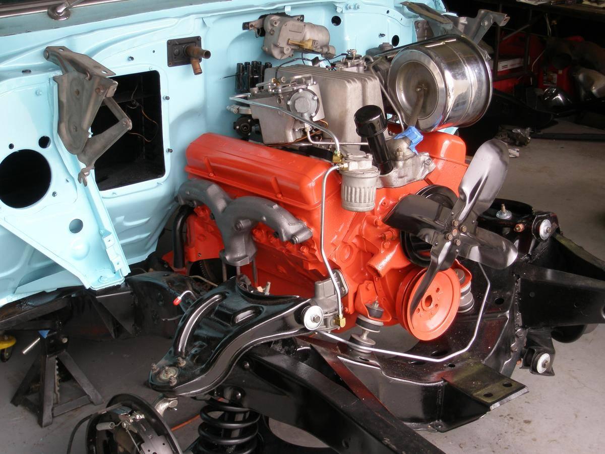

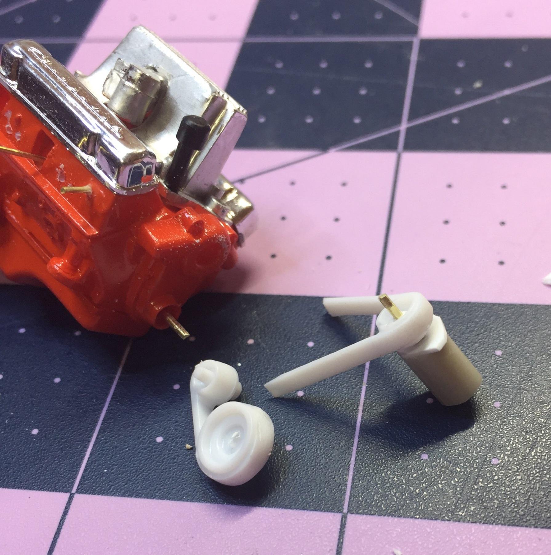

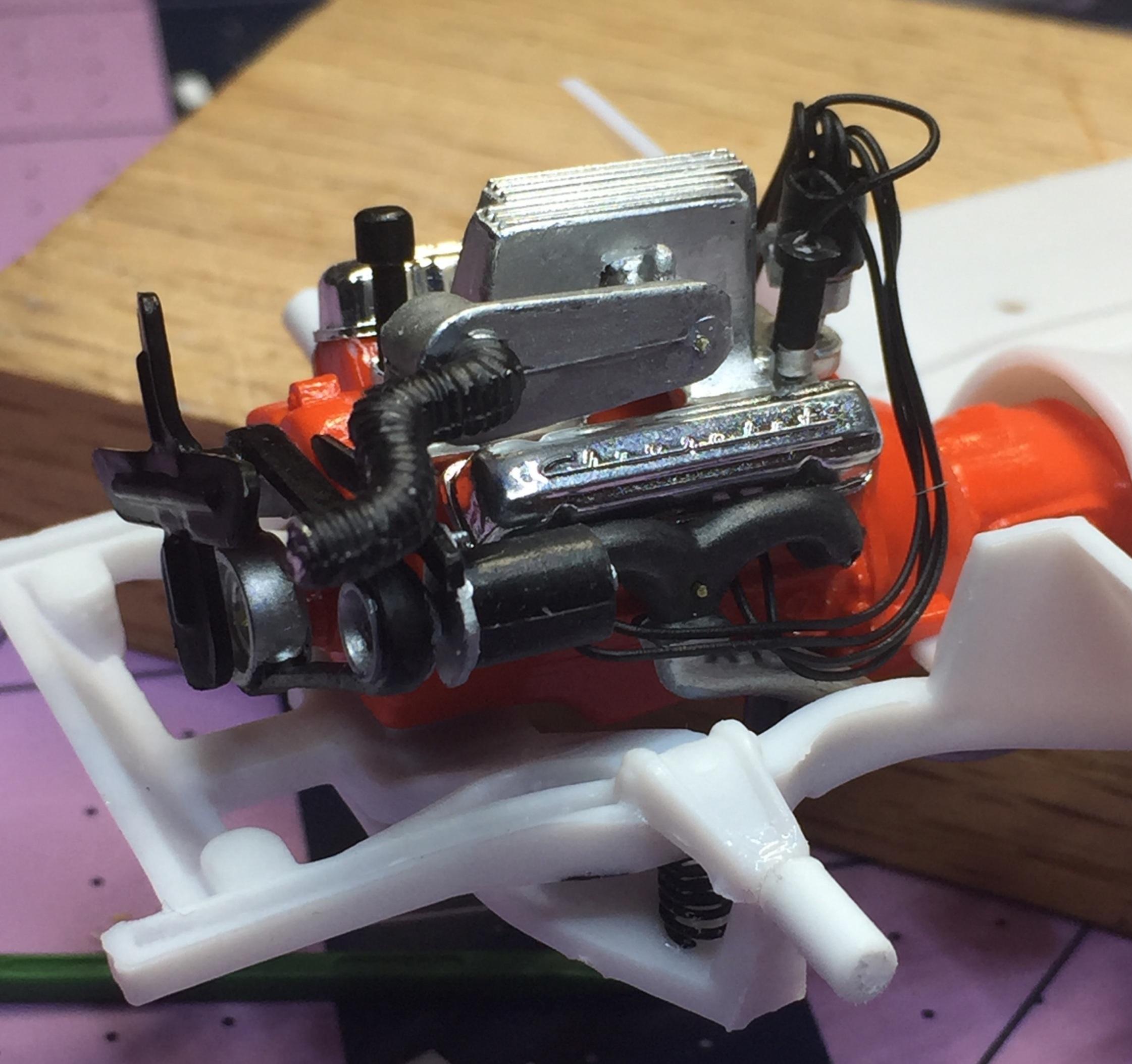

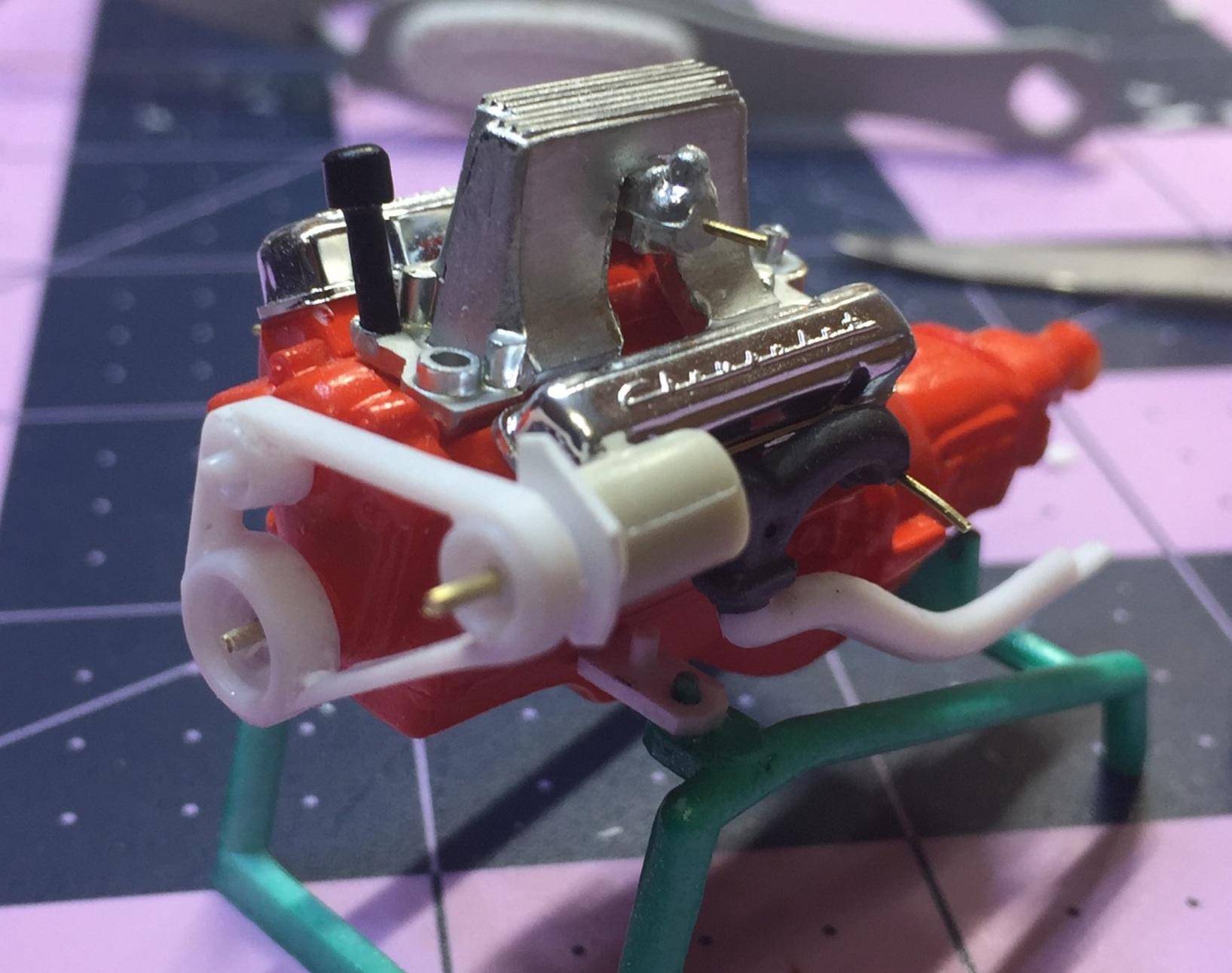

  2. I spent some time on the engine today, mostly tedious, neck-ache stuff like re-locating the "new" generator and ignition wiring. Threading the wires through PE looms...you know the drill. Anyway... One thing that hits you as odd is the way the heads locate the exhaust manifolds so that they may end up lining up the molded in pipes on the "chassis". I drilled holes and pinned them. Easy ?. Next I noticed the generator was not in the right place. In fact it looked like it would interfere with the air cleaner/intake duct so I decided the prudent thing would be to locate it where all my reference pics show. I continued to add an oil filter cannister of my own design, and a coil, and a oil filler. Then the dis..... well you know. there's a few more little things I want to add but my neck is killing me ?

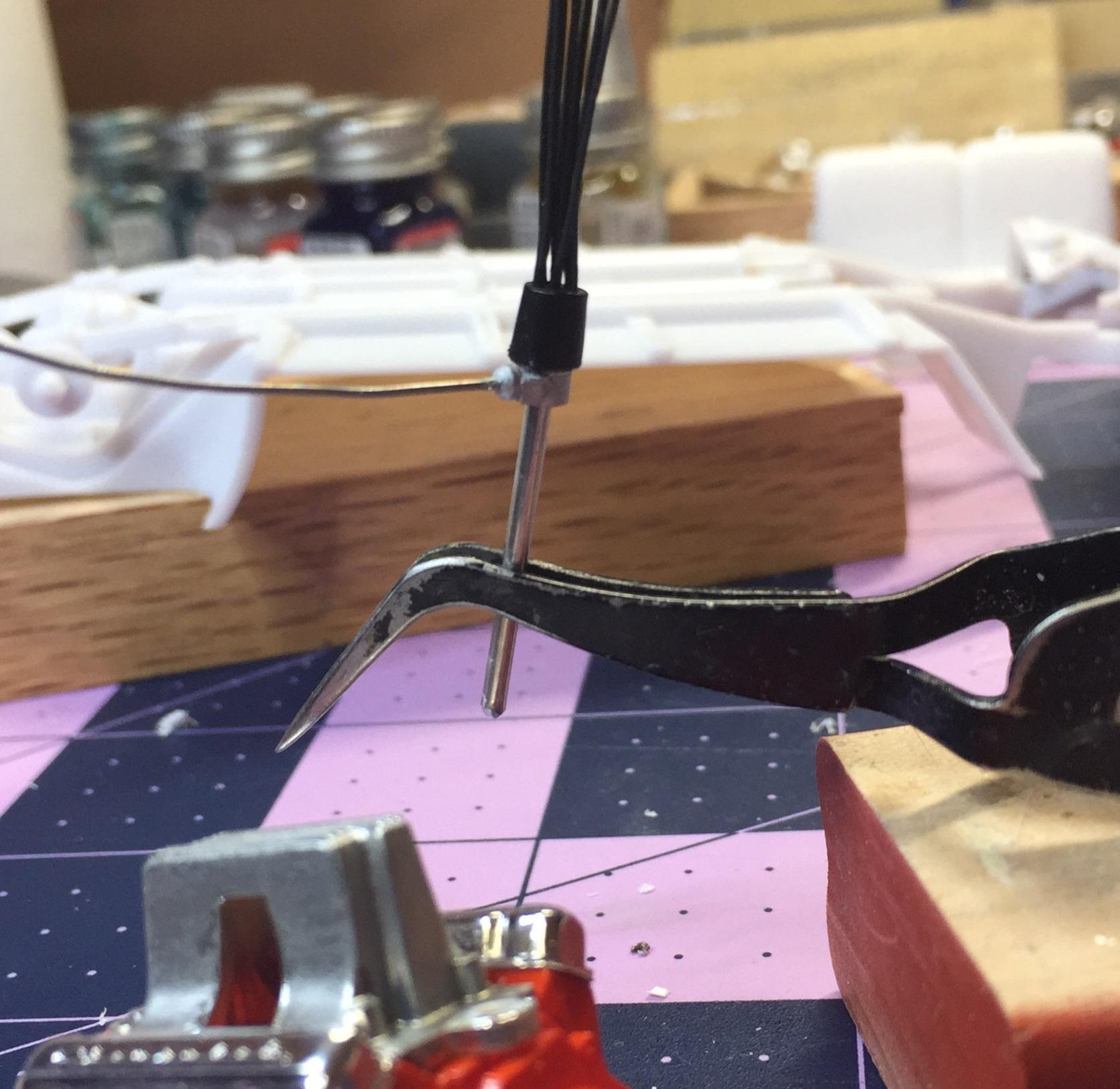

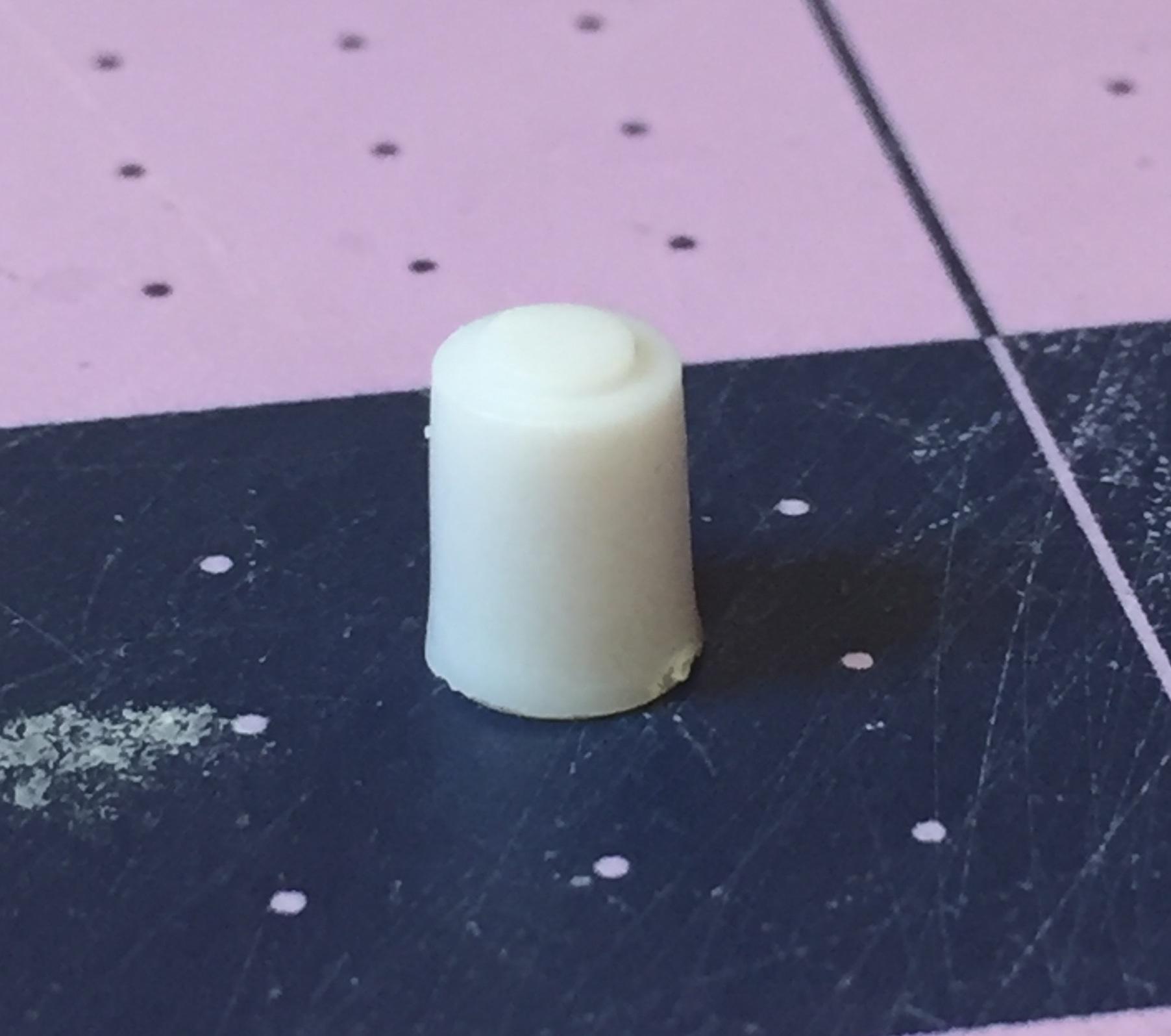

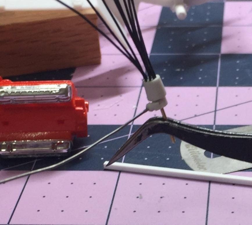

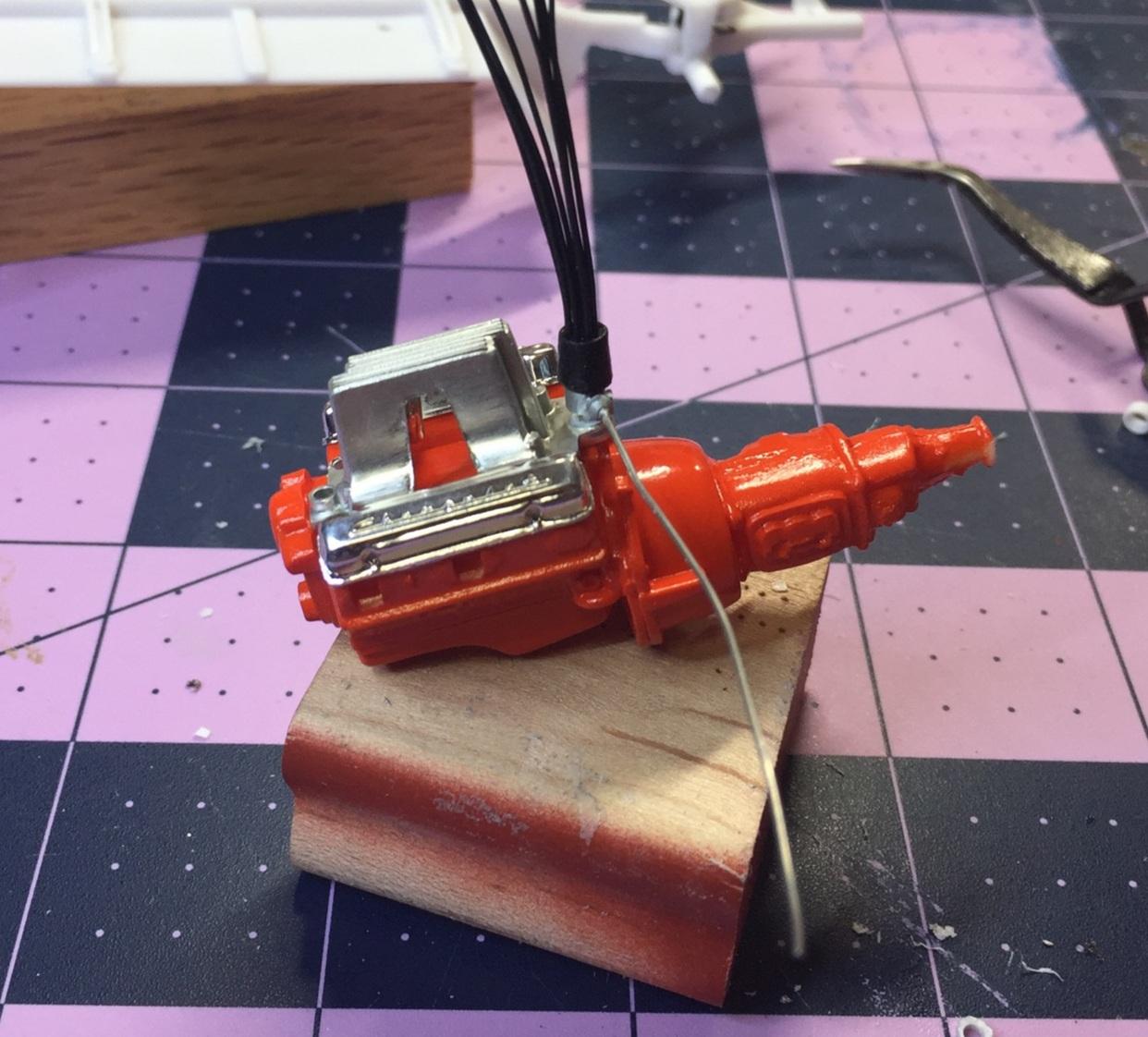

  7. Something that irks me (and probably you too) is that the small cylindrical items like oil filters and generators are conical. I get it though, they do that so it will exit the mold. But it bothers me enough to want to fix it. Its easily done so i won't bore you with the obvious. I recently discovered those cone shaped generators are ideal to serve as distributor caps! ?....well at least this time anyway. You even have a guide to drill eight holes around the raised center I inserted the wires through and, from the bottom, filled in with CA to form a solid unit. After it was cured I cut it to size and added a slice of styrene tube to act as the housing and drilled the bottom for a short length of .032 brass wire. Then I gaffed a vacuum advance, painted it like a stock item. I removed the molded in distributor and added an aluminum tube to act as a sleeve and look like the shaft housing. I messed up the angle when drilling the hole to accept the new distributor but don't worry, I feex. Later. Now the reason I had to fab a distributor: See the 1:1 ? See the teeny-weeny 1:24? That's why. ? I'm starting to like 1:24, it's easier to work with ? Next up: repositioning the generator- next for me, that is ?
