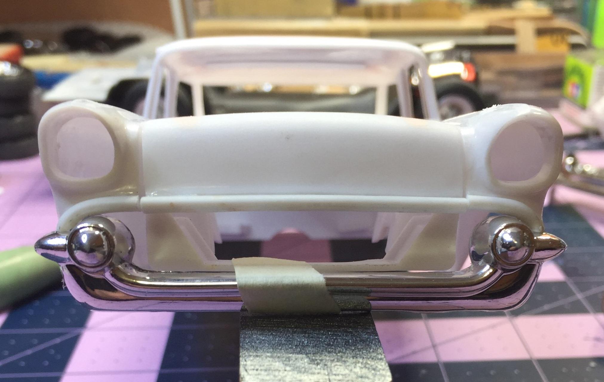

Bumper update: this is the one đ Tucked in tight and pinned. Now I need to get it smooth. Smooth enough for chrome. Thanks for stopping by đ§âđ
What about casting another Weber? Or modifying the funny one? Nothing to lose by trying. Floor pan looks fantastic, Dennis, can't tell it's not "real" đ

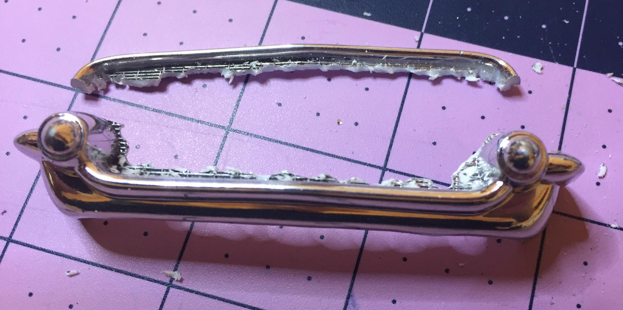

And now for something completely different. You may recognize my next victim as the rear bumper from the AMT/Lindberg '53 Ford kit. The overriders needed removal. I figured that process would naturally narrow the bumper more than enough so I would be left with two ends and a center section to be rejoined. Then I would need to fill the two gaps. I bonded the bottom of the three pieces to a sheet of .020 while set in place against the body. I then glued a length of .060 half-round to the inside of the bumper parts and reinforced with more thick CA, partially filling the two gaps. Afterward, I removed the sheet foundation and work will continue on filling and shaping and sanding. In the last photo, I have added a piece of .010 sheet to the top of the bumper that will be shaped to match the contour of the rolled pan. That's all for now. Thanks for your interest.
