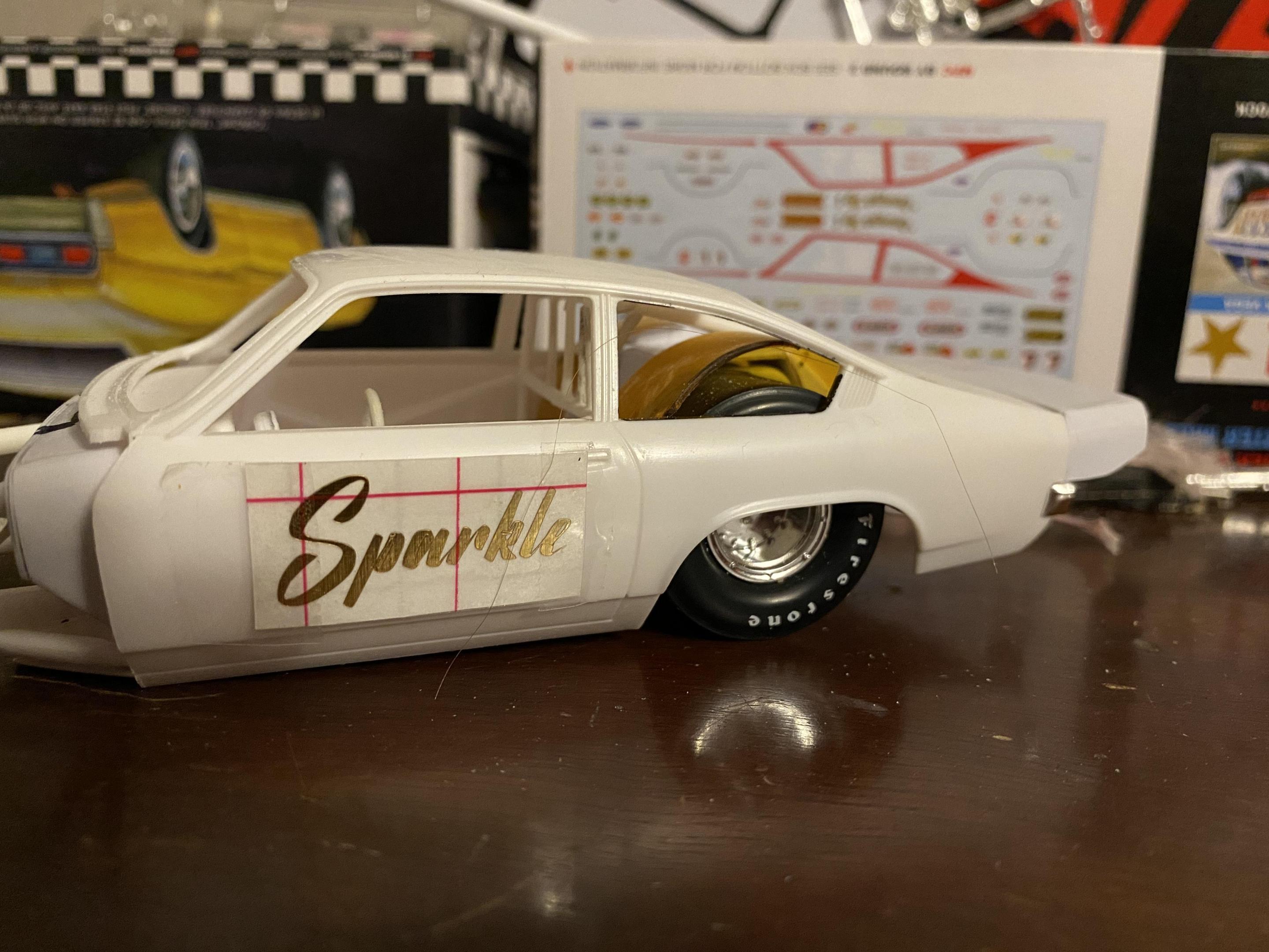

If you have someone with a cricut cutting machine, i realized they can be use to cut custom vinyl letters for the sides of your race/drag cars..
For the guys who have a wife/girlfriend/significant other who has a cricut cutting machine, you can print your own vinyl decals with whatever font you’d like. I want that old school gold leaf lettering look so gold vinyl seems like it gonna do the trick. I’m naming the car sparkle party (paint to come) I’ll outline it with black and boom..,

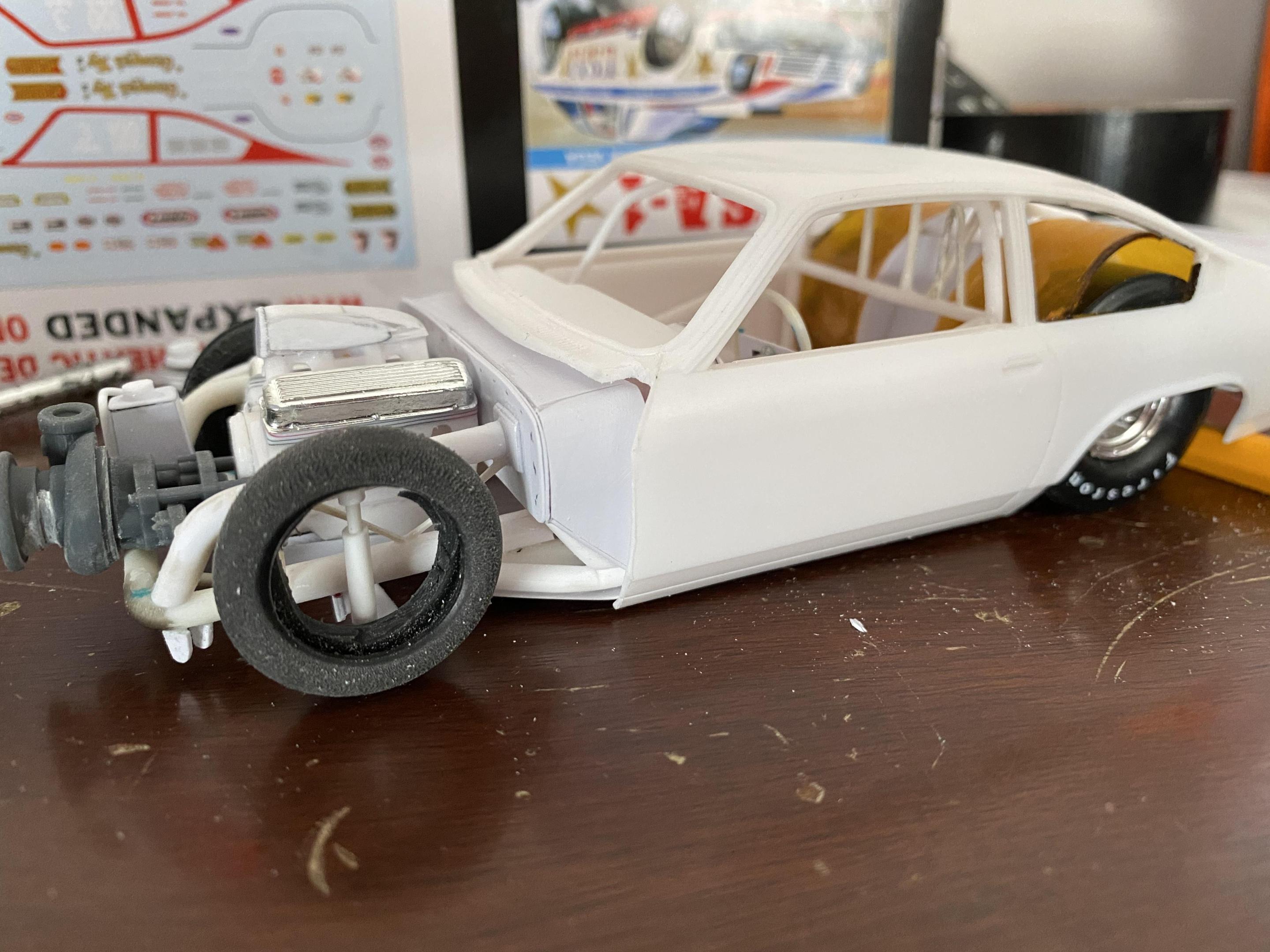

well the old Vega got a pro charger added to the motor which may get the motor moved back into the firewall a bit.. front suspension is starting to come together, four link is being built for the rear and hopefully this thing will run into some paint soon.. this Vega was the inspiration for all this, just lower and meaner but paint wise I’m looking at a green/gold metal flake party…

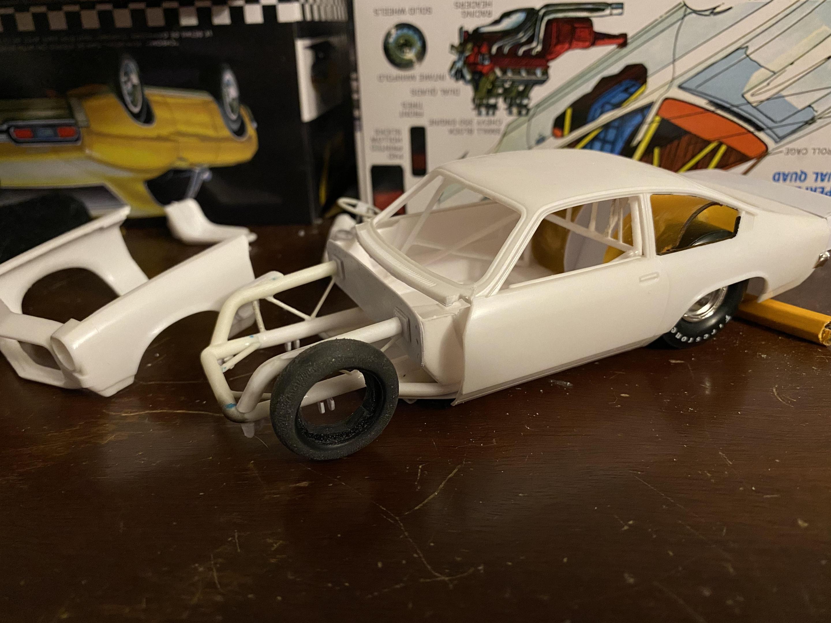

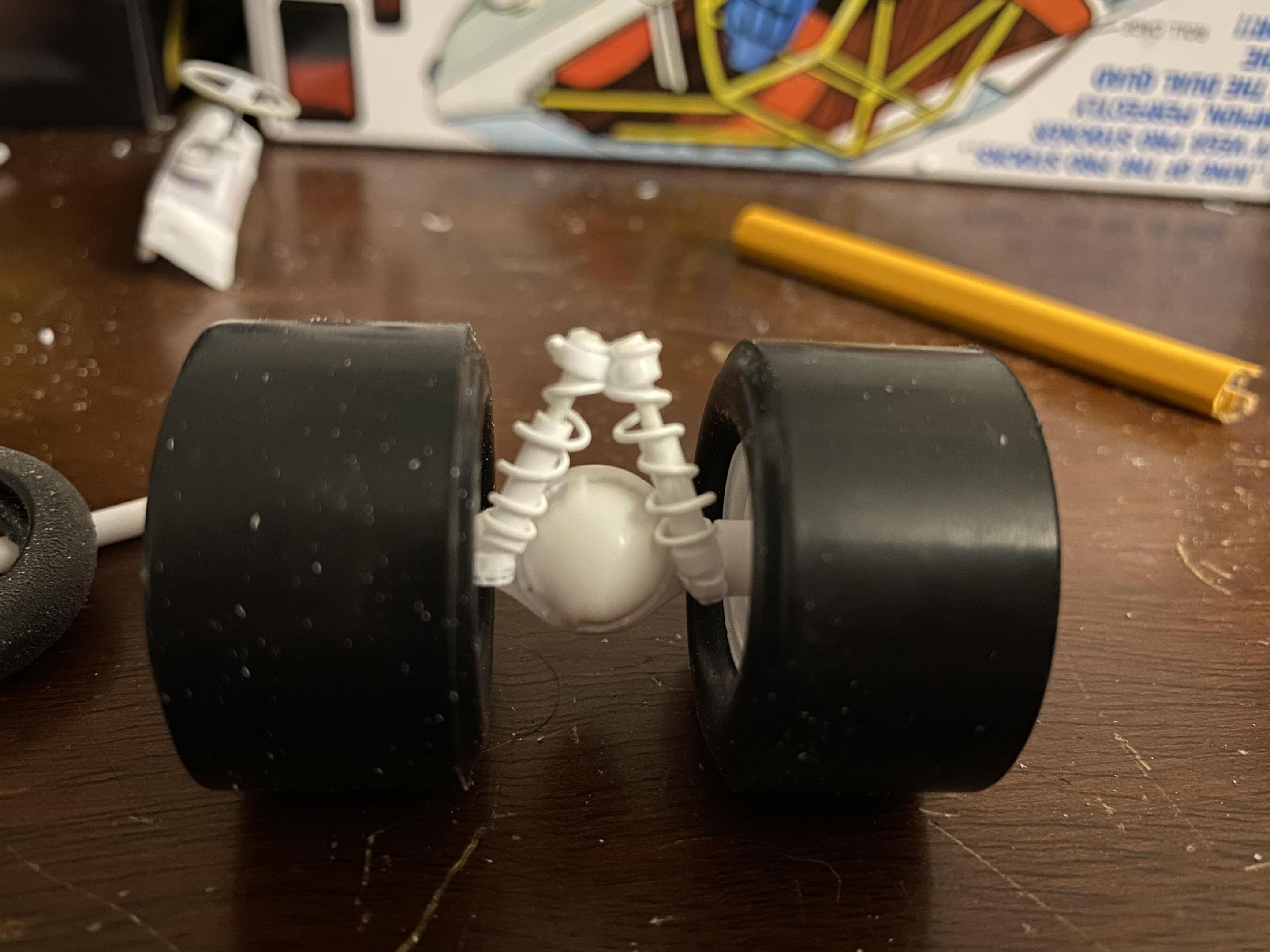

scratch built shocks and springs for the rear end and for some reason I decided to make the front end removable.. it’s going somewhere, stay tuned to see where it ends up..

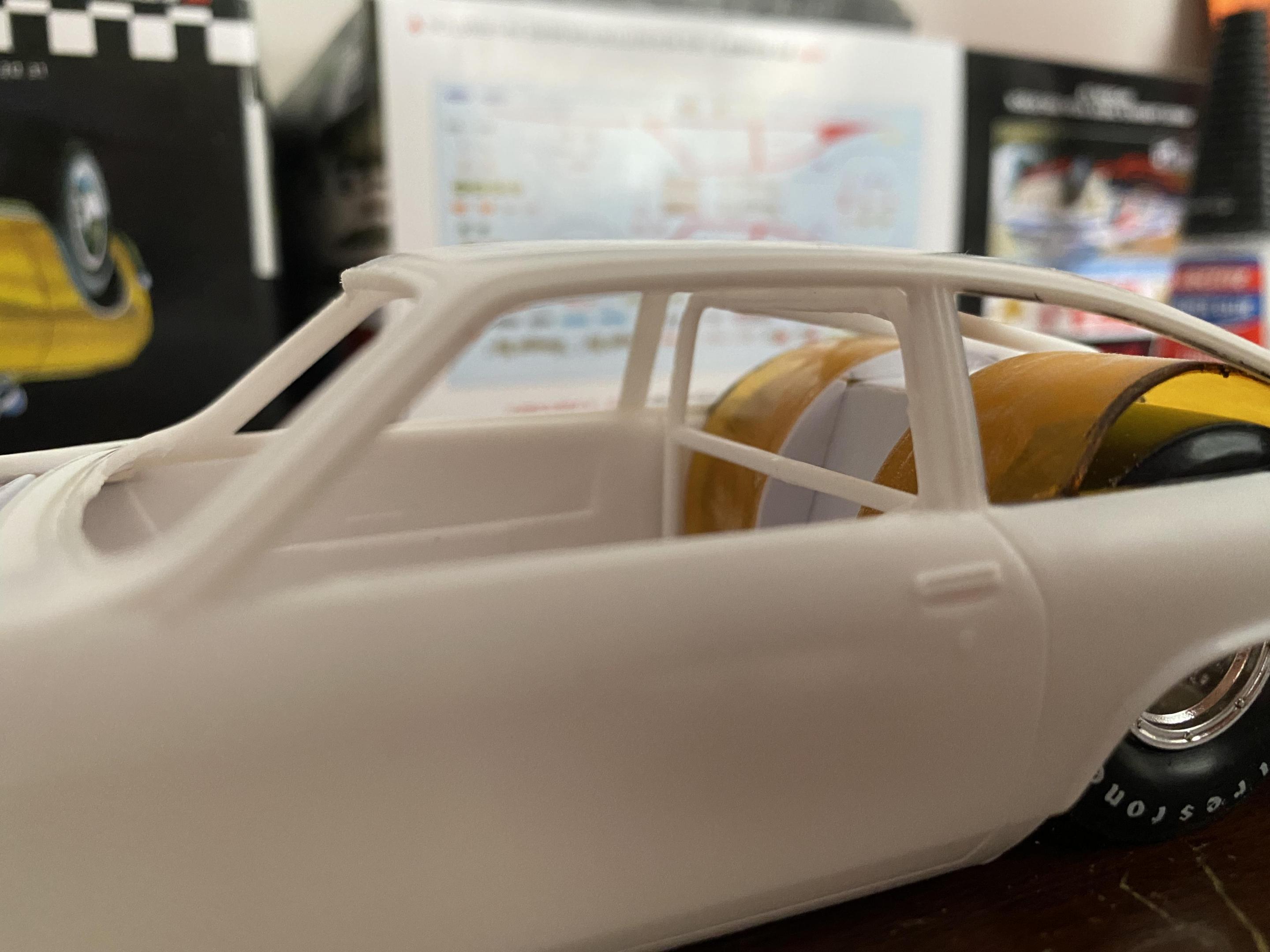

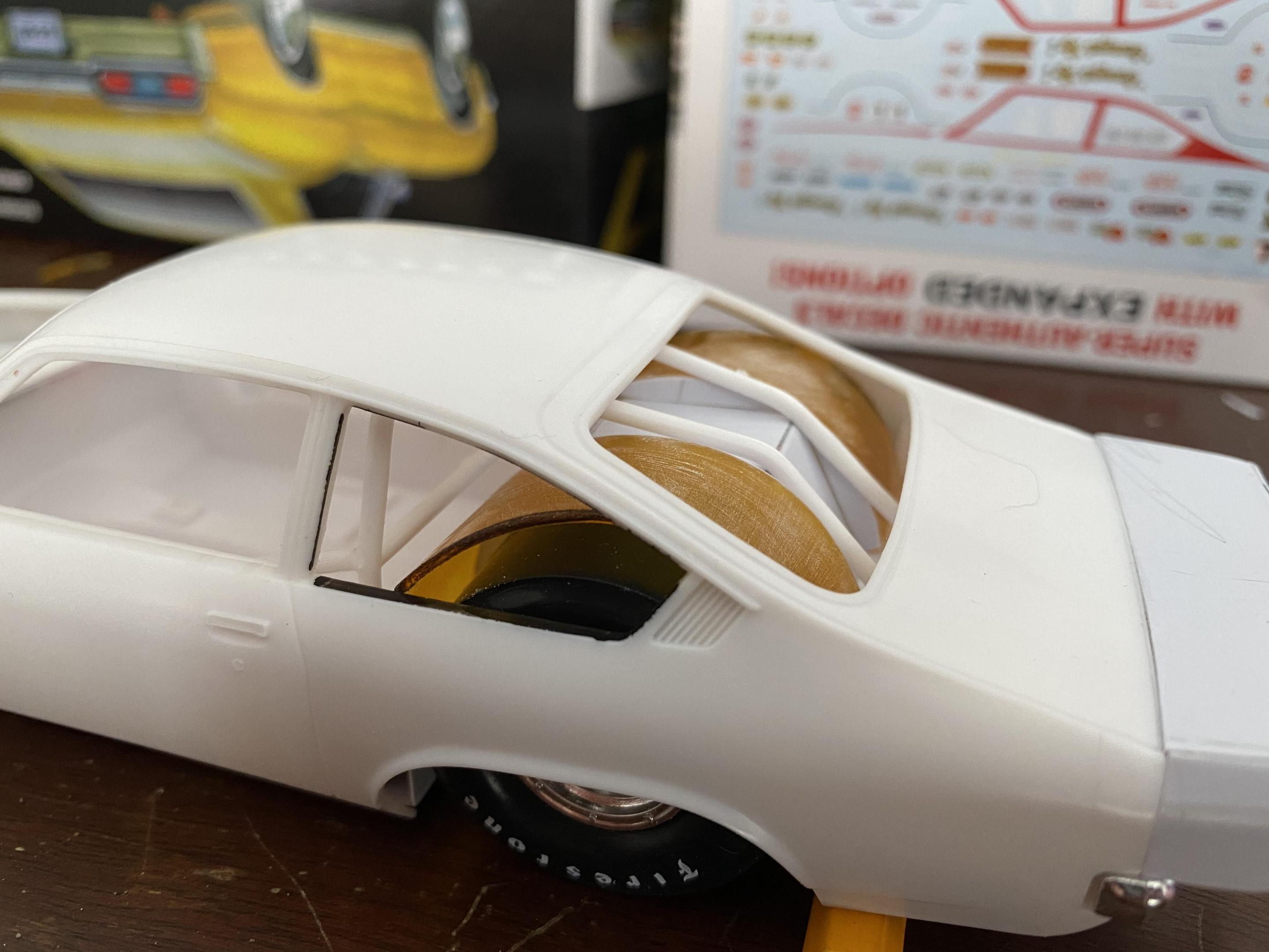

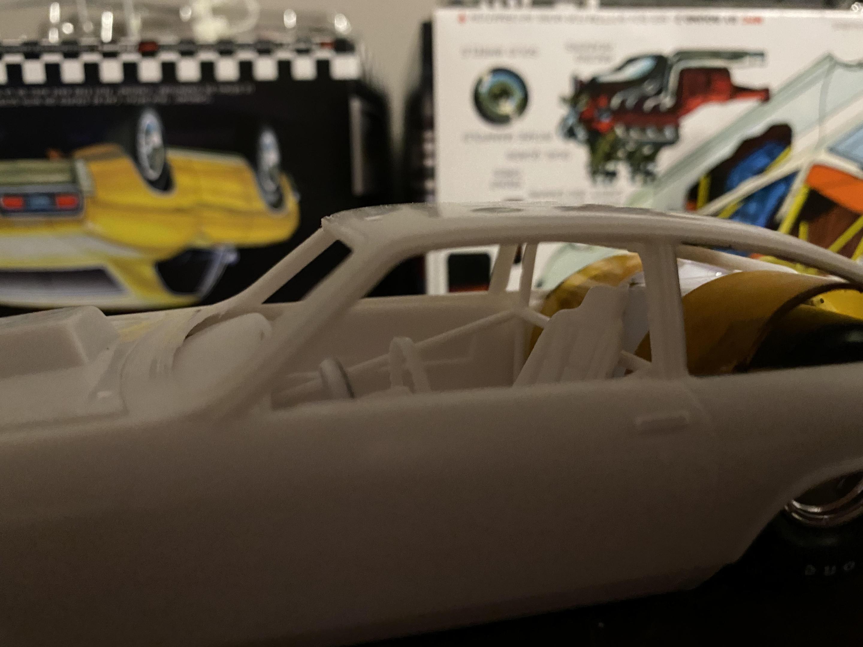

Rollcage a little further along, seat mocked up, scratch built race pak mounted… slowly getting there

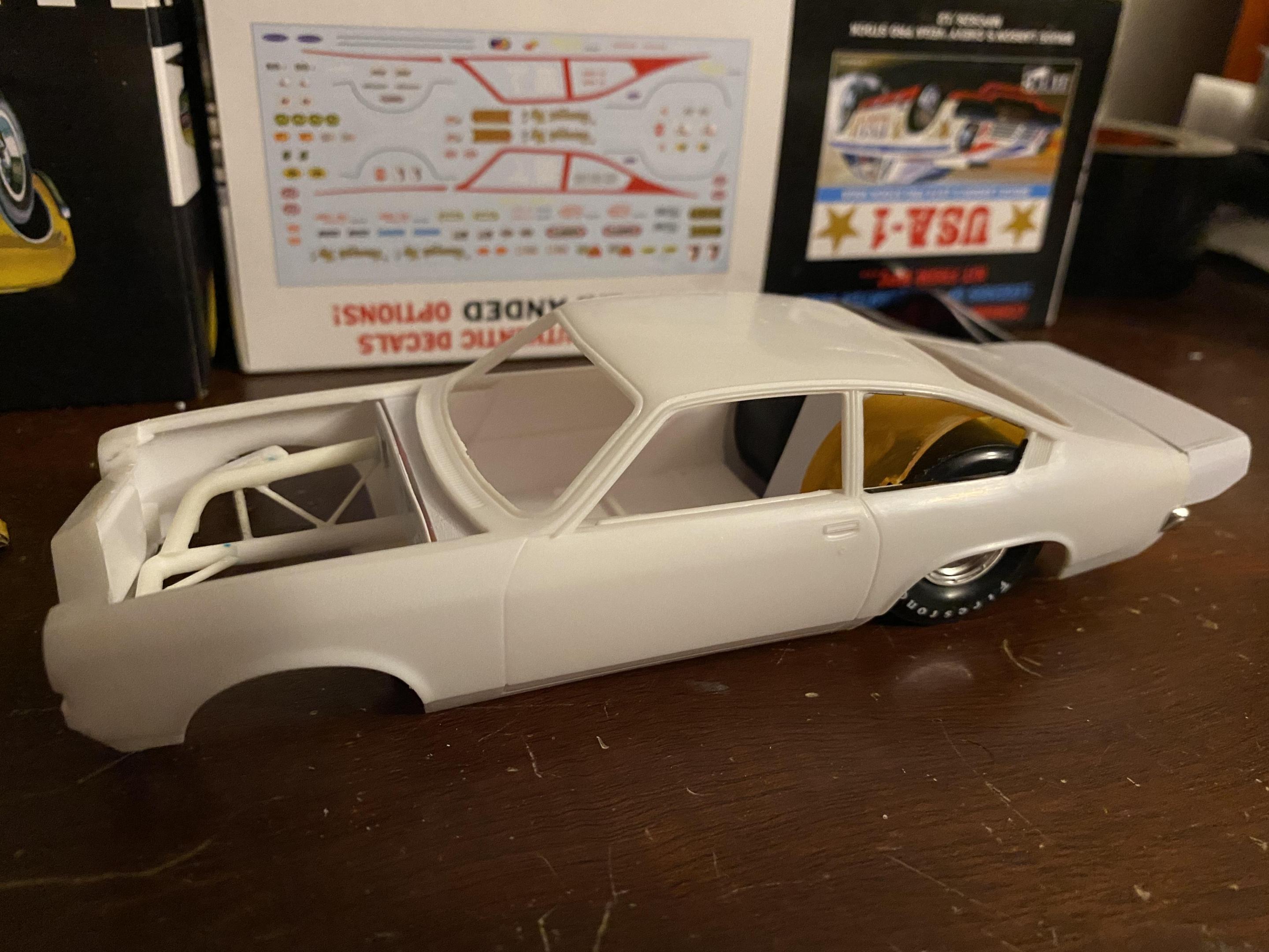

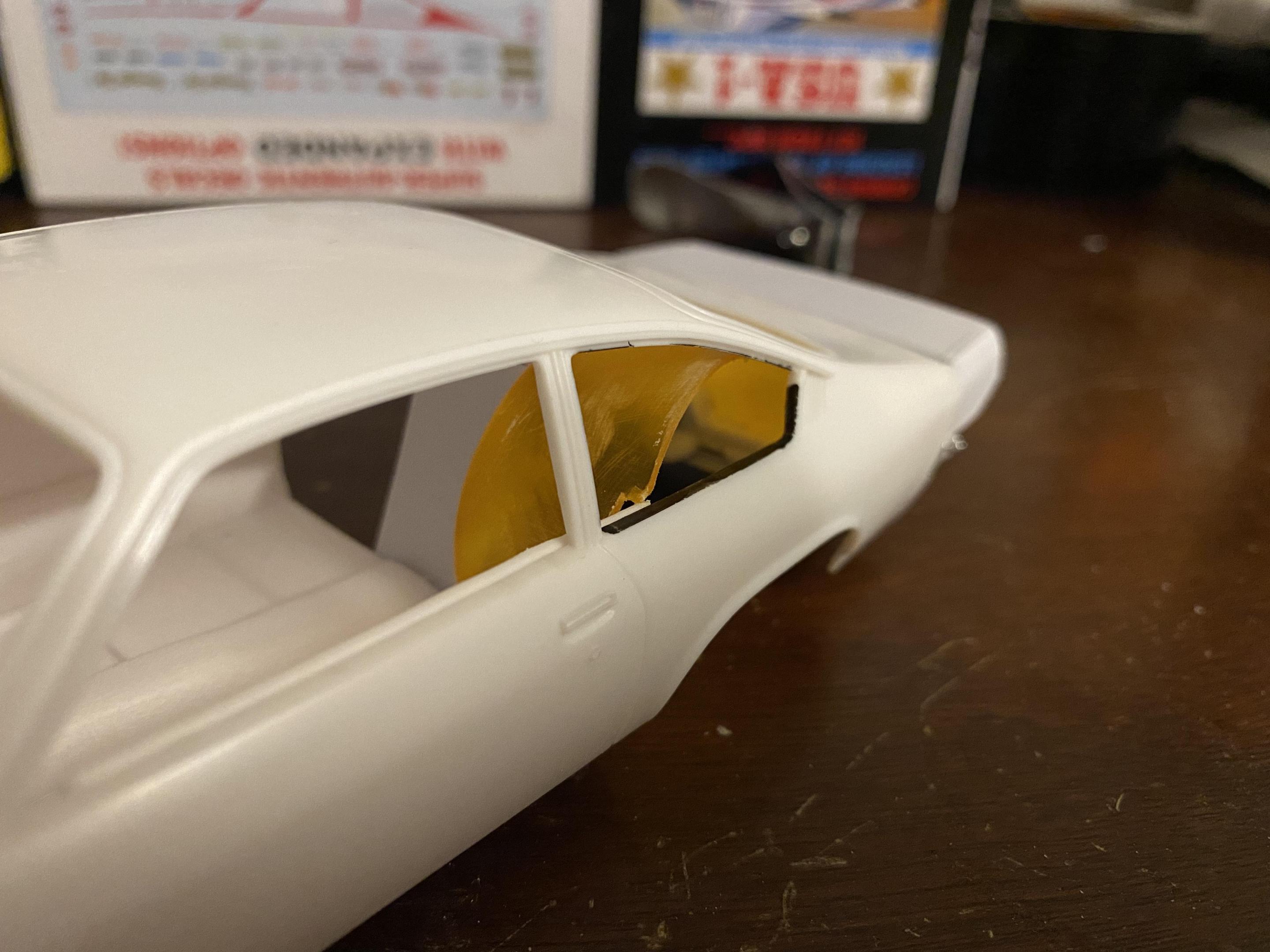

tubs done rollcage started.. surprisingly this thing is just kinda cruising along which has been really nice..

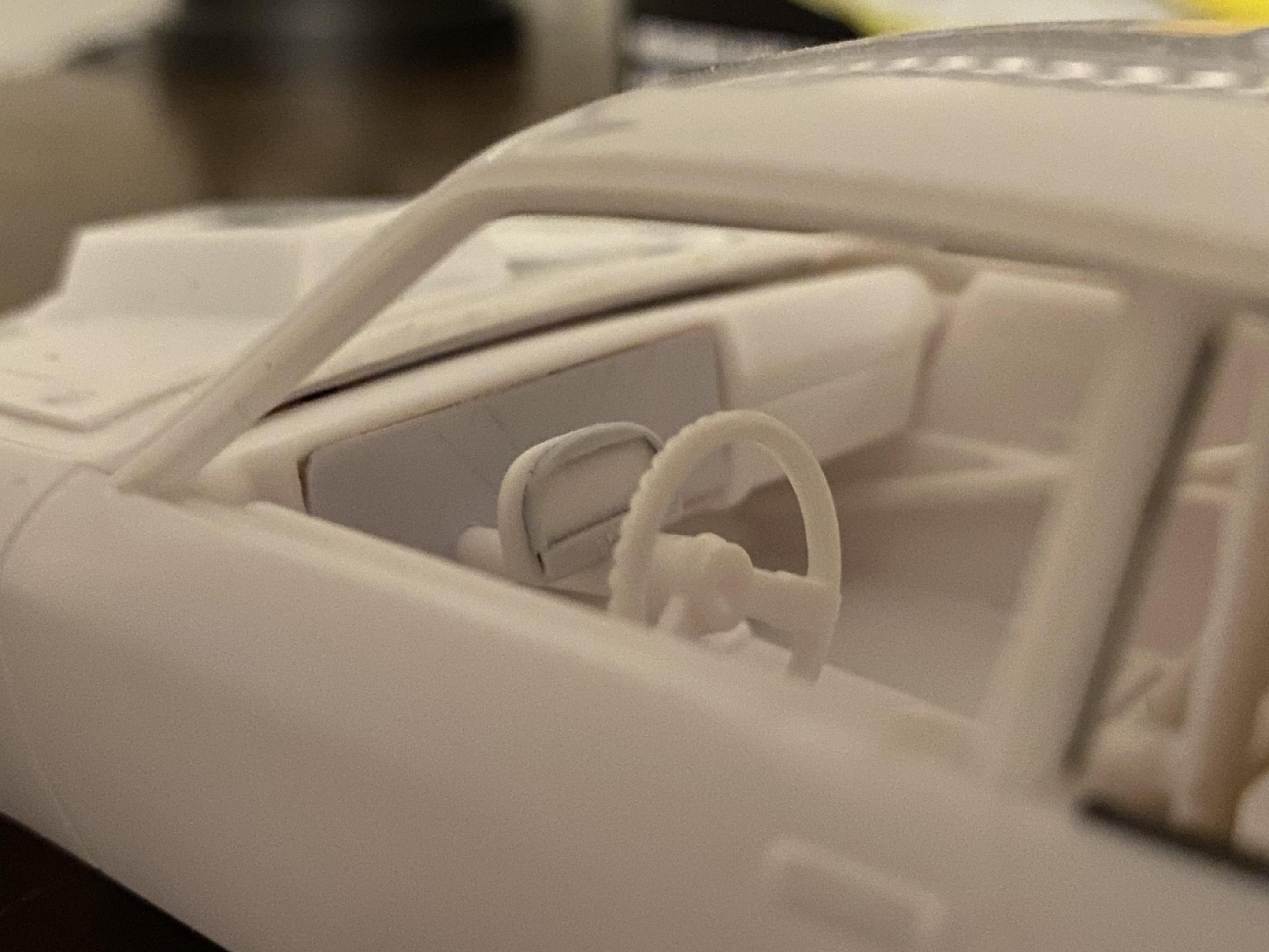

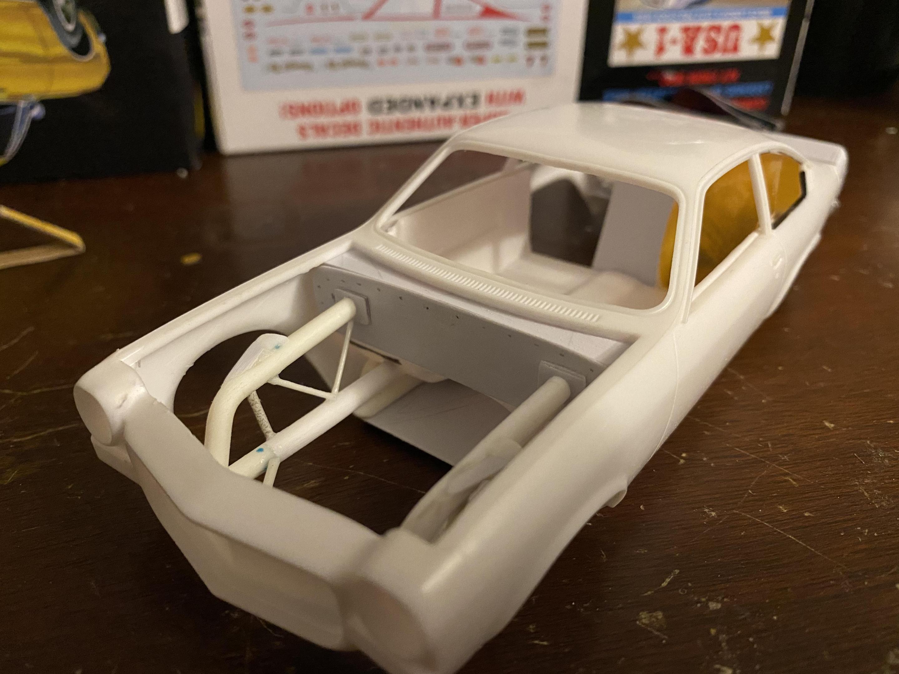

Front frame pieces, firewall done and one tub in. Hopping to finish up the other tub in the next day or so and get even closer to paint. Have to build the front and rear suspension mount the motor and build the rollcage…
I don’t have access to “tubing” so I used a few parts trees sanded down to the thickness I needed.

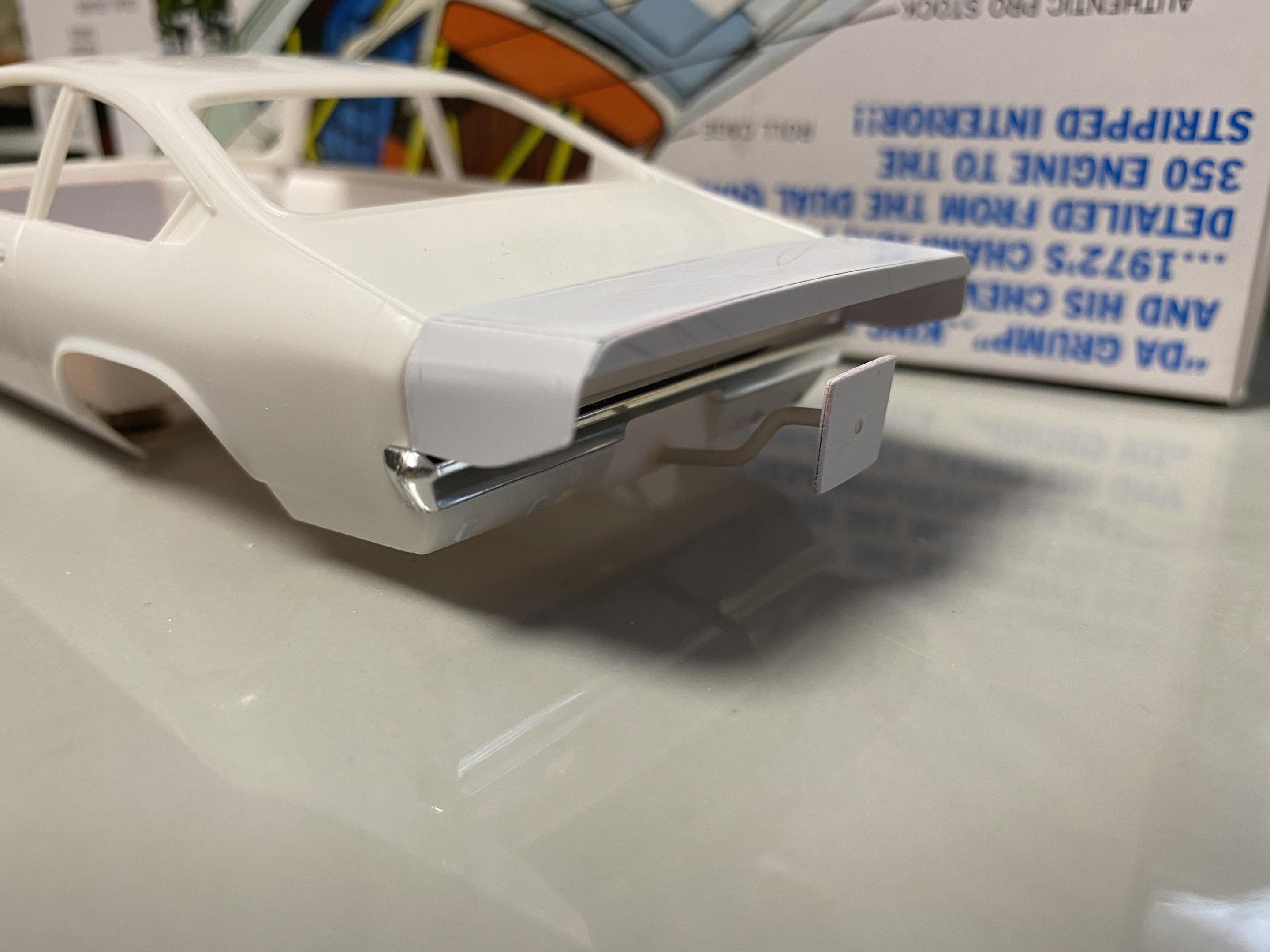

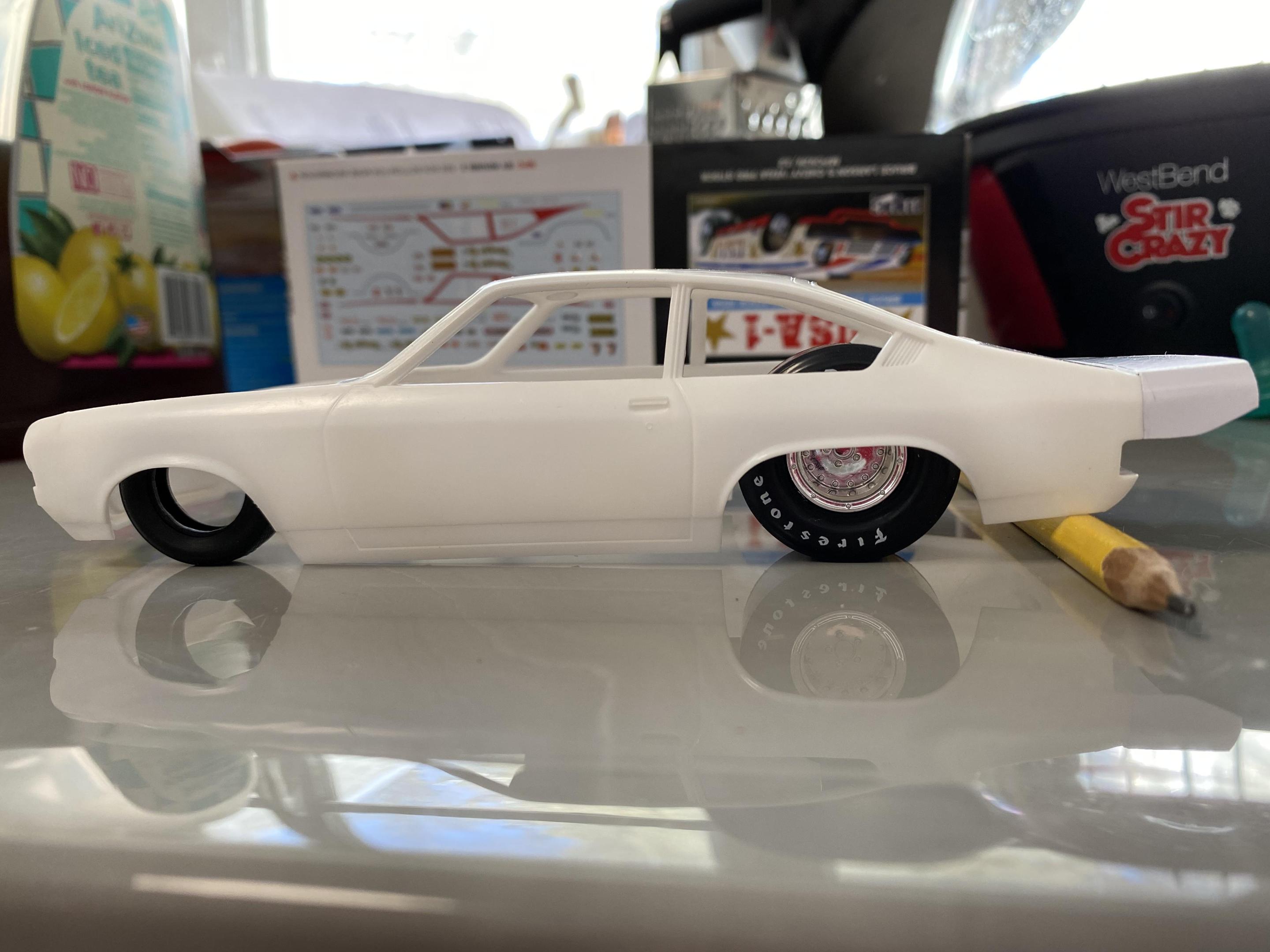

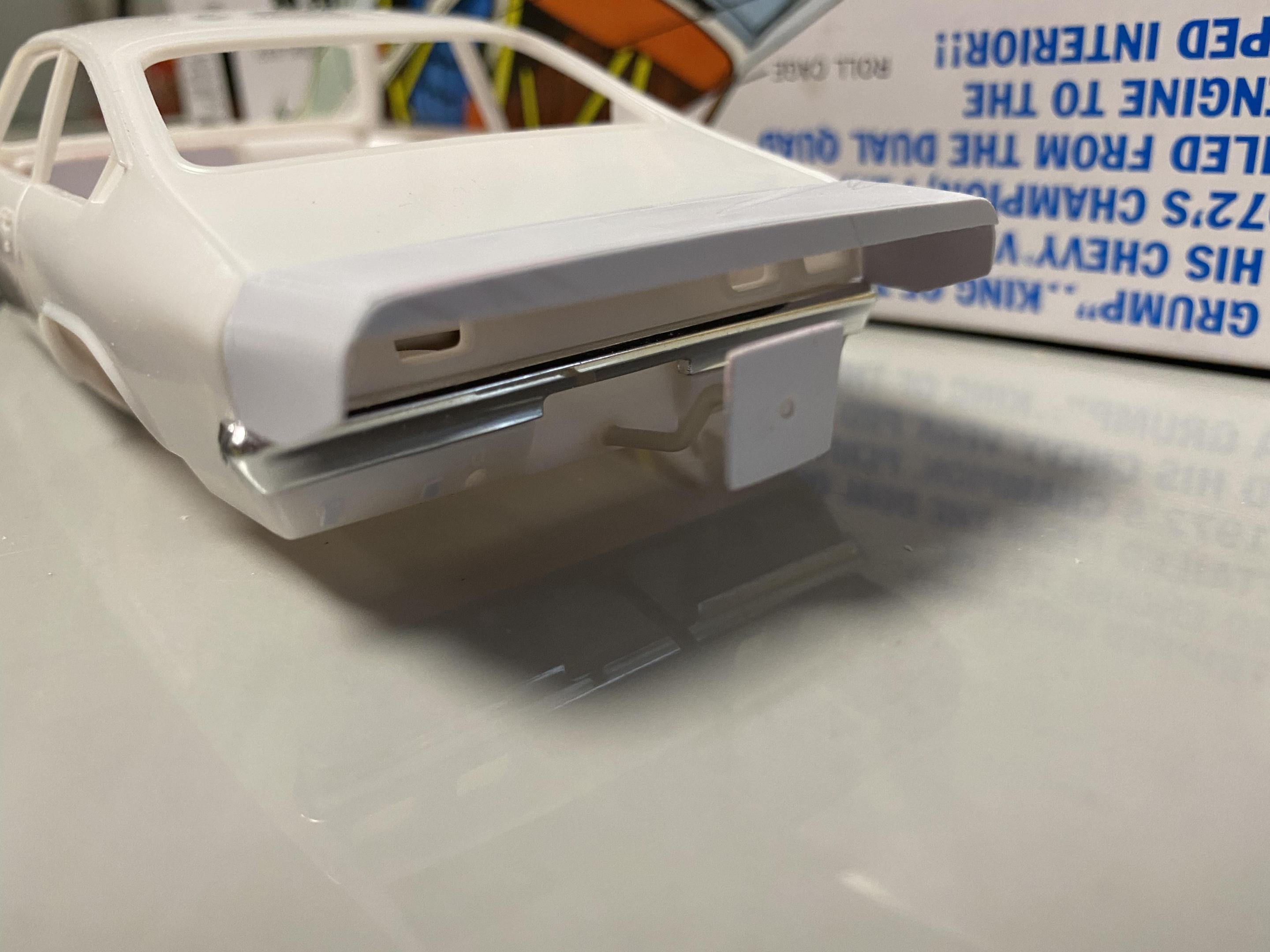

Started working on the grumpys vega pro stock kit, things got out of hand lol… tube chassis, lower stance, scratch build wing and who knows what else my brain is gonna come up with…
