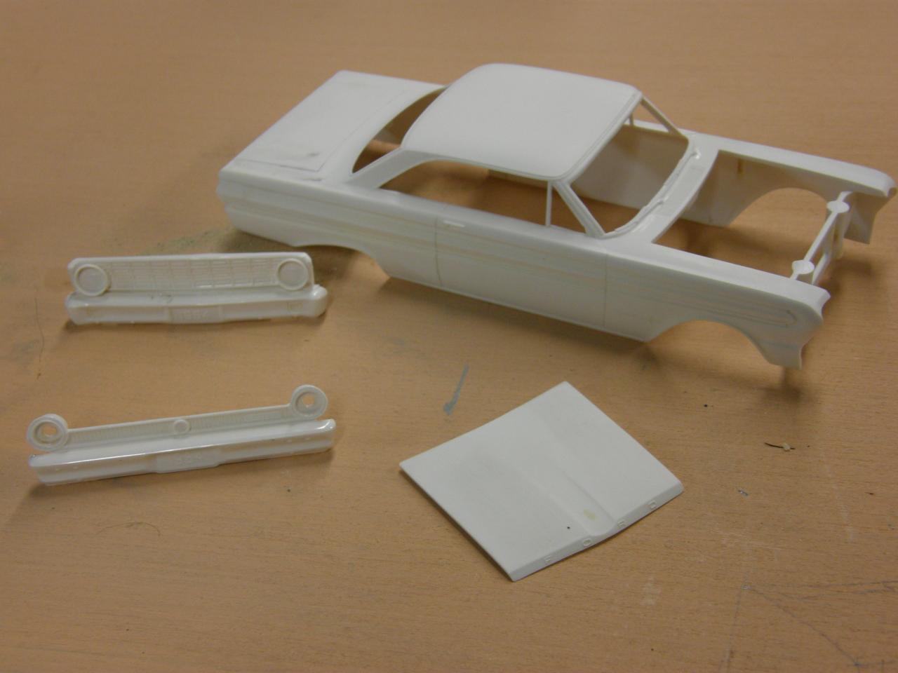

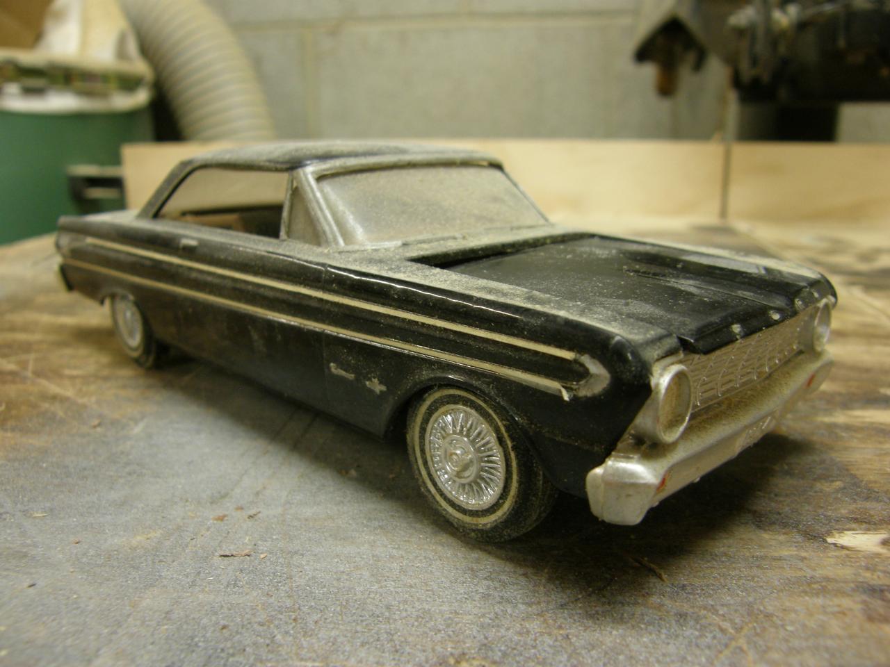

  7. Wow...I just got my old Falcon out of the purple pond. Never used any paint strippers at all before. This stuff really worked nice. The body and bumpers/grill came out like it was fresh out of the box. NOT the same story for the interior, though. I can't remember what that 15 year old sprayed on the interior. Must have been something my Dad had lying about. Guess I'll try 90% denatured alcohol...but it looks as though the surface has been "lacquer" attacked. We'll see. D

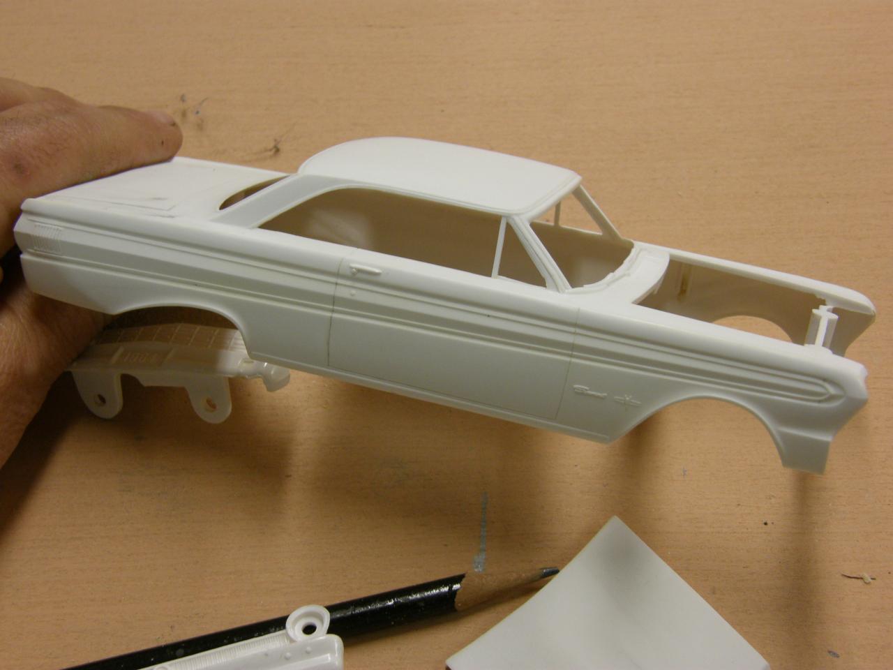

  10. This weekend my wife and I saw a "wine" colored 1:1. So I decided to take the step of starting the "rebirth" of my '64 Falcon. First put together 50 years ago. (I was 15!!) Now in the Purple Pond. wish me luck. D

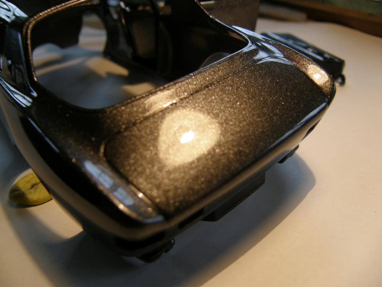

  17. Got some update pics to post. This is the result of wet sanding from 3200 through 12000 grit. Never did this before in my life! Wow am I happy with the results. Burned through (2coats of paint and 3 coats of clear) in only one little spot on the drivers side front fender tip. A little touch-up with brush and 12000 grit should "fix it". Next mission: Bare Metal Foil! Then, I guess Novus 2 and wax. Thanks for lookin' in... D

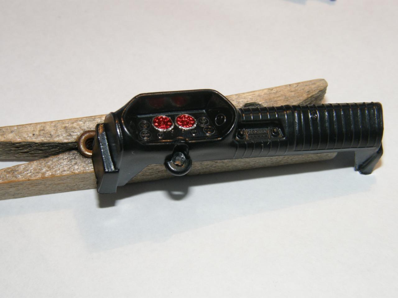

  18. Thanks Ken. All Studes in '63 & '64 had the option to have RED instrument lights. The new CEO at the time was an aviation nut and wanted the dash (especially in the Avanti) to have an aviation theme. I used a circle template and cut out BMF just a little bigger than the outside diameter of the gauges so the outside edge would overlap and give the appearance of a bezel. Then I put a couple drops of Tamiya clear red in the middle and let it settle out. Now I have to do the other 6 smaller gauges the same way. The effect on the radio is purely accidental! (I just picked it up and looked at it under a magnifier and, to my eyes, it doesn't look that way at all.) Go figure. Don't know what it is. I intend to BMF the radio anyway. They always say that "the camera never lies", huh?!. D

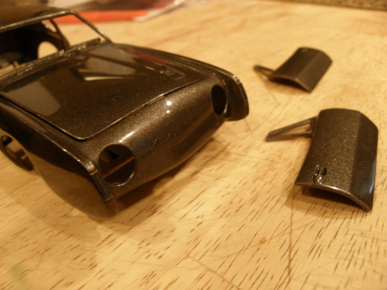

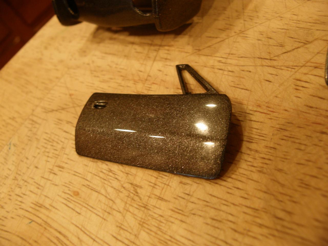

  20. Ok folks...I promised to post the results of my first shot using the Detail Master polishing kit I bought. All I can say is, "holy meadow muffin, Batman!" This worked out splendidly. Give a look. Untouched (3 thin coats) DupliColor clear on the trunk...then 3200 through 12000 on the roof. Unbelievable. I am impressed.
