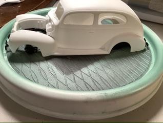

  5. BY GEORGE I THINK WE’VE GOT IT! Thanks to all, hot water and slow gradual progress worked. Might have some seam issues to deal with but no big gaps anymore. I reckon this type of stuff is what this forum is all about, thanks for walking me through it. I really, really appreciate the interest, expertise, patience and wisdom. I drove this car my first two years of college long, long ago and this model is important to me.
  6. David, this might just be the ticket! Seems to be helping a little each time. I’ll continue this very gradual process. THANK YOU! David, there is no mention in the instructions and from what I see, there is no cross member to remove. There was a sprue to be removed but it was on the outer side of one running board. Thanks!

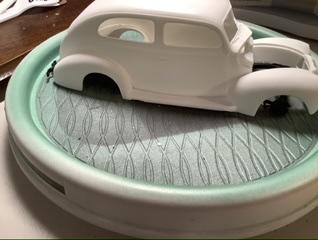

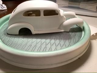

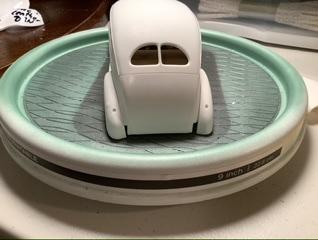

  8. Yes, the body seems fine. But, then again, the fenders look ok to me, given these old eyes, but no flashing is visible anywhere. I am thinking about rubber banding the body to the fenders, then dousing the whole thing in a pot of very hot water for a few seconds and then letting it cool before I take off the rubber bands to see if that might work to force it to fit. Thoughts?

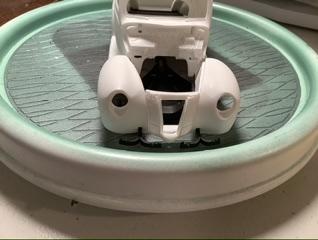

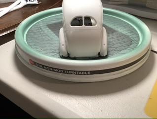

  9. Tried some more sanding, nada. The fenders do have the little protrusions on the top and the body does fit but then jus rises up unless pressed into place. I think I do near some “heat”. So, like a hairdryer? Just hold it in place and apply heat? How do I do this?

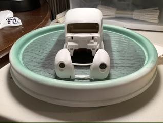

  10. Both the body and the fenders look to sit flat. No gaps that I can see. I might just try to take a little material from the drivers side of the running board area, though it feels the same. Whatever it is it’s minute, just enough to not allow it to sit as it should. After work, I’ll check the fit on my 40 ford panel unbuilt, to see if it’s the same. Thanks for the suggestions, keep em coming!
  11. I know, that’s why I put the interior tub in. It’s not the interior holding it. The same thing was happening when doing fit checks without the interior. The body will meet the fenders if I press it down but not sure that it will stay after gluing. Any other ideas? This is the kit, anyone else had this issue and how did you correct it?
  12. The body just does not want to nestle into the fenders. Done a little filing at the joint, seems smooth, no high spots. Do I have warped feeders or body? If so, how can I correct it? thanks!
