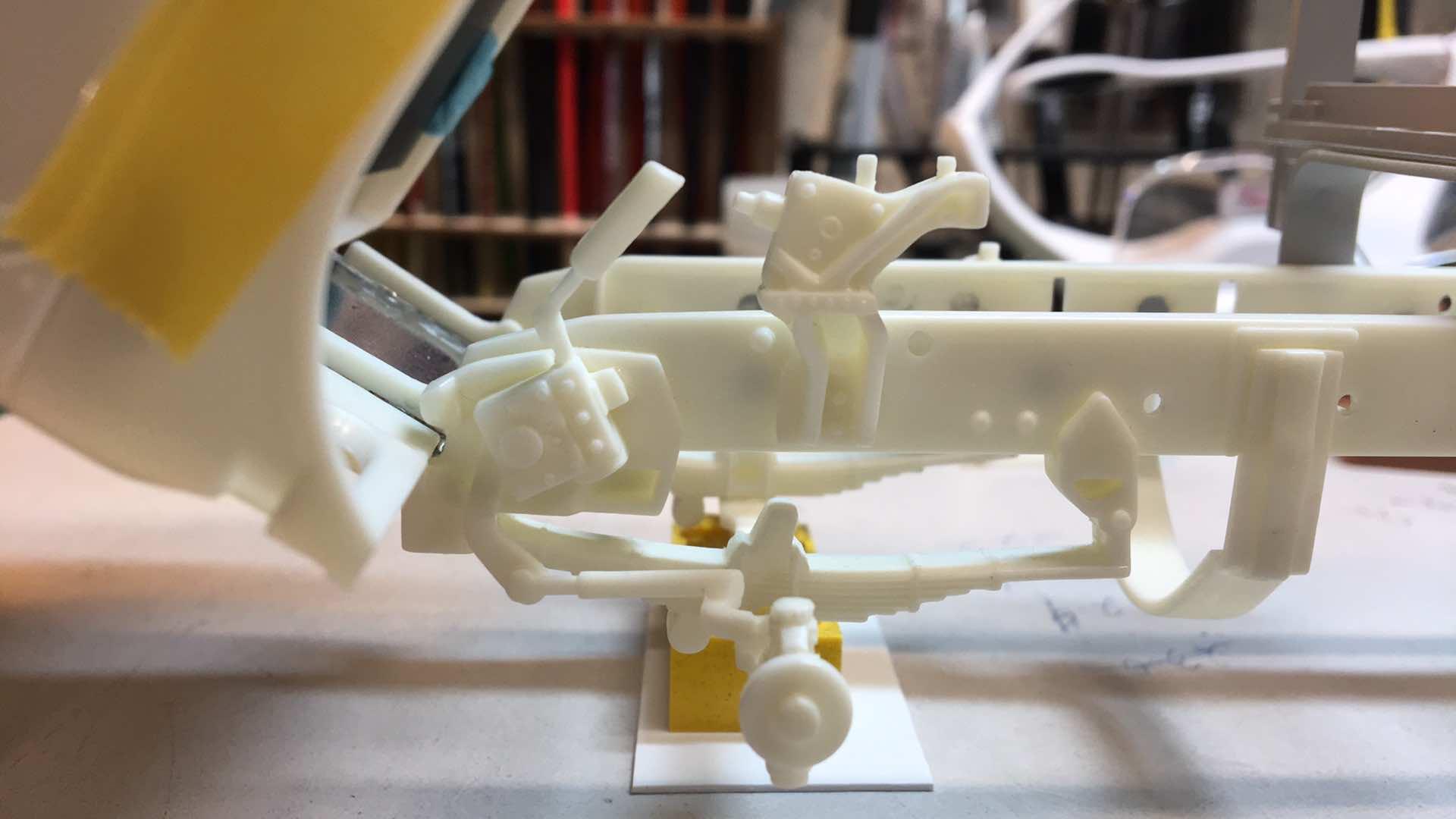

  4. I tacked the steering box on, but I think it needs to be "rotated" more counter clock-wise so that the shaft is more forward where it meets the cab floor. The steering shaft would come down I think right at the front of the tub floor.
  5. Thanks for posting the photo. That helps a lot. I'll try tacking mine in that position and then see how it works with the cab lowered. I'm guessing there's some trimming to be done.
  6. Am I on the right path here ? Best I can tell from the instructions -- it looks like the short leg of the pitman arm goes upward. Now part #7 is the mystery for me.

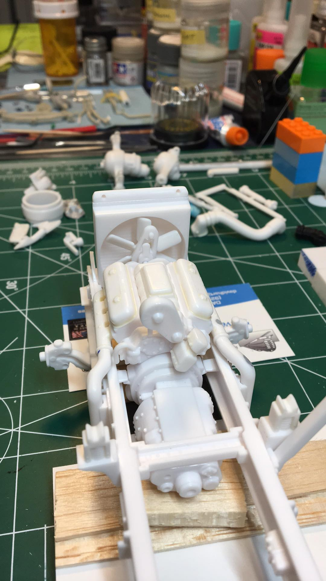

  15. Worked a bit more on the fit of the crossover pipe today and test fit radiator with engine in. Finally attached the fan support bracket to the block! Was sweating that one as it needed to land the fan in the center of the fan shroud.

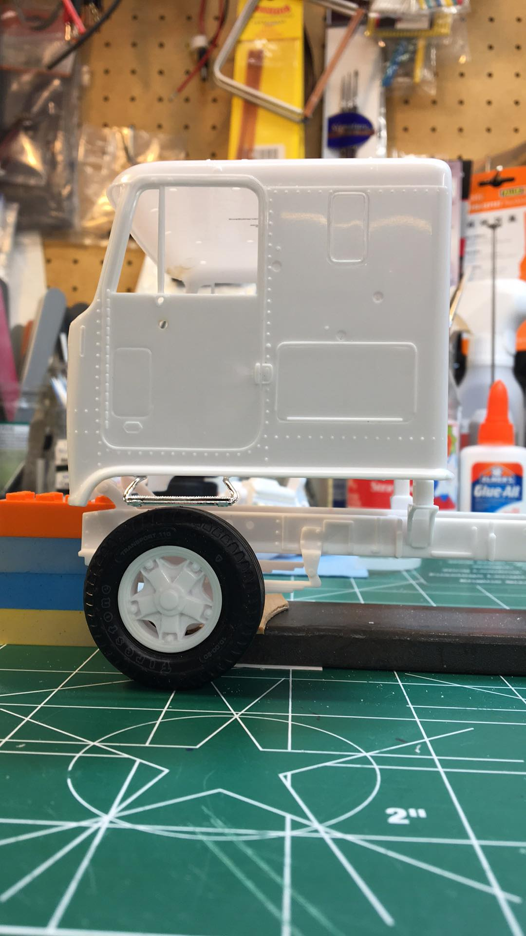

  17. I got the cab supports lowered. Here are before and after photos. It seems about right now based on 1:1 photos.
  18. Slowly getting all the frame stuff on the right side mocked up before I start lowering the cab -- to make sure there aren't clearance issues with anything.
  19. Well now the next chore. Of course, the cab sits waaaaaaaaaaay too high on this kit. Looks like it needs to be lowered about 1/8" or 3/16" to sit correctly. Based on 1:1 photos, the bottom of that cab step should be about level with the top of the front tire.

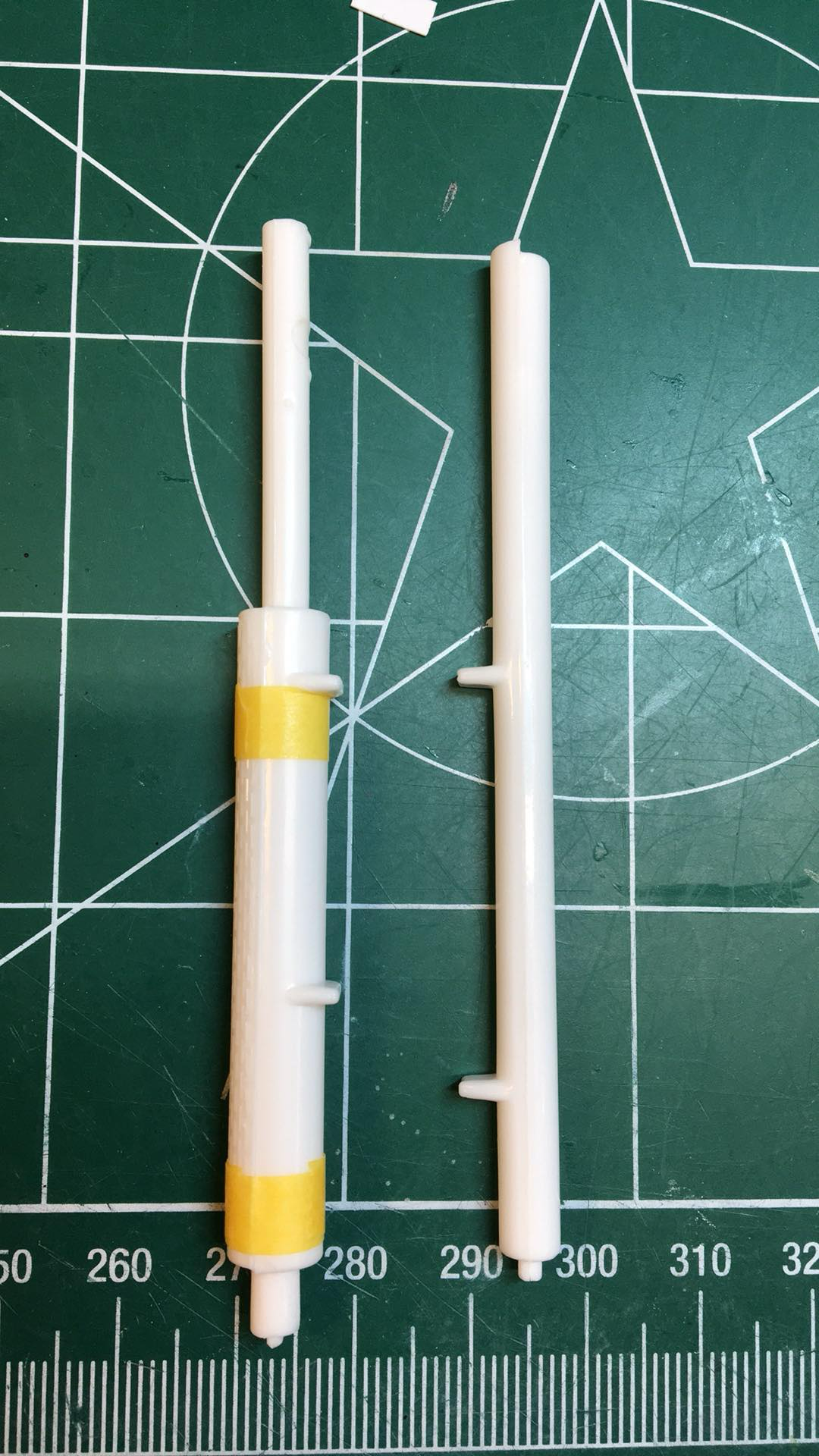

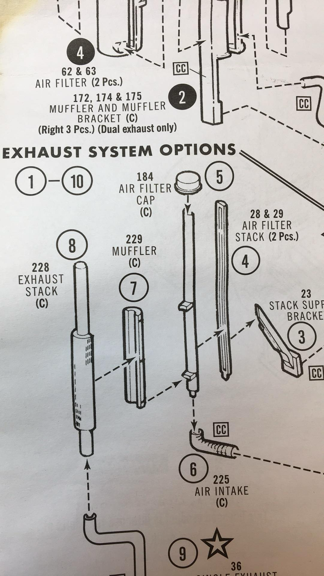

  21. Thanks ! My next quandry -- for the single exhaust, I'm guessing the tabs on the exhaust need to be removed ?? And just attach the exhaust to the air intake pipe using the tabs on it ? The instructions don't show the tabs on the exhaust (parts 228 and 229).
