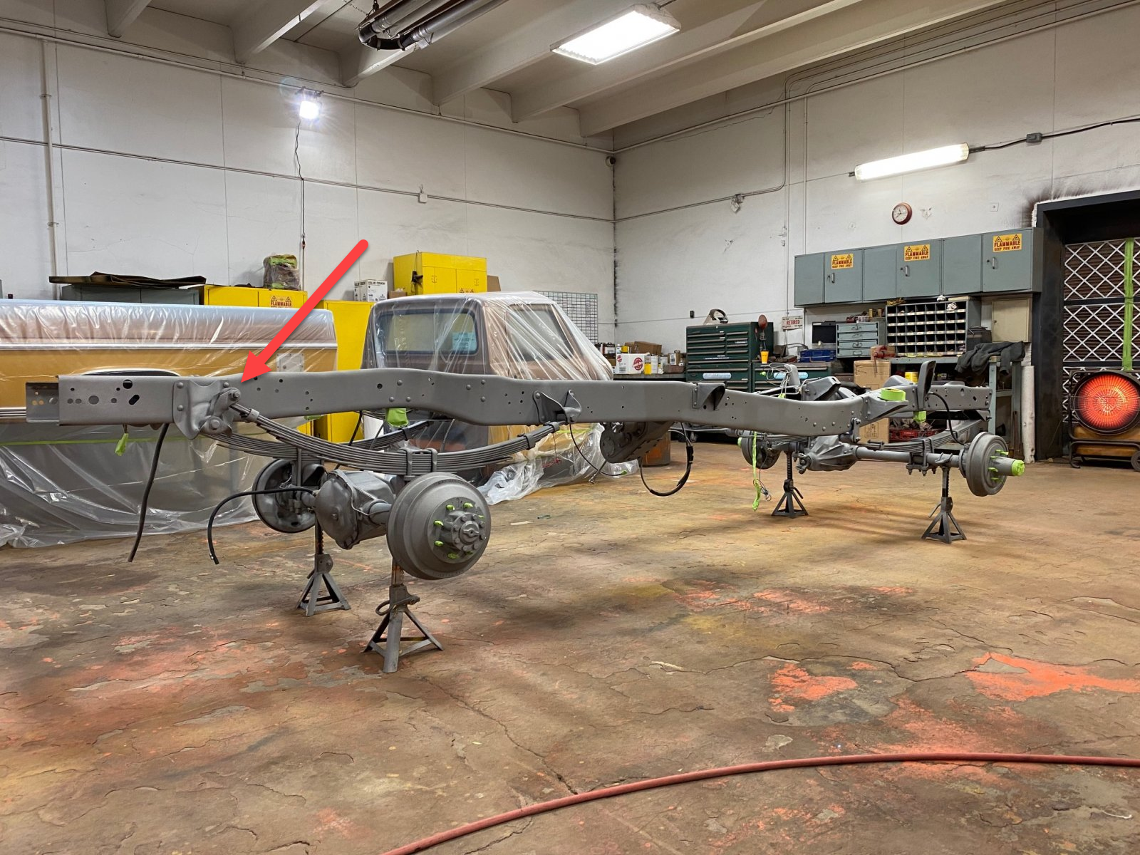

I've started this as a club build and thought it might be a good idea to document all of the issues/corrections/fixes etc. that I've run into. First issue is the rear springs. The top of the rear of the spring extends above the mount and this interferes with the box sitting properly on the frame. It needs to be filed down level with the mounting plate. In the image, the spring on the left is the standard kit rear spring. The spring on the right has been filed down as described. Note also in the 1:1 photo how the spring should have been molded -- note how the top of the spring at the rear is below the top of the mounting plate. More to come...
