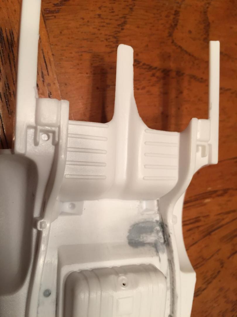

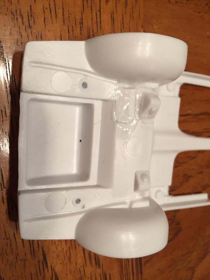

Very nice! Question: Is that the stock battery tray area? Mine just seems to look different in my same kit? Plus I have to rebuild that area on my 69 Resin Coupe build so am curious. Anyhow, great job!

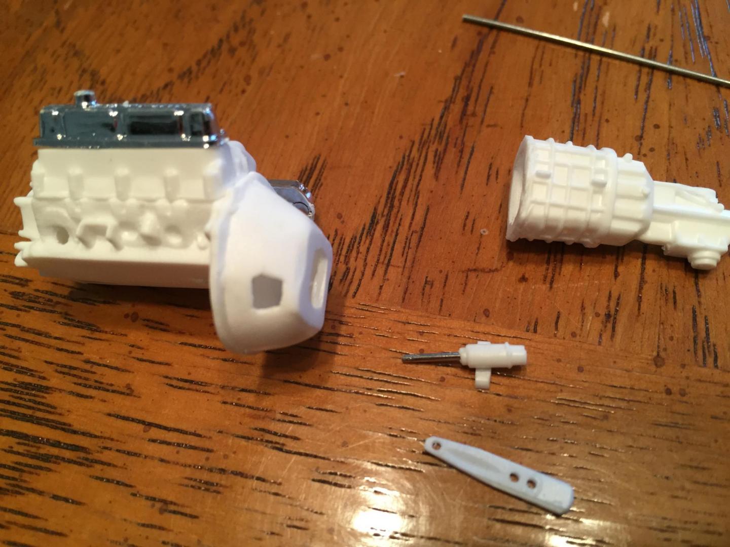

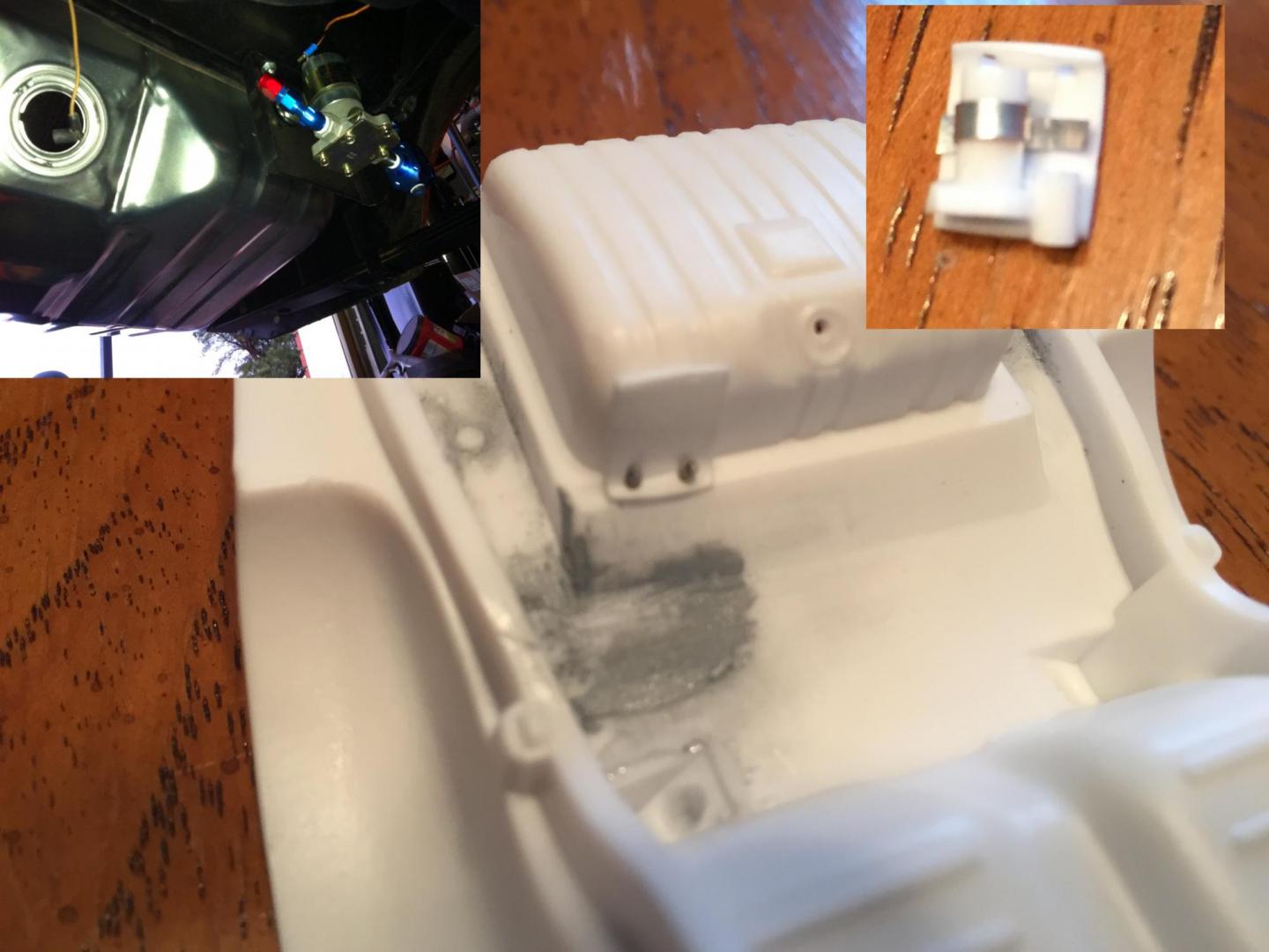

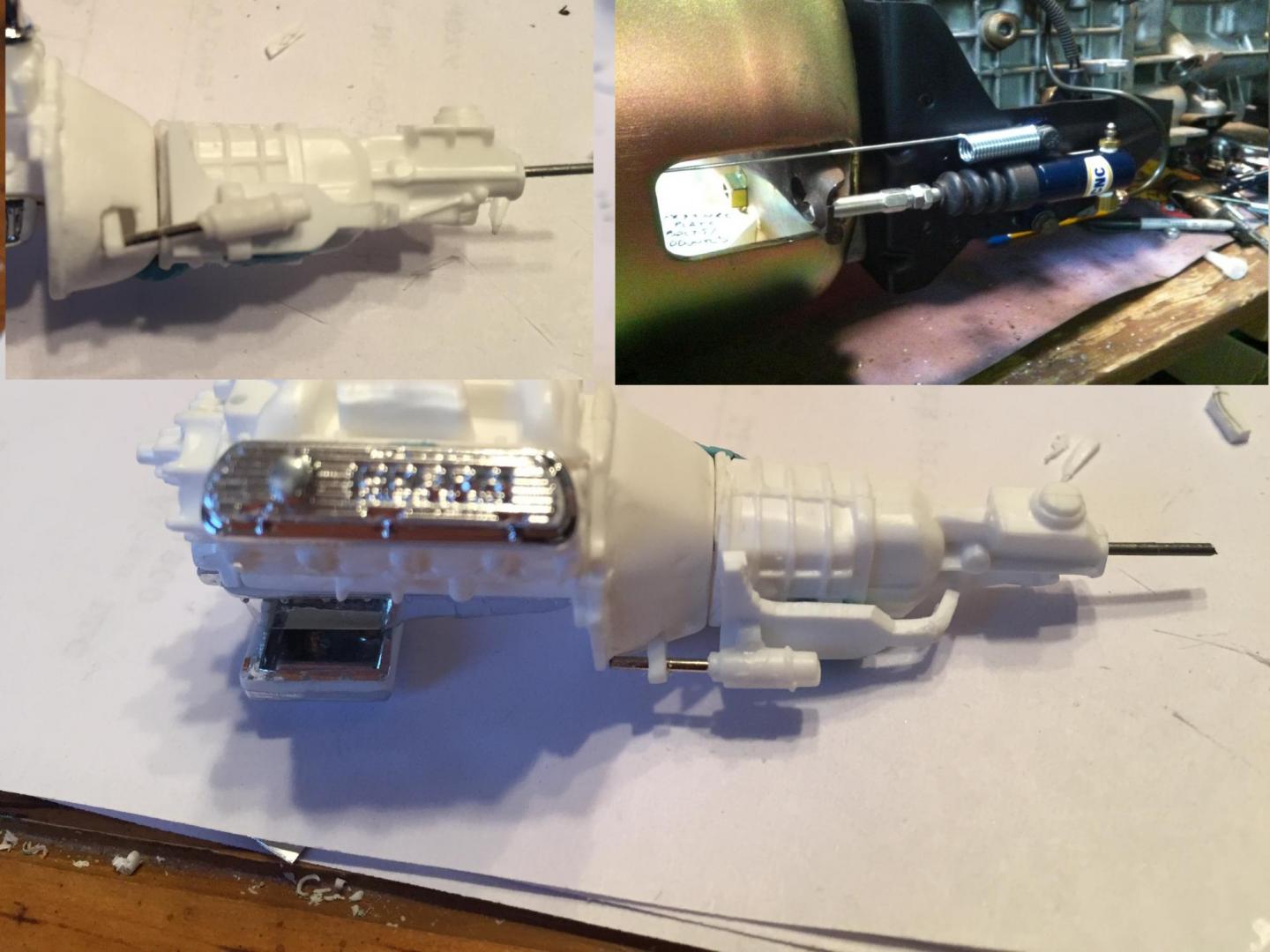

Worked a little more on this while I'm interested. Worked up the clutch slave setup, electric fuel pump, and some misc clean up. I wanted to try to duplicate the fuel system as much as possible so scratch built a little Holley electric fuel pump and mount similar to the real thing. Pump body is pretty close to scale, regulator not quite but the plate is close as well. Cut a strip from an aluminum coke can for the strap mount. Those cans are MUCH thinner today than they used to be when I used them for interior panels on my drag models! Sorry, fuel pump pic sucks as I couldn't get a good macro of it.The mounting plate is where it is on the real car as well. I pinned it in but thinking I should have just eventually glued it and make a couple paint dobs for the bolts. For the clutch slave cylinder I found what I think is a starter solenoid on an old scrap tree and scratch built a mount similar to my real one. May still need to thin it down some but it looks very close. I used an old long number tab and drilled a hole for the slave rod and then one in the near center and drilled out the crank line through the bell housing. I then used some music wire as the alignment from crank, through the clutch arm and lined it up after cutting a hole for the fork in the bell housing. Pretty darn close to me. The slave rod is a bit over scaled, I may need to find a smaller straight pin or wire. I validated that the shifter on the trans actually lines up with the in car console and it does, just like the real thing. Actually that ragged hole looks kind of like the real thing as well. :-( You can also see from here I have opened up the passenger side door so see how difficult it's going to be. I also filled in the gaping hole on the bottom side where the console pops up in the tunnel. My real car doesn't have a hole on the bottom so figured this shouldn't either. Just have to bondo and clean it up eventually. Going to be in Austin Texas this week for an IT conference so no working on it for the week. Might be better for me anyhow. Stephen -

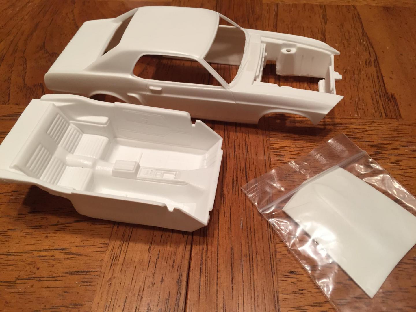

This is likely going to be an extended build but thought it would be fun to share the progress (or no progress as it may be) here with others. The goal is to build up a 1/25 scale of my actual 1969 Mustang Coupe that I've had since 1974. I finally have the car back on the road after way too long although it still needs details completed. I really should be working on the real one instead of this but I hope this will rebuild my motivation for the big car. I've messed with cutting up a kit to get the coupe roof line long ago but was never happy with what I could accomplish. Having run across the resin Grande coupe body some time ago I knew that was what I needed BUT the prices were over $100 on every auction and that was too much for me. Recently I received an alert from my ebay notices that there was a "69 Mustang Resin" for sale but figured it was another one of the decorations or 1/43 scale version. I checked it out anyhow and it had a very reasonable buy it now so I clicked it without any second thoughts. This is the resin kit pieces although I may use the CJ hood with the hole is the standard scoop will cover it. In any manner I want the air filter just peaking through the hood under the scoop like the real car does. Engine wise I want to match the 347 that I've built for the car as well which generally will not be a problem except for maybe the shorty Cobra filter that I've never seen anywhere else. The rest is pretty easy as the Cobra T pan is out there and covers and I found an intake that closely matches the old F4B I've kept on the car. I put a Mcleod scatter shield and TKO 3550 in the car and have found a close trans out of an early 90's Mustang kit. In fact, I bought the Mustang Cobra Combo kit to get not only the 1969 base parts but the rack and pinion to fit the rack I used in the real car and the fox body seats that I used as well. The Fox Cobra is 1/24 though so I may have to do some fitting on the seats as they already seem over sized. I plan on painting up / detailing the engine as close as I can to my actual build as well as the electric fuel pump setup, slapper traction bars, etc. I'm still debating on opening up the doors and trunk. It's a lot of work and sometimes doesn't actually add any value but then again I do not plan on building another one of these. One of the first things I had to do was remove the molded in battery from under the hood as mine is in the trunk. I'm thinking I'll rebuild the shock towers as well as the kit looks more like the Boss 429 laid back towers than my stock ones. The front suspension detail is so lacking on this kit as well so I may build up some custom shocks/springs and upper arms. I'm pretty familiar with the 1969 Mustang having put a passenger side shock tower and battery tray panel in the real car so I know how it should look :-) The other thing I have to do is remove the molded in power steering linkage as I'll be using a rack like the real car has. Little detail but I figure what the heck, I want to do this as close to the 1:1 that I can. Cool thing is I can always walk out to the garage and take pics, measurements, etc if I need to in order to validate the end results! Stephen

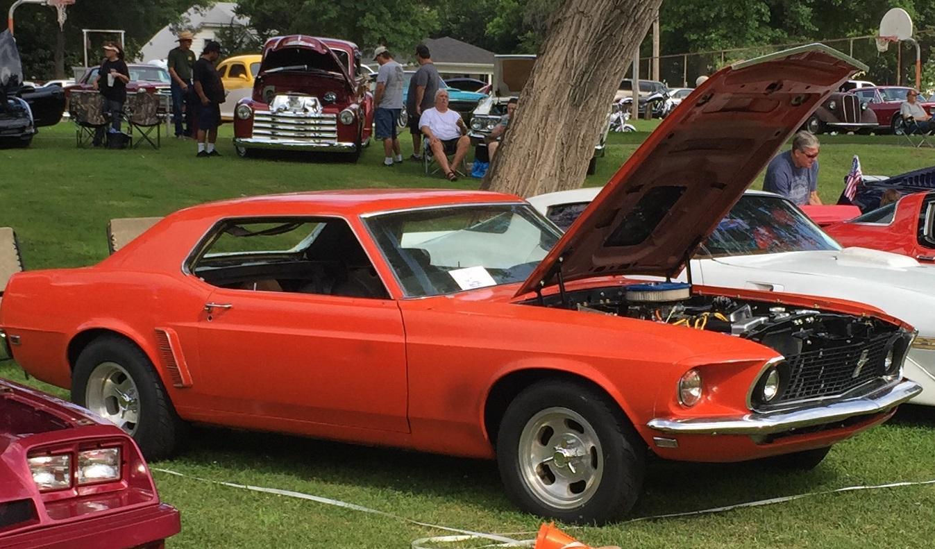

Just checking in and saying hi from Oklahoma land. Old man, no current builds but a few survivors from the 1980s. Been re-collecting some projects and especially want to build a copy of my full scale 1969 Mustang Coupe using the Grande Resin kit. Here's a few of the old builds for now. 1940 Sedan was built to be like the 40 Sedan in my garage at the time... model done back then, real car sold so I could work on my real 1969 Mustang. 1987 Turbocoupe drag car as the 87 Turbocoupe body on the 85 Pro Stock chassis before any TC kit was available. The 1985/6 Prostock car was done before the 87 with opened doors, trunk and removable front section. 1970 Boss 429 was basic build, toothpaste polished plastic with engine detail. 1940 Coupe Drag was the earliest build with a tilt up body and single drag seat/engine/drive line from a funny car kit. Getting interested again in scale to build a copy of my still in progress actual 1969 Mustang I've had since 1974. Back on the road this year and just picked up an affordable copy of the 1969 Grande body so now seems like a good time to start at least. Last pic is the real (but rough) 1969 Stang... fun (to me) story of that pic is I used to own the white TransAm back in the 80s, sold to a friend who had to sell it and recently got it back to rebuild and the 1978 Rally Sport Camaro was the car my wife and I actually met in back in 1980. Fun pic... But enough rambling... Stephen
