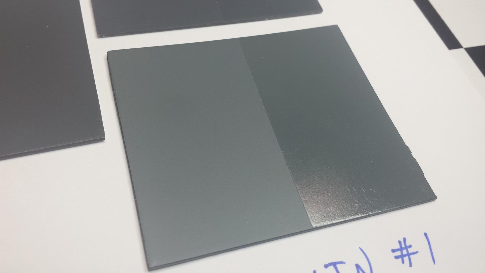

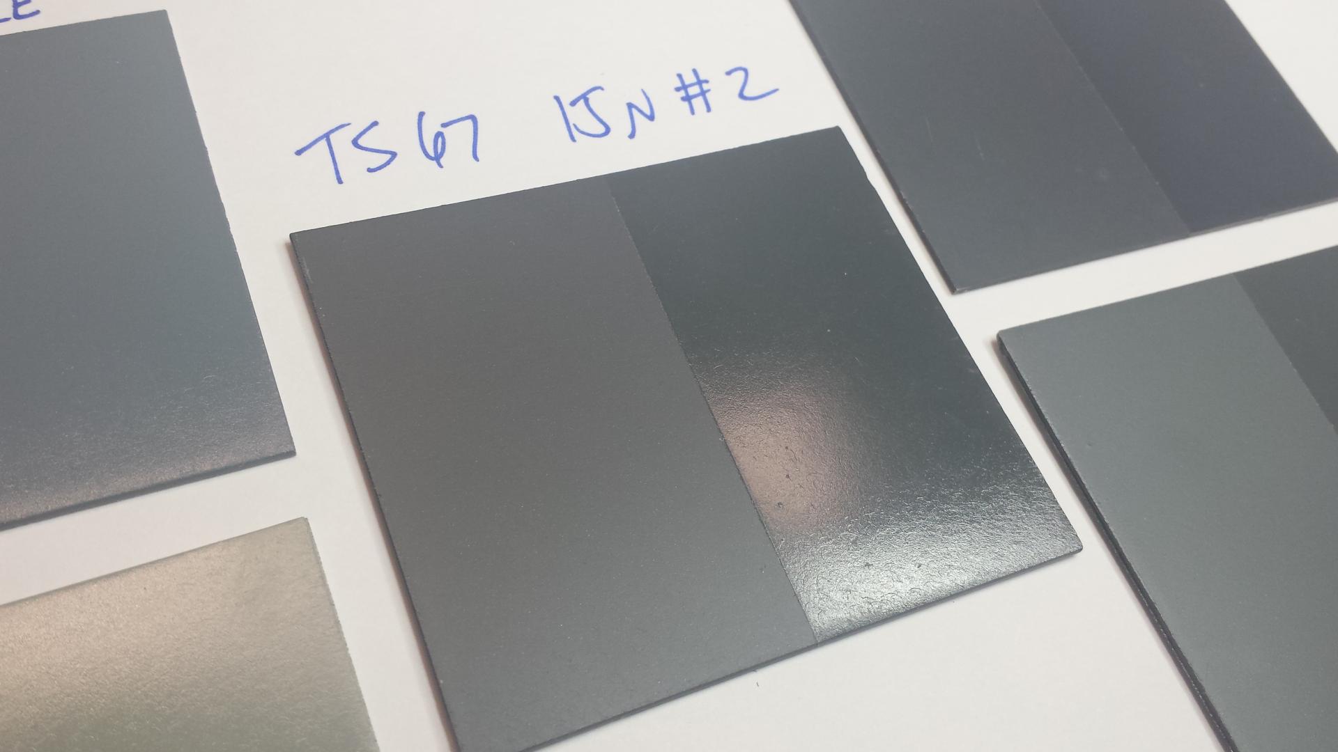

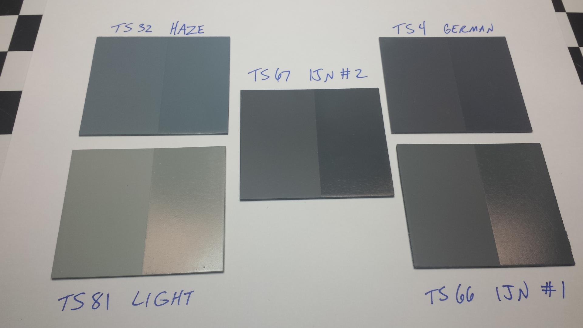

Steve Osbourne replied to crowe-t's topic in Model Building Questions and Answers
This might help. Since I migrated to Tamiya TS cans years ago I have been making paint chip cards when I try a new color. For the flat military colors I spray half of the paint chips with clear gloss. At least you can see how TS 67 compares to other grays you might be more familiar with. -
