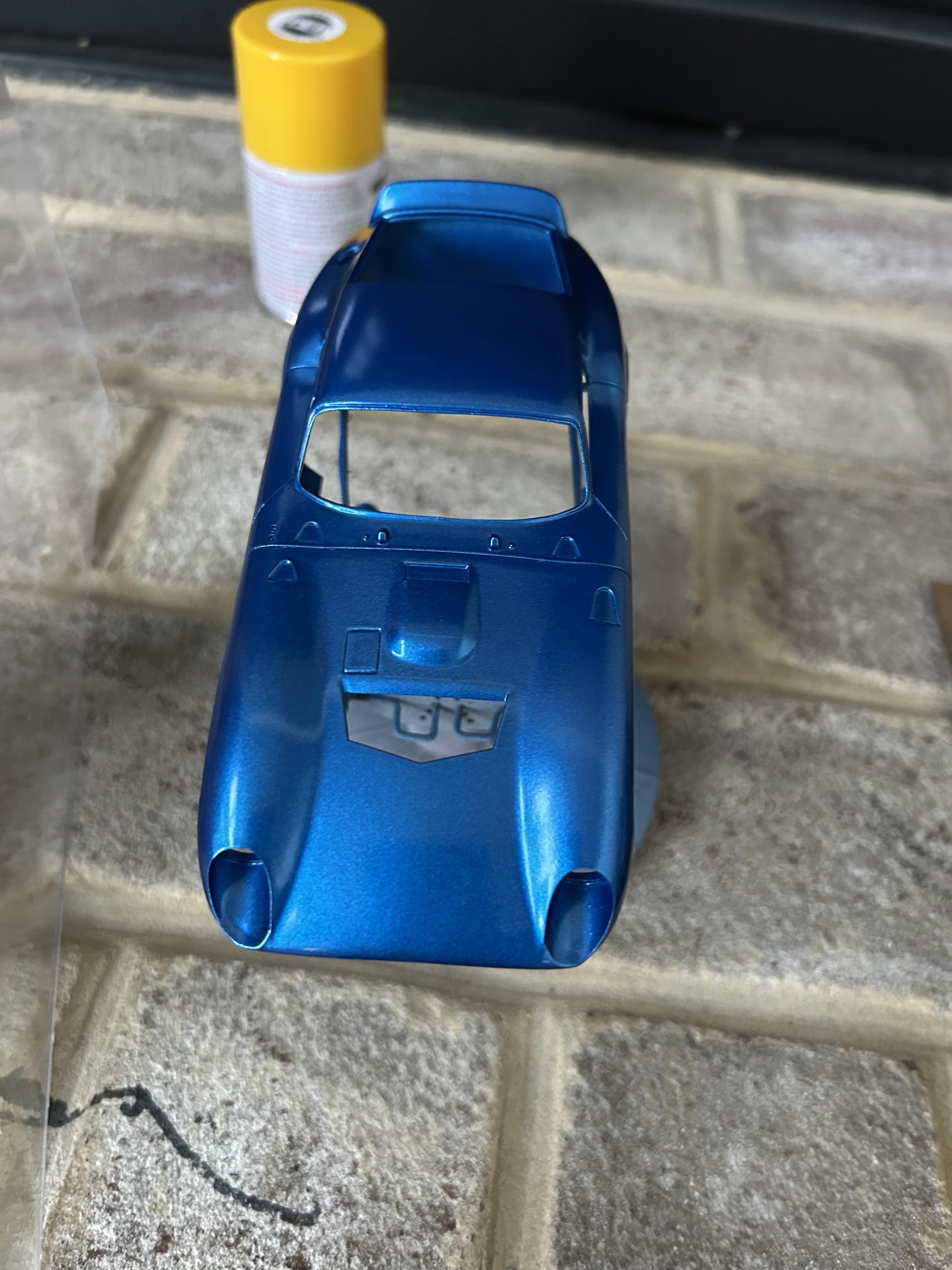

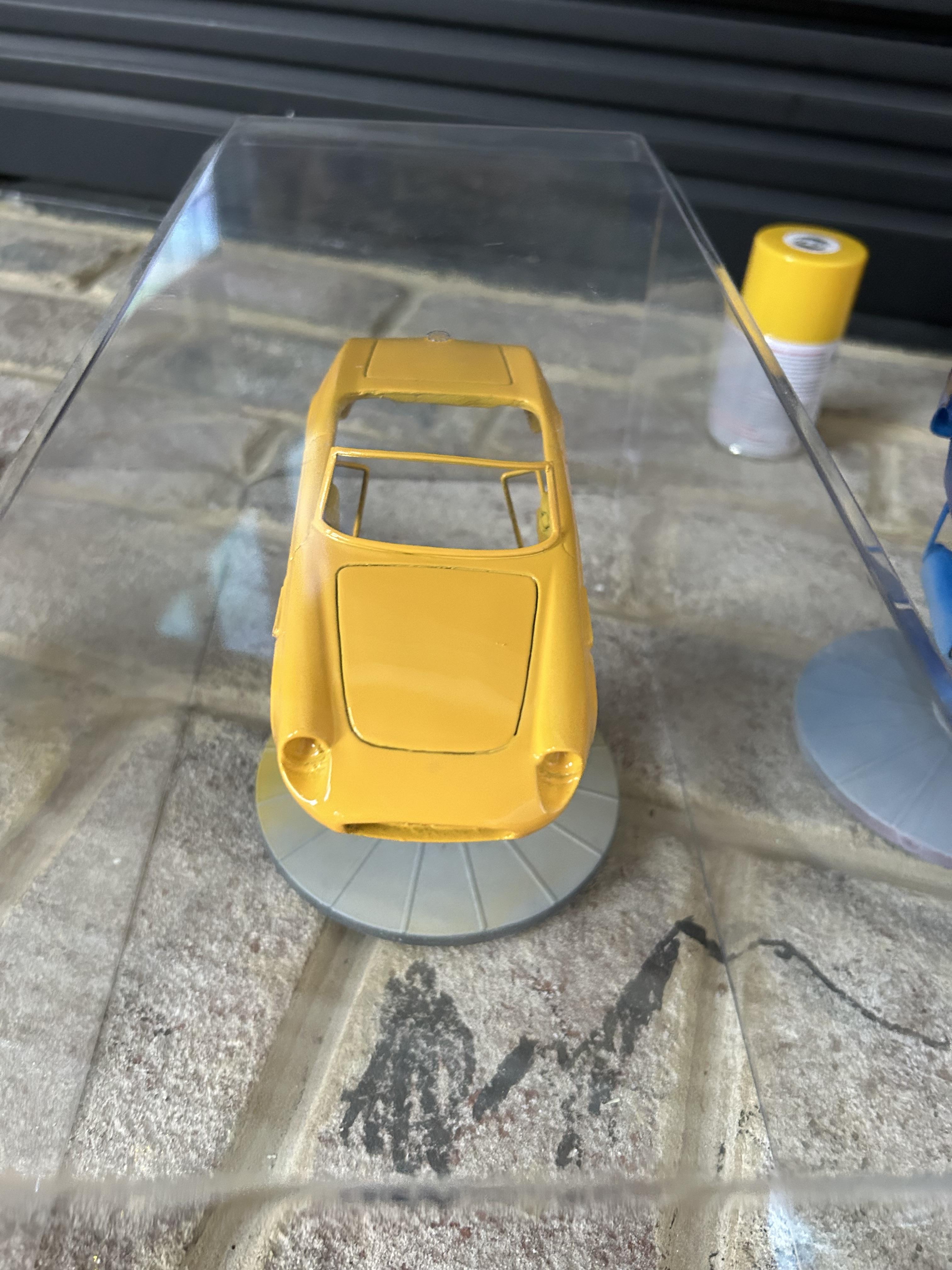

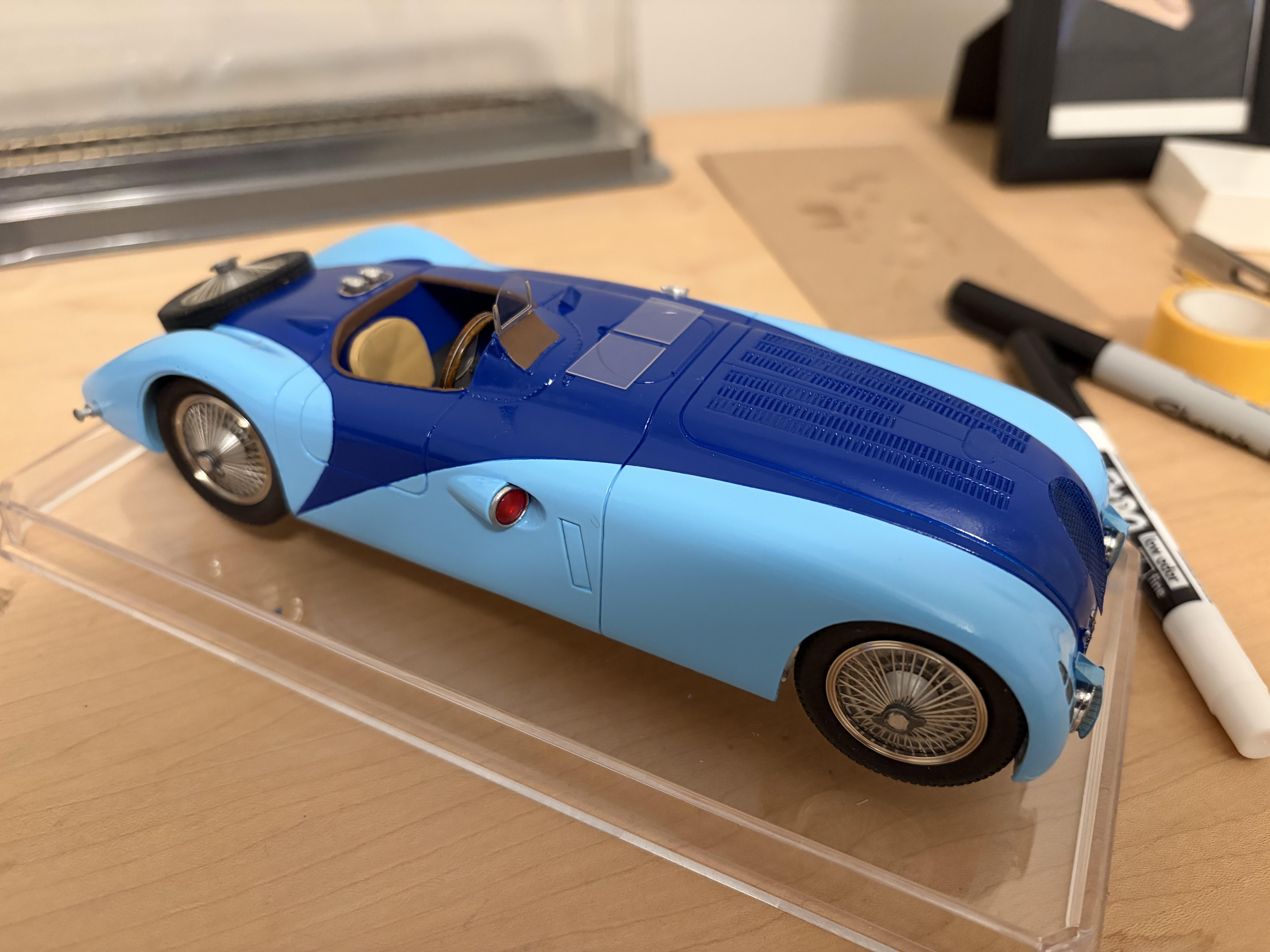

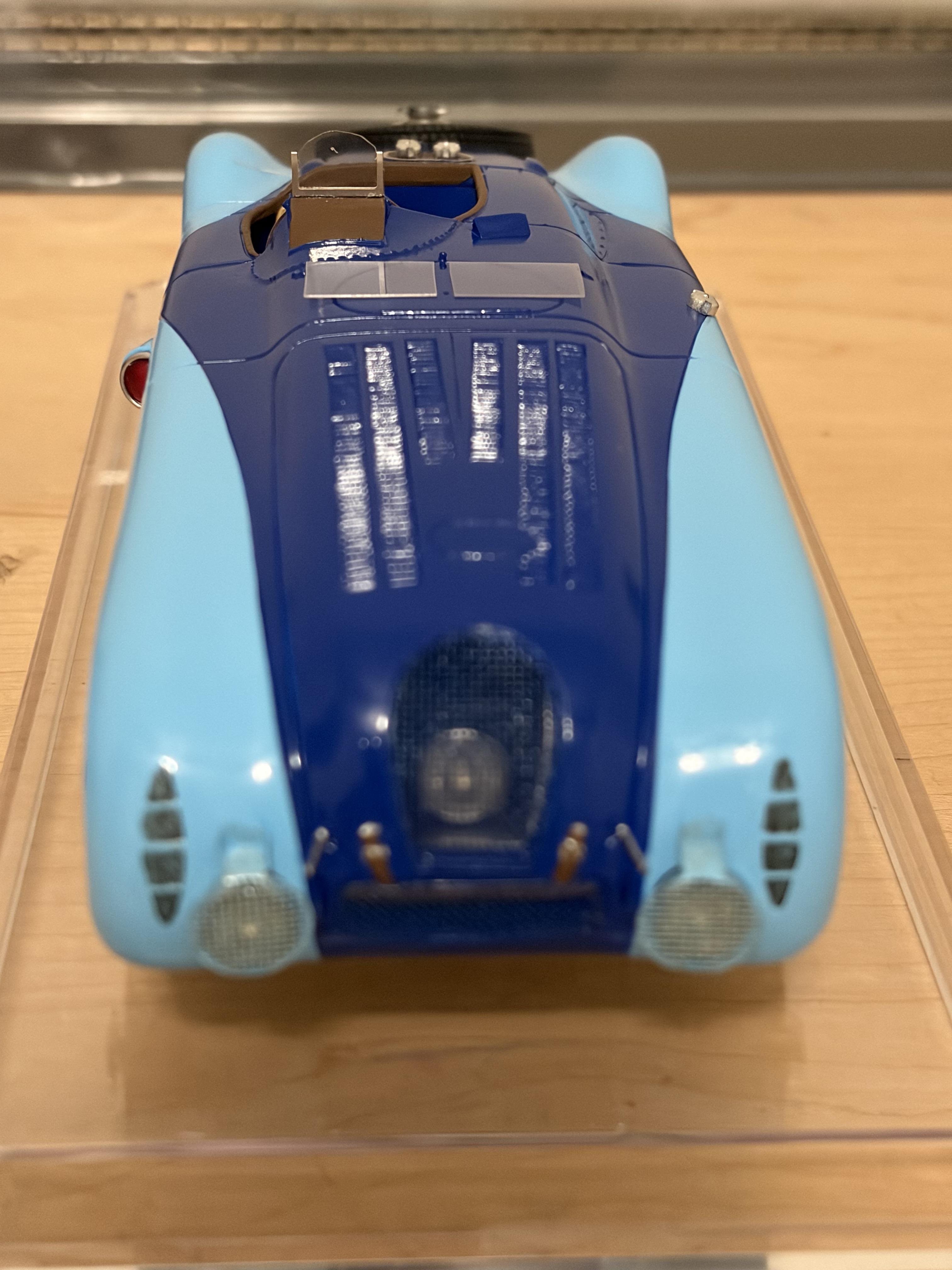

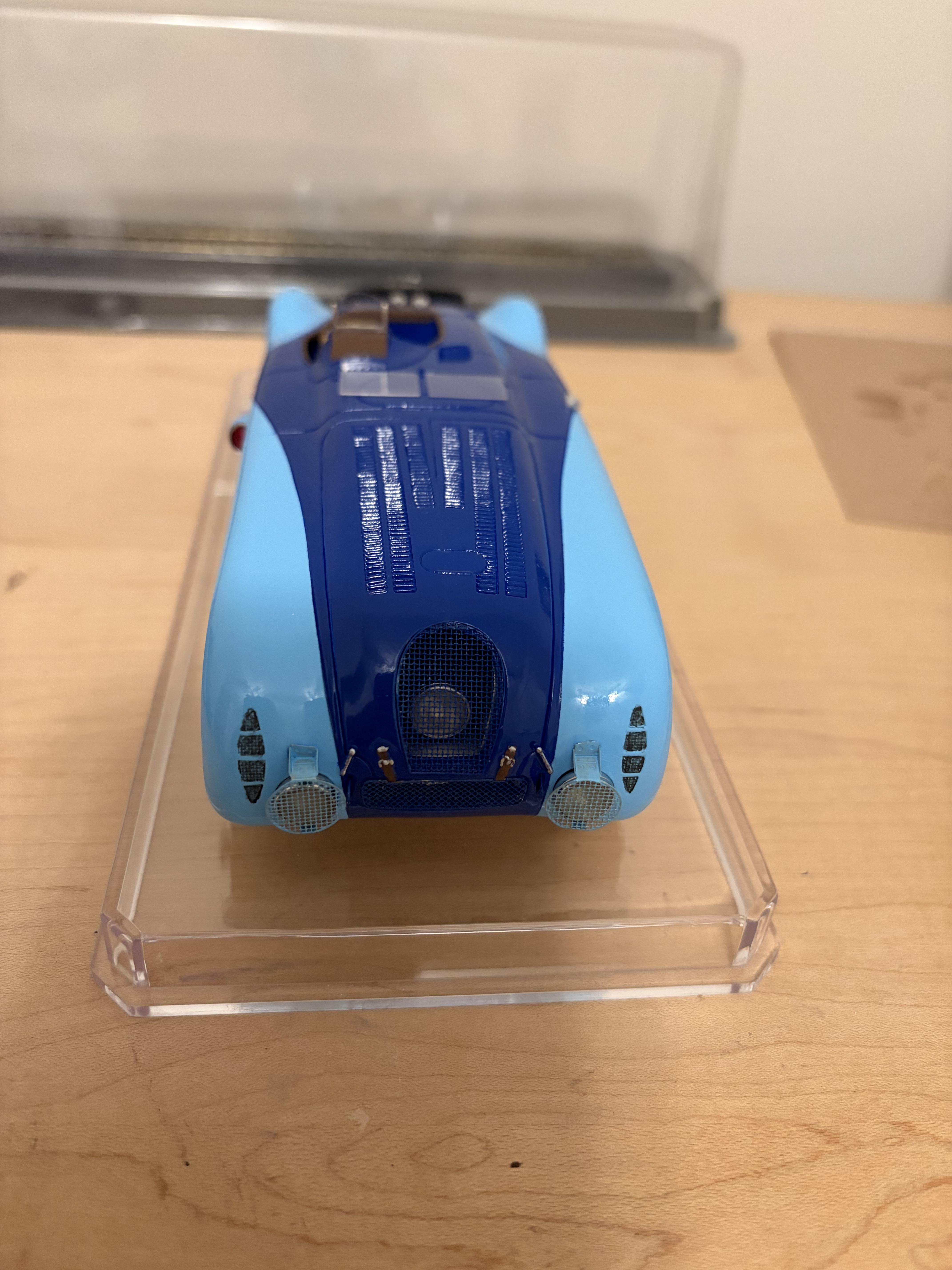

  1. Hi, the paint was as follows: primed with Mr. Surfacer 1000 from spray can. model was then airbrushed with Vallejo mecha color sky blue. masked with tamiya flexible white tape for outlining dark blue and then tamiya yellow tape to cover rest Airbrushed Vallejo model air French blue for dark blue. Let dry overnight and removed masking let sit for a week and then cleared with starting with several light layers with Mr surface clear uv cut gloss from a spray can. Finished with wet coat revell chrom for headlight chrome from spray can. Let dry for several weeks before touched aluminum parts are spaz stick chrome spray paint but not over black. Gives a nice aluminum look…

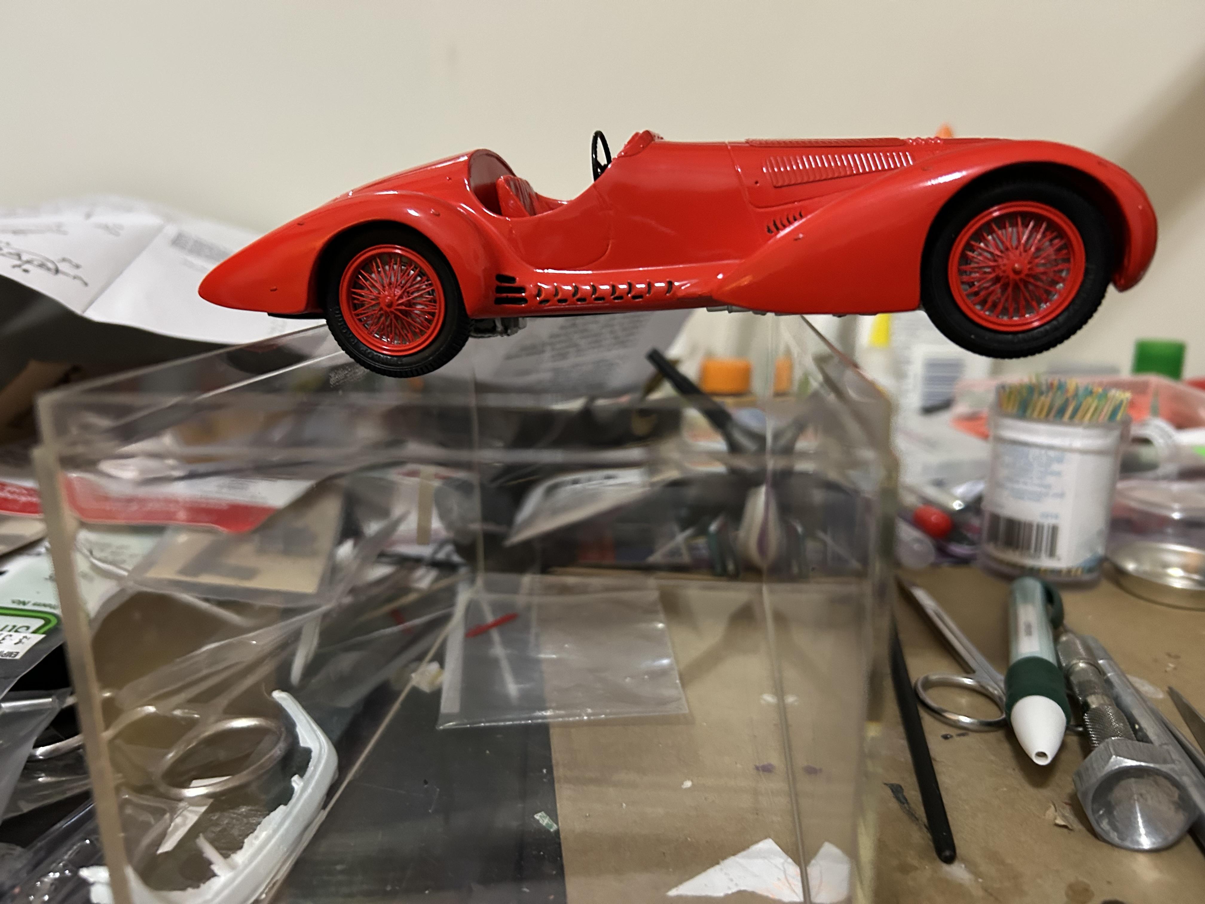

  2. Yes. They are nice thin photo etch wheels that you build up
  3. The wheels were from eBay jack modelling. I ordered a few sets a while back kept the front narrow wheels for a Ferrari 250 California and saved the wider rears for this.

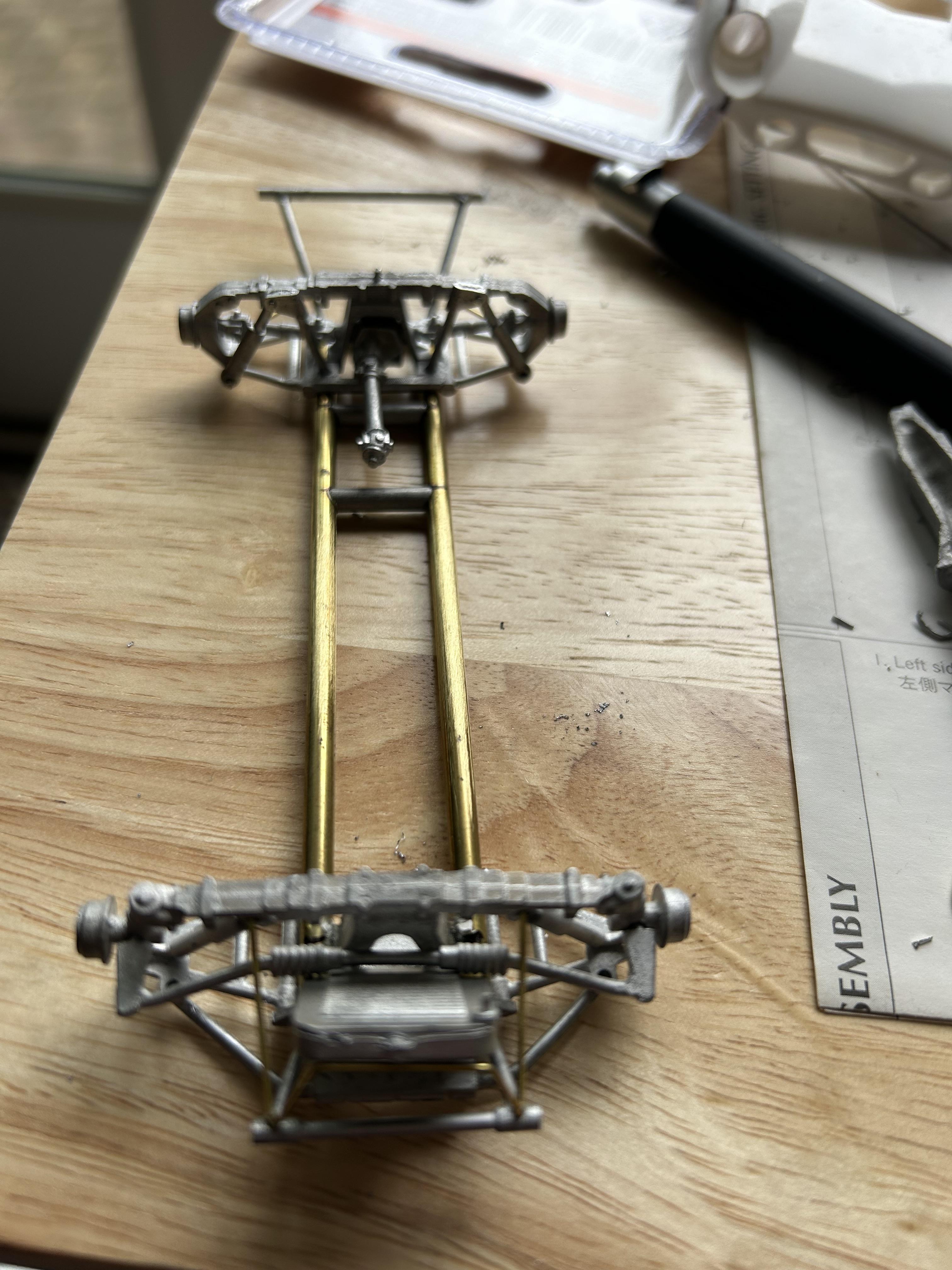

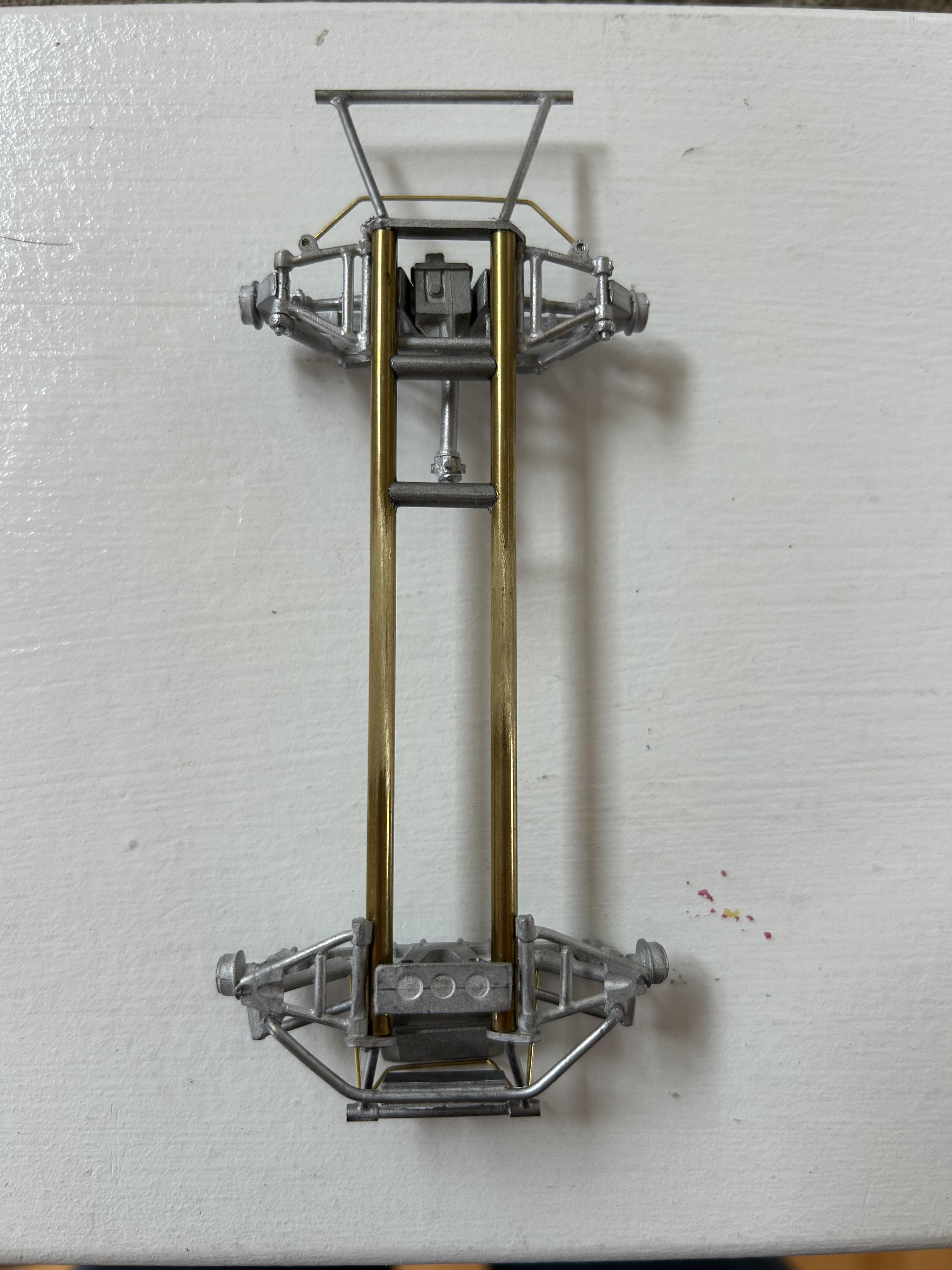

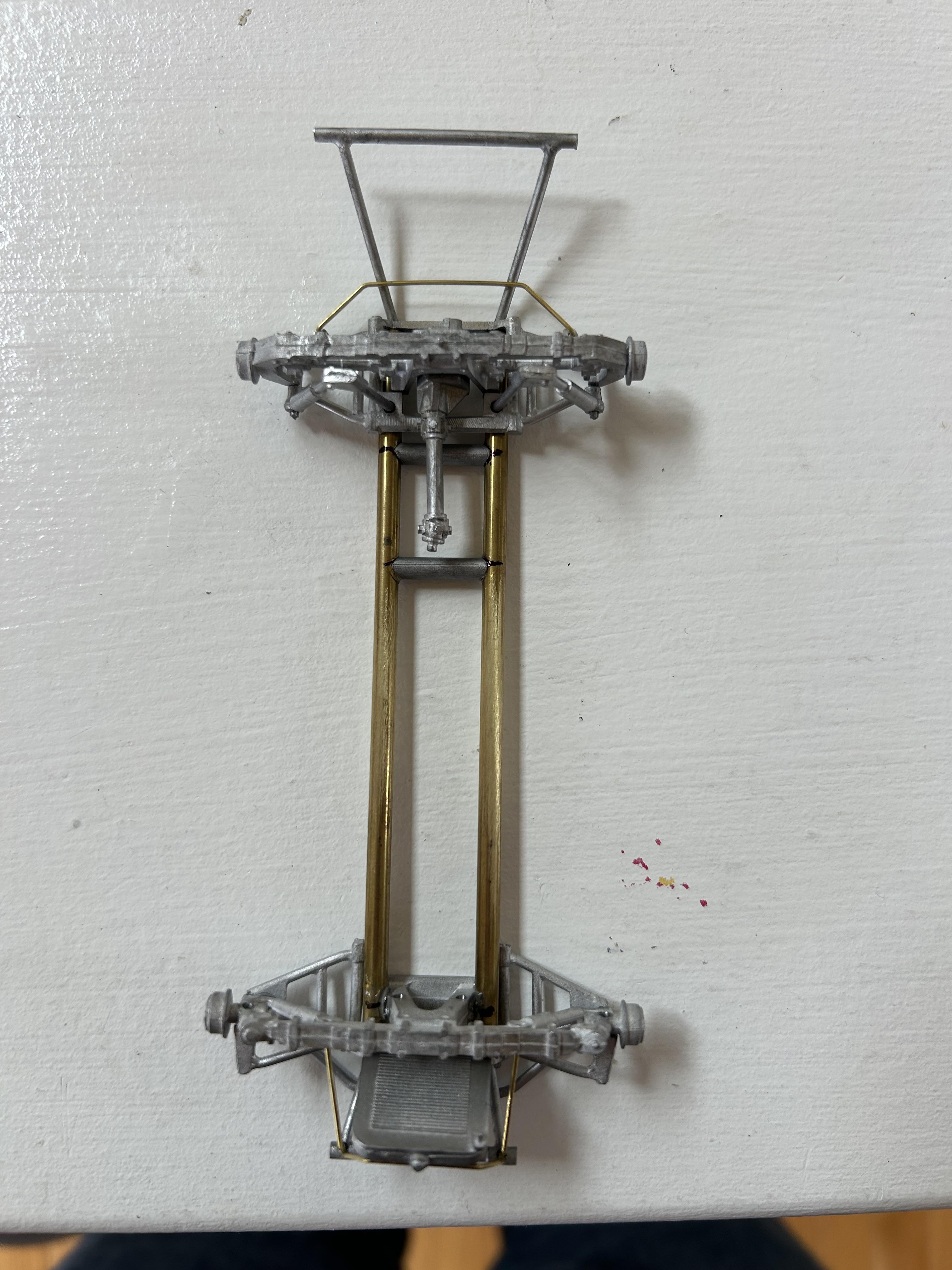

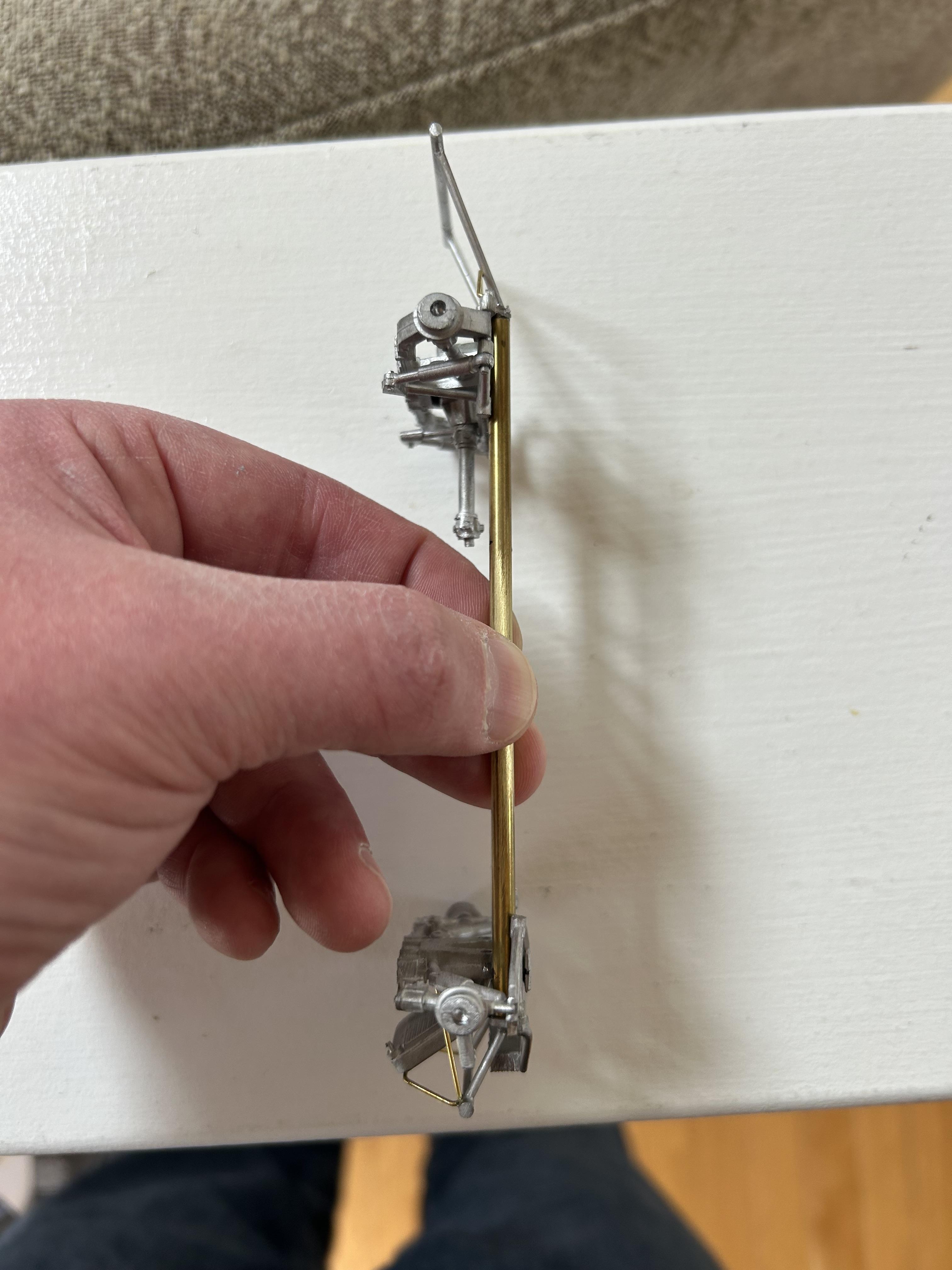

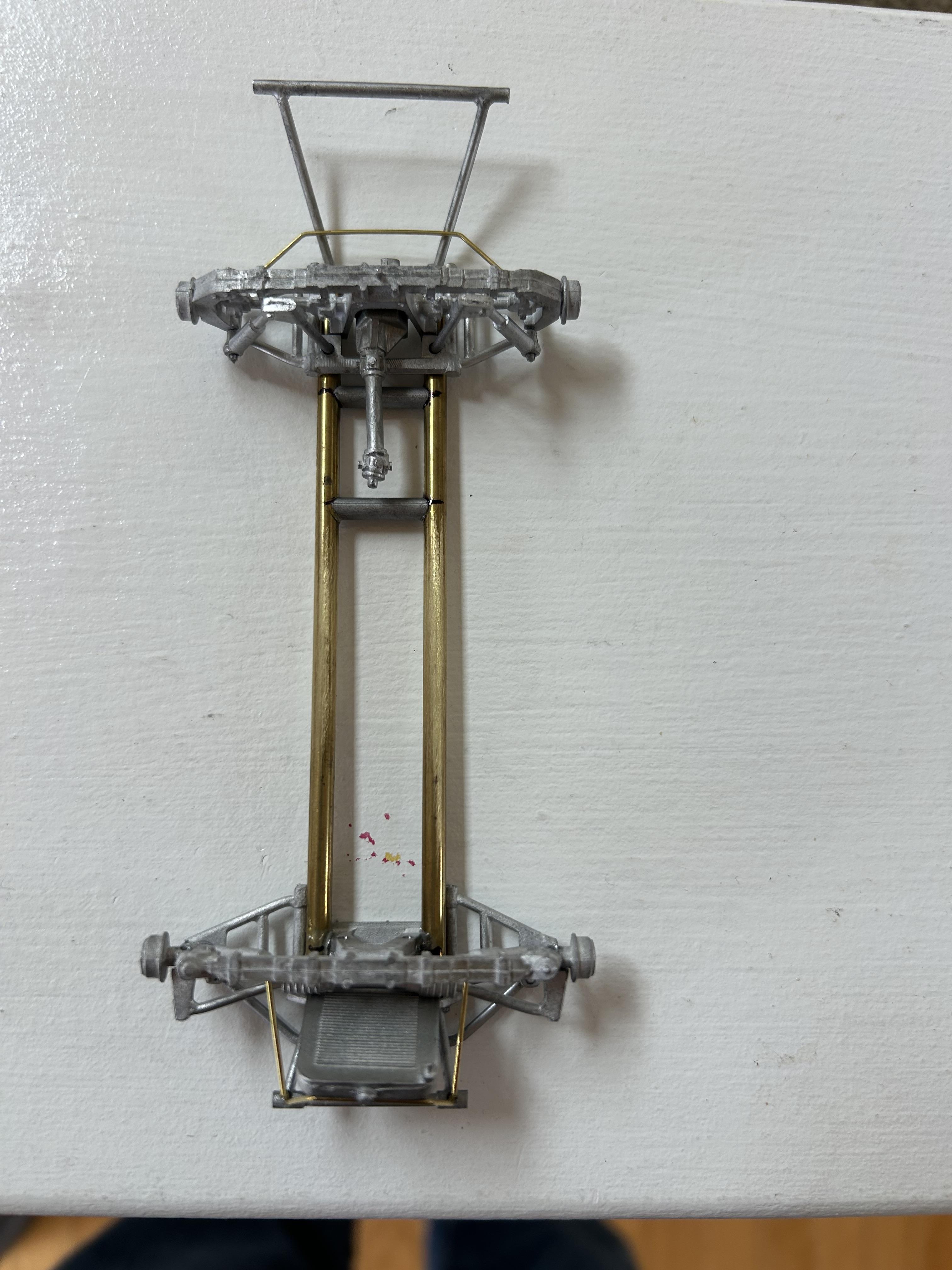

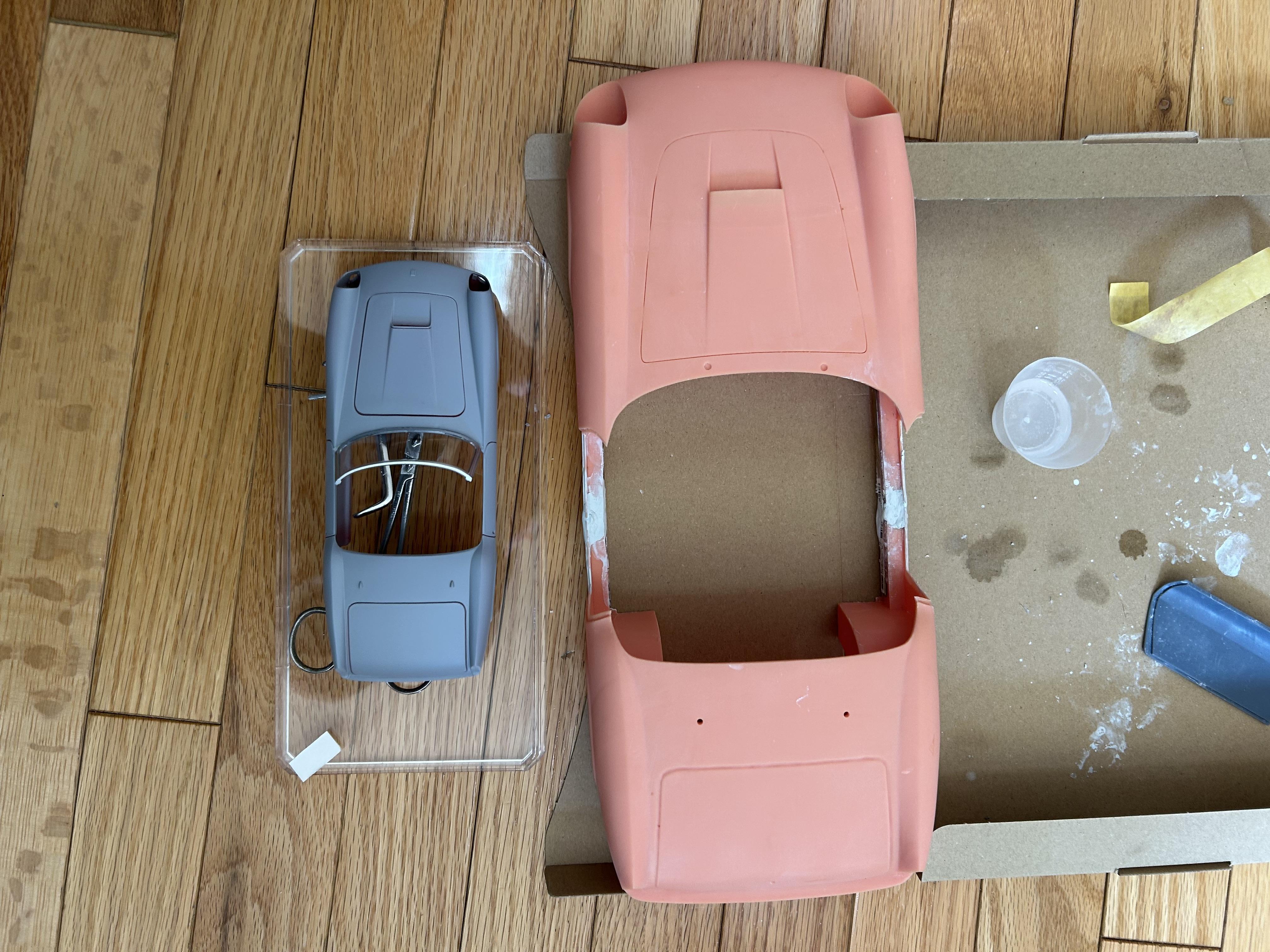

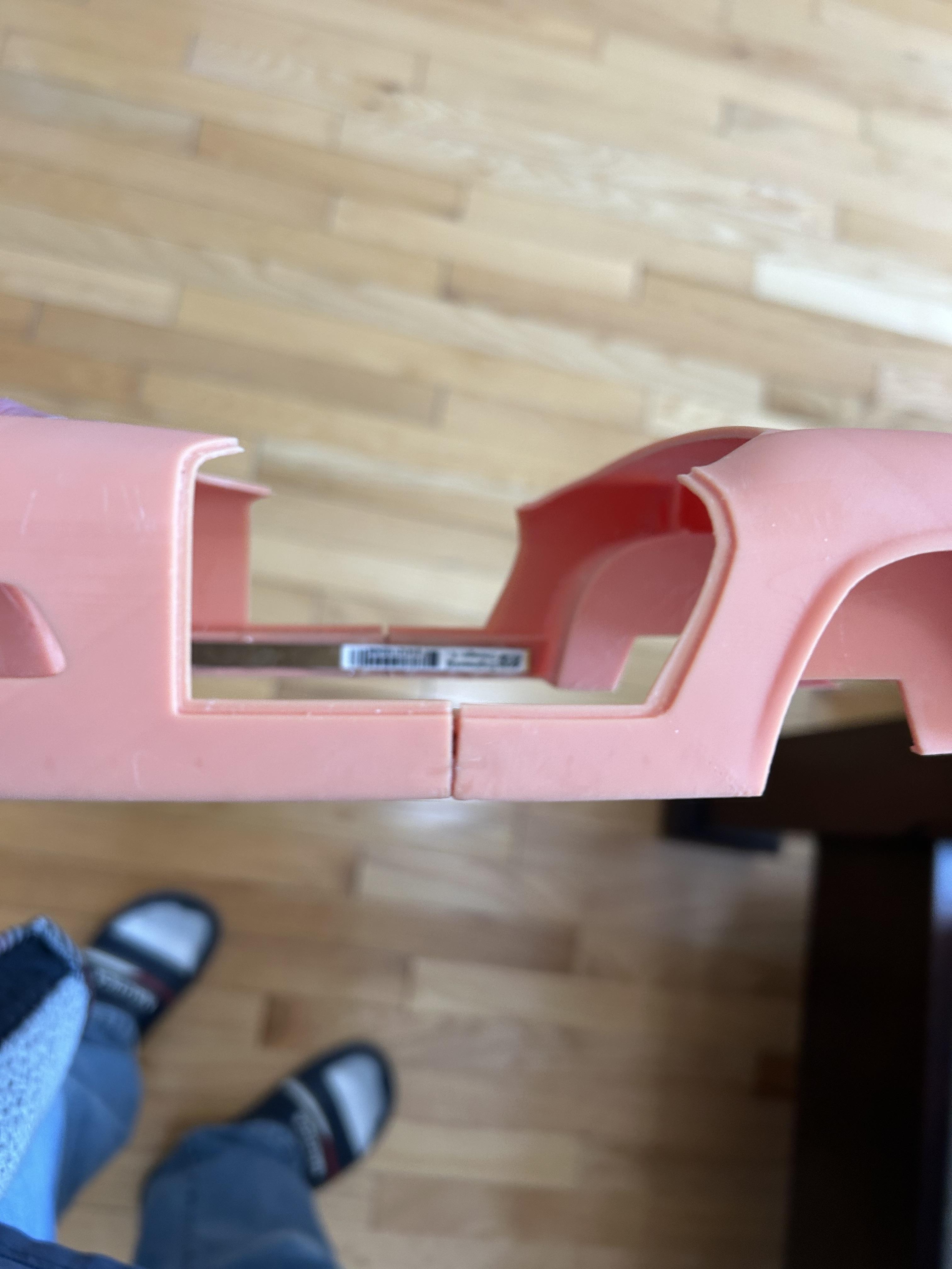

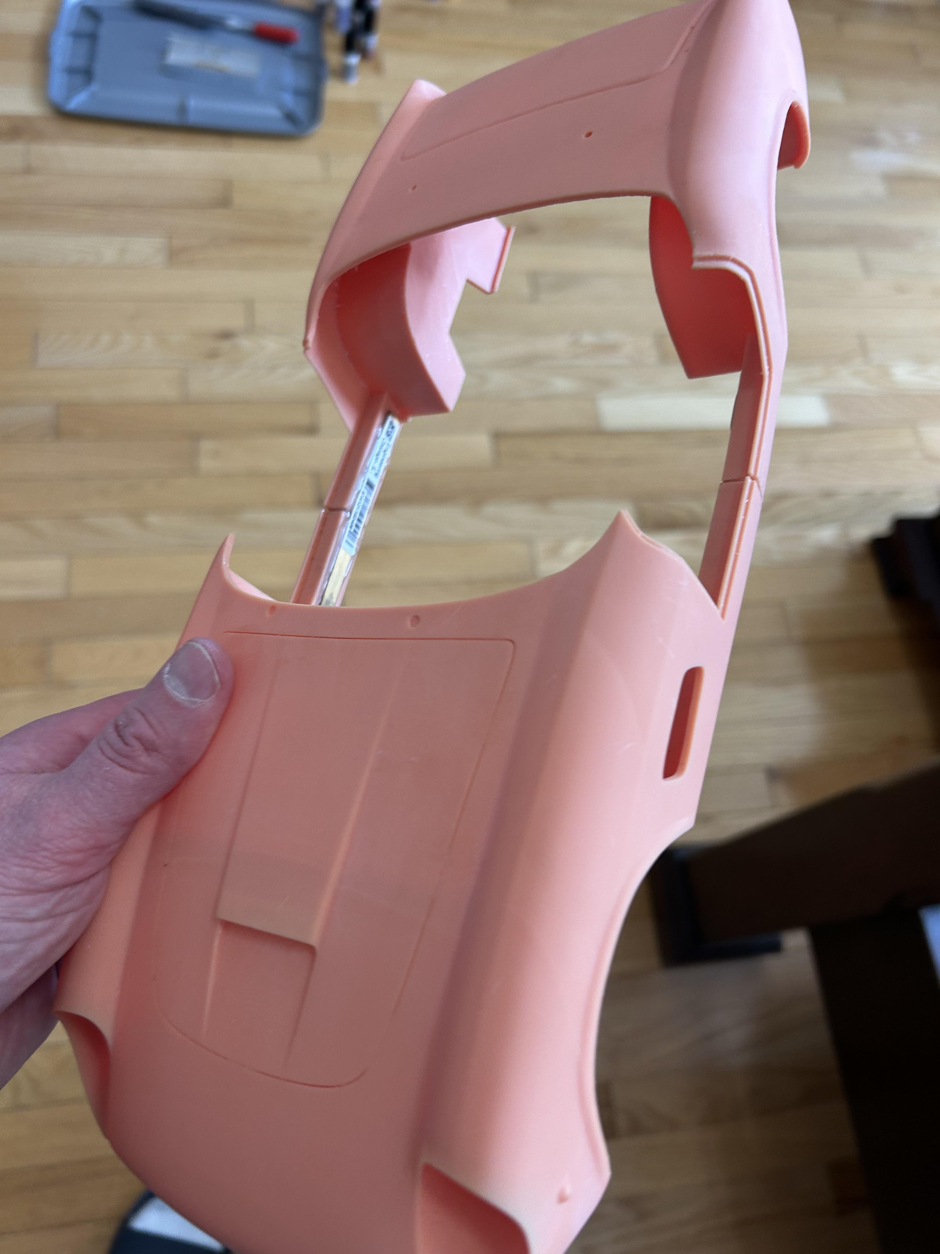

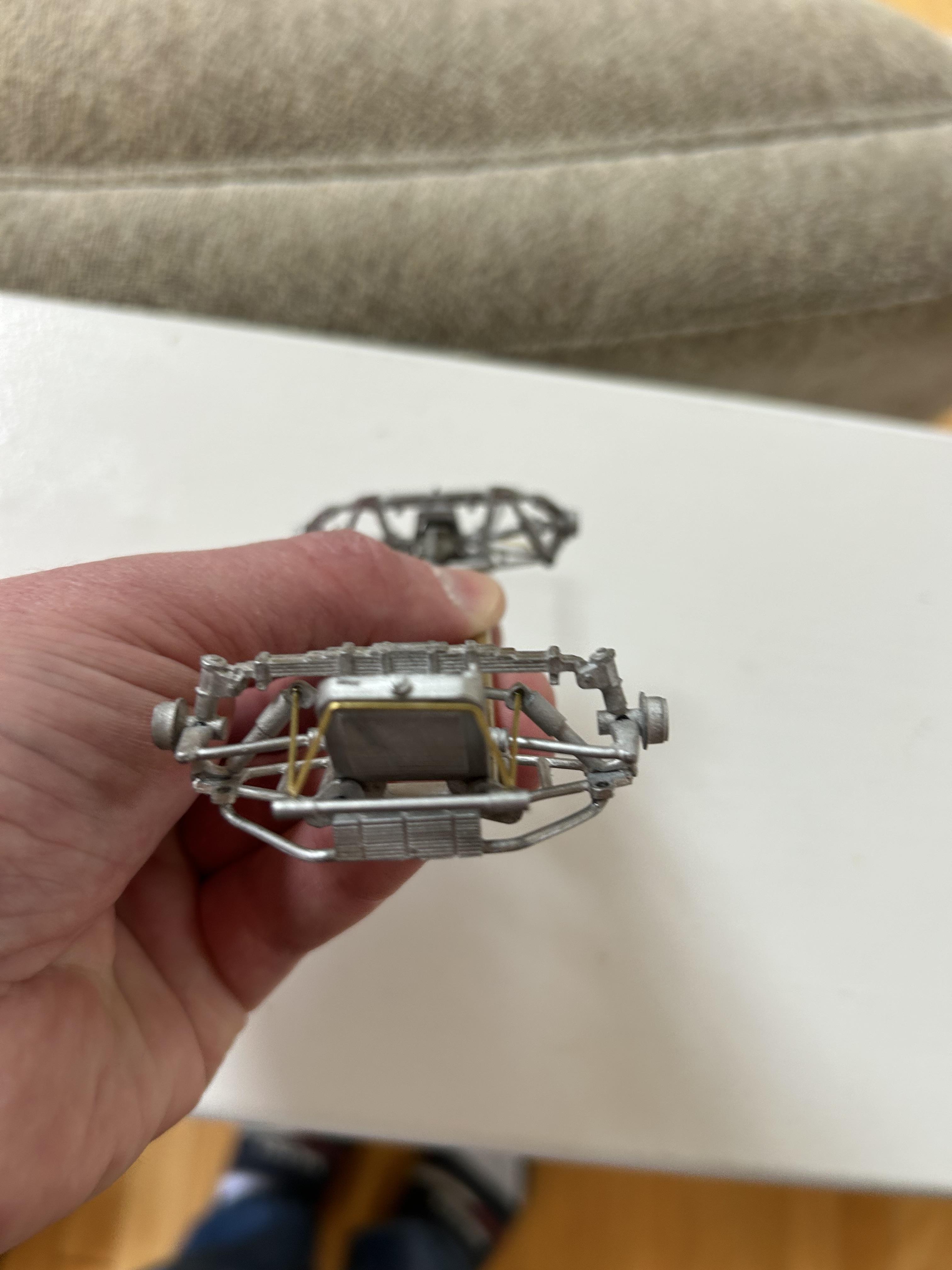

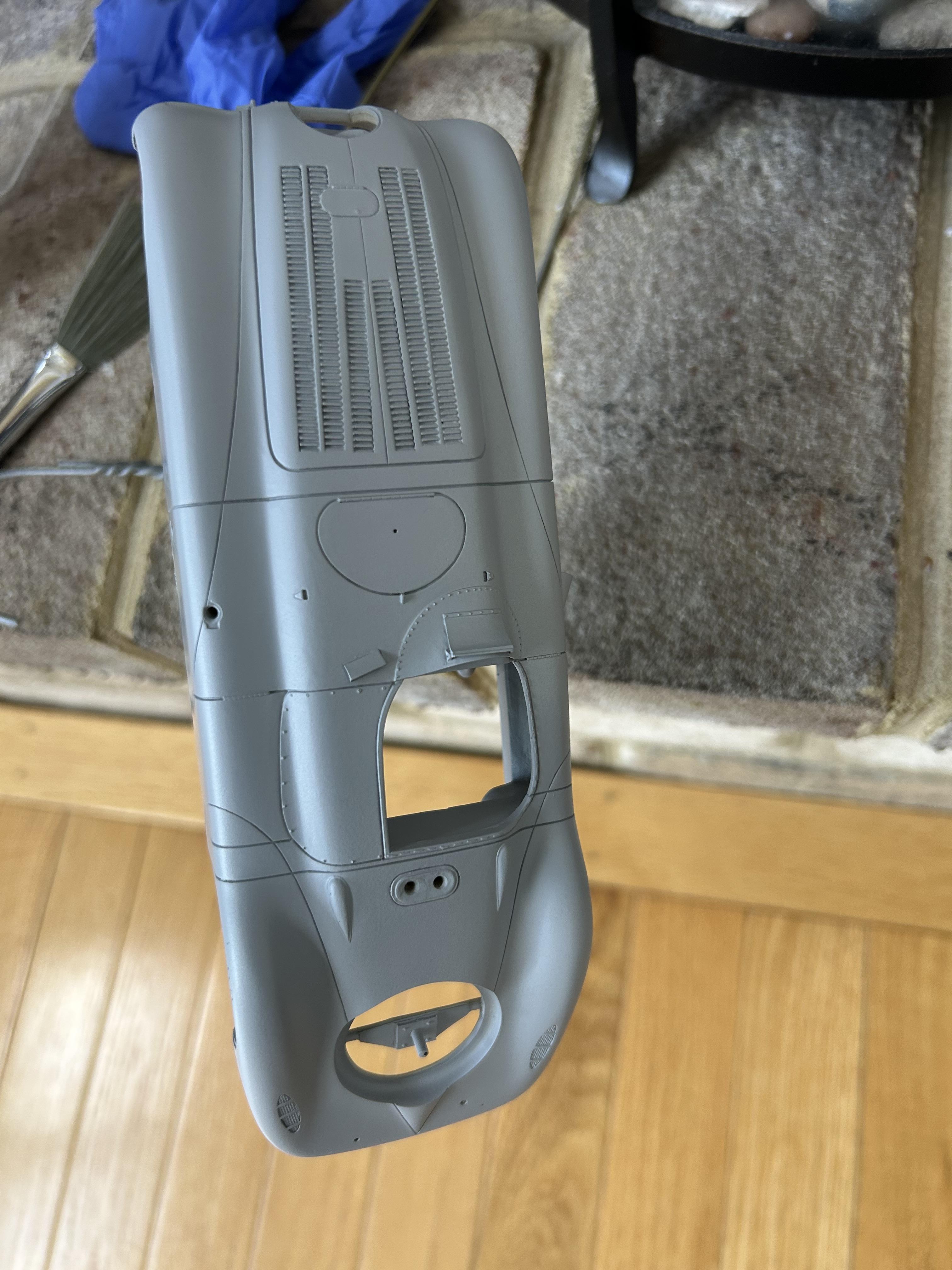

  4. Air Trax kit that I’ve been working on over past few years. Was missing several parts including center console which I will try to make next. the chassis that came with my kit was not useable. I have chopped and stretched an italeri Ferrari Daytona chassis as a replacement. today boxed in the the rear parcel shelf, made new fender area and parcel shelf with polystyrene and apoxie sculpt Will like change color to metallic brown to replicate Peter Sellers car

  9. Painted with Vallejo acrylics. Model air French blue over mecha color sky blue. paints mixed in airbrush cup with with a bush using several drops of airbrush flow improver, a little Vallejo thinner and a drop of retarder medium .5mm needle at 25 psi Will remove flexible tamiya masking tape tomorrow and see if any French blue bleed under it

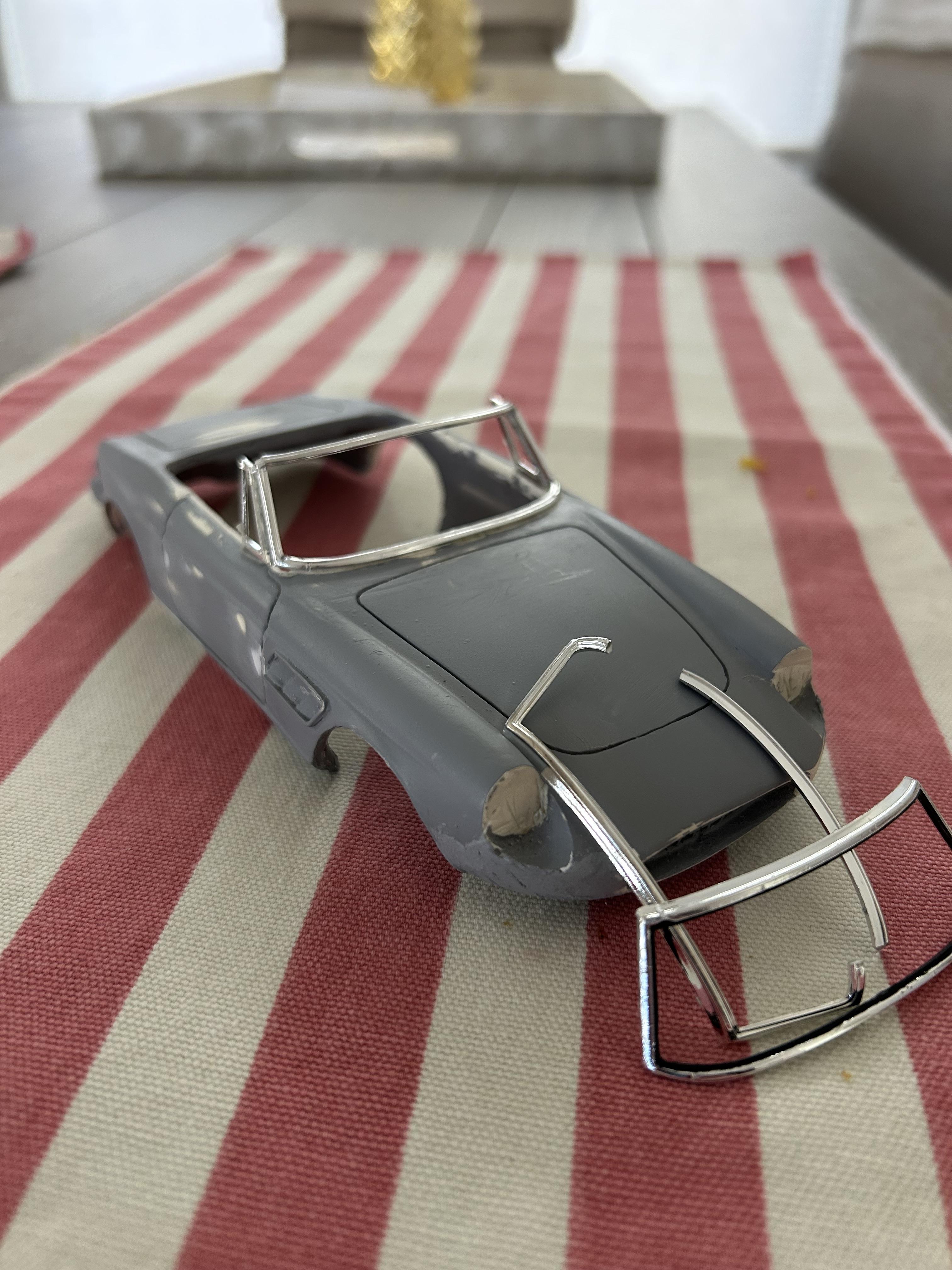

  12. Windshields in. Had to make my own front windshield as couldn’t get the kit one to stay in place without interfering with dashboard. With progressive cuts to fir with dashboard no longer had enough material to secure in place. Replaced with .005 inch clear polystyrene sheet opting against side windows

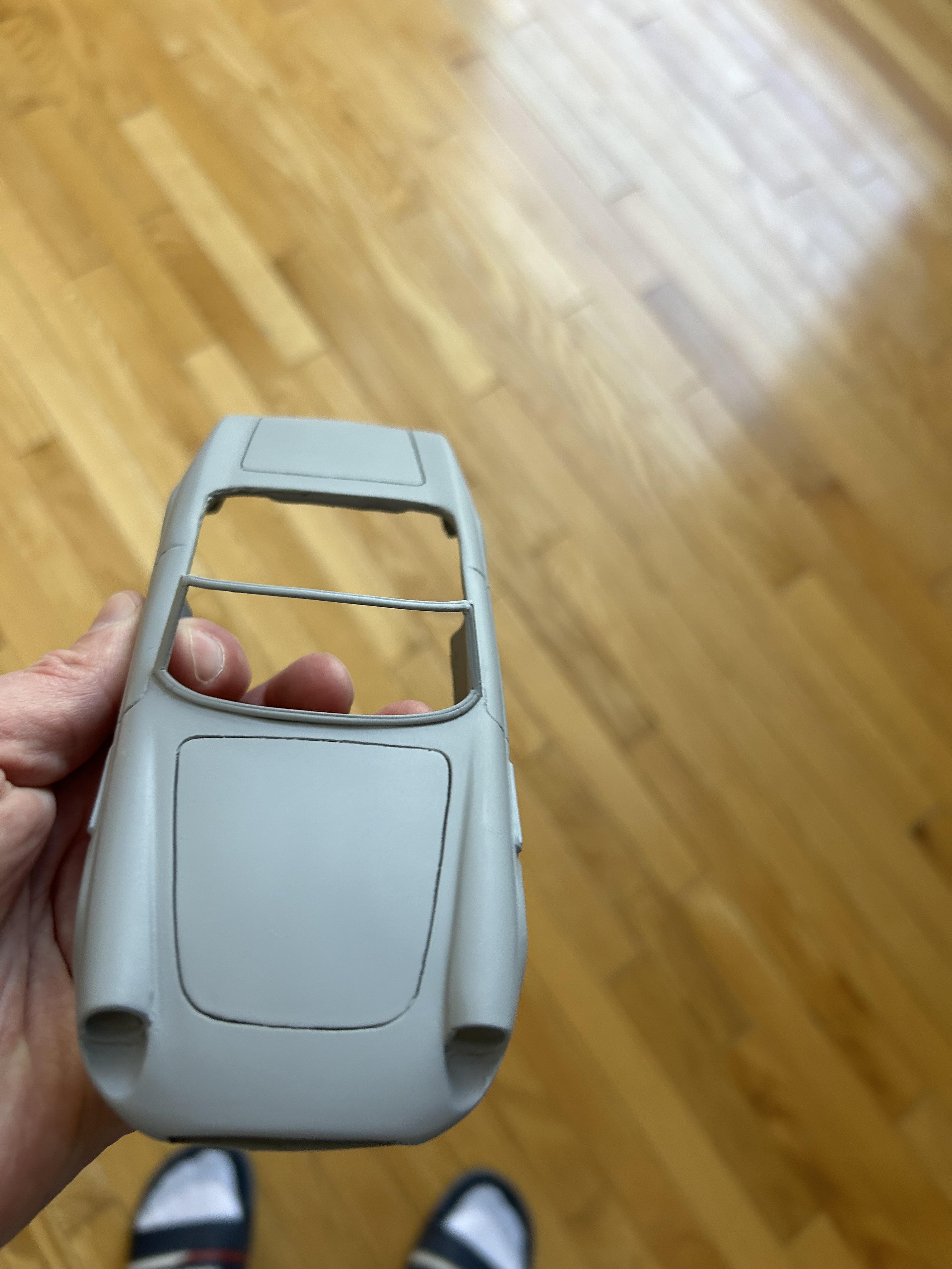

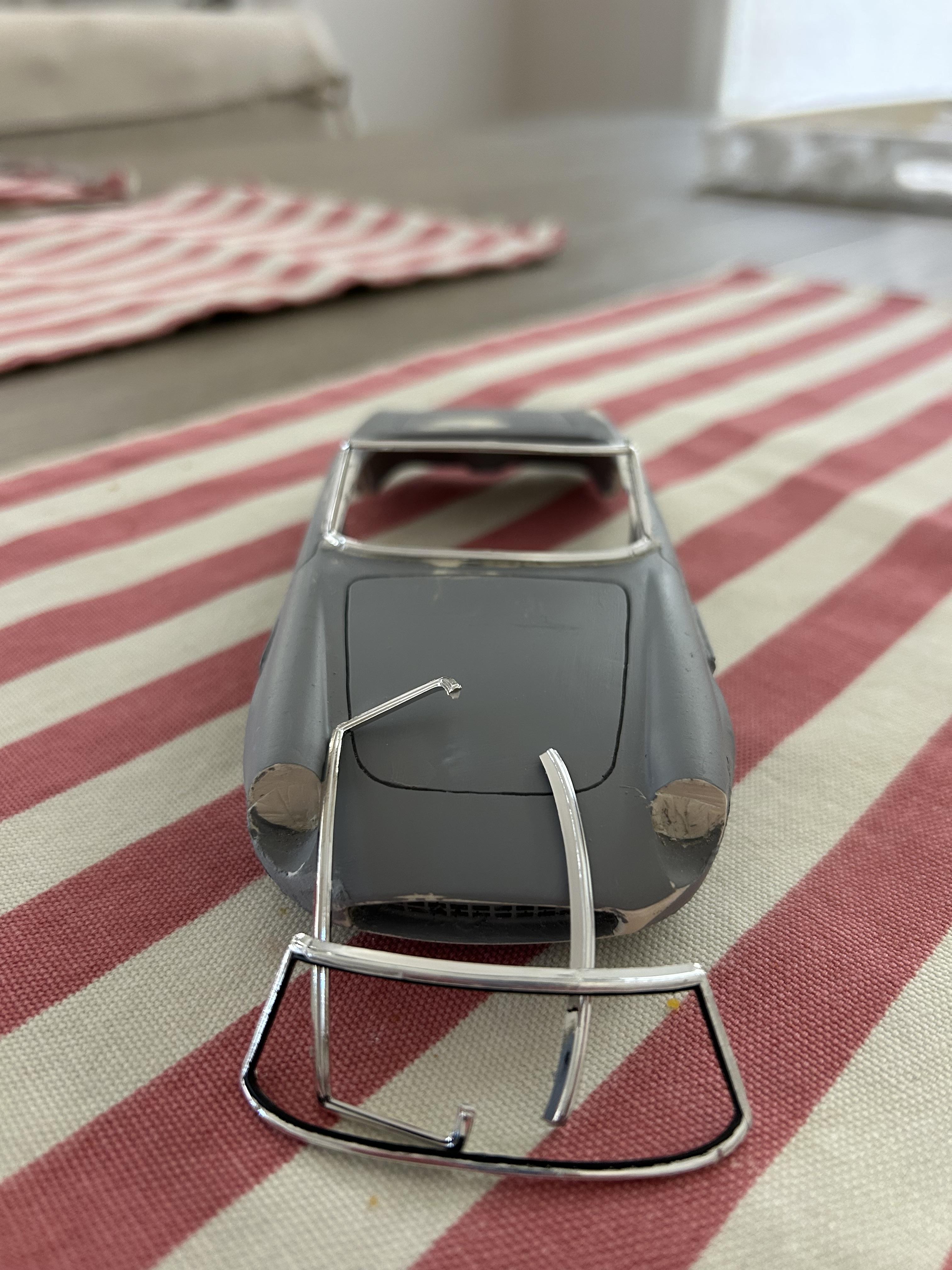

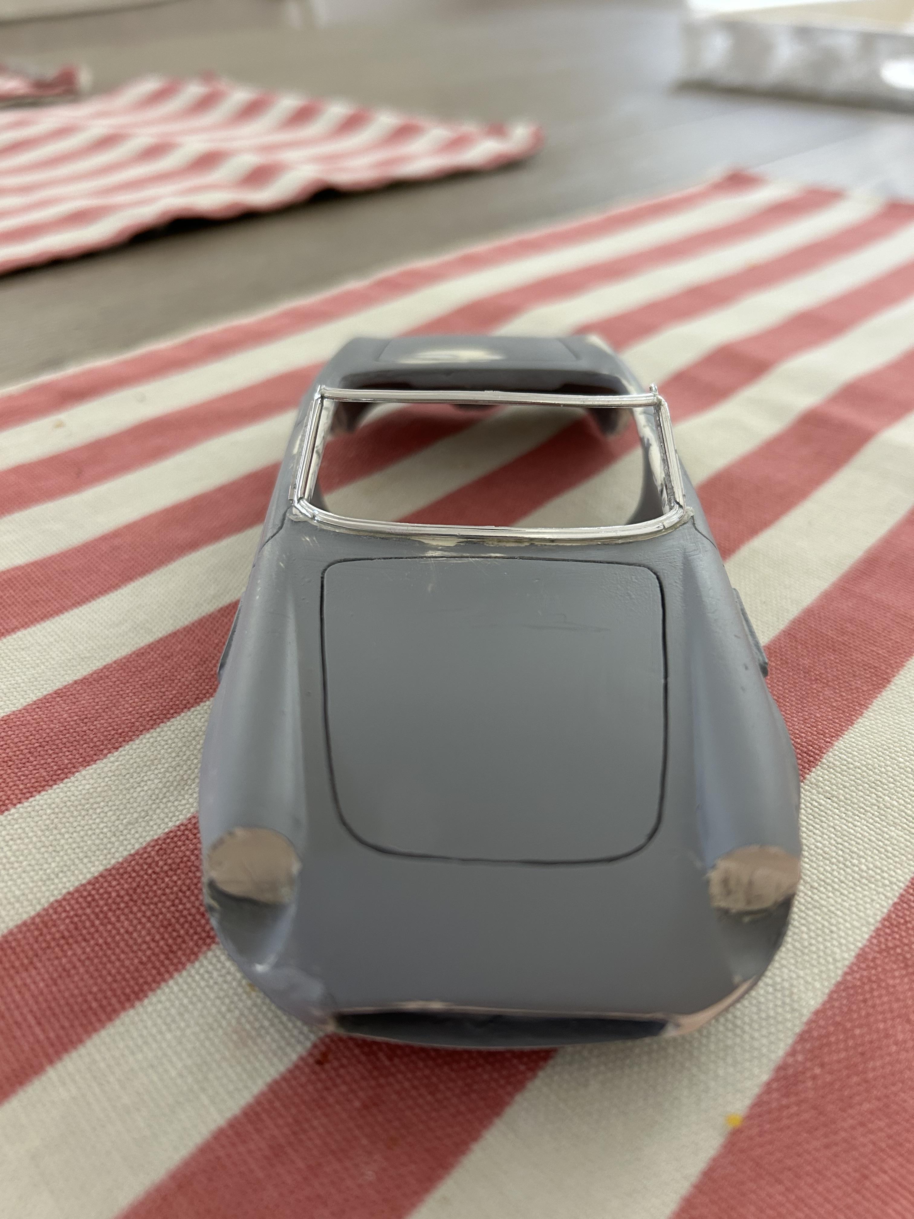

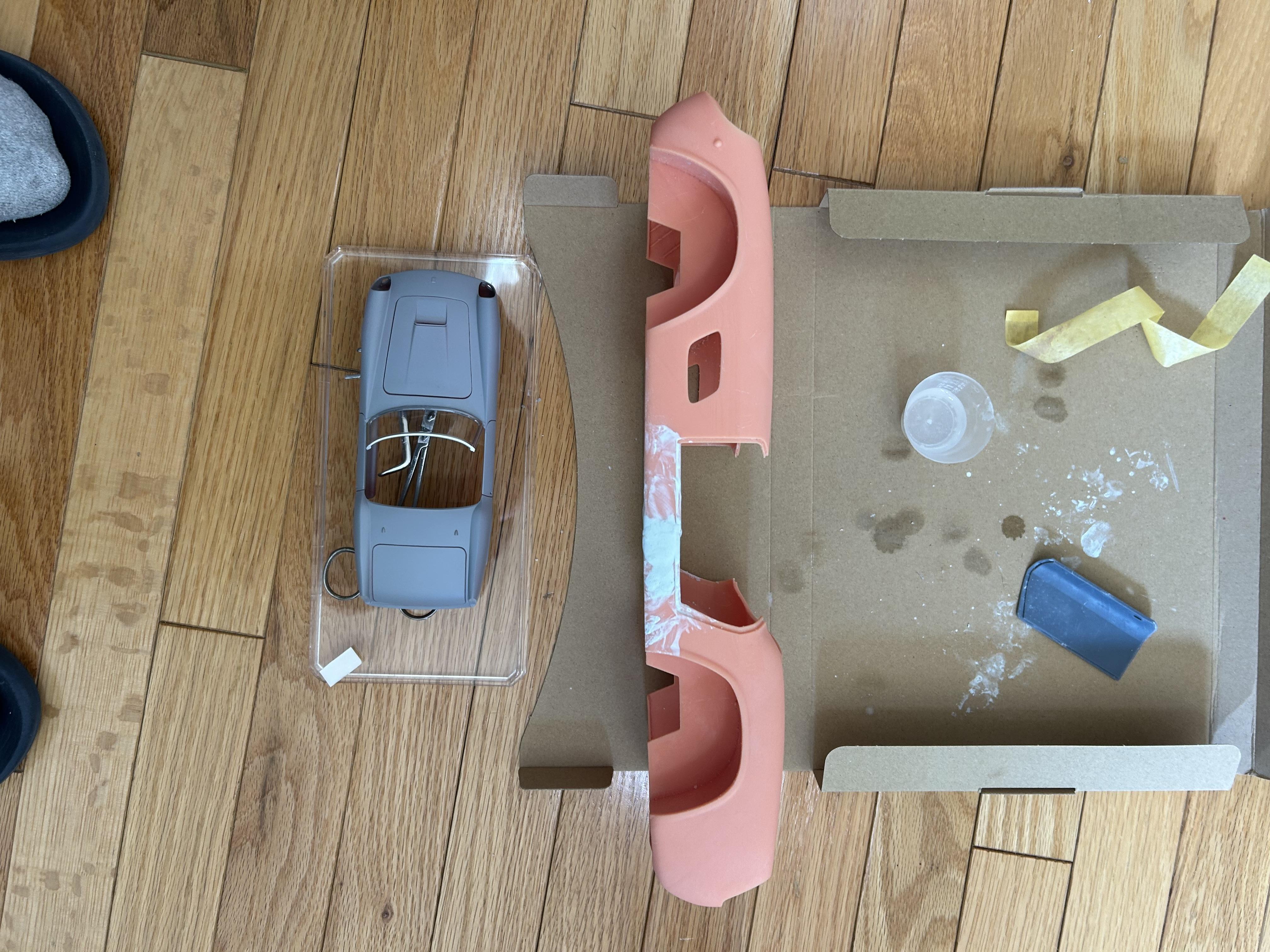

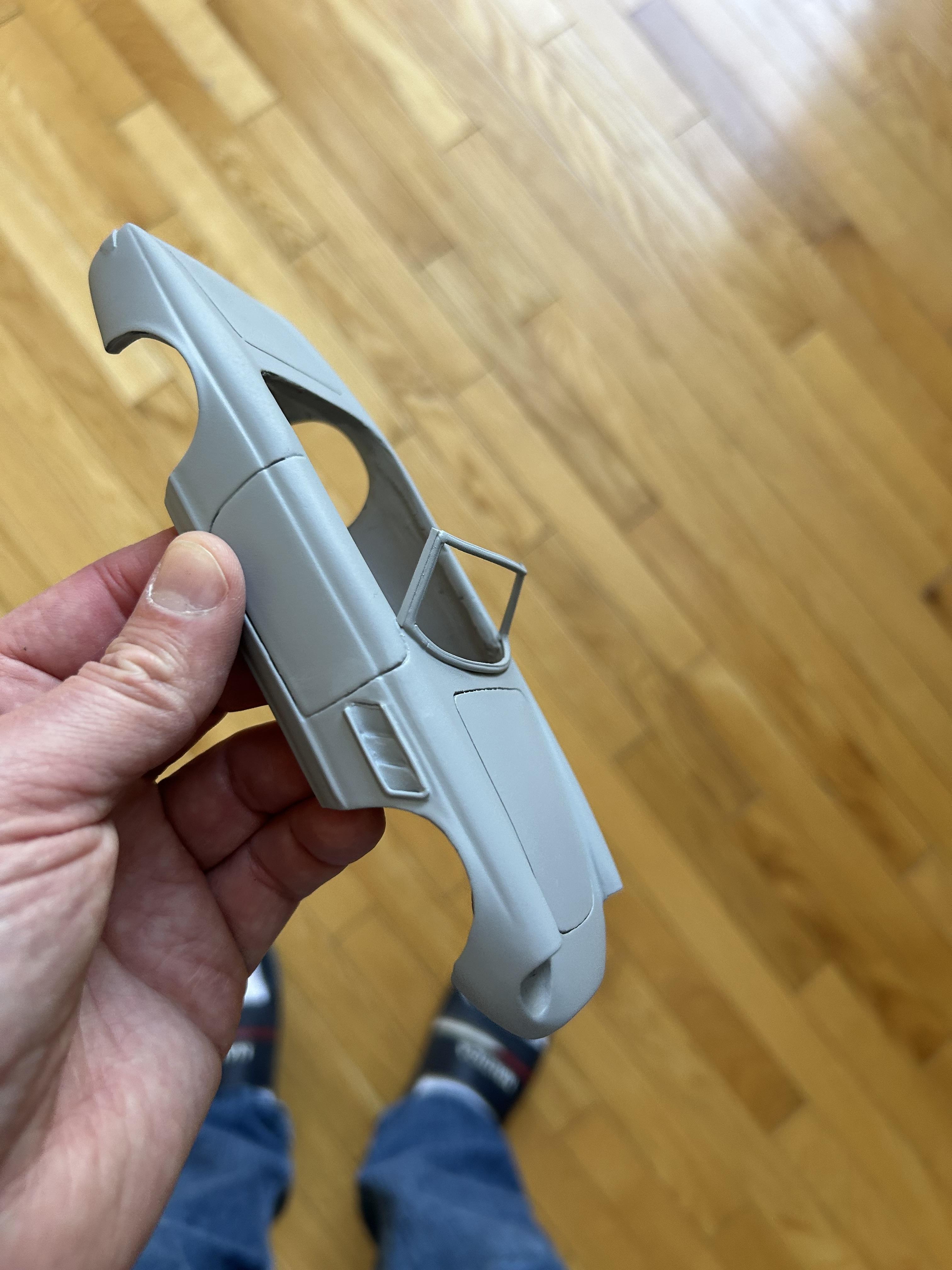

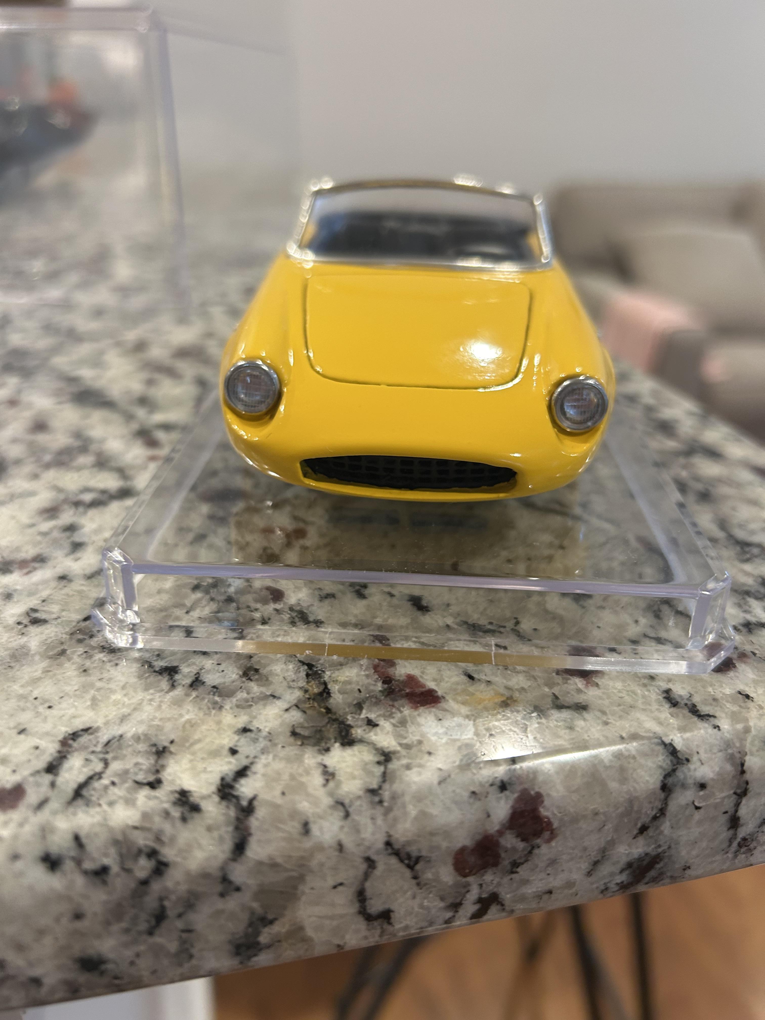

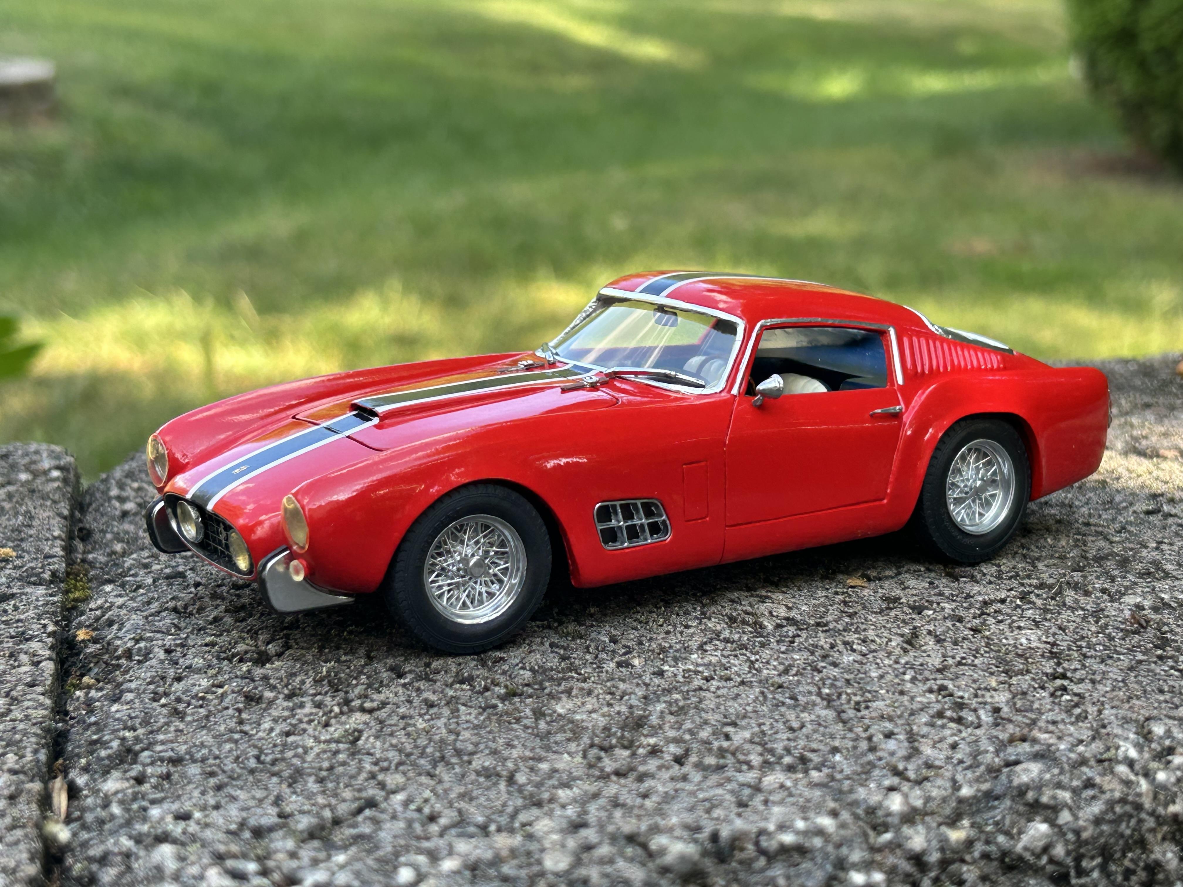

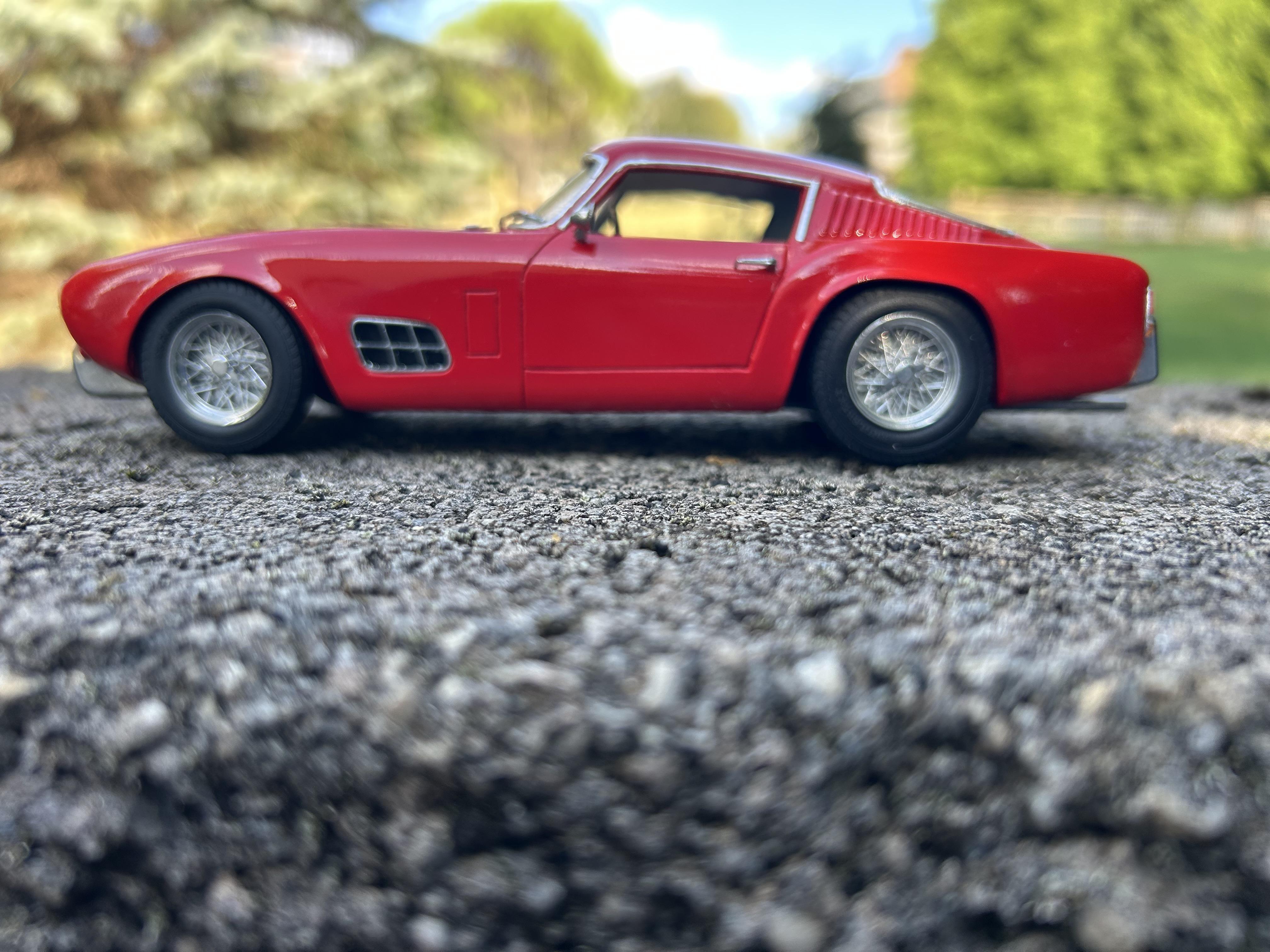

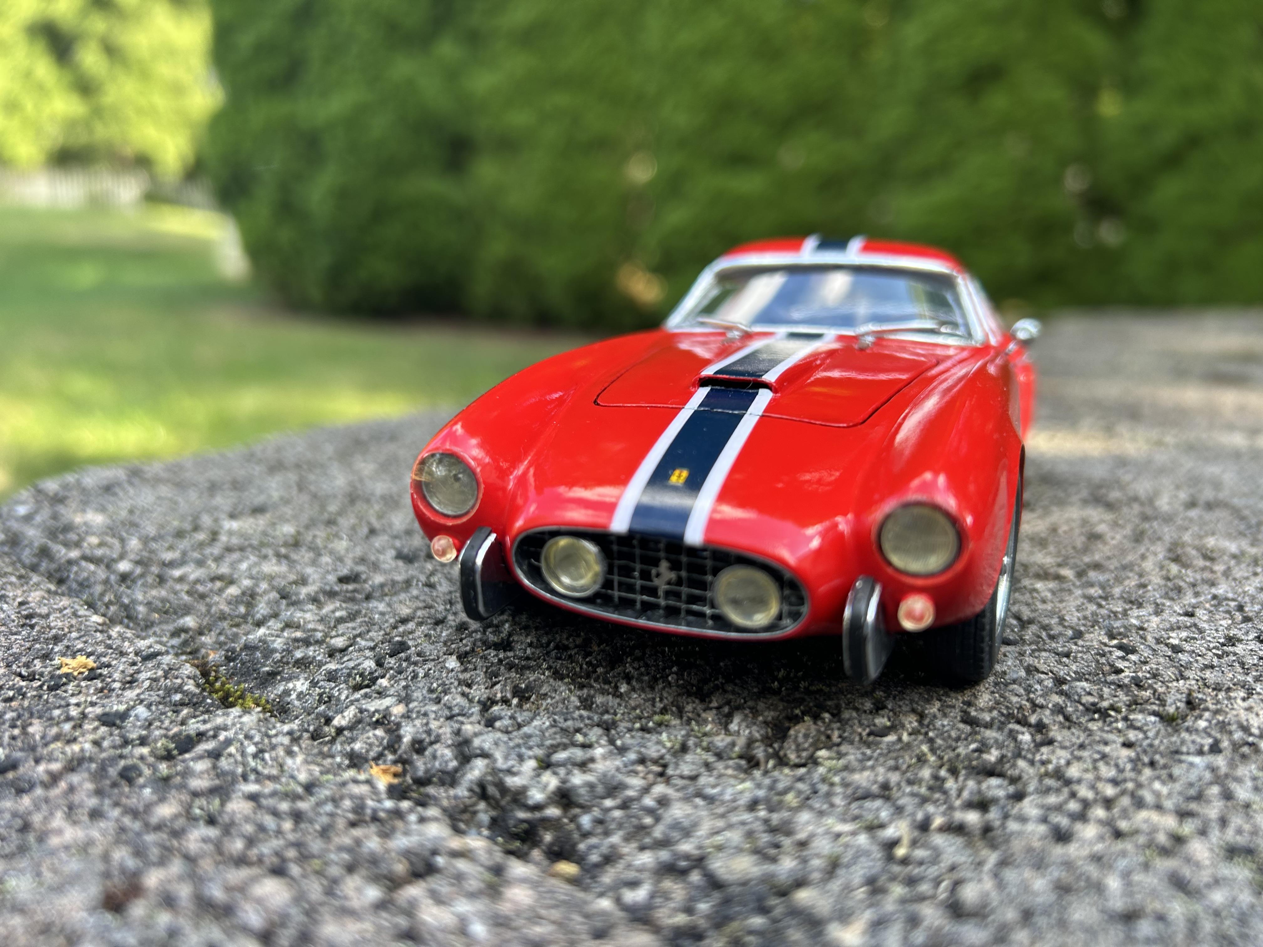

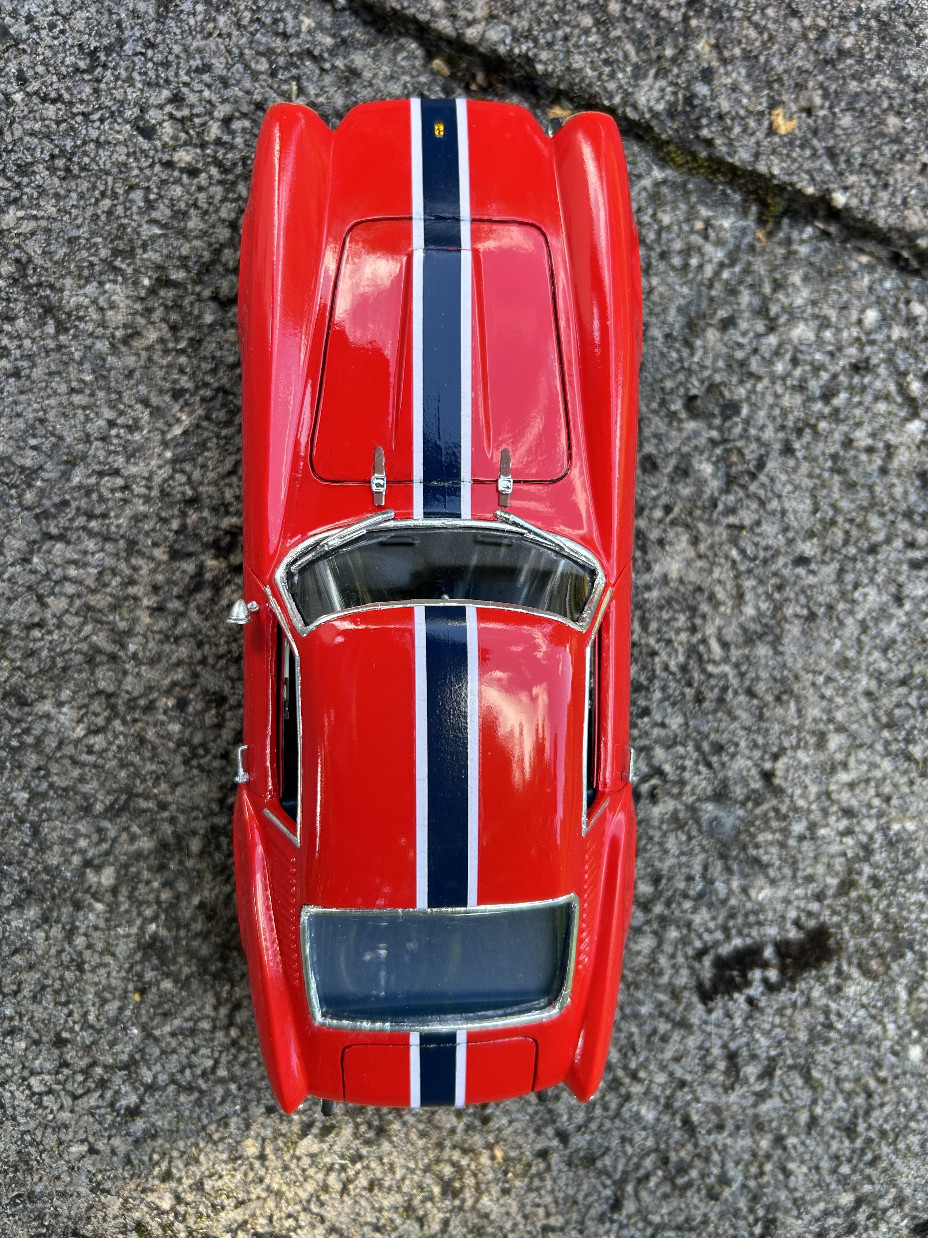

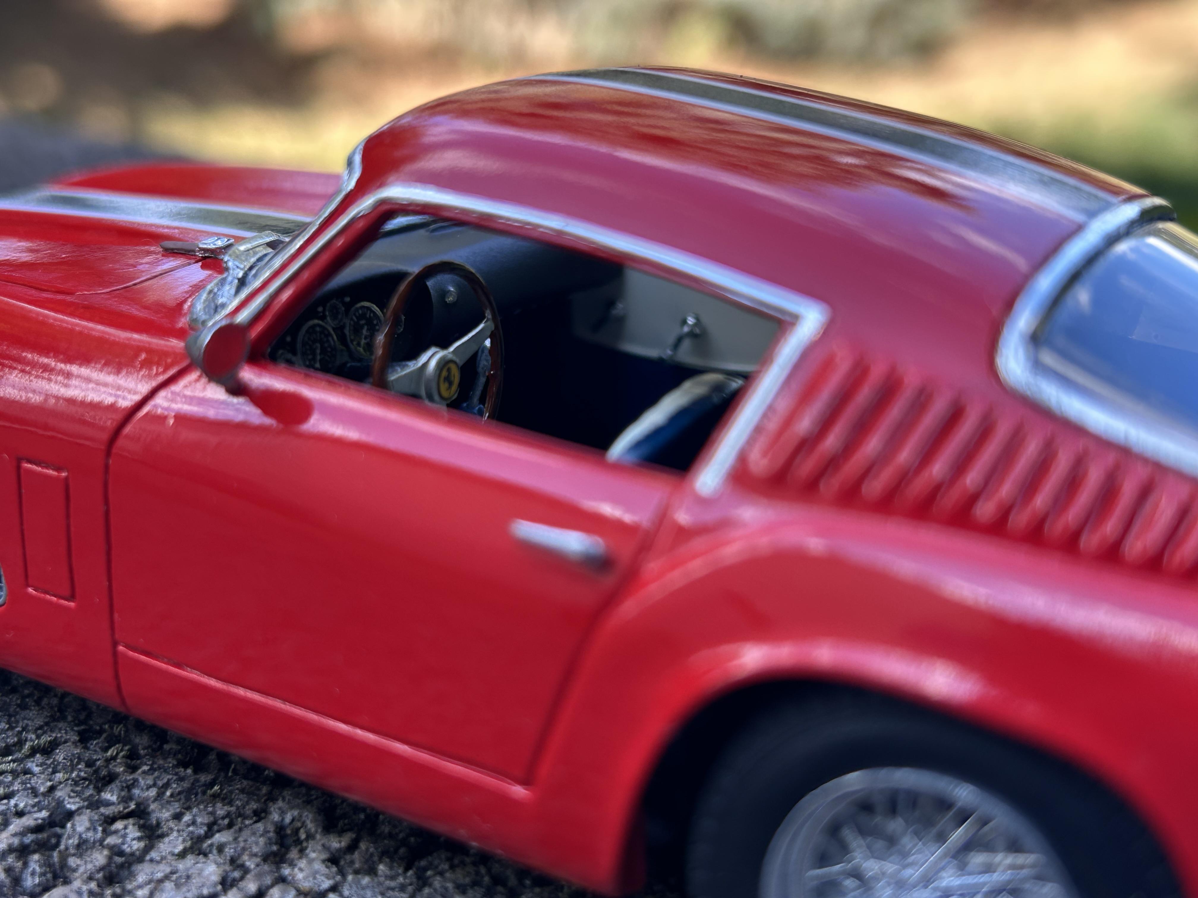

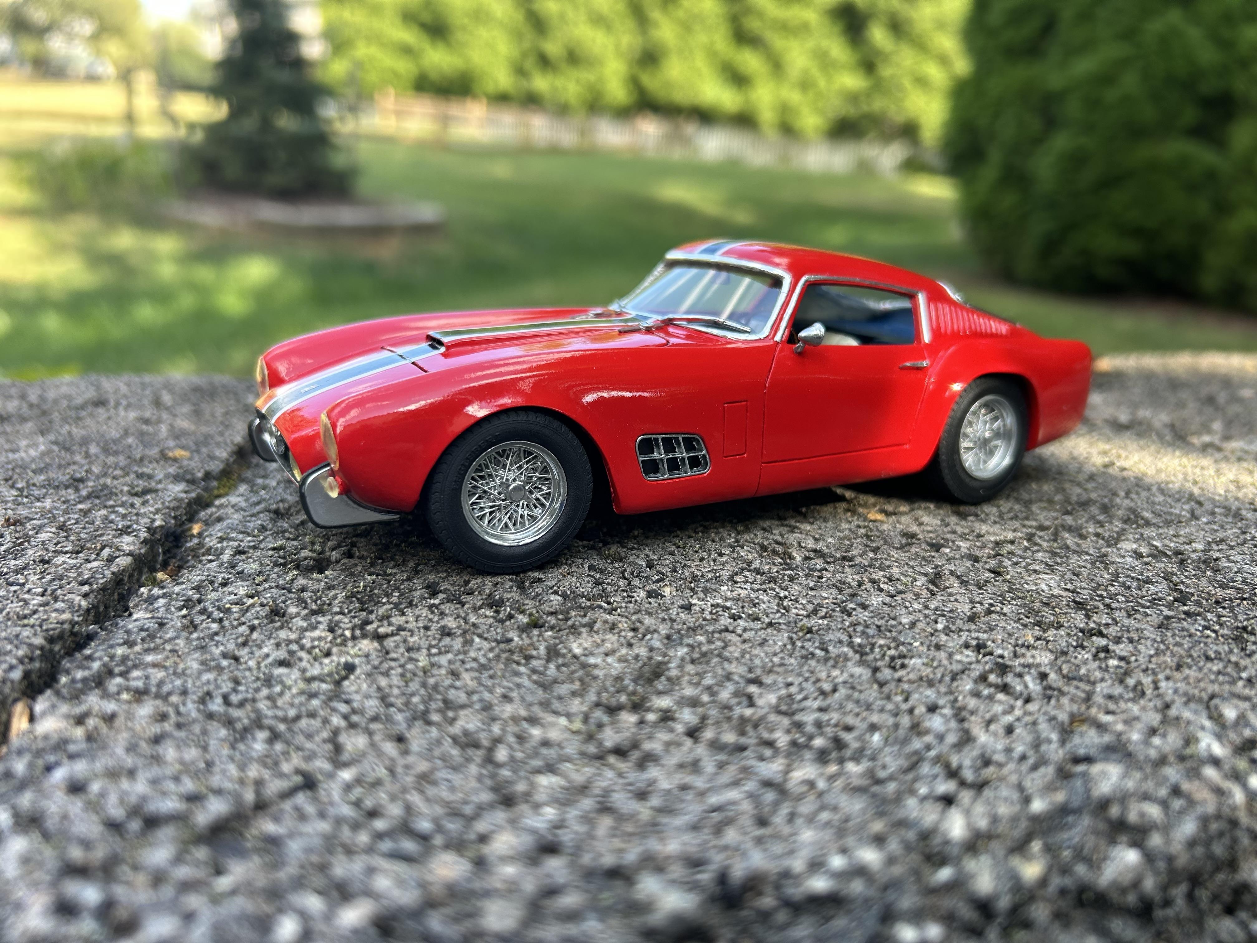

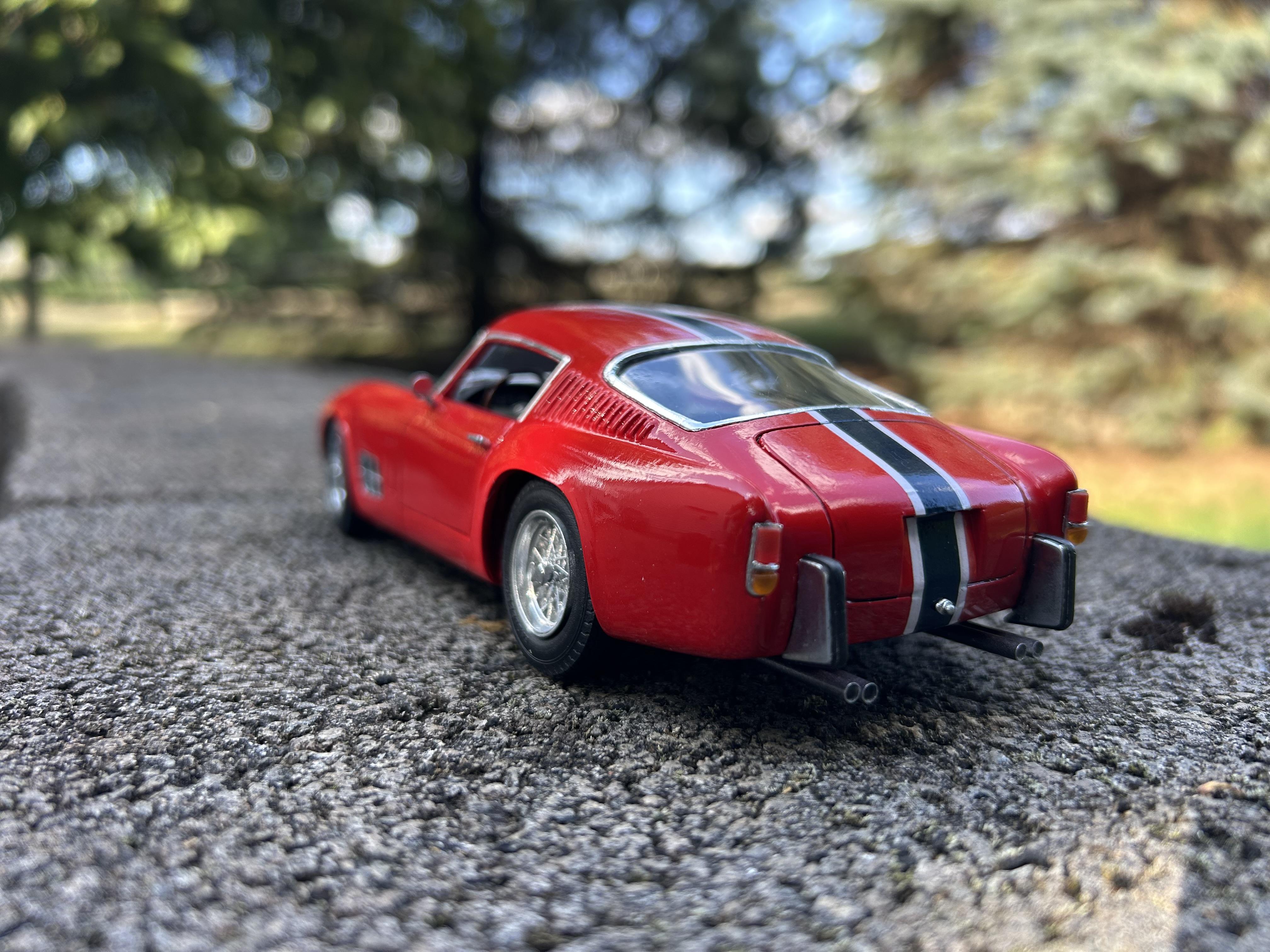

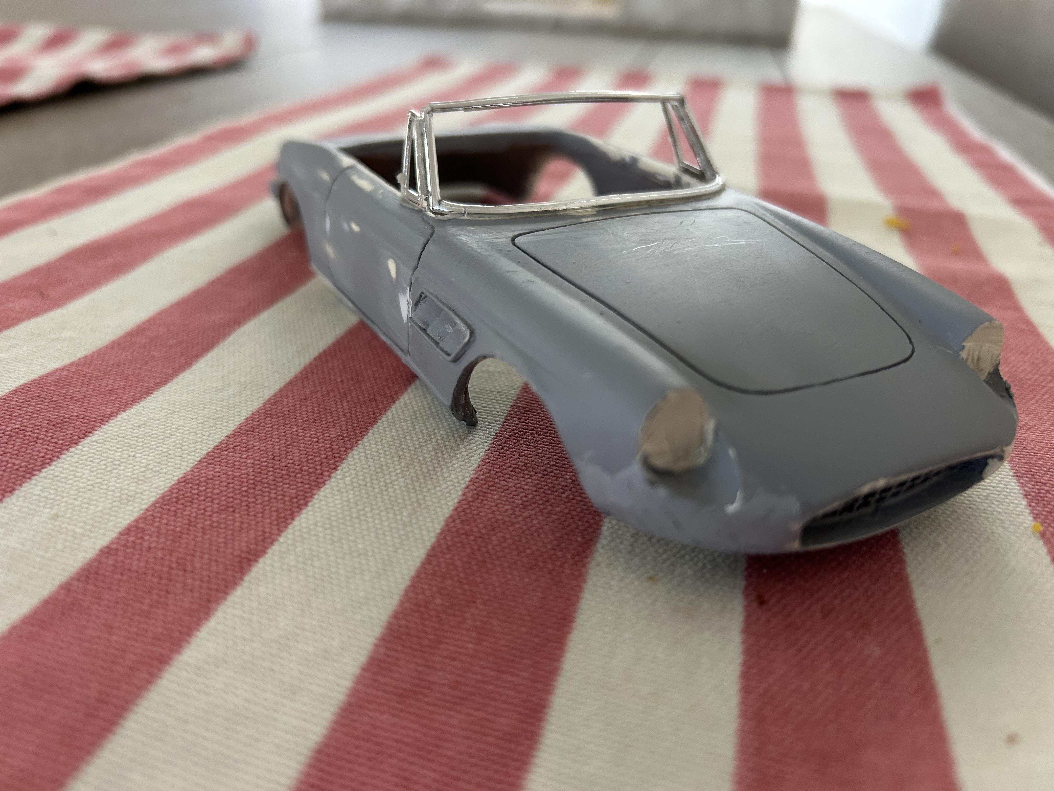

    Ferrari 330 gts

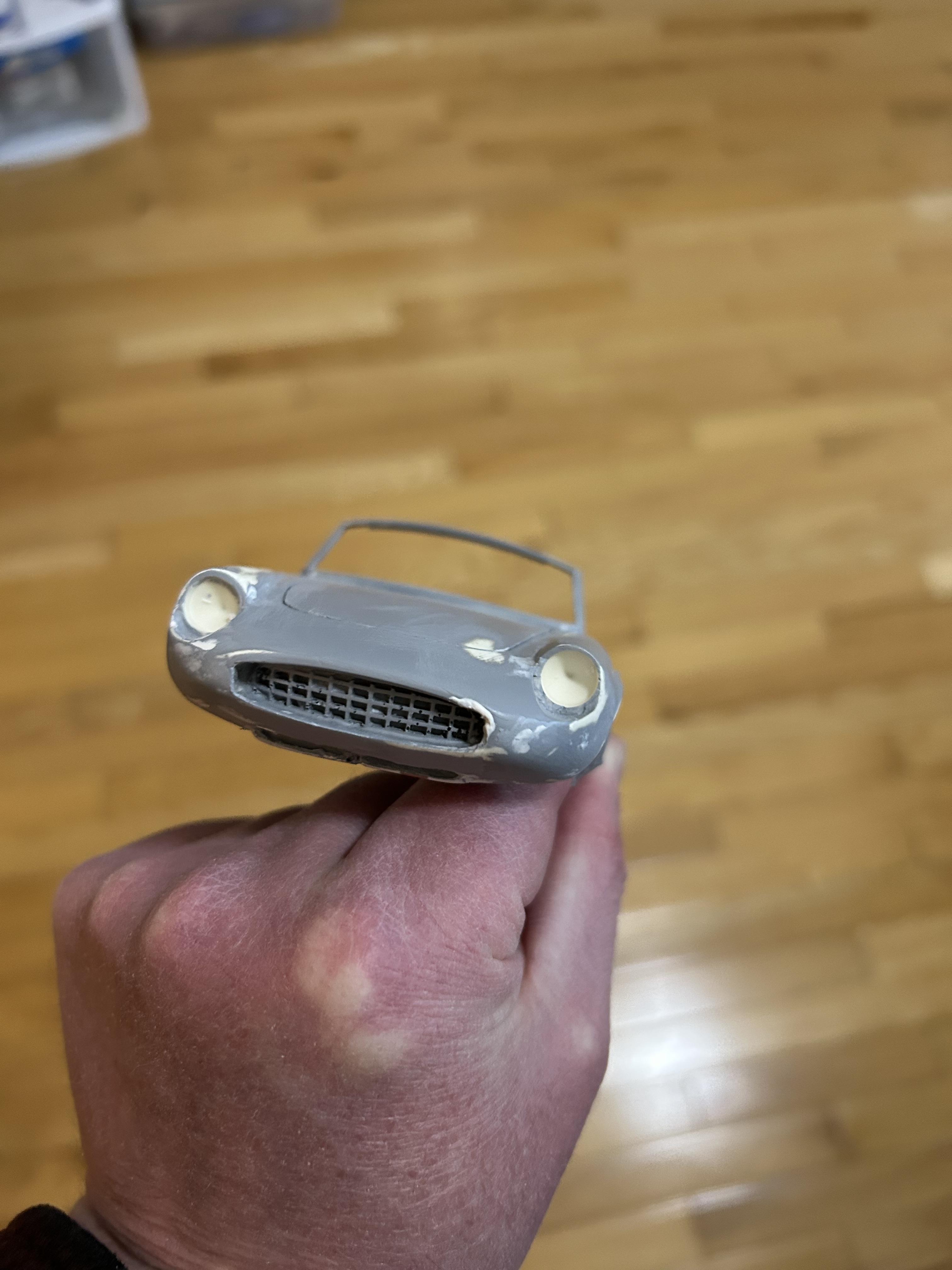

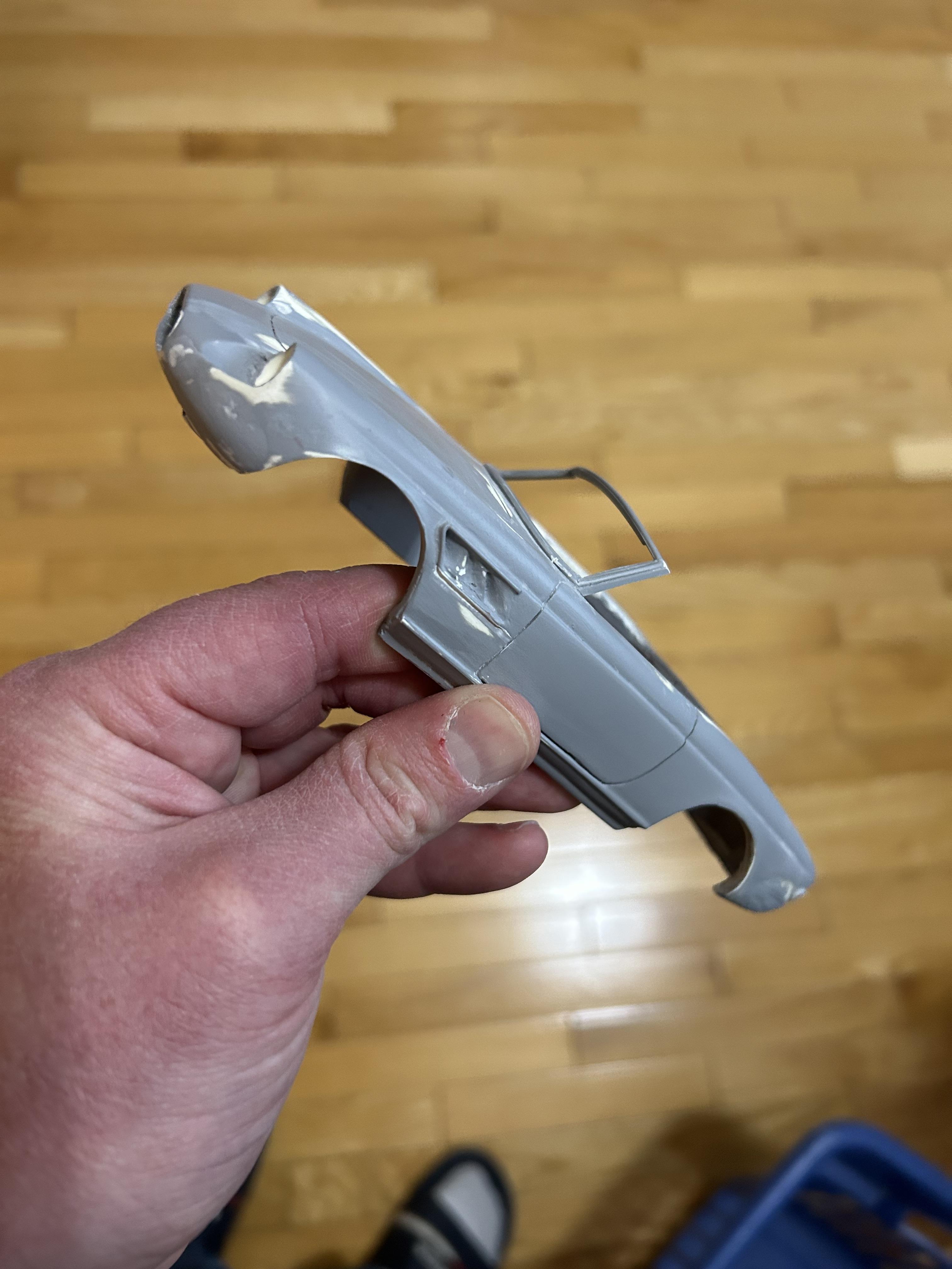

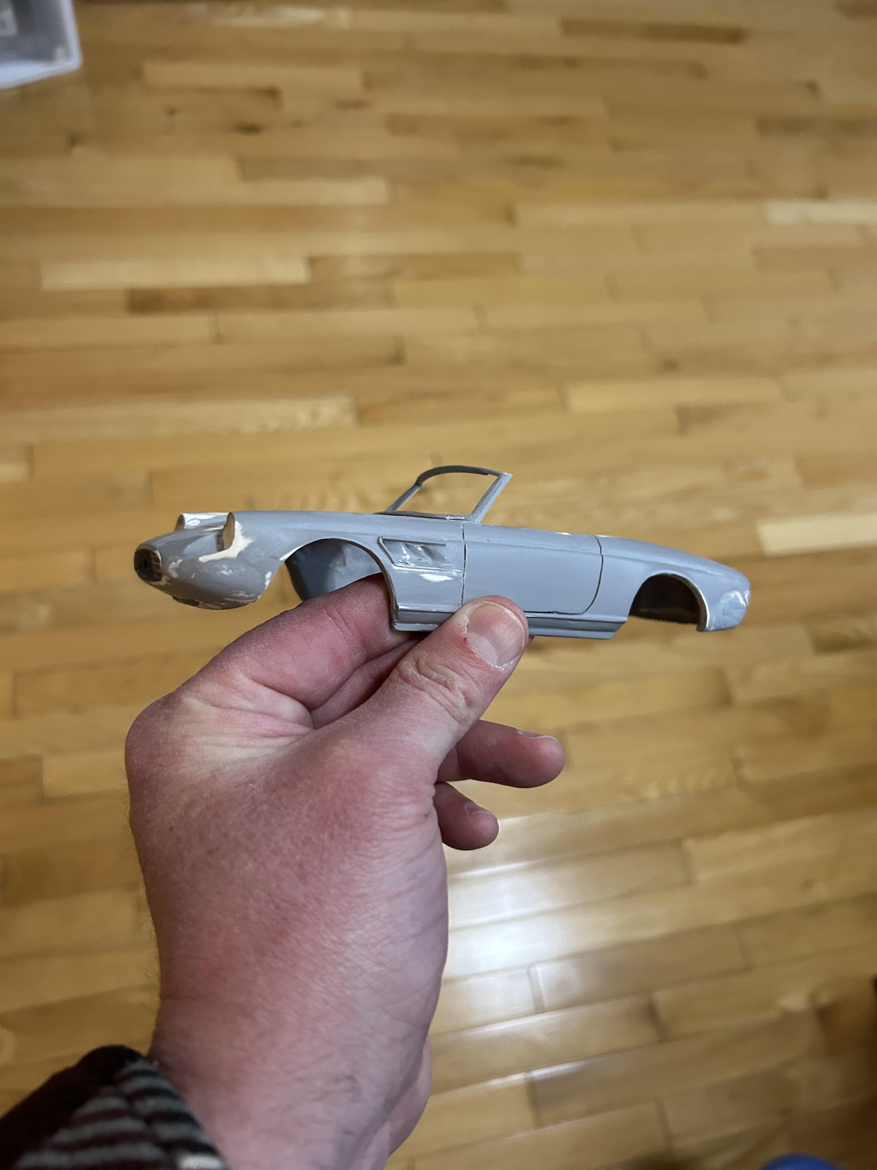

    Ferrari 330 gts started with a urethane casting copy of what was likely an Airtrax kit sourced on eBay. (See similar casting of a 275 gts starting point obtained from same source. cast bumpers, windshield, side windows and door handles removed. Lots of putty and body work. Front bumpers from an italeri Ferrari 275 gts NART kit. Side marker lights cast in clear resin from same kit. Wheels from italeri unused stash. Exhaust from italeri Ferrari 365 gtb4. Windshield frame made from 2 unused Italeri Ferrari 250 California kits. Windshield hand made. rear bumpers and inner door panels remade from casting of parts from an actual Airtrax Ferrari 330gtc kit. Quarter windows reshaped from extras supplied in Italeri Ferrari 275 gtb door handles from a Volkswagen Beetle kit front headlights from extra parts in amt kit chrome is from revell chrom spray paint on bumpers and headlight and bare metal foil for windshield surround and side moldings

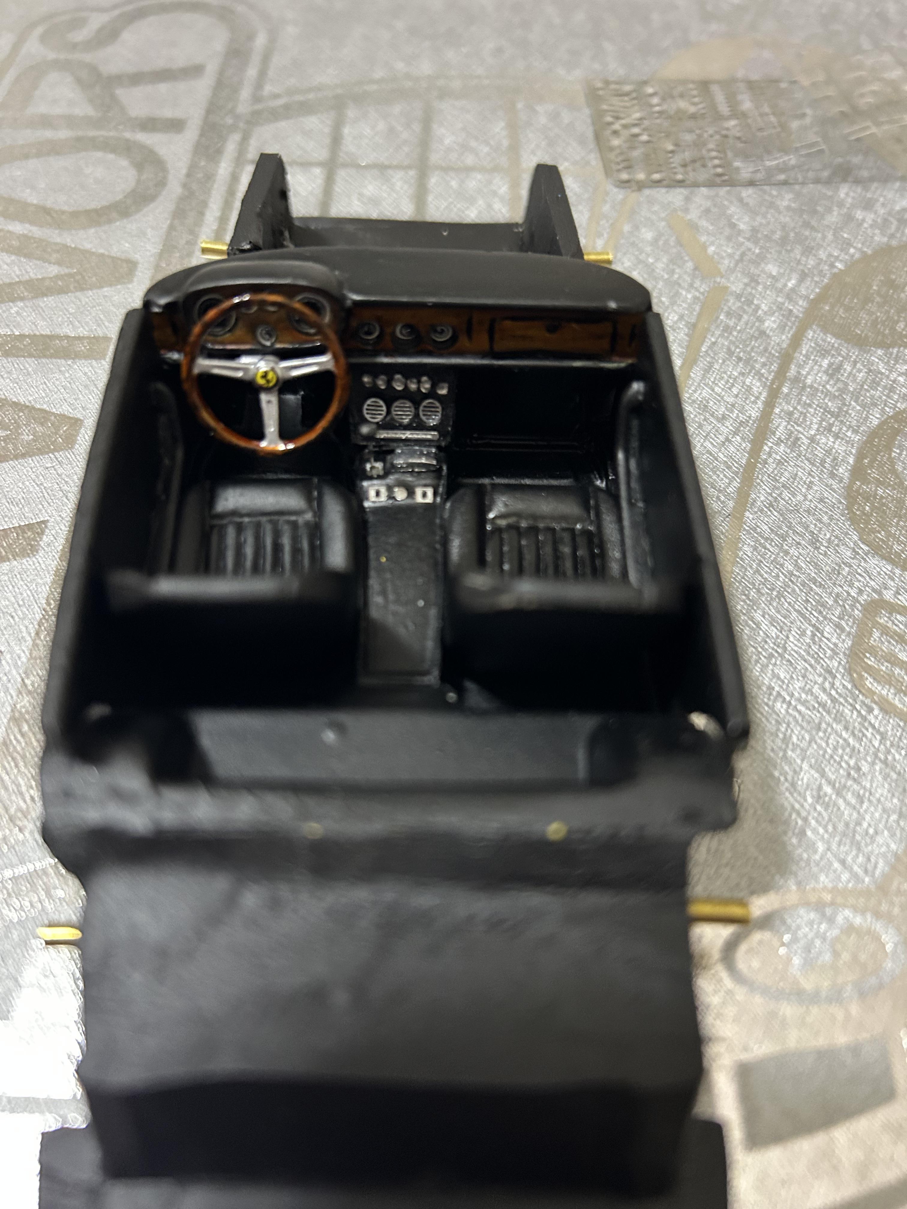

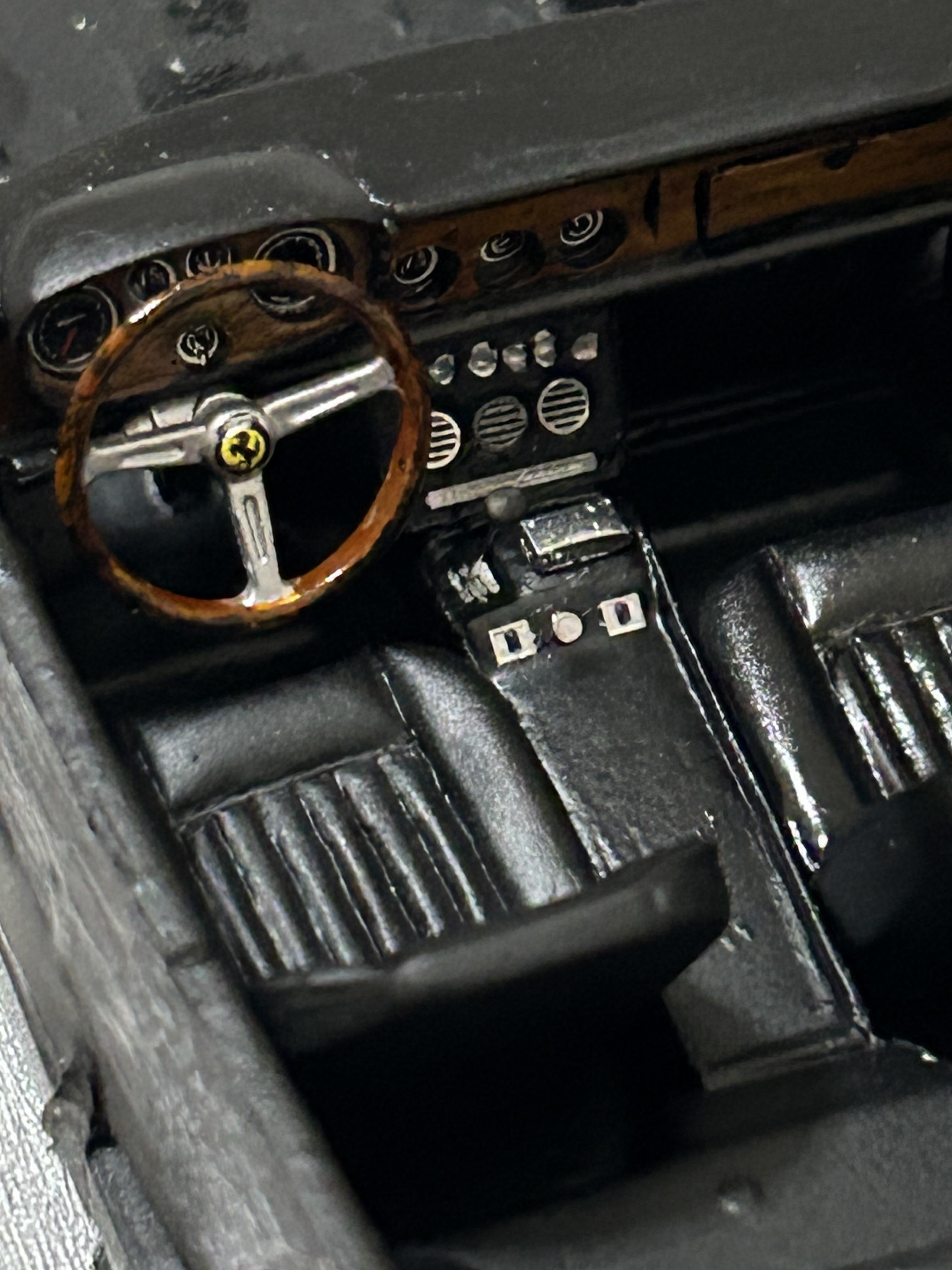

    Interior pretty much completed

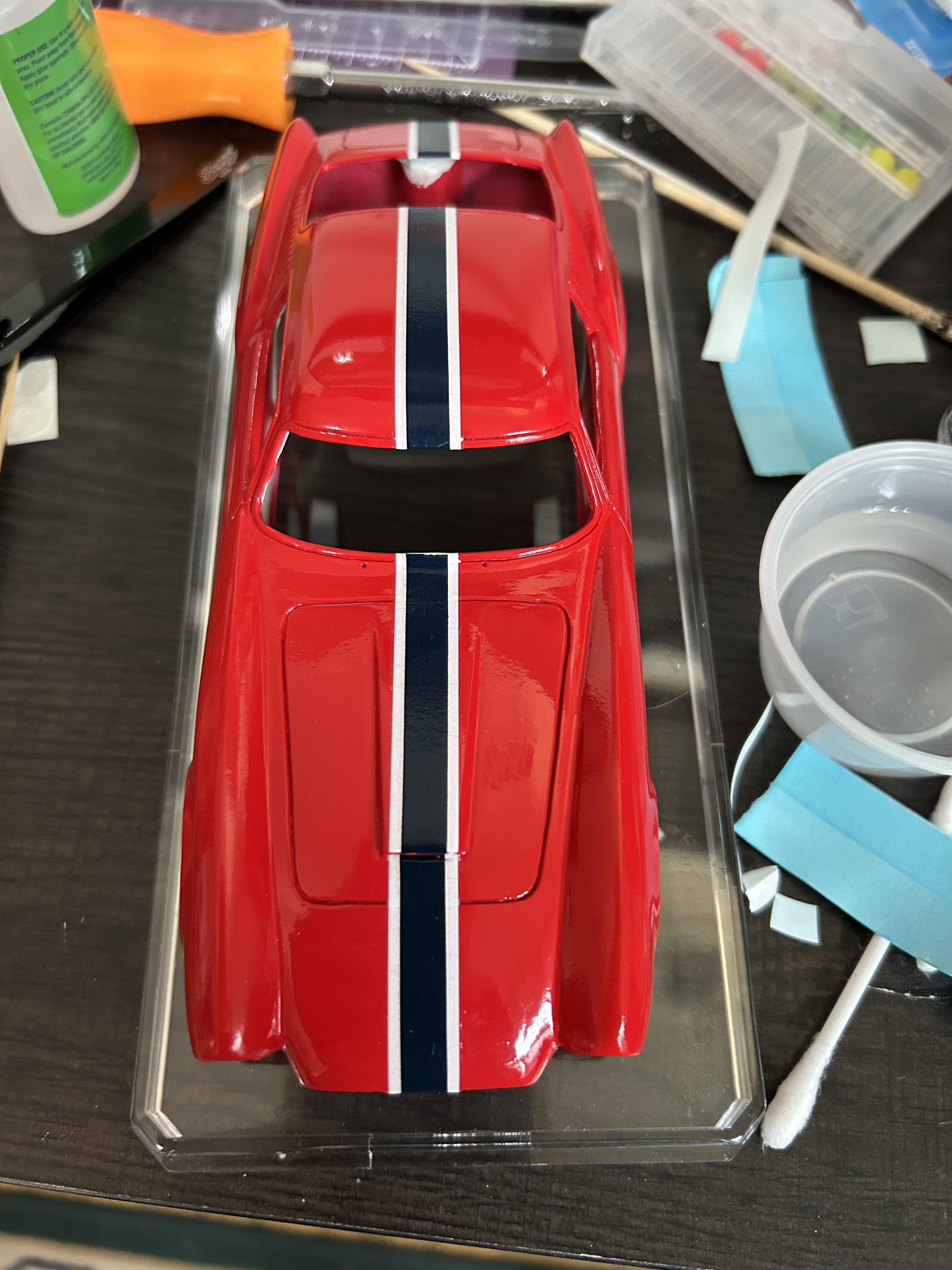

  15. Stripes added

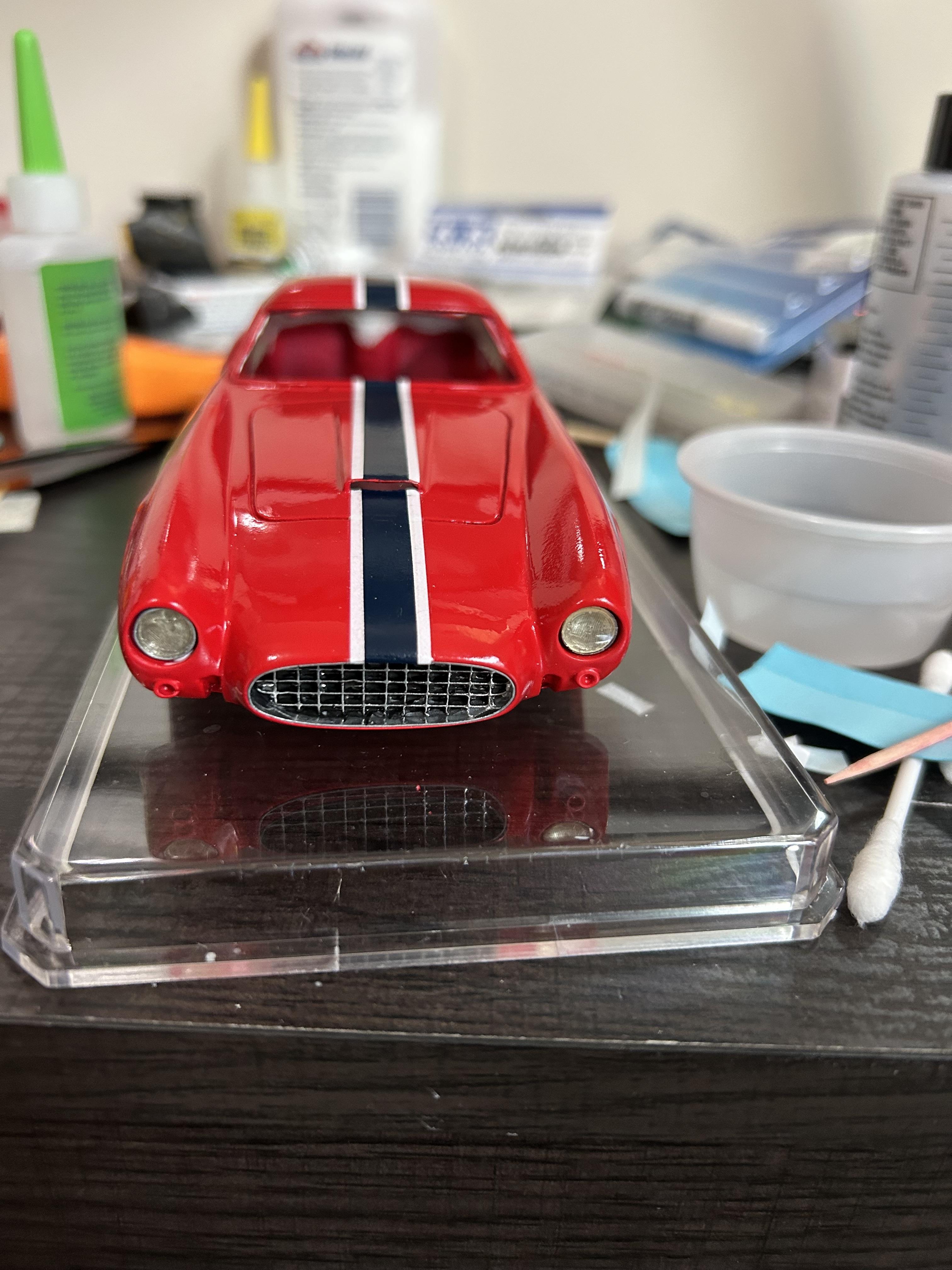

    Extra headlights from amt Ferrari 250 swb Revell chrom spray paint for headlight chrome

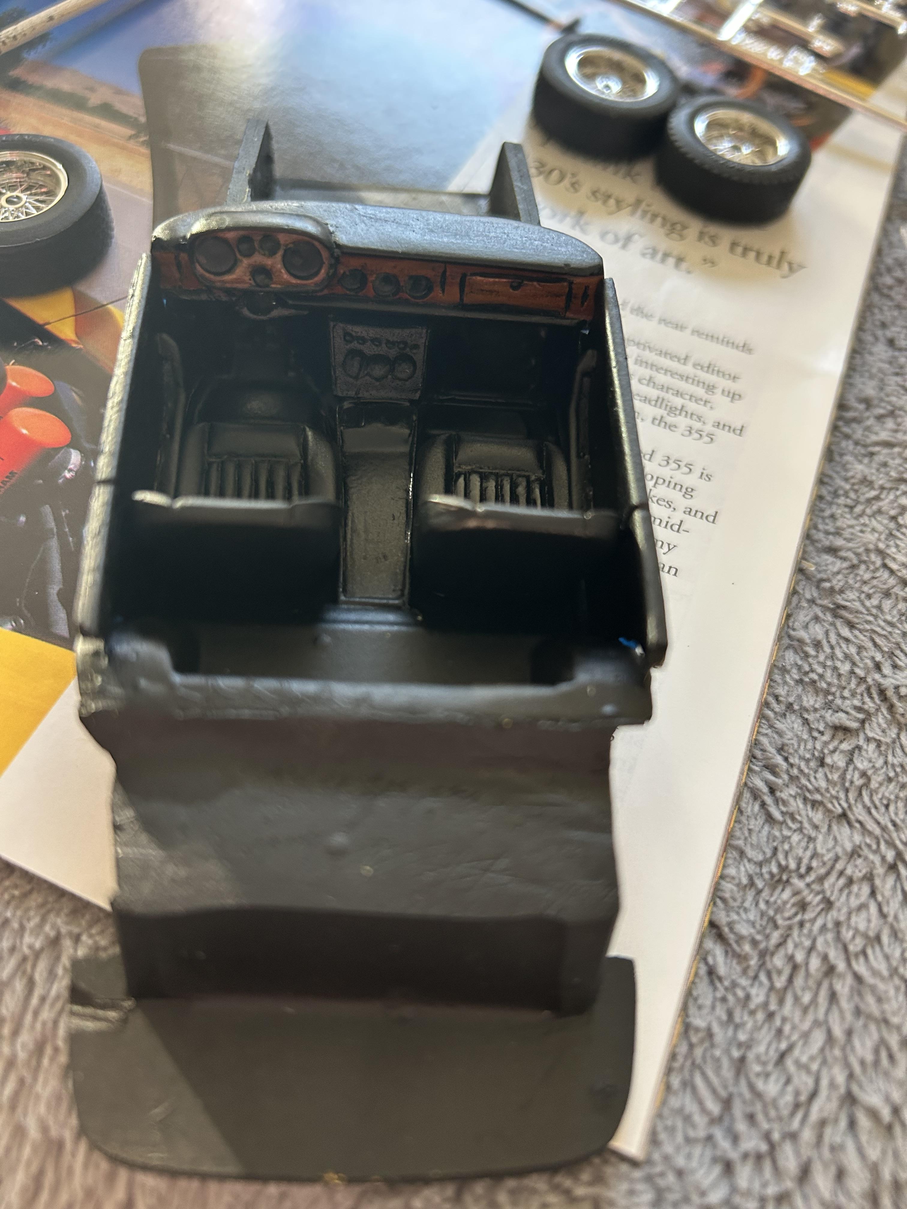

    Ferrari 330 gts
    Windshield made and in place new door panels cast interior taking shapee

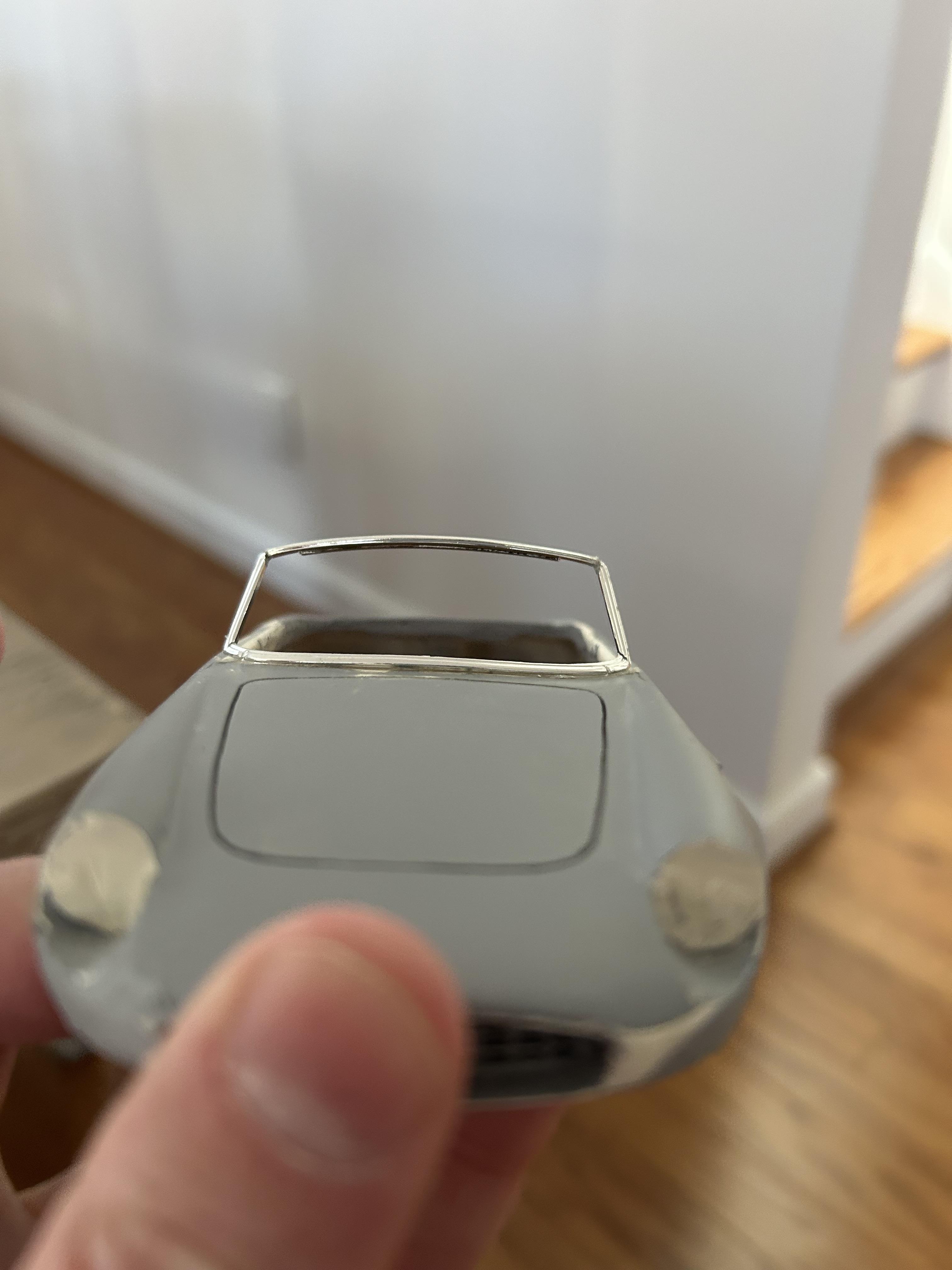

    Ferrari 330 gts

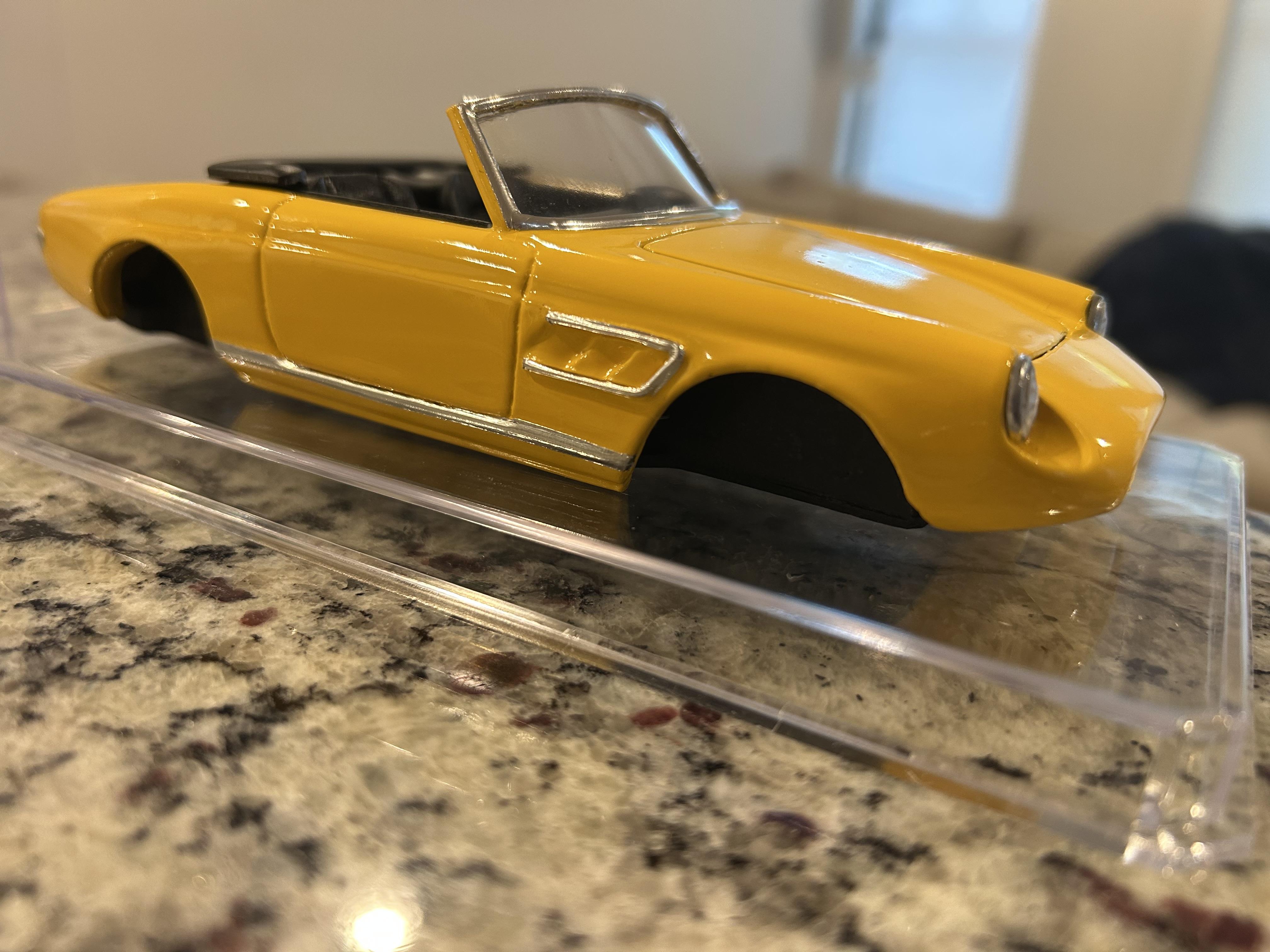

    Bare metal foil completed on 330gts
