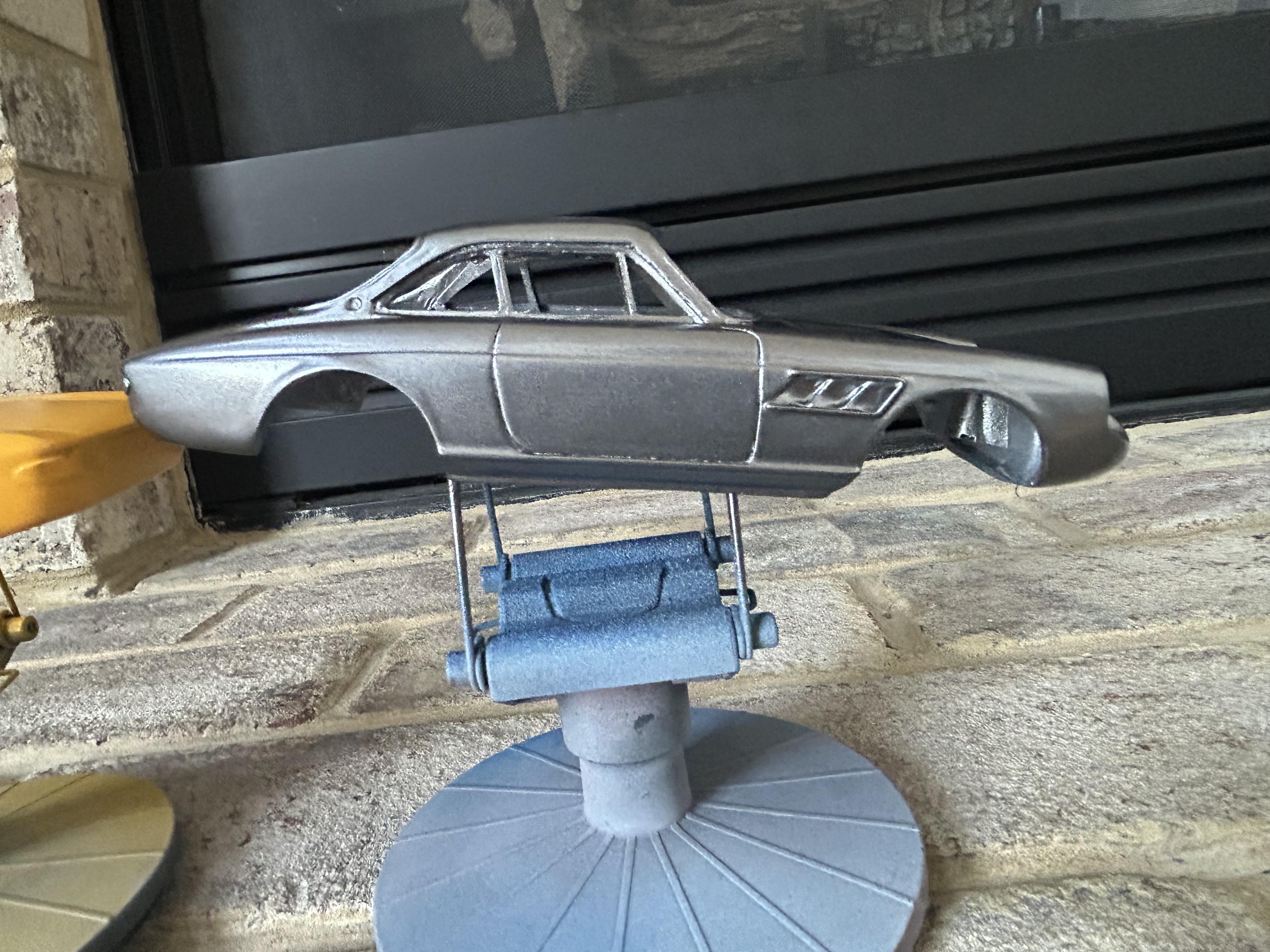

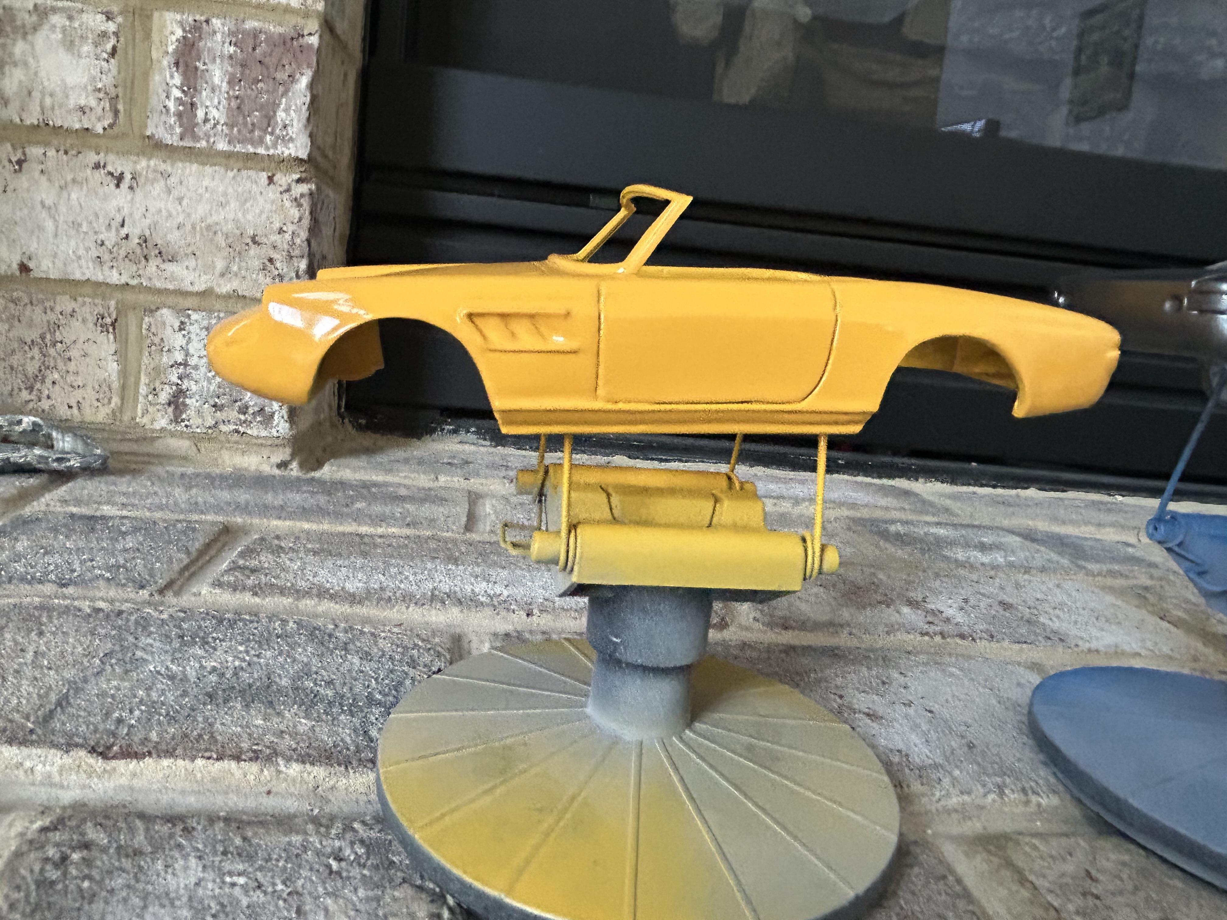

Ferrari 330 gts started with a urethane casting copy of what was likely an Airtrax kit sourced on eBay. (See similar casting of a 275 gts starting point obtained from same source. cast bumpers, windshield, side windows and door handles removed. Lots of putty and body work. Front bumpers from an italeri Ferrari 275 gts NART kit. Side marker lights cast in clear resin from same kit. Wheels from italeri unused stash. Exhaust from italeri Ferrari 365 gtb4. Windshield frame made from 2 unused Italeri Ferrari 250 California kits. Windshield hand made. rear bumpers and inner door panels remade from casting of parts from an actual Airtrax Ferrari 330gtc kit. Quarter windows reshaped from extras supplied in Italeri Ferrari 275 gtb door handles from a Volkswagen Beetle kit front headlights from extra parts in amt kit chrome is from revell chrom spray paint on bumpers and headlight and bare metal foil for windshield surround and side moldings
