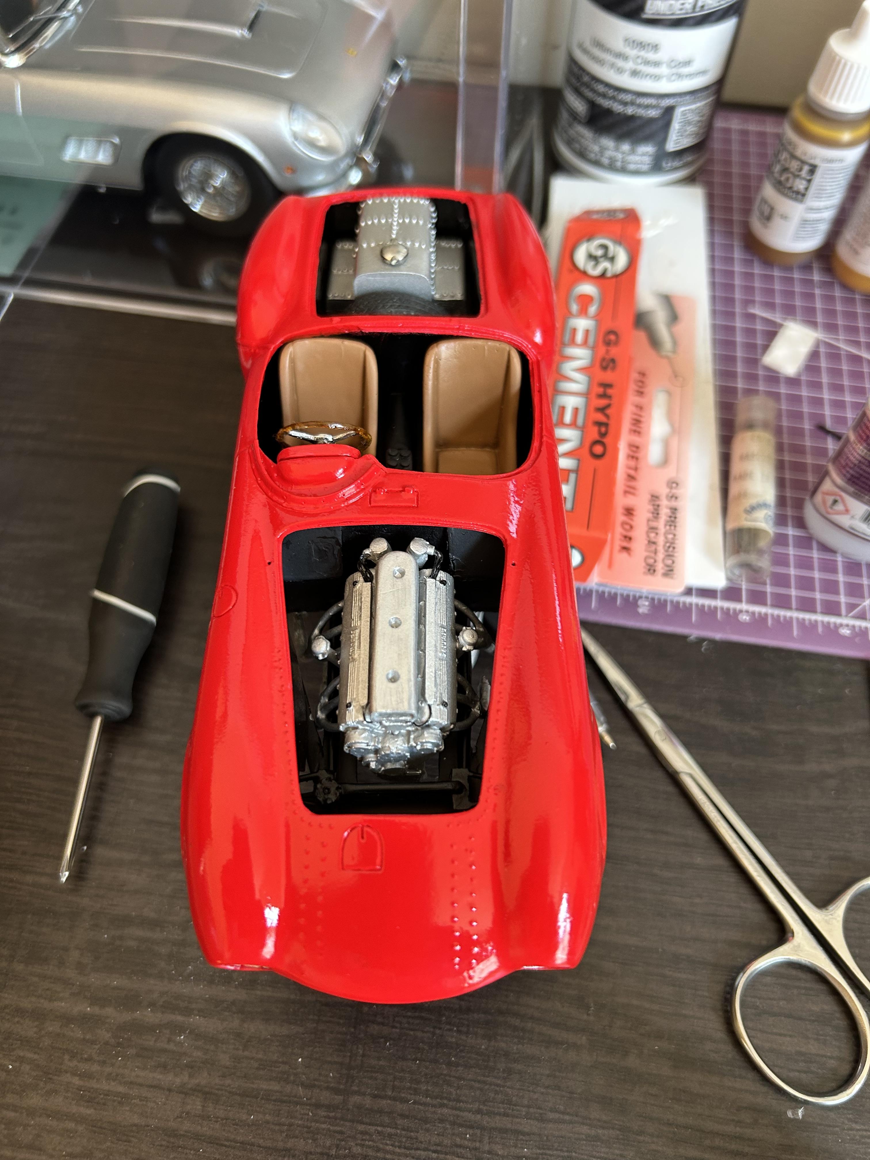

  2. Yes there is a resin engine that comes with the kit

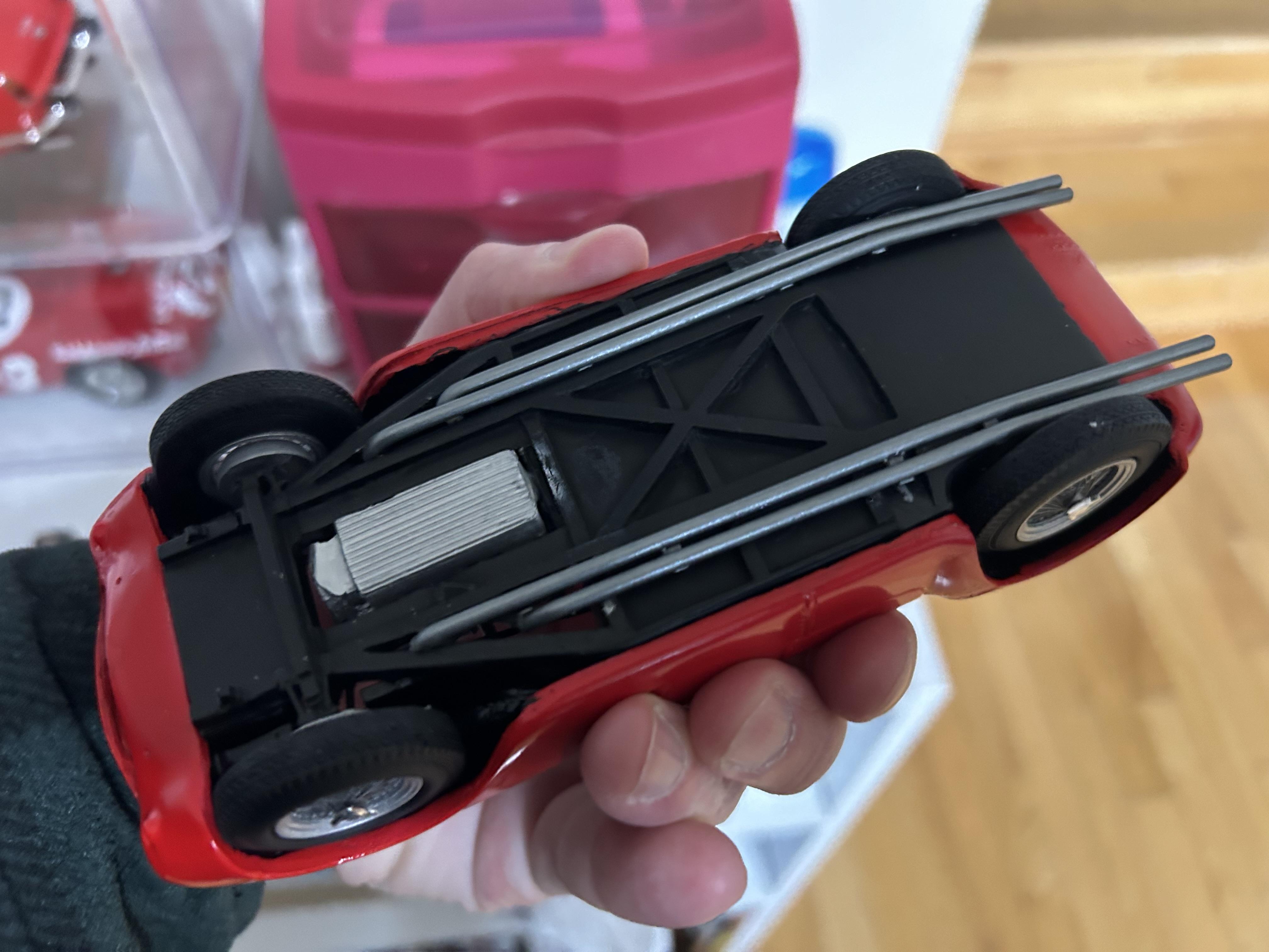

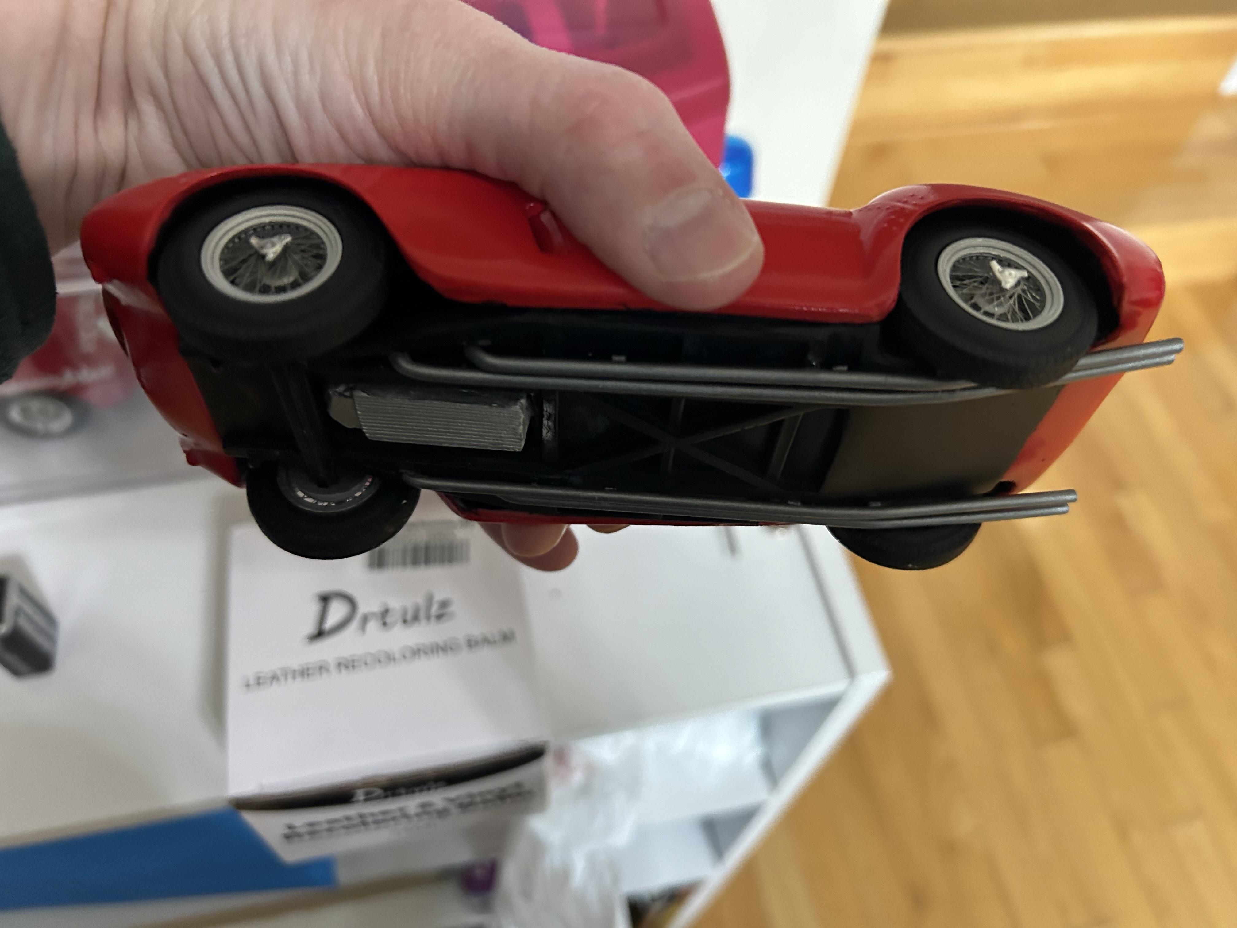

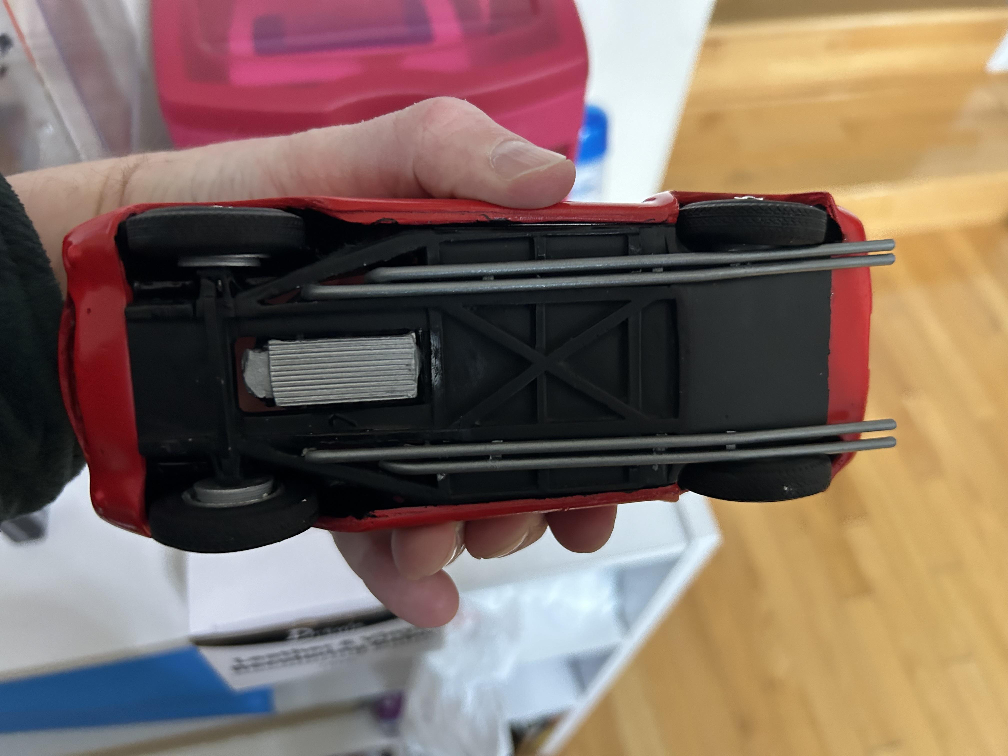

  4. It’s a curbside. The chassis piece has some under engine cast detail

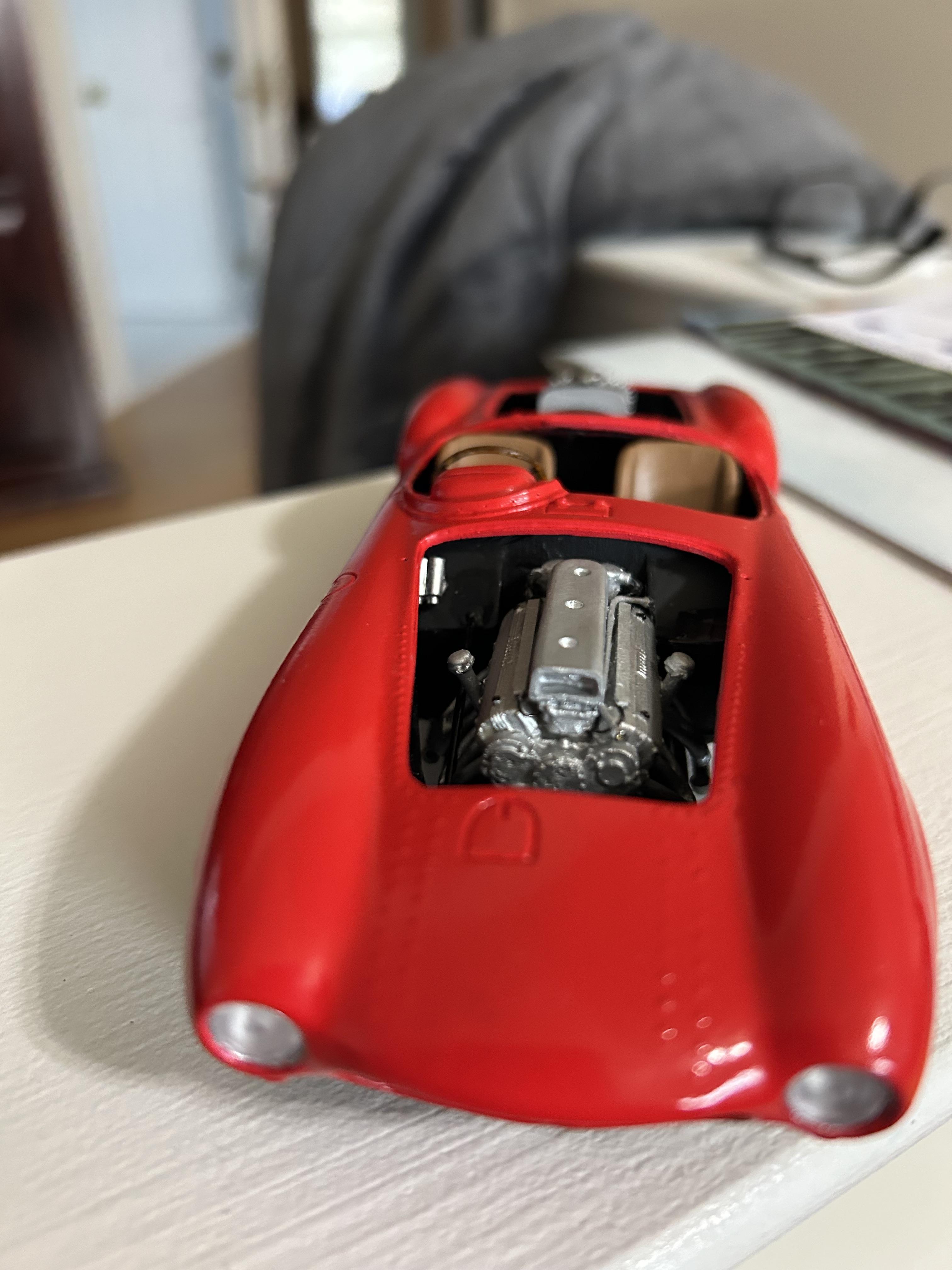

  5. Profil 24 kit very nice resin cast with excellent photoetch including wheels

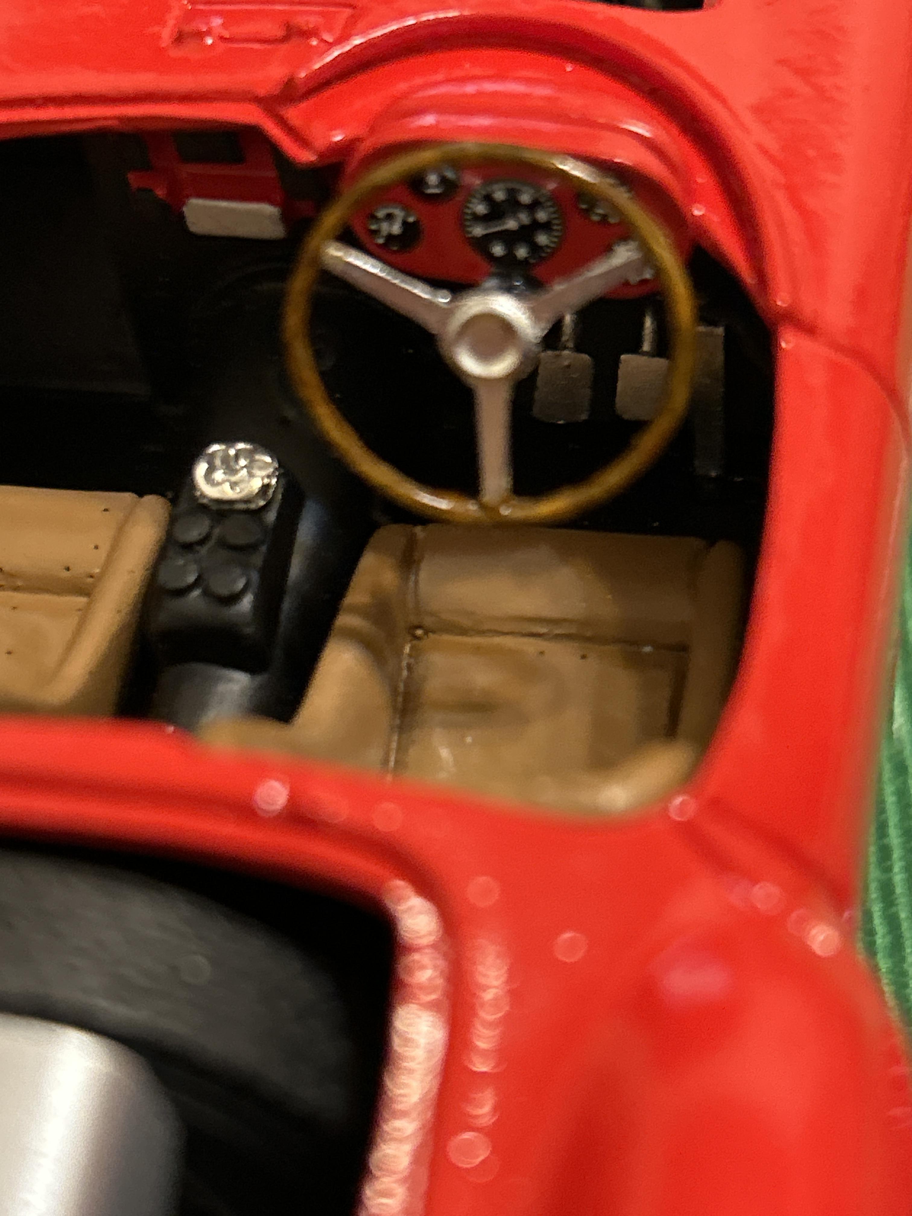

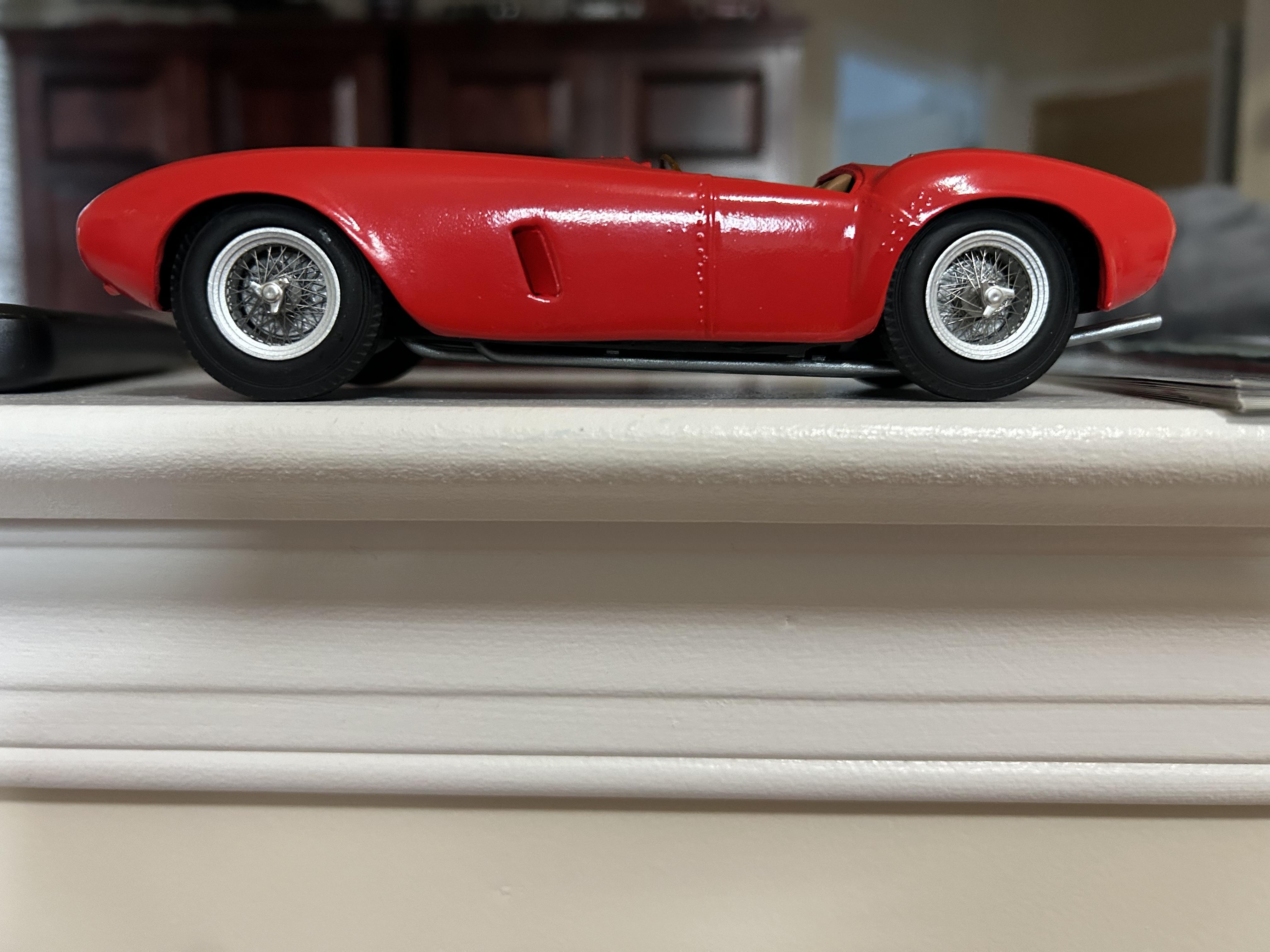

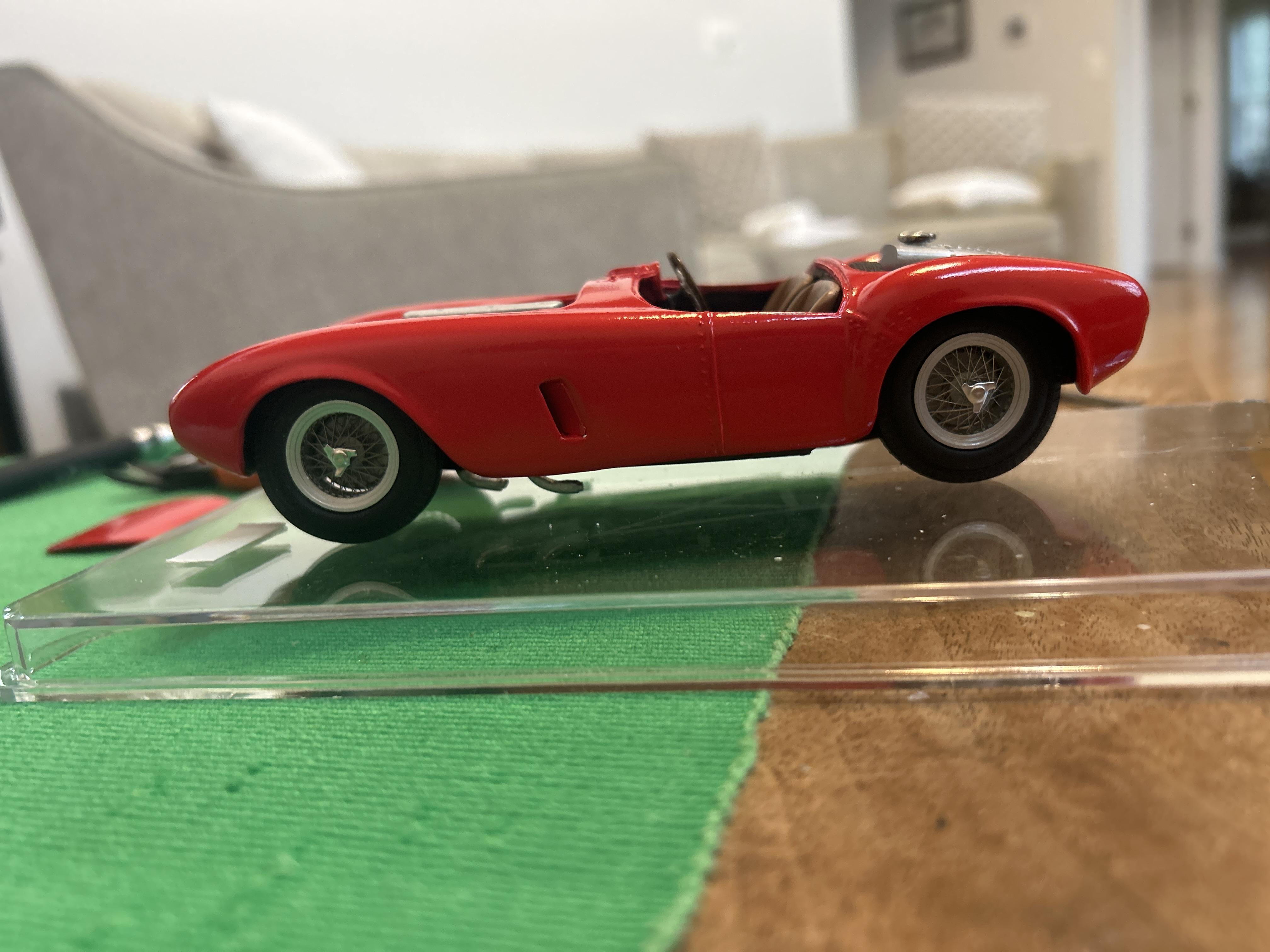

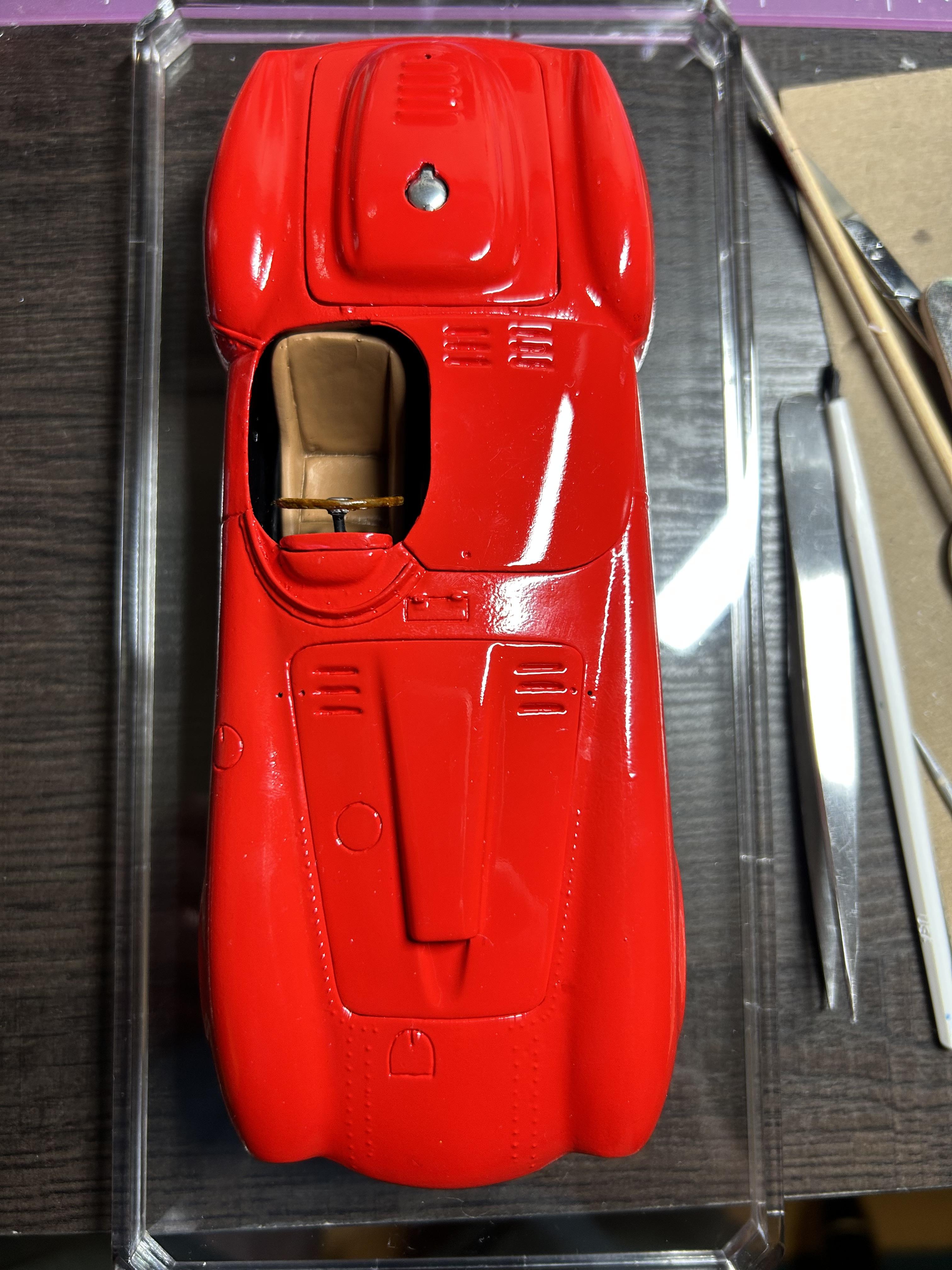

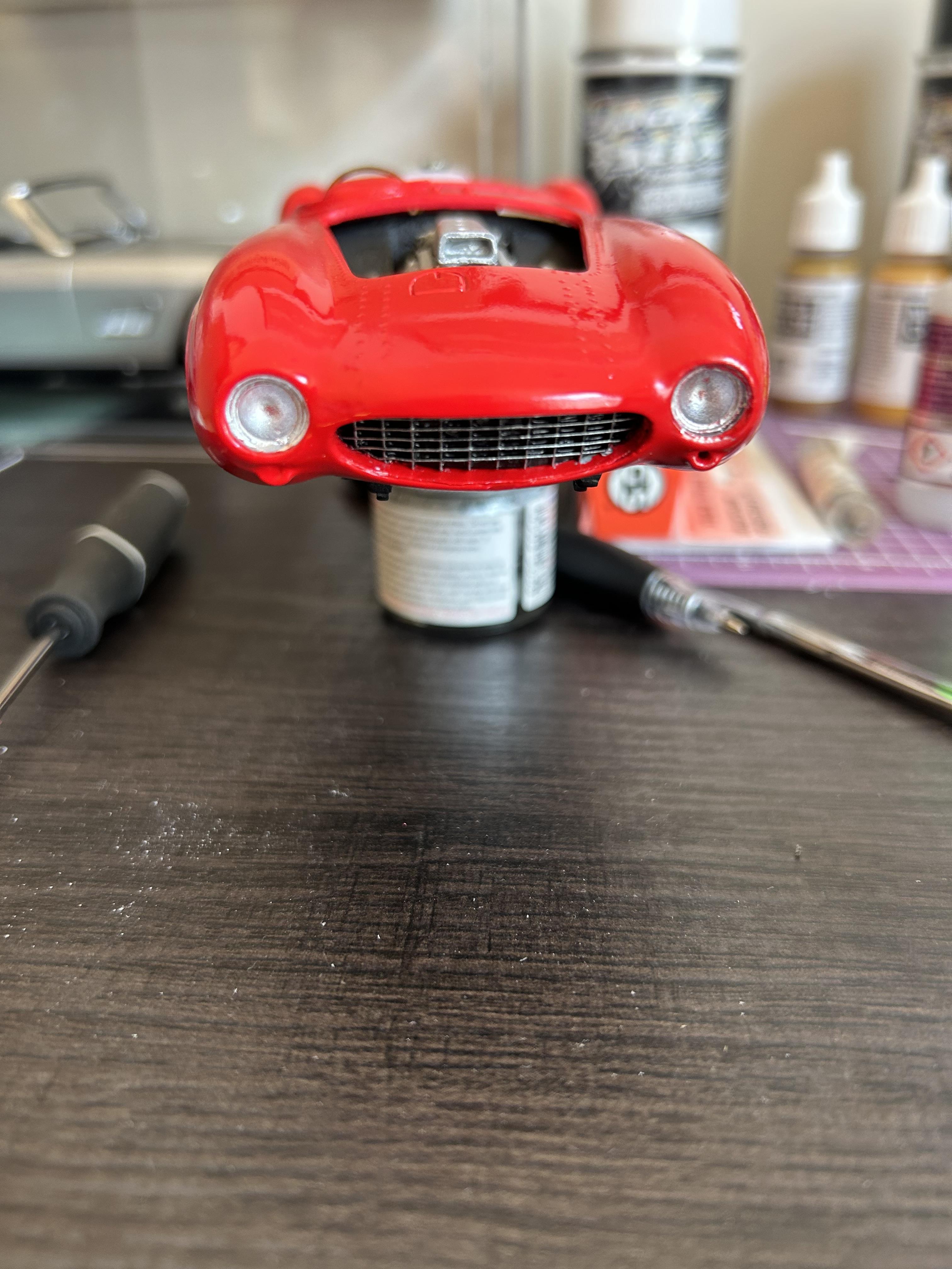

  6. Fernando Pinto 1/24 Ferrari 375 Plus airbrushed tamiya Italian red lacquer over pink primer replaced rivets with Archer decal rivets i did some minimal engine detailing but after a lot of work to get engine and rear deck hoods to fit they are loosely closed with thin double sided tape the window silver molding on the door and passenger cover were not molded in this newer opening version of the kit so I cast copies from the original release that I had in my kit stash all of Fernando Pinto’s kits are very nice

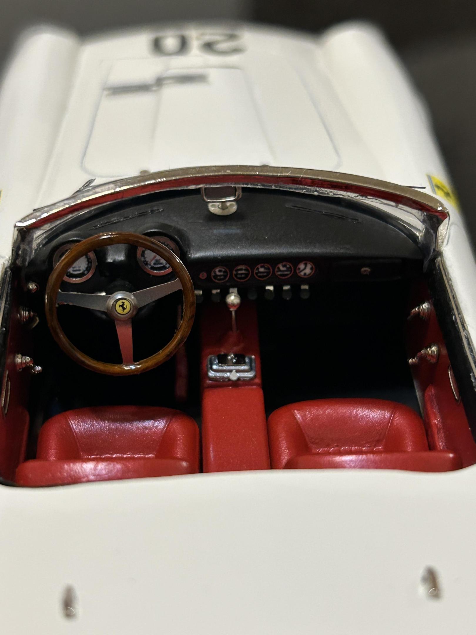

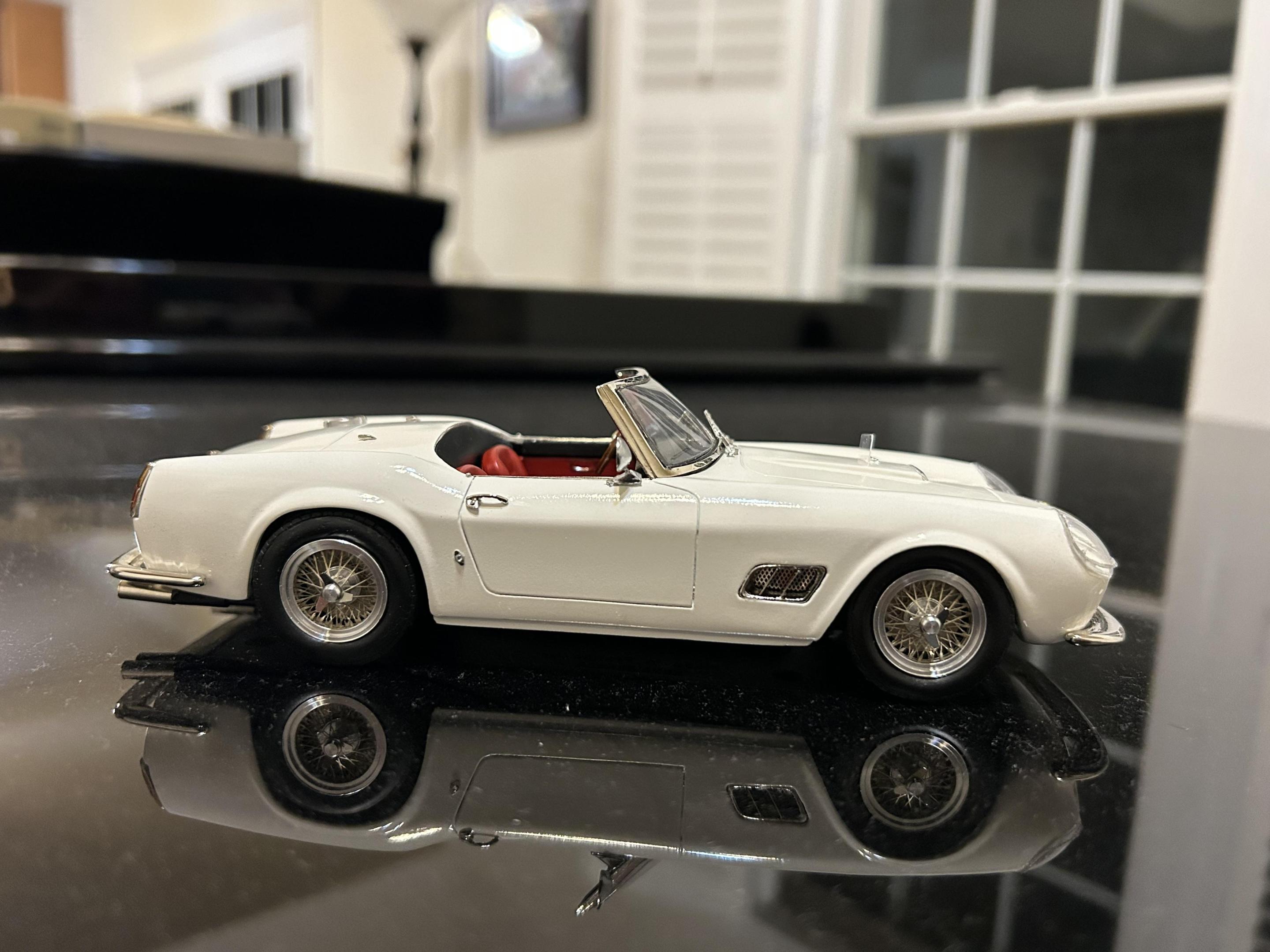

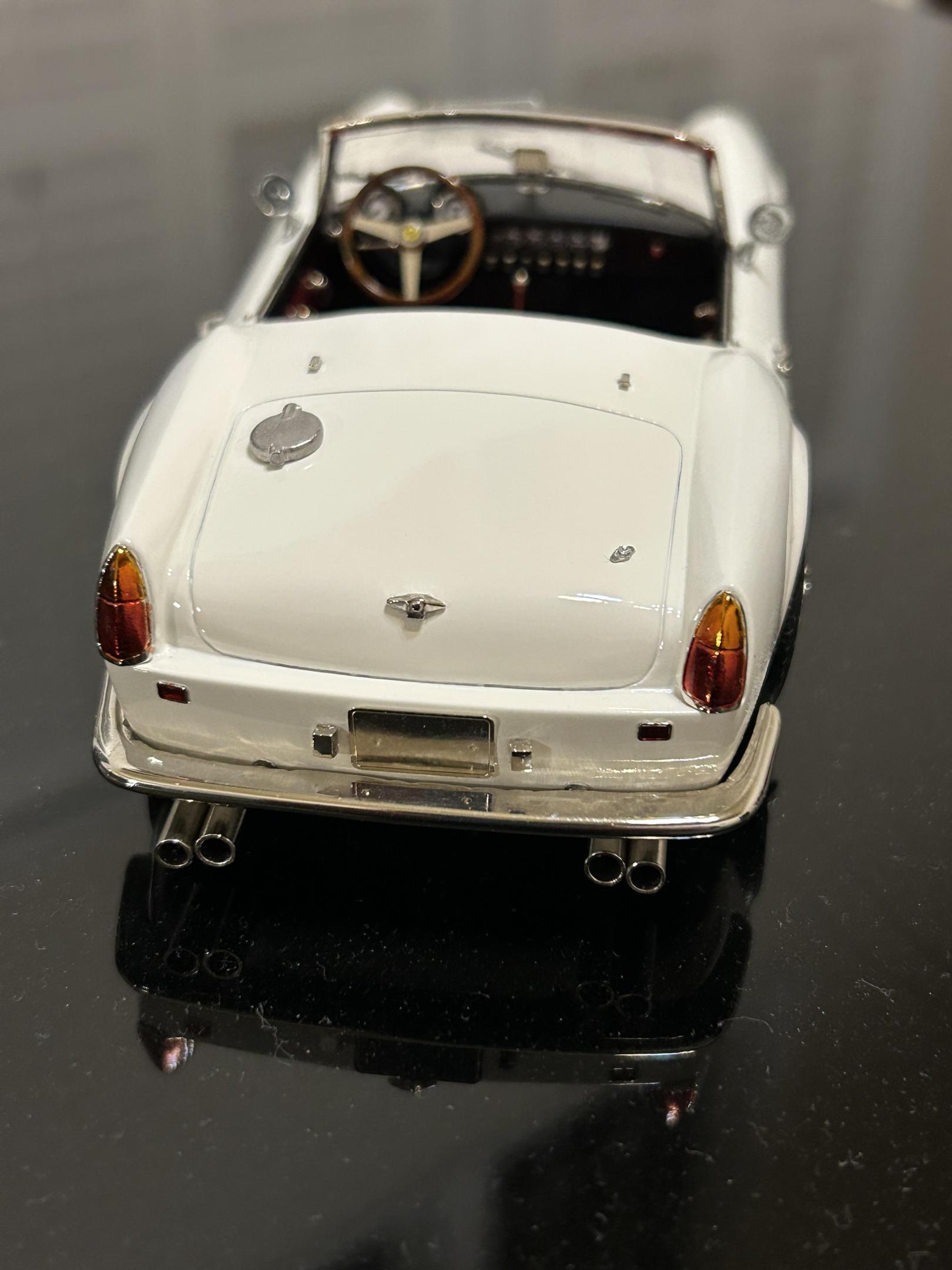

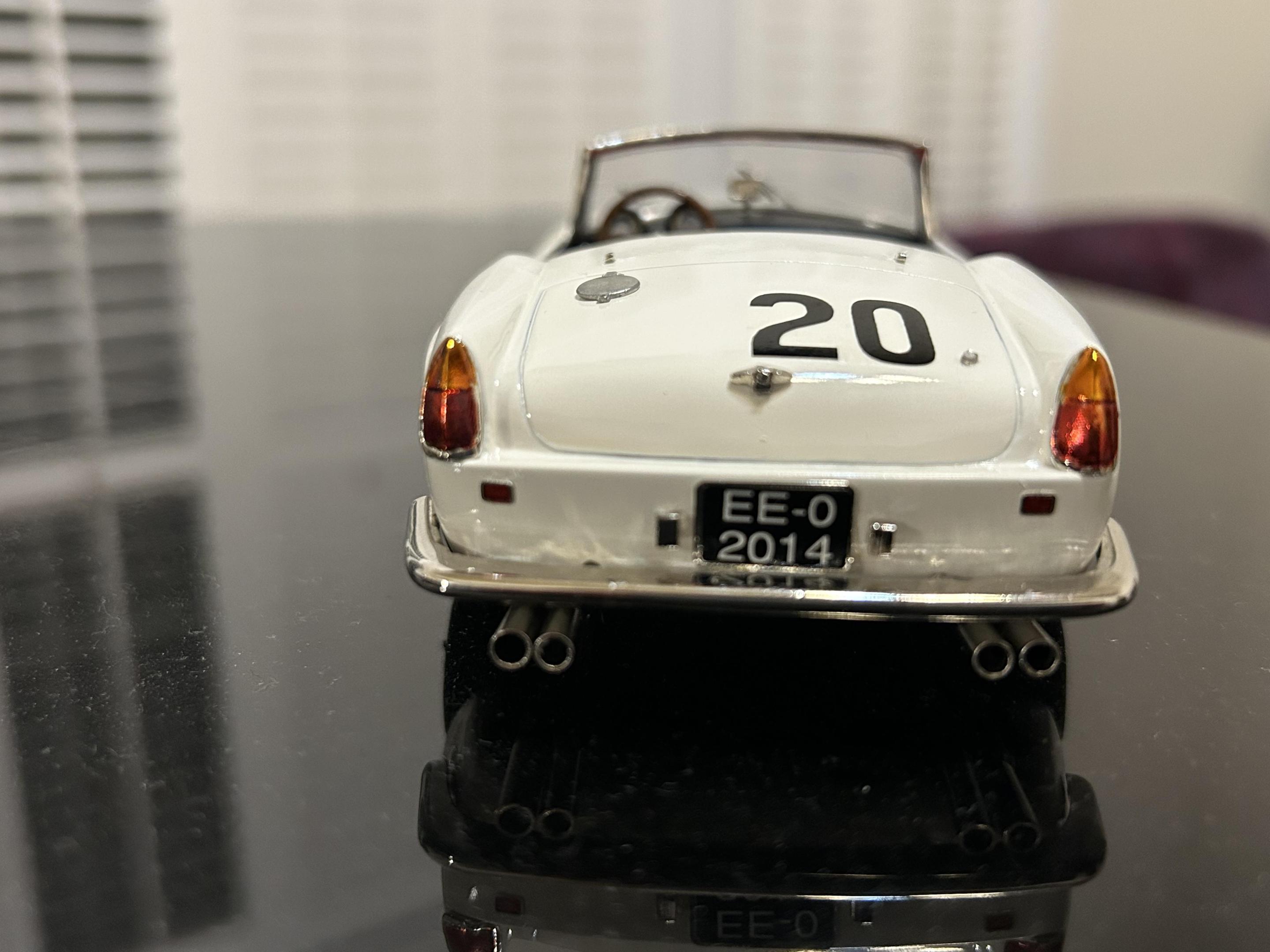

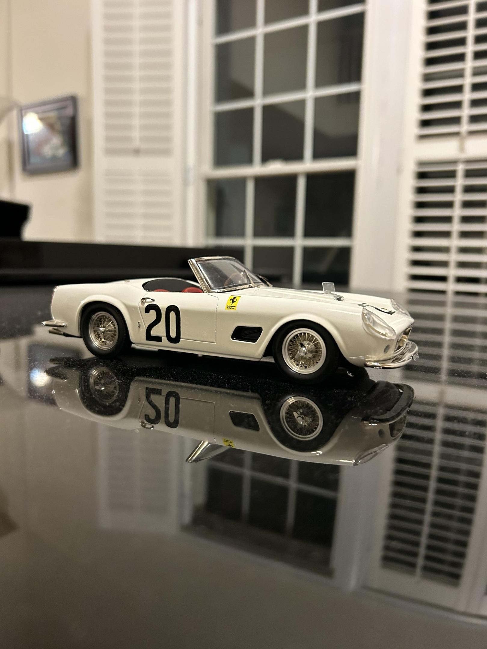

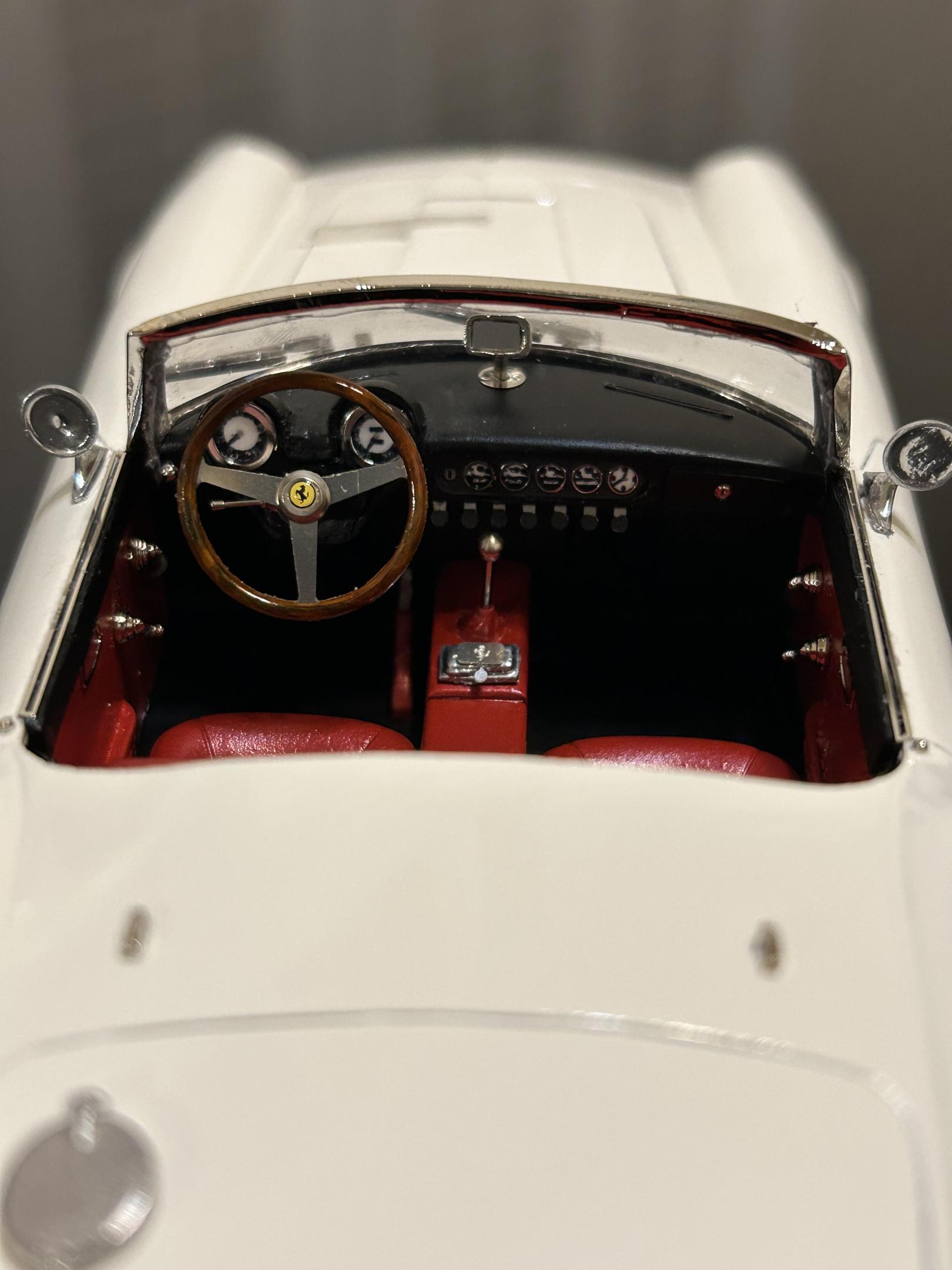

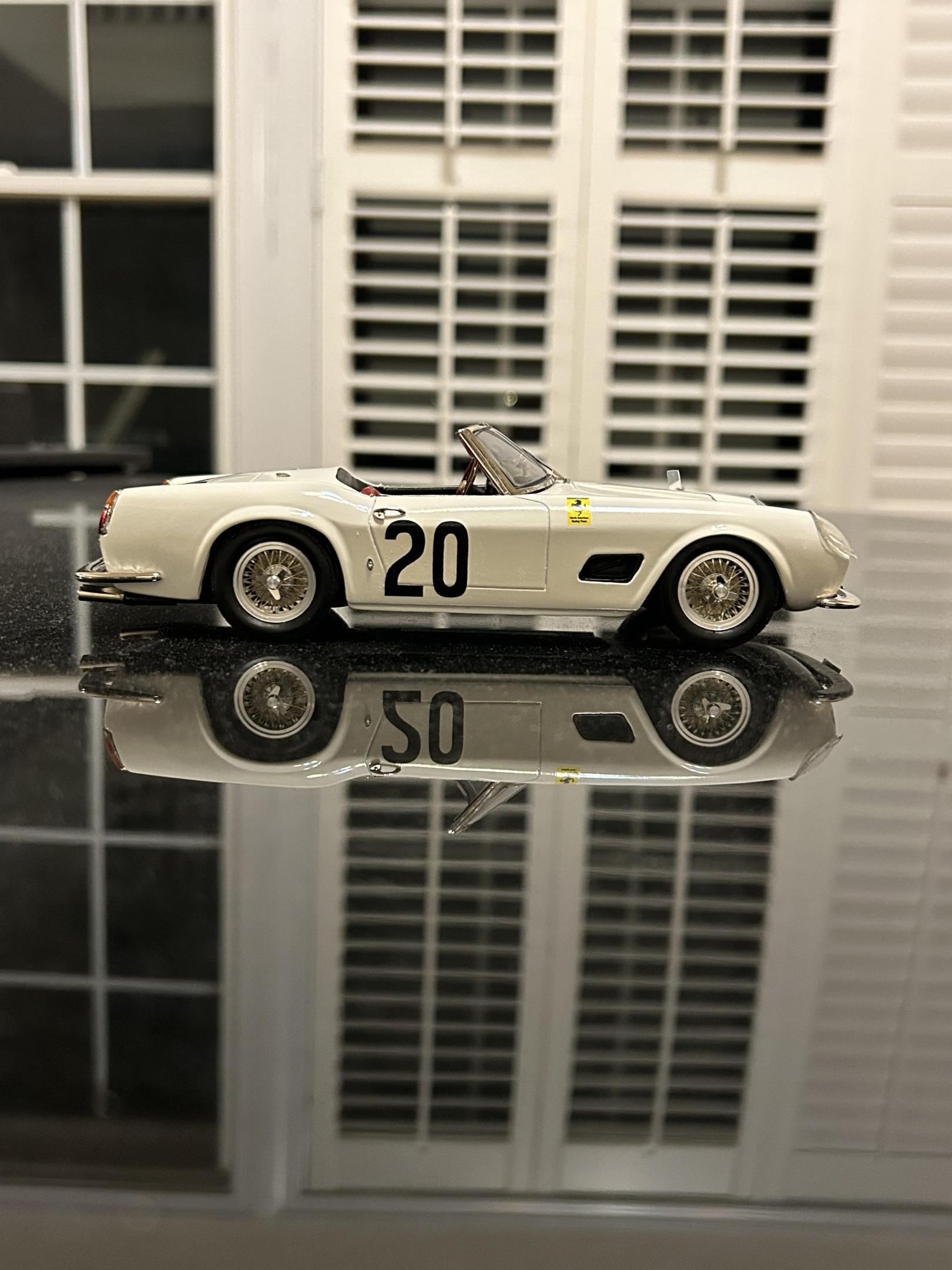

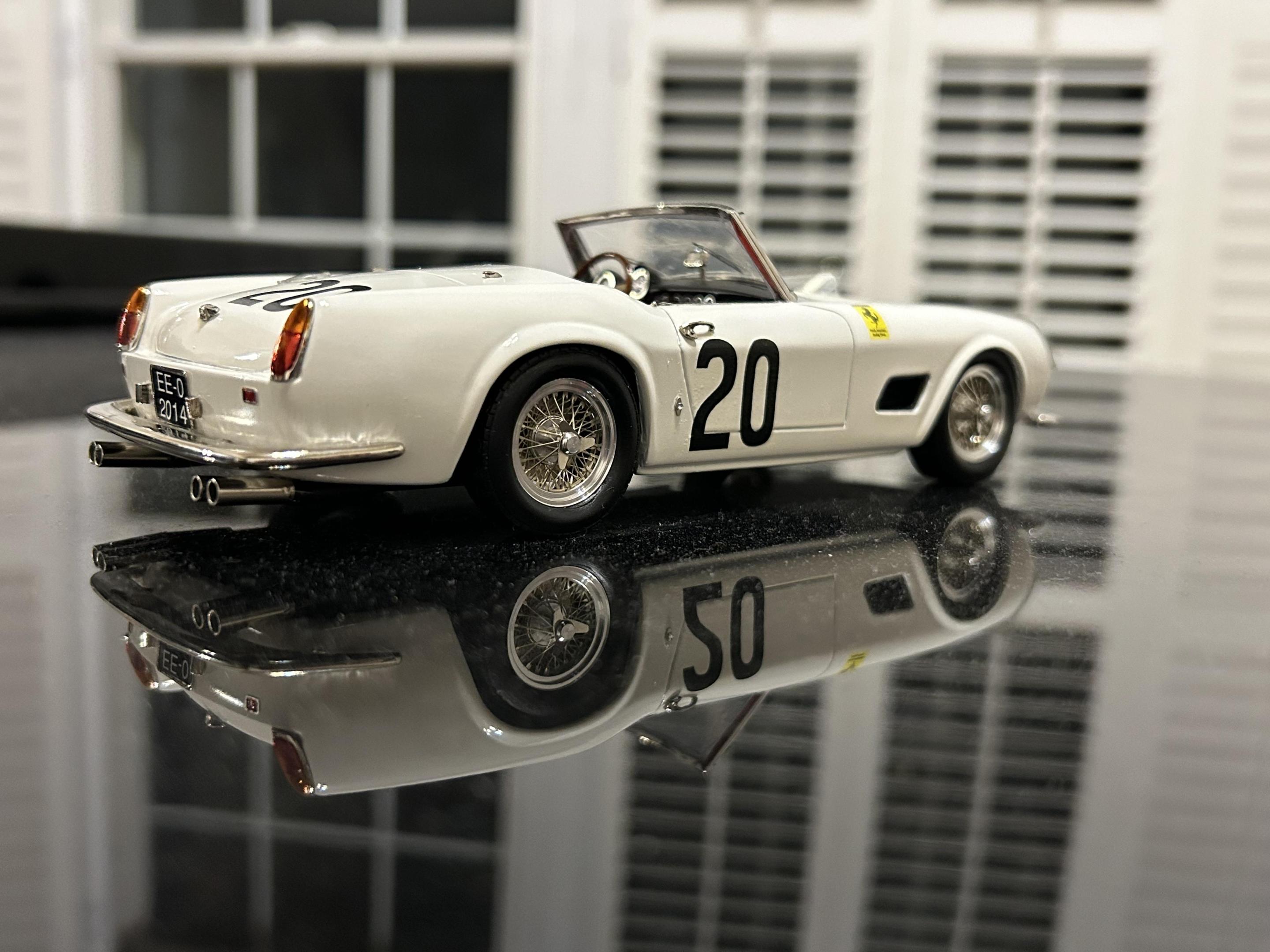

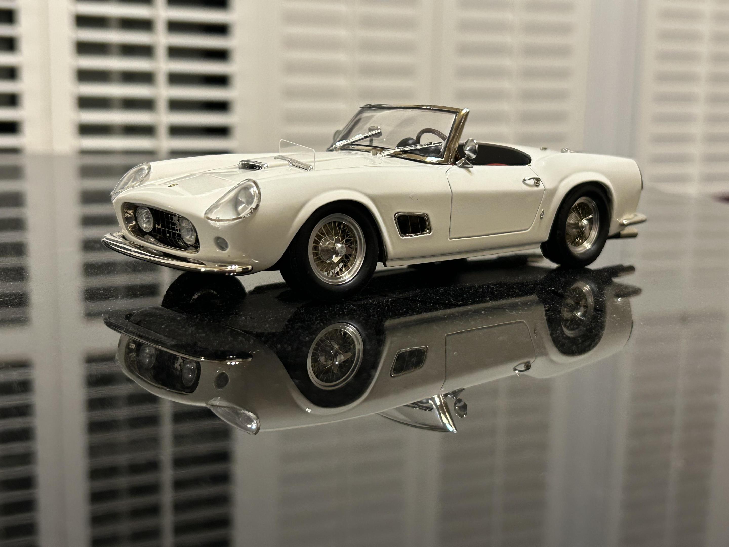

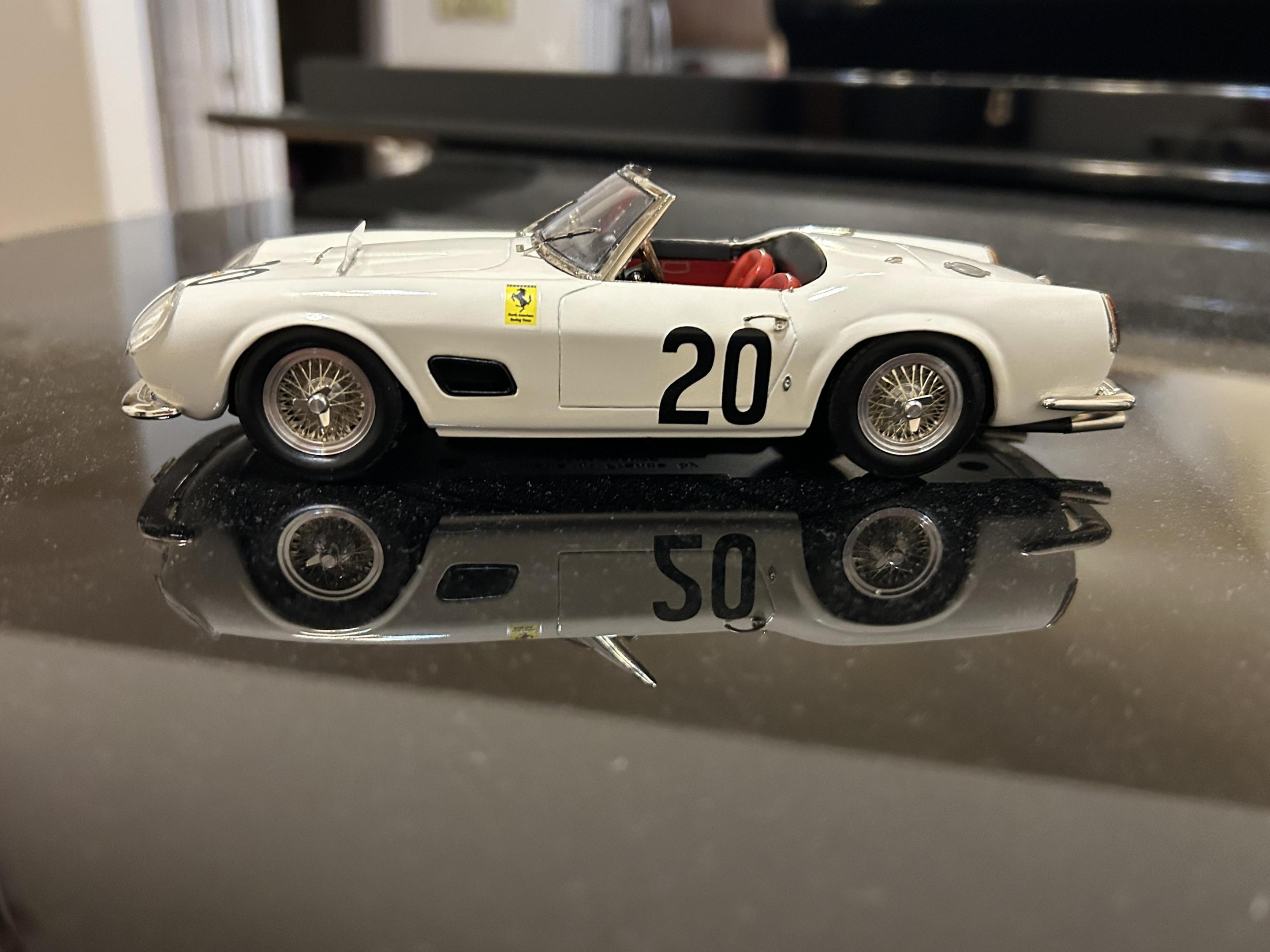

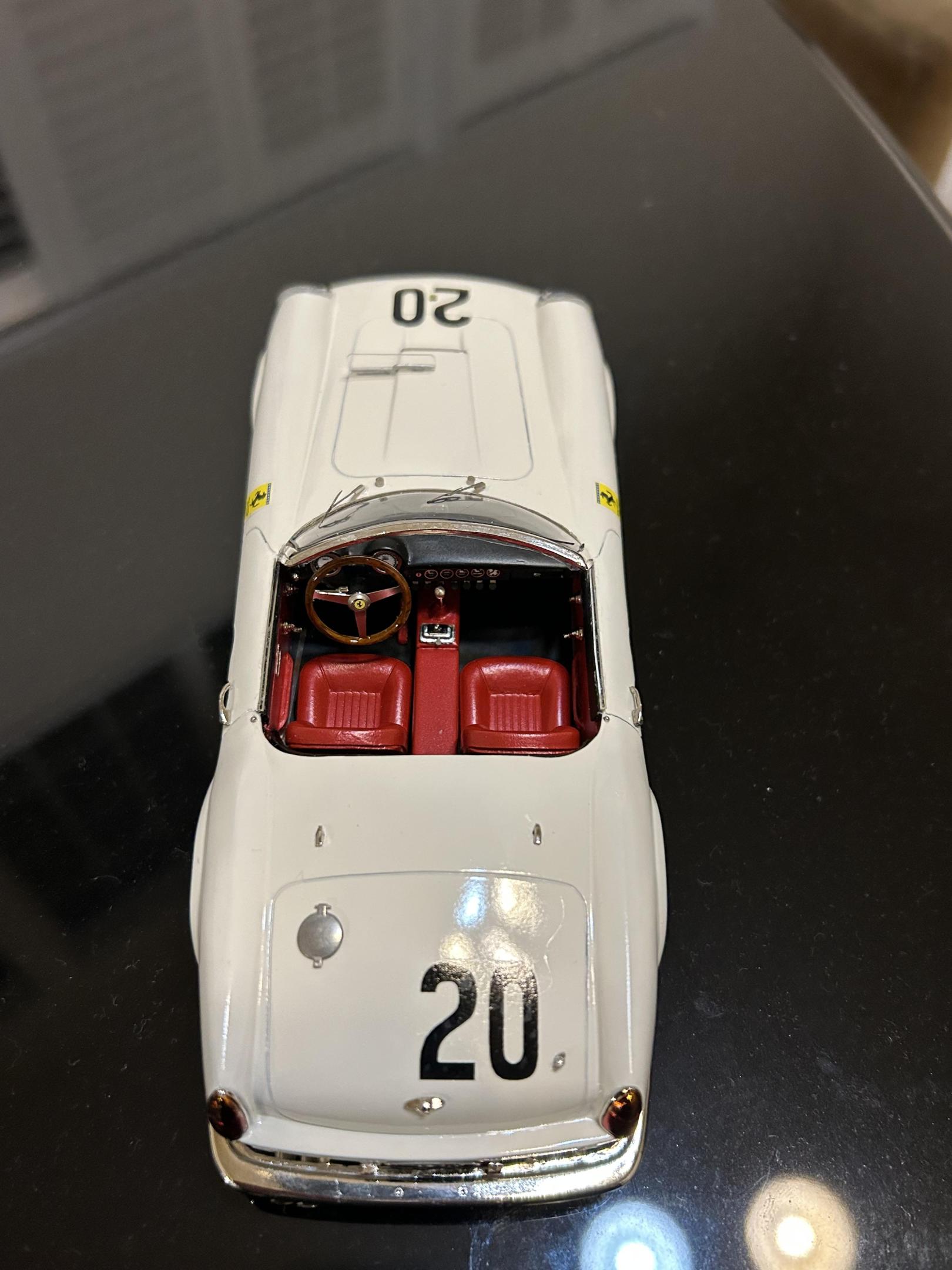

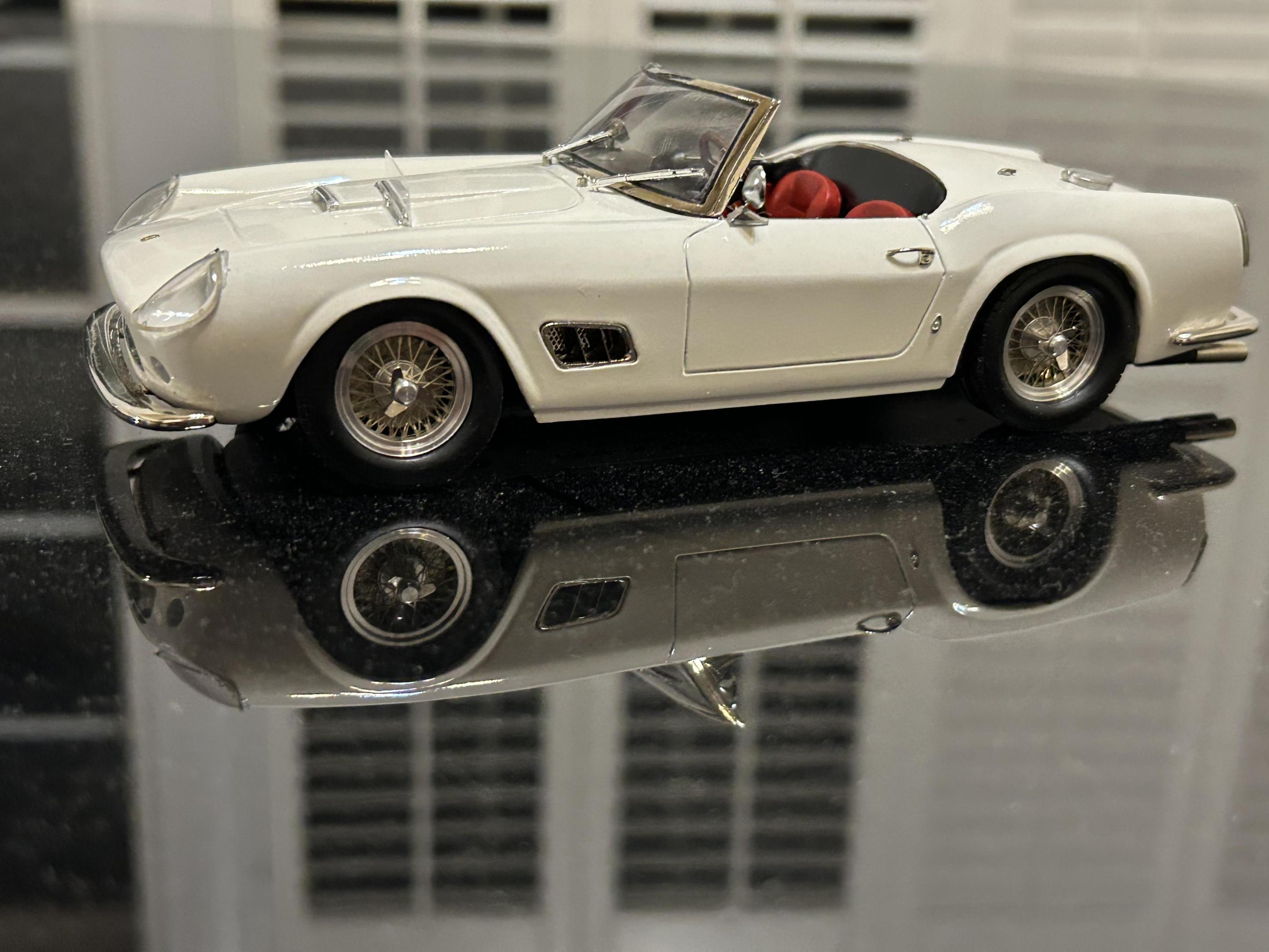

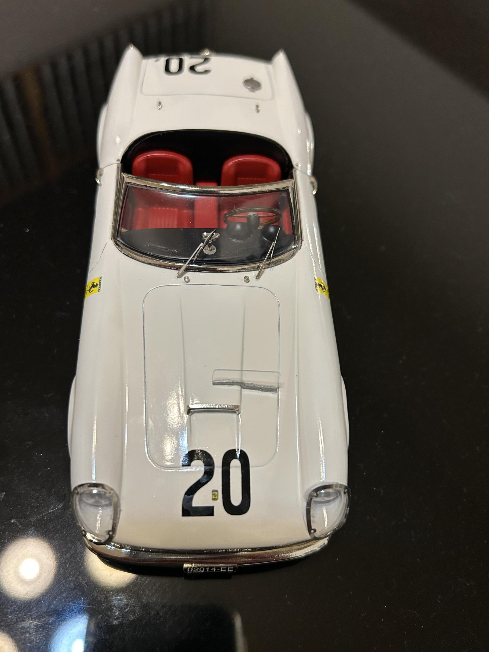

  7. A pair of 1/24 Ferrari 250 gt California built from modified Renaissance kits representing serial number 2015 as raced at Lemans 1960 and restored body color is airbrushed mix of tamiya white and racing white
  8. Adding details

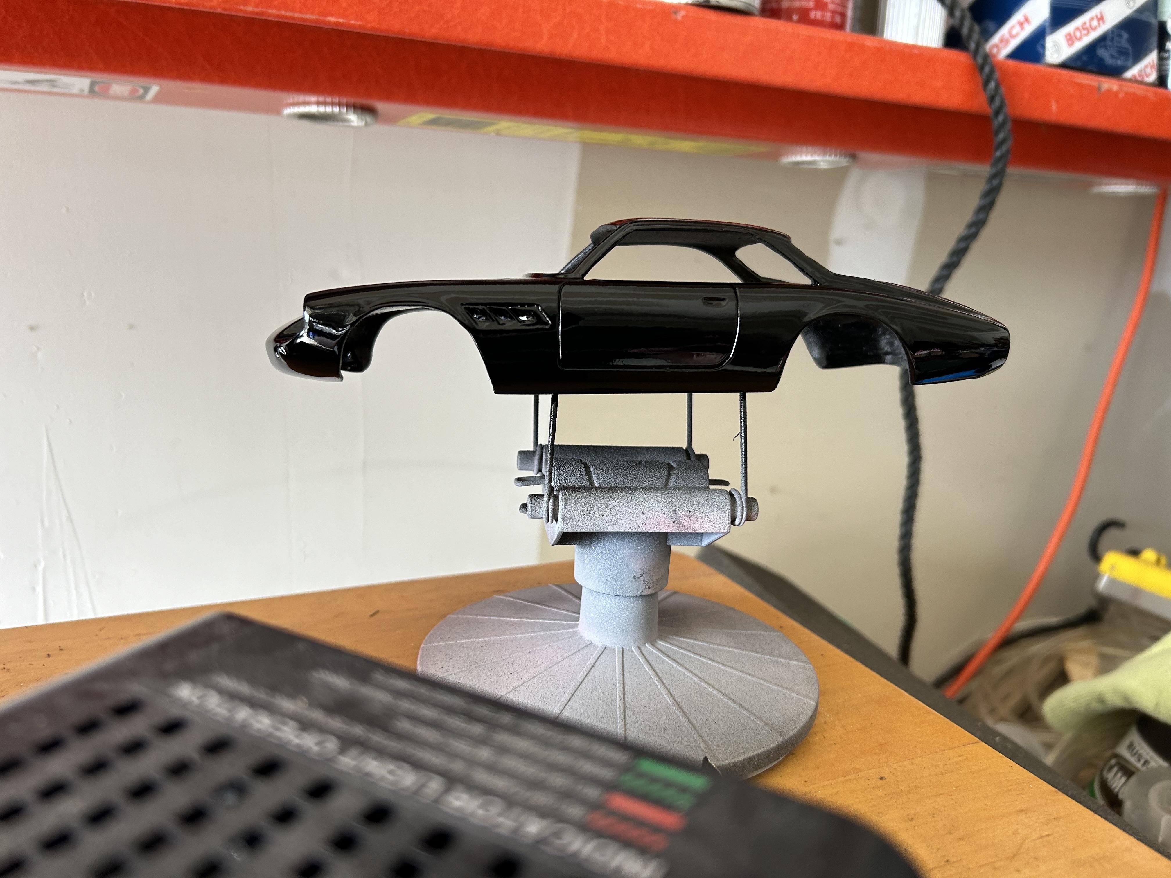

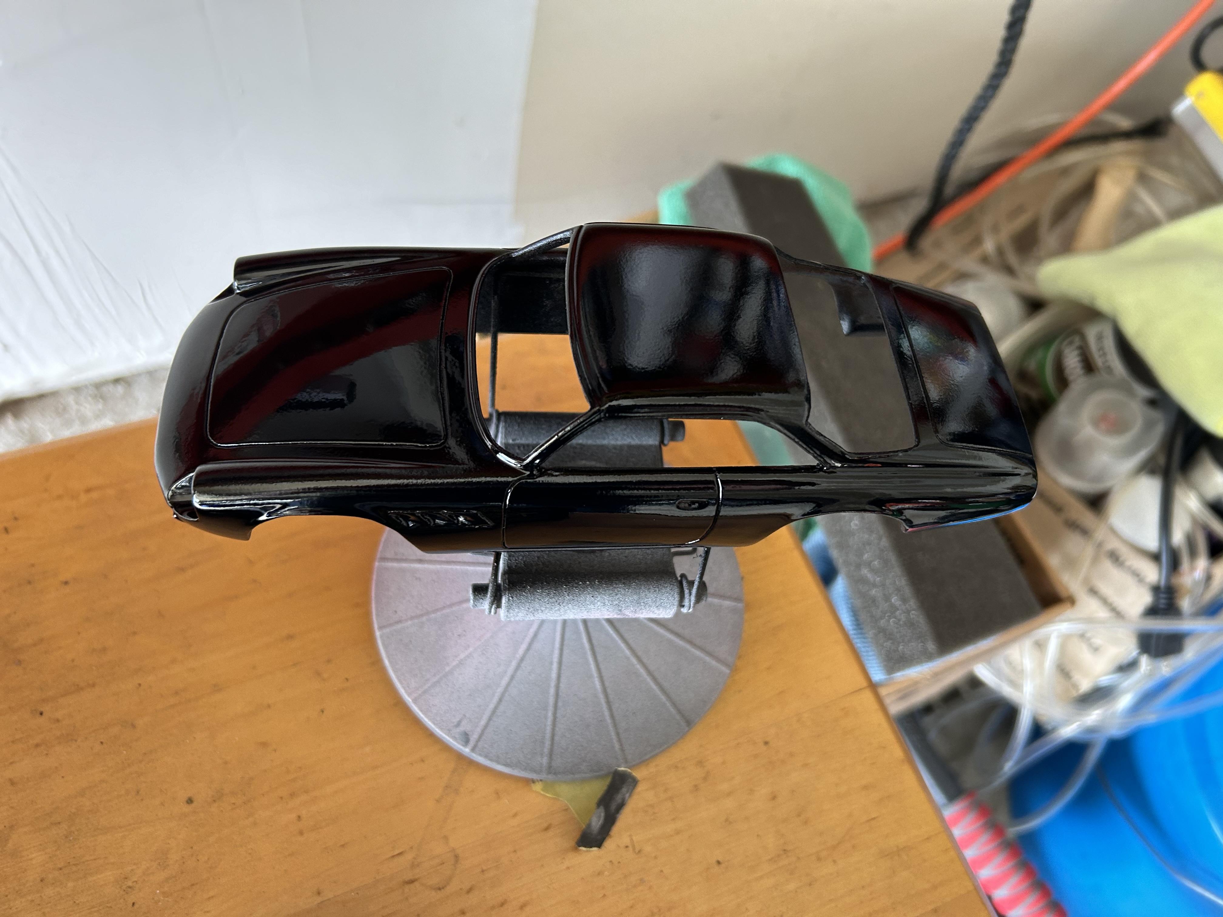

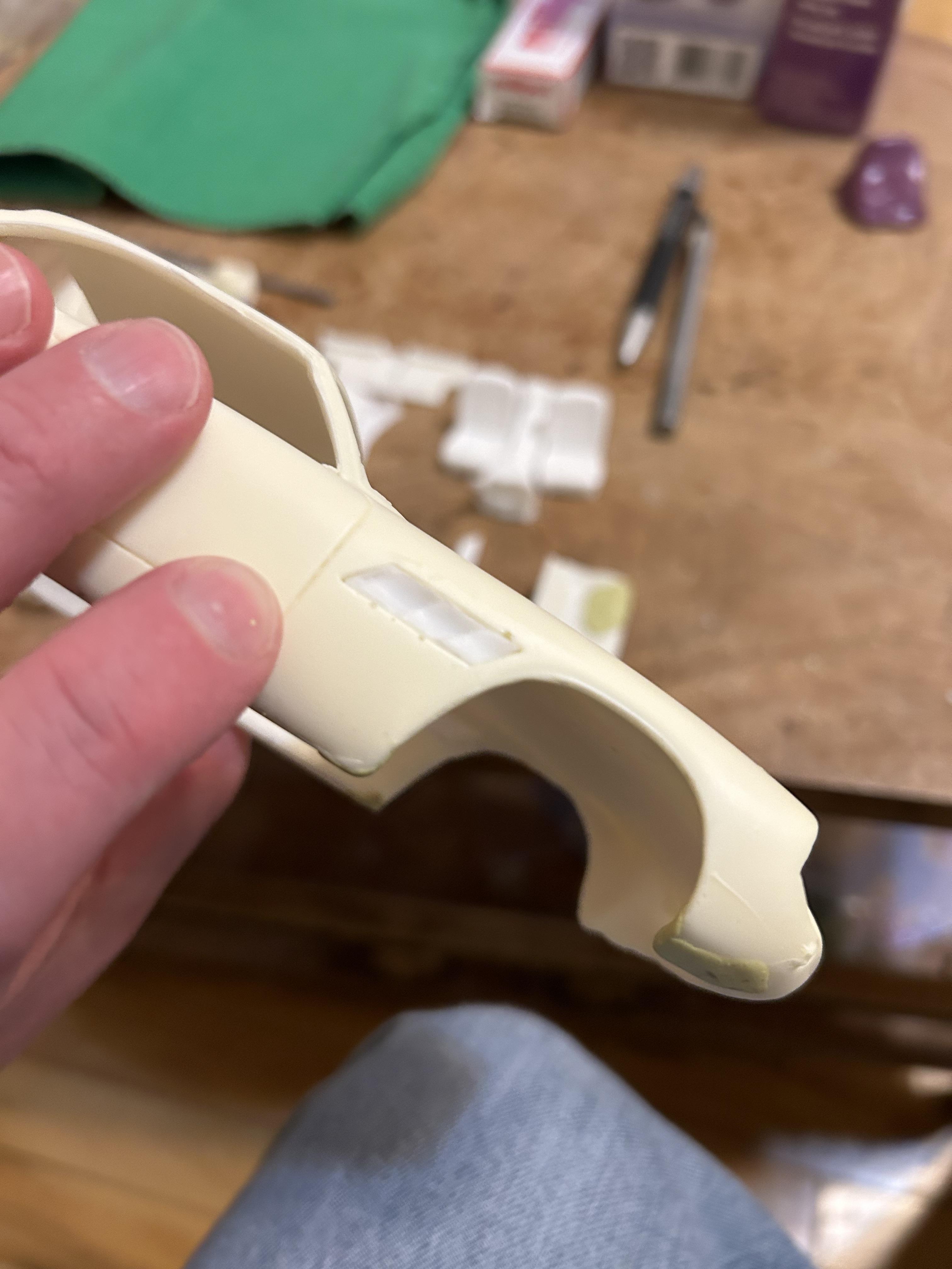

  9. Mocking up a 1/24 Ferrari 330 gts body obtained as a rough copy of what was likely the Airtrax kit. windshield was very distorted so removed. New windshield frame from italeri Ferrari 250 California kit. Side 1/4 windows and front bumpers from italeri Ferrari 275 kit will remove crude rear bumpers and replace with chopped and modified italeri Ferrari 275 rear bumper

  11. Photoetch surrounds in place
  12. I was lucky a few years ago to come across on eBay someone getting rid of several of the photoetch sheets for the 1/24 tecnomodel Ferrari 250 swb kits which had the metal bug guard as one of the parts. Bought them with this car in mind. for the Renaissance version one of their body shells come with the part molded…

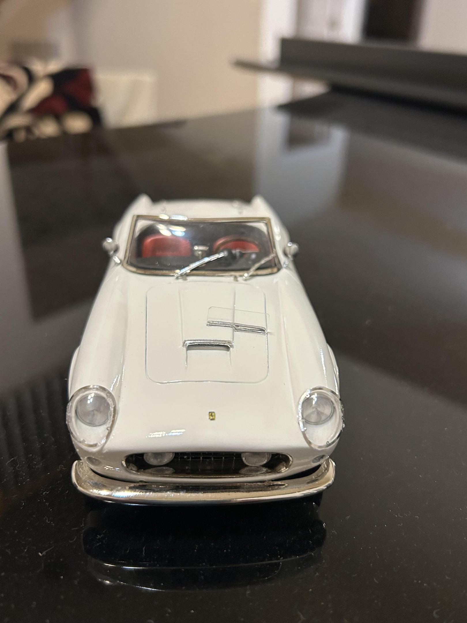

  16. I use the photoetch surrounds meant for the fujimi Ferrari 250 gto (aftermarket set can find on eBay or sometimes directly from one of the Australian hobby shop websites) the vac formed clear parts are copies I made from the Renaissance kit. (Made polymer clay molds and then vacuum formed myself). More recently renaissance was kind enough to let me order extra vacuum formed clear parts to save me from wasting a lot of clear plastic making my own…
  17. Almost finished need to add front bumper which is being resprayed. Door mirrors, wipers, and will change out headlight covers for vacuum form and photoetch surrounds
  18. Thank you 50:50 mix of tamiya laquer white and racing white airbrushed

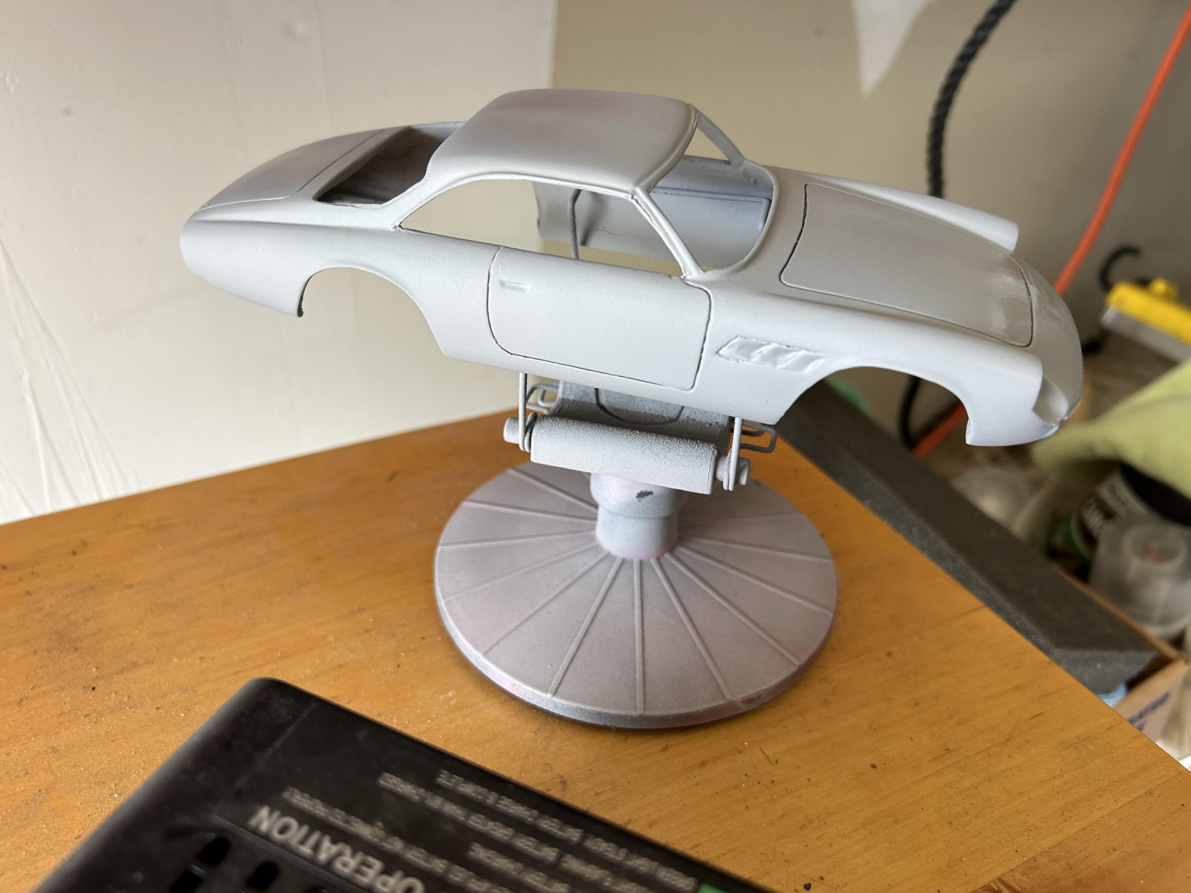

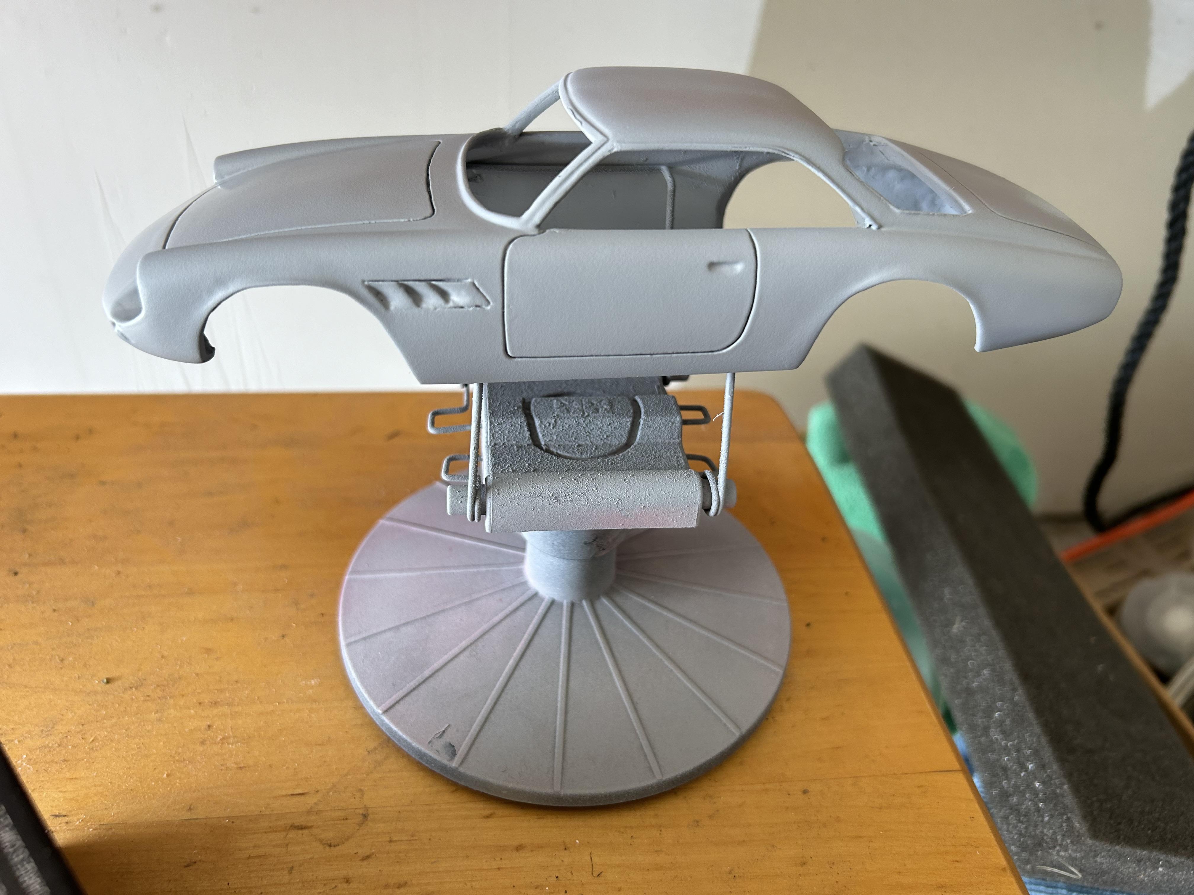

  21. Mock up of body a couple of Renaissance bodies in progress below
