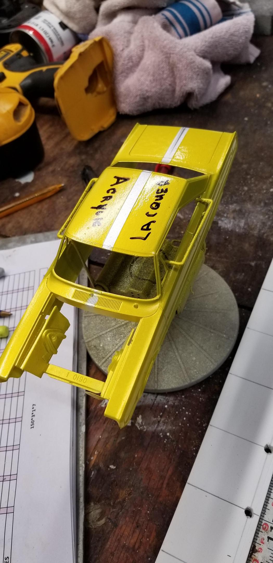

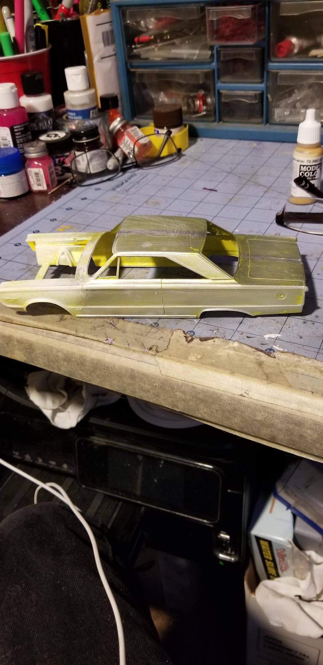

  3. Ok. the body spent the night in the purple pond. Acrylic clear came off all the way to the base coat, real easy. The lacquer clear coat was harder to get off but a small wire brush convinced it. Funny, the Lacquer silver base coat stayed on. Conclusion? The base coat was on a couple of days before I painted the yellow. The lacquer base coat had a couple of days to "dry", "set" or "gas out" , whatever. ALSO , the silver base coat made the iridescent seem to have a "blue" tint to it. Left the front white. Seems the yellow was a better shade of yellow in the front. Take notes, put in book for future reference
  4. Well , the Lacquer clear over the acrylic paint seems to do alright. No bad reactions to it. Of course the acrylic clear over the acrylic paint did fine. The lacquer clear seems to have more shine. Didn't try sanding and buffing, which I should've done. too late now it's in the "purple pond" Rats!

  11. Also, piture does not do the color justice. You should see it in sunlight. Just amazing
  12. Going with that on the body with a pearl white top. All Createx

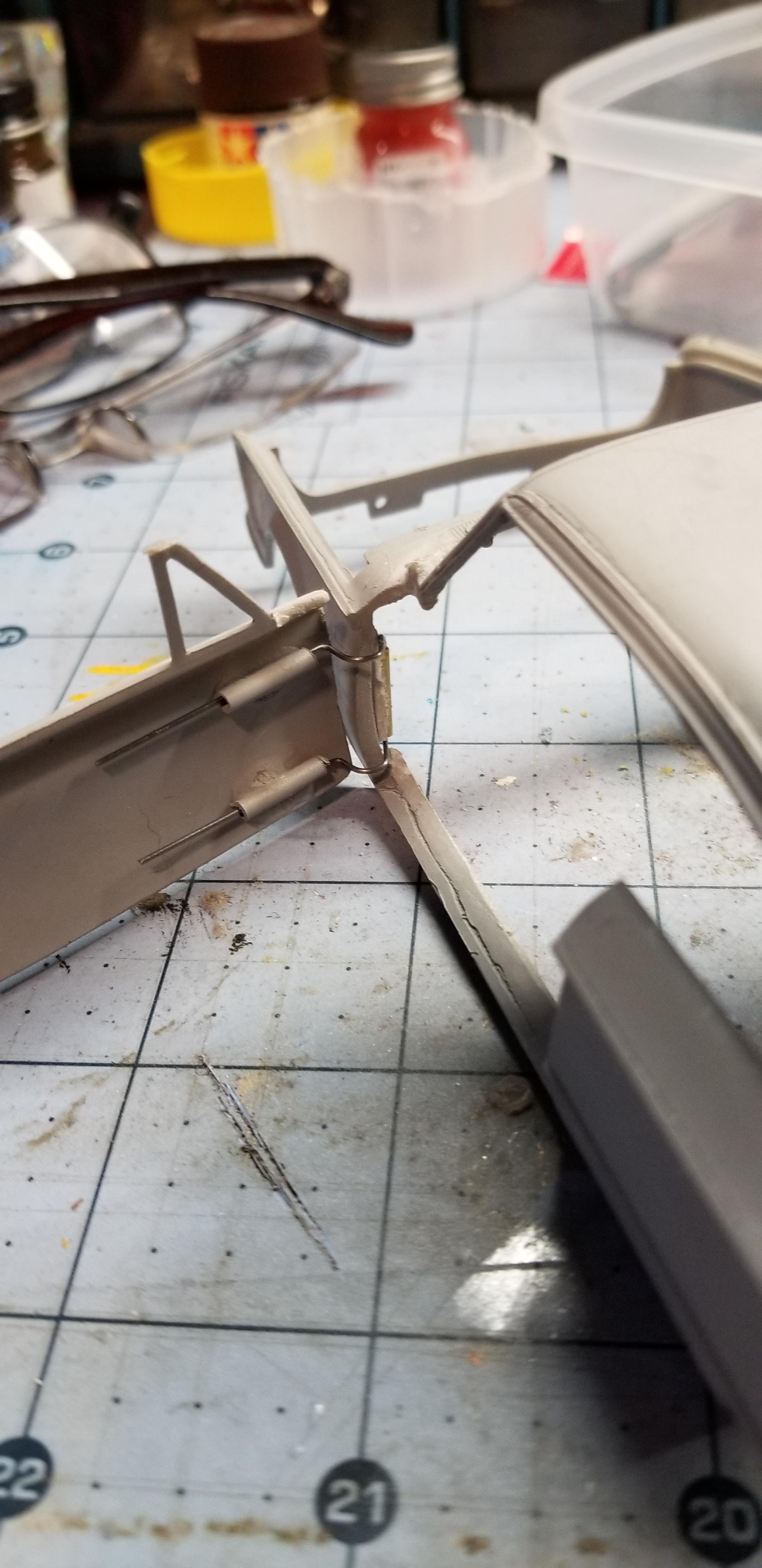

  18. Yup! Broke one of them. Seems to be a problem , that and the rocker panels so now I re-enforced them right at the start

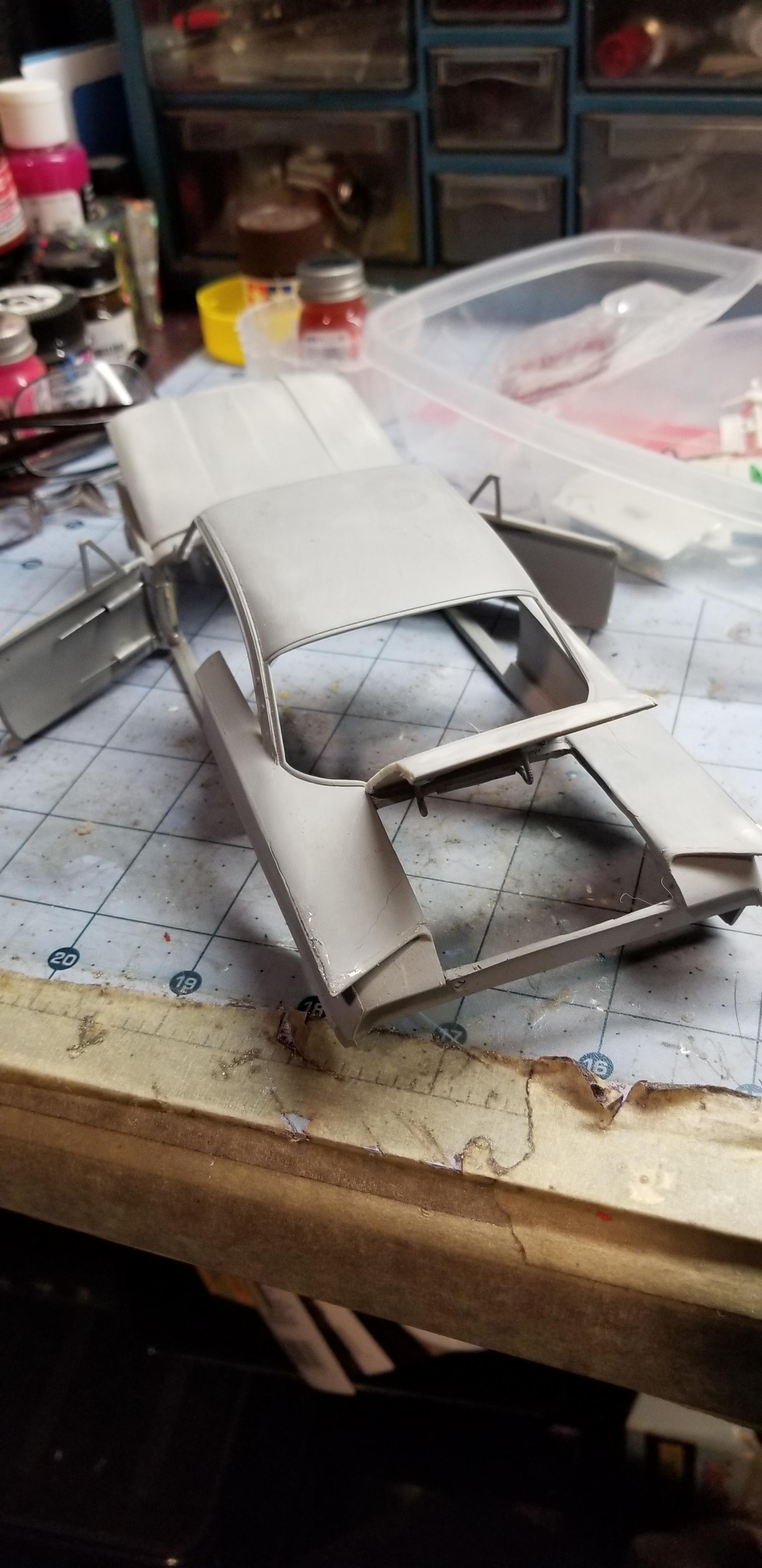

  20. Now to move ahead on this one!
  21. On the model
  22. New set of hinges
  23. That to re-do the hinges on the doors. Now using smaller wire and brass tubing
