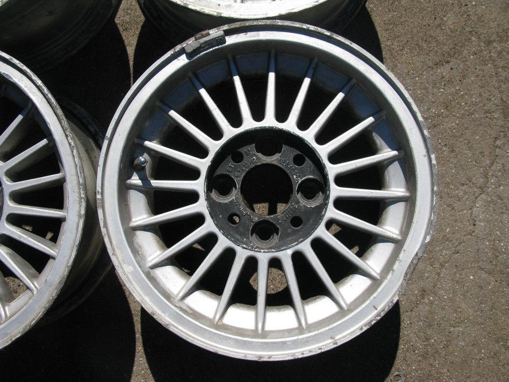

  7. I didn't like the wheels in this kit. That spoked wheel wasn't the one in 1977, It was the one pictured. The kit called for silver on the wheels and I just did that. I might try a matte silver or maybe a wash? I have another unbuilt kit. So someday I might revisit this. I bet someone makes a photo etched wheel that looks like the one pictured. Thanks for the ideas. Dave

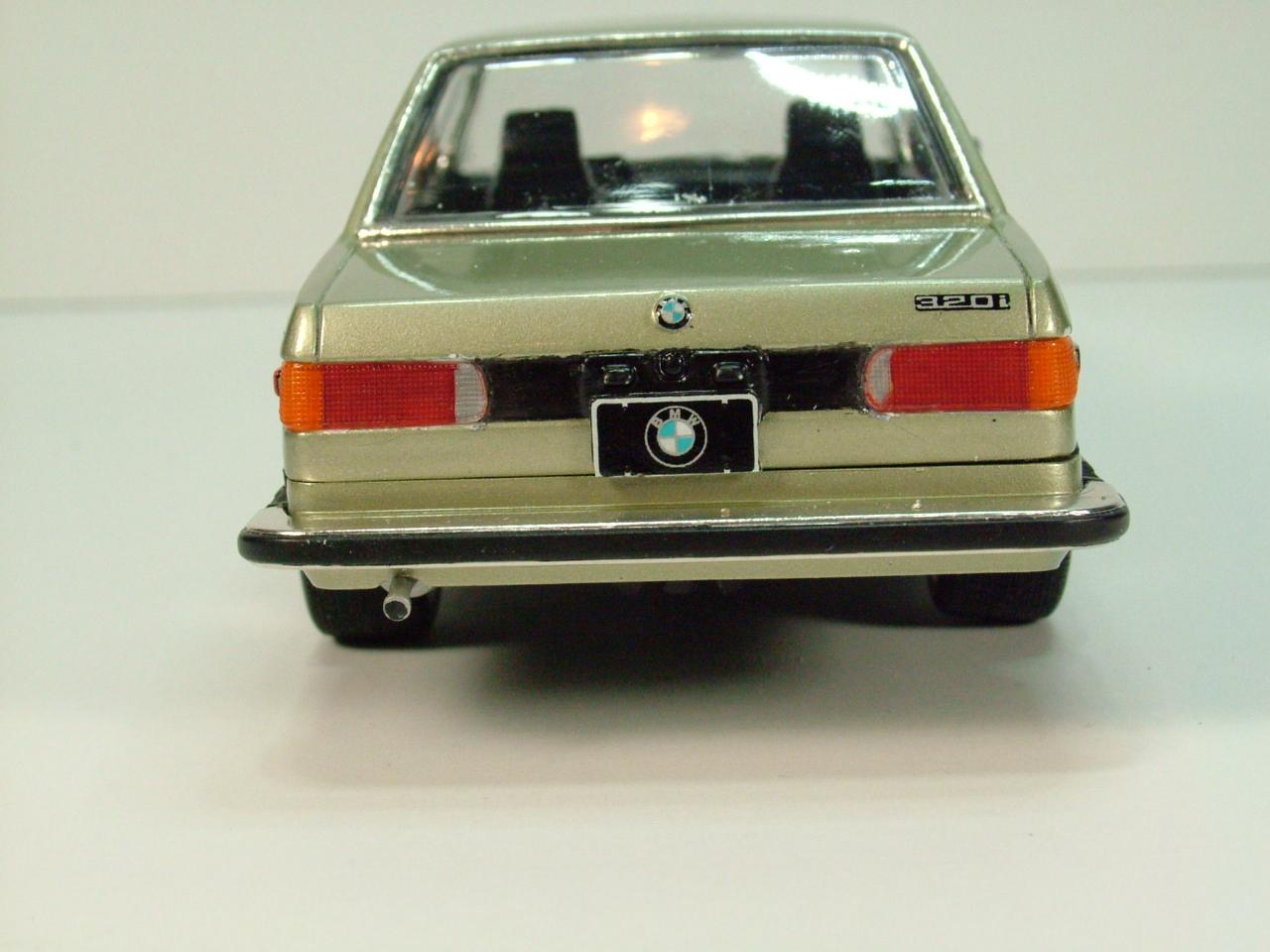

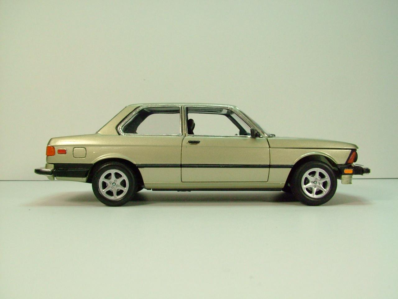

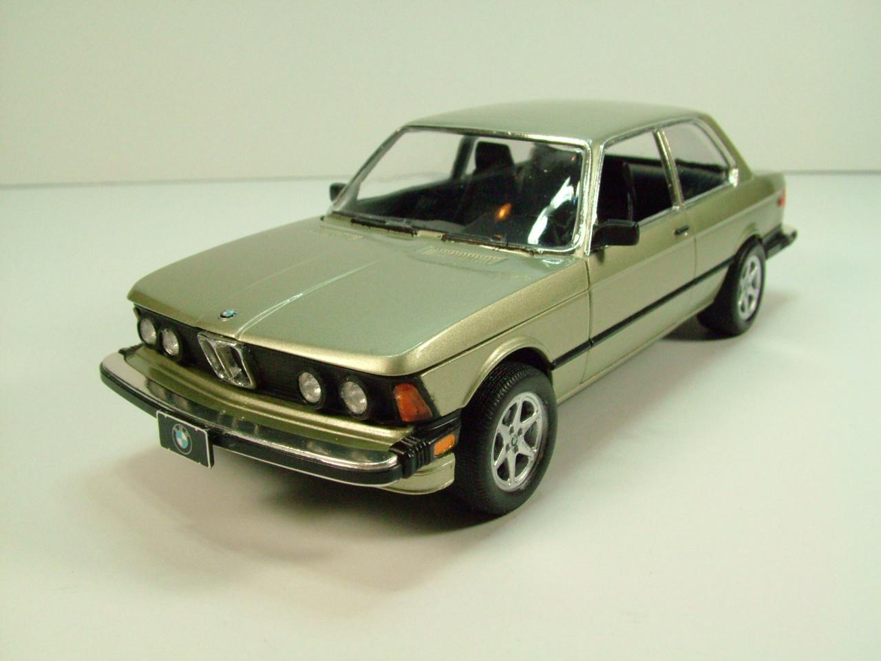

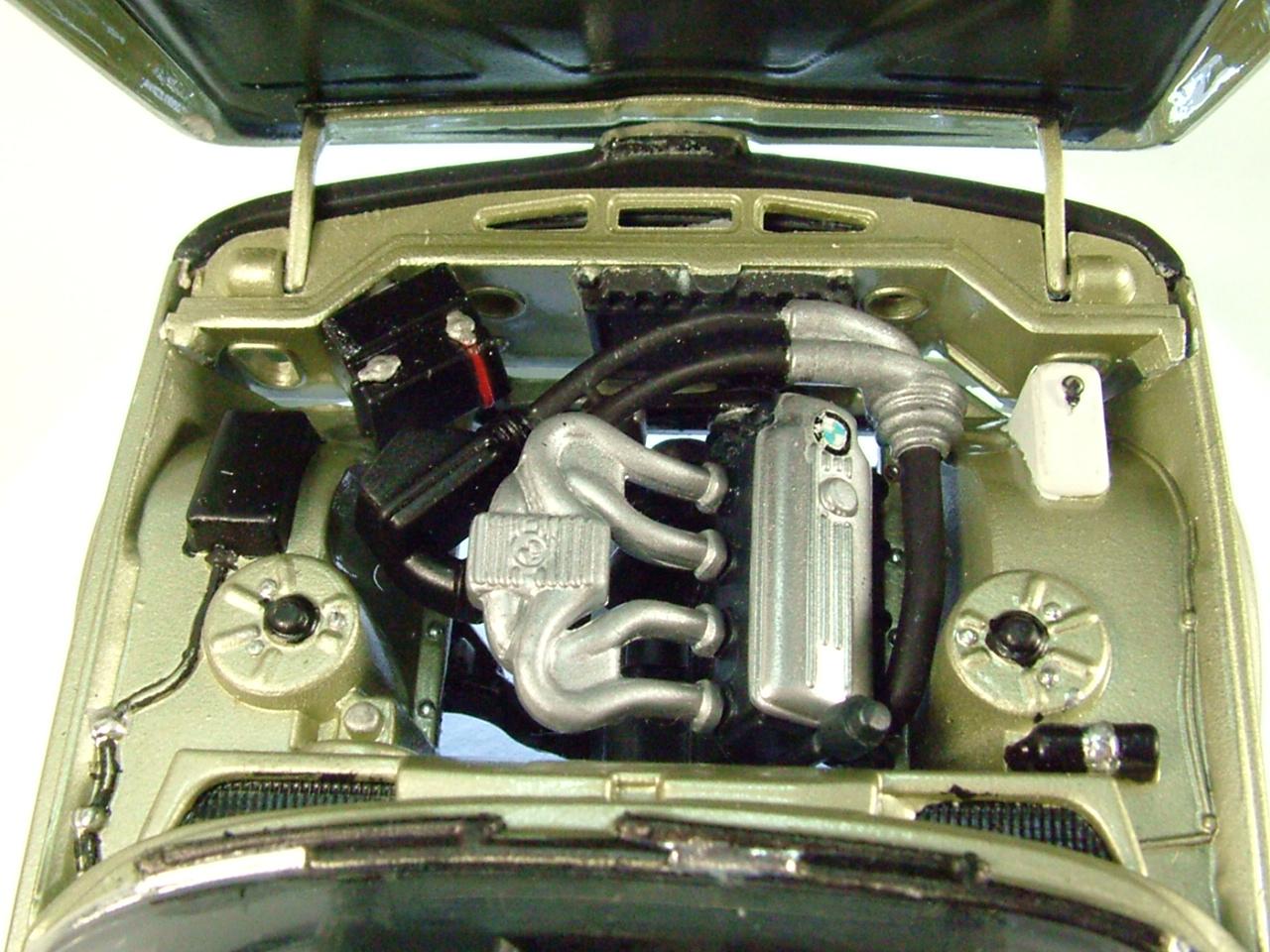

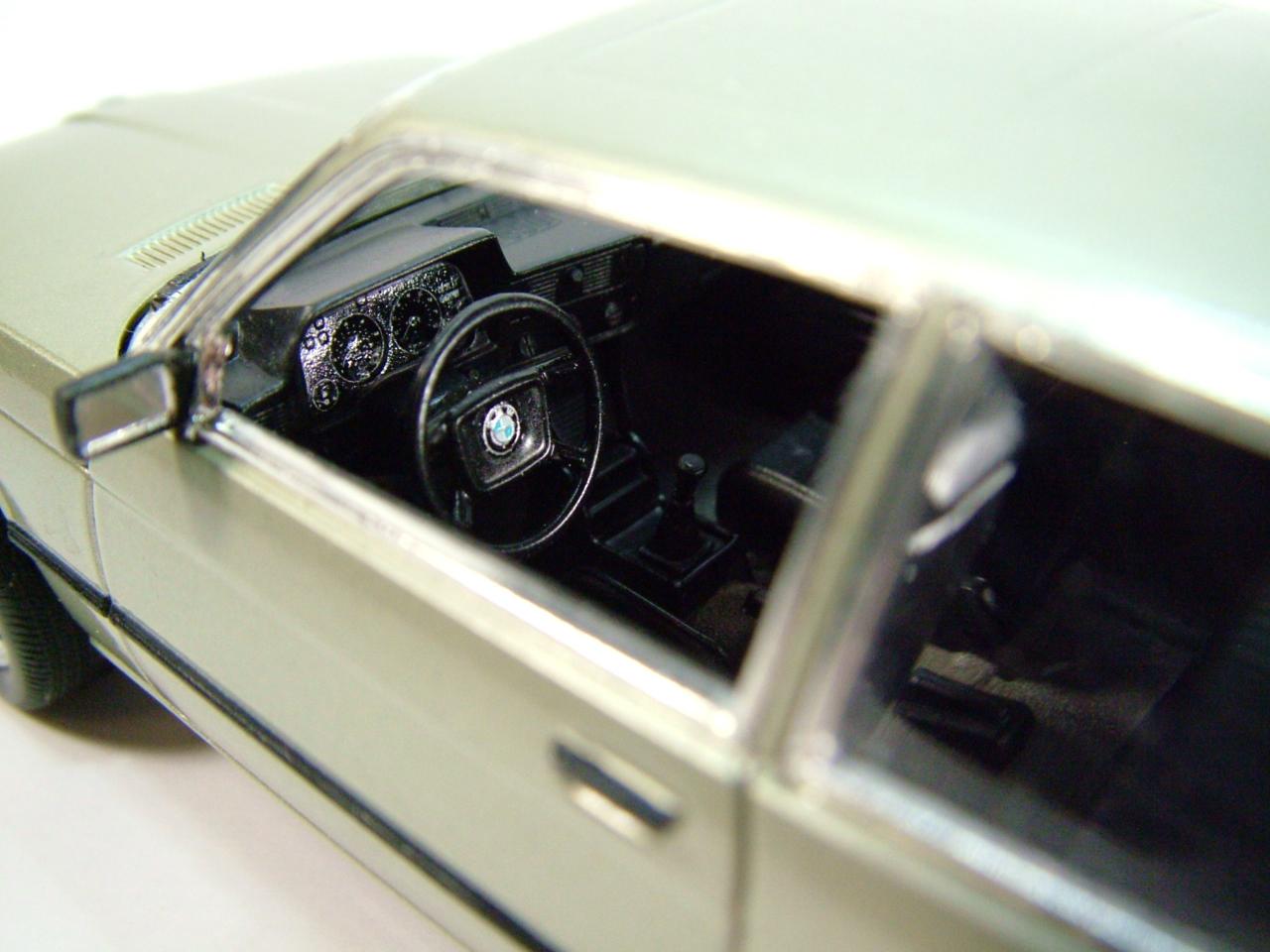

  10. Soooo, there are many flaws and I've learned a lot, mostly from here. The color is the original Reseda Green like the 320i that I owned; many problems with trying to spray urethane automotive finish and clear coat. The front grill is a Molotow pen (painted with a brush). The other chrome is BMF. I tried the Molotow pen on some ruined bodies, but think the BMF looks better on chrome trim. I butchered the rear end; too much build-up of the urethane clear ruined the black center trim. I used extra fine embossing powder for the carpet in a color called watering can. You can't see that in the photos. All comments are appreciated (yes, the brutally honest ones too) My next model is a Cobra, just started the body. I think this one will look a little better, but I'm really just a beginner. Dave

  14. Those seat panels in my 320i were cloth with vinyl outsides. I'm hoping to discover a way to match the appearance of cloth seats on a model. Anyone? Bueller? . . . Bueller?
  15. No pics yet, still working on it. The carpet in my 320i was gray. I just found some gray embossing powder. So I'm going to try that on a tub from another one of the 320i models I have. I agree, the carpet here looks awfully bright (gawdy).

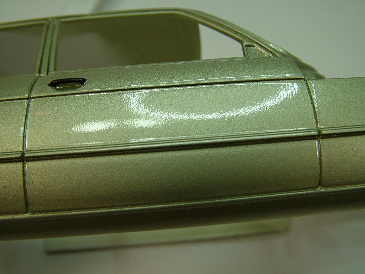

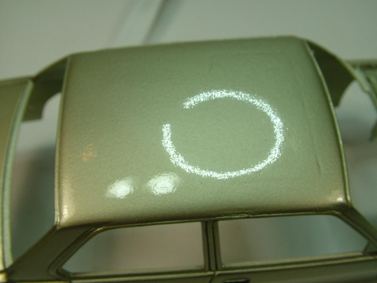

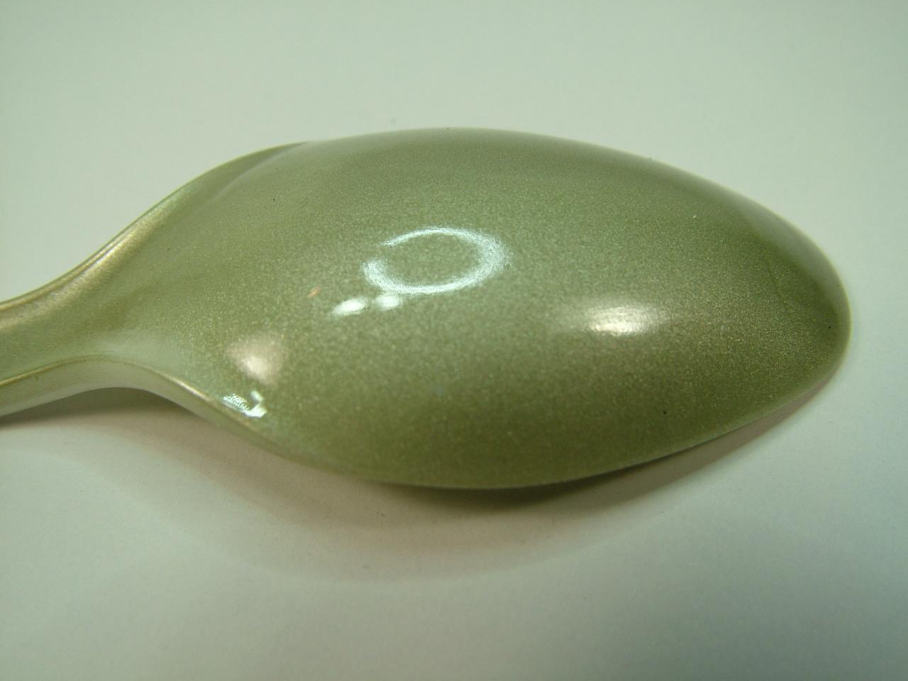

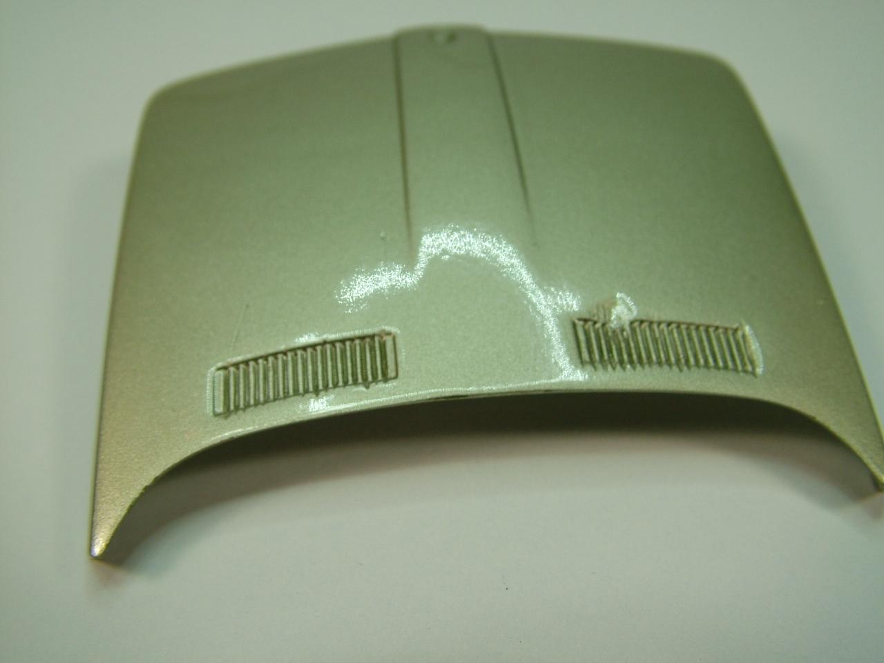

  20. This is my first model, trying to replicate a 320i I owned. I primed with Testors white primer and sanded. The paint is from Express Paints and is an automotive urethane with a clear coat from the same company. I saw the orange peel after the second color coat, but the directions said not to sand before clear coat. The roof has more primer after I tried (and failed) to fill the sunroof. The orange peel seems to be all on the color coat and not in the clear coat. The side view has less primer and less orange peel. I didn't sand the engine compartment at all that that seems to have no orange peel. I shot it with a Paasche H @‌ 35 lb. The paint was decanted from a spray can and was not thinned. From what I've read, orange peel forms when the paint dries before it has had time to level out. The spoon wasn't primed at all, just lightly sanded before painting, and clear coating and has no orange peel. This body is a "throw away" after I screwed up the panel lines and the hood. I have three more. Is it possible that multiple coats of primer are drying the color coat too fast? I'm going to spray more spoons with different coats of primer and possibly lowering the pressure. Any thoughts? What would happen if I sprayed the body without primer? Thanks Dave
