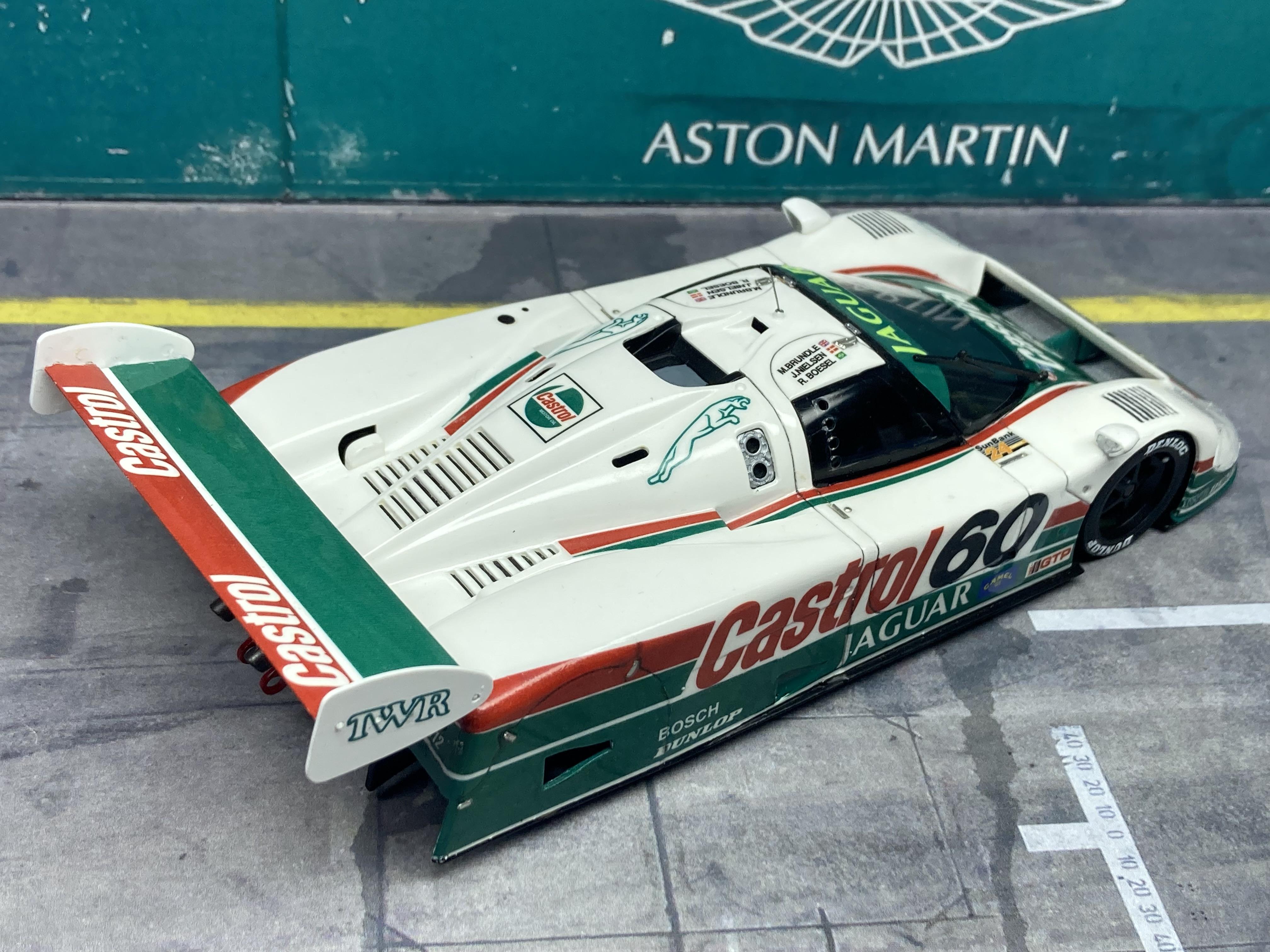

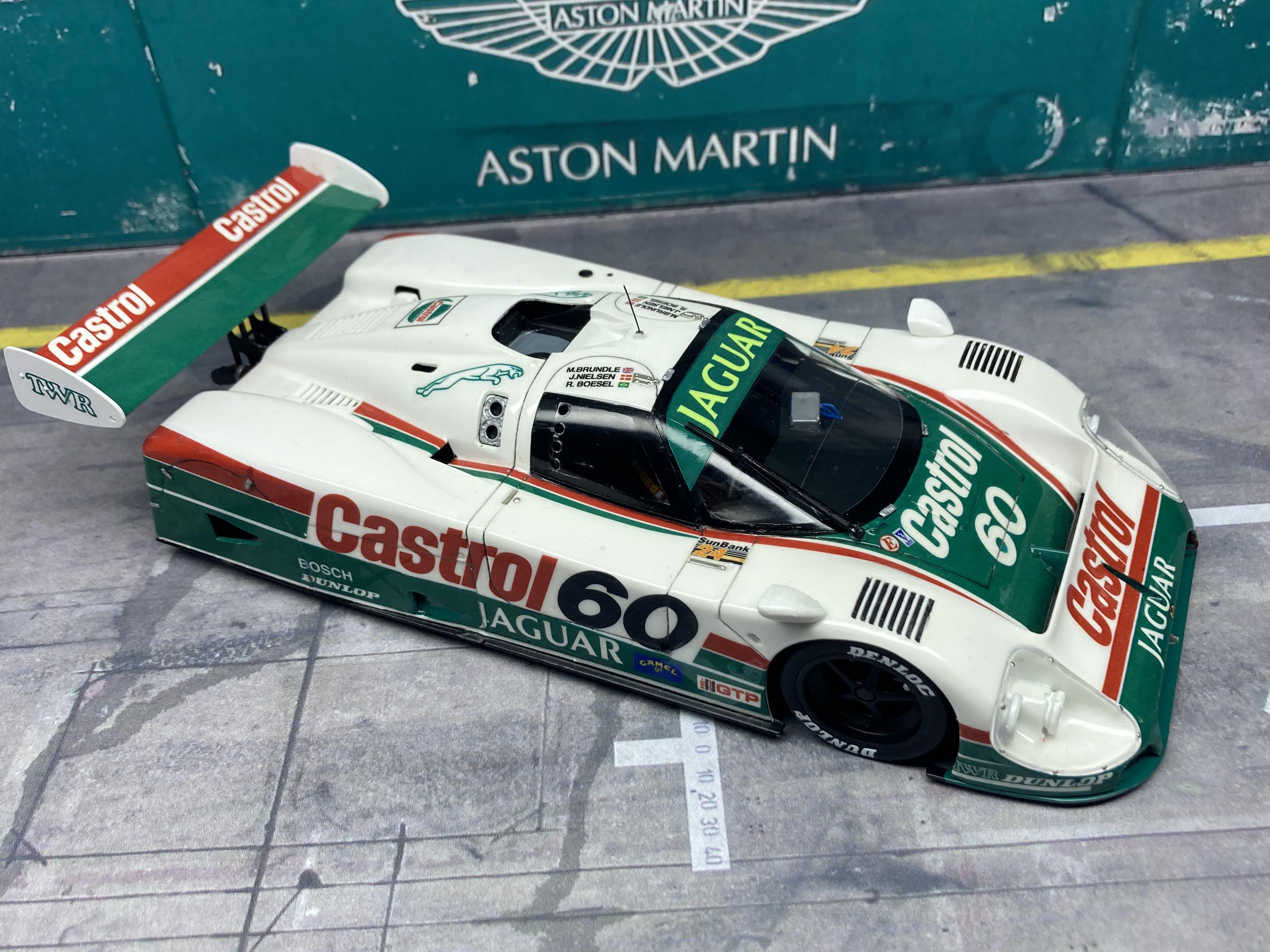

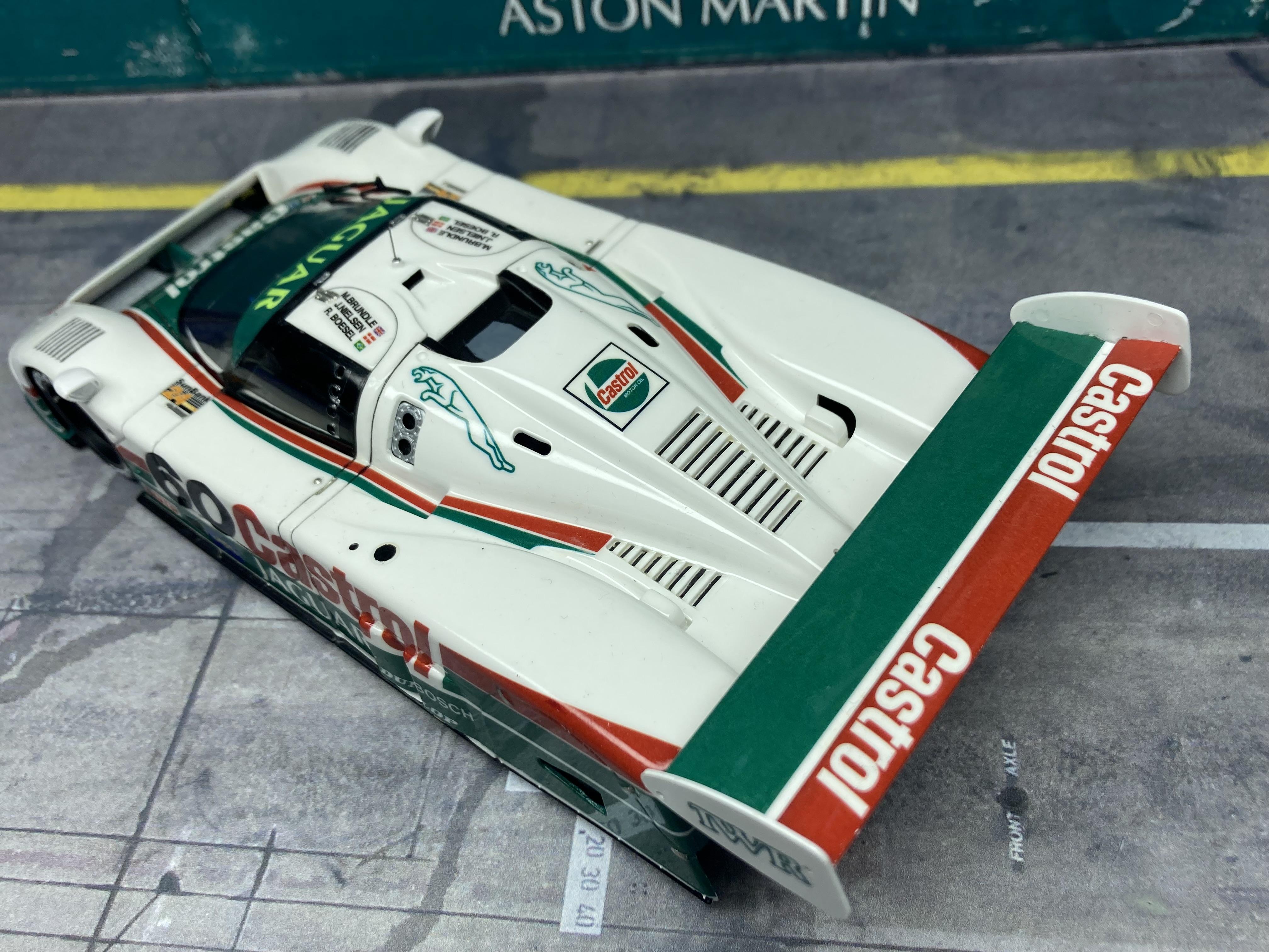

Hi there, here is my take on this old kit. Had a lot of problems using the kit's olds decals. The substitutes from Le Mans Decals did not work because they were way out of scale. I complained about all of this already in Rich's thread, so here we go with the images.
