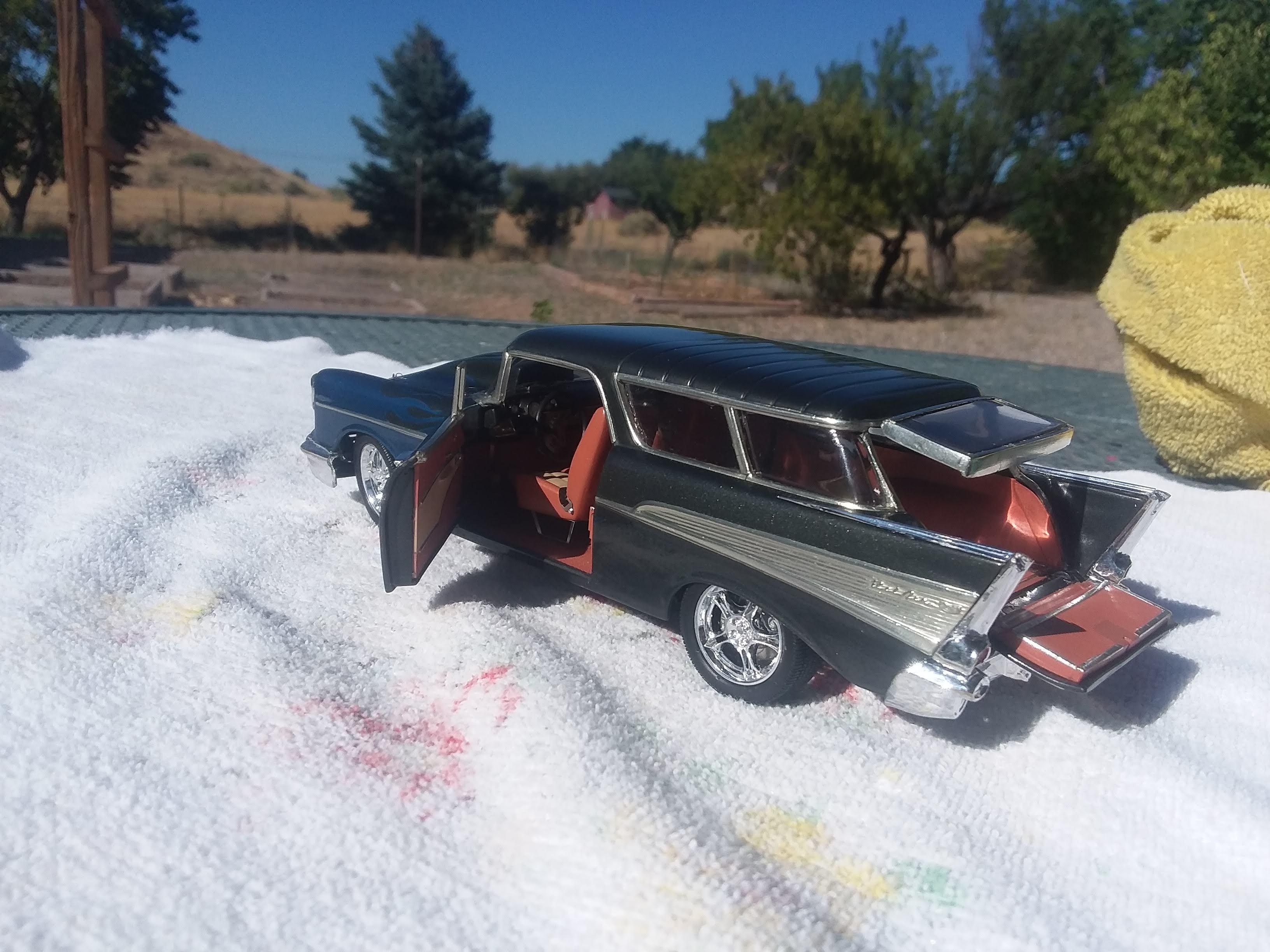

  8. Well, I got busy with other things as happens when it gets warm then forgot about the nomad till a few weeks ago. Was bothering me that I had a box with an almost built car. One of the reasons I walked away for a bit is that I got a bit frustrated with re-chroming some of the bigger parts. The alclad base coat just wouldn't cure and even a year later was still tacky. Either I got a bad batch of the base coat or I did something wrong. So I went back to ebay to see if I could find a parts kit with chrome in good/decent condition and eventually found what I wanted. When I got the parts kit the chrome still had issues but not nearly as bad as what was in my original kit. Masking and painting flames was a bad idea. Very difficult to smooth out the ridges and if one looks closely you can still see them in the finished product. Next time it's decals. Lastly I learned that foil gets dull if you gloss coat over it. Usually it's the last thing I put down but I also have issues with the foil lifting over time from handling so I thought I'd use the gloss to help keep it in place especially given the large amount of chrome trim unlike every other build I've done since I was a teenager. Anyways here is the final product. Pardon the dust but it's near impossible to get it all off for pics... believe me I tried.

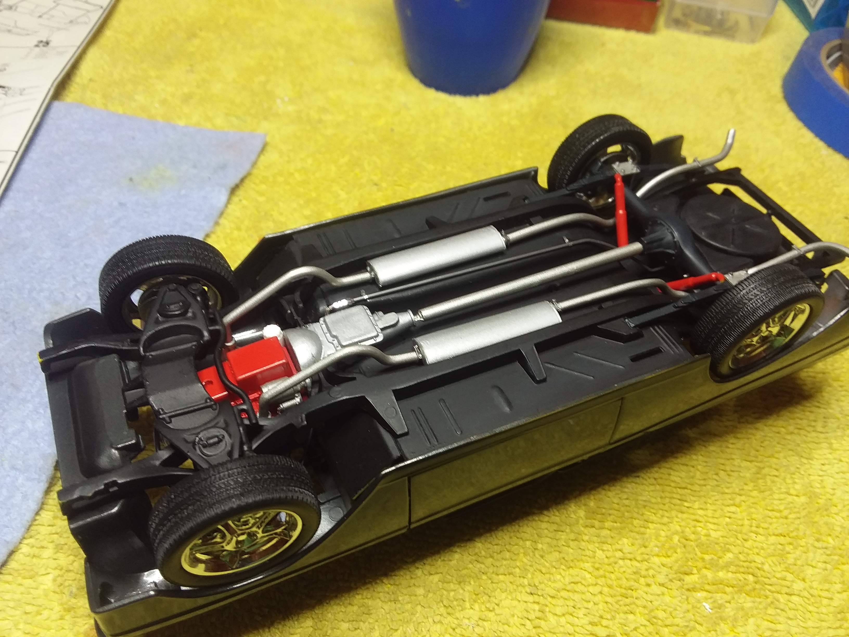

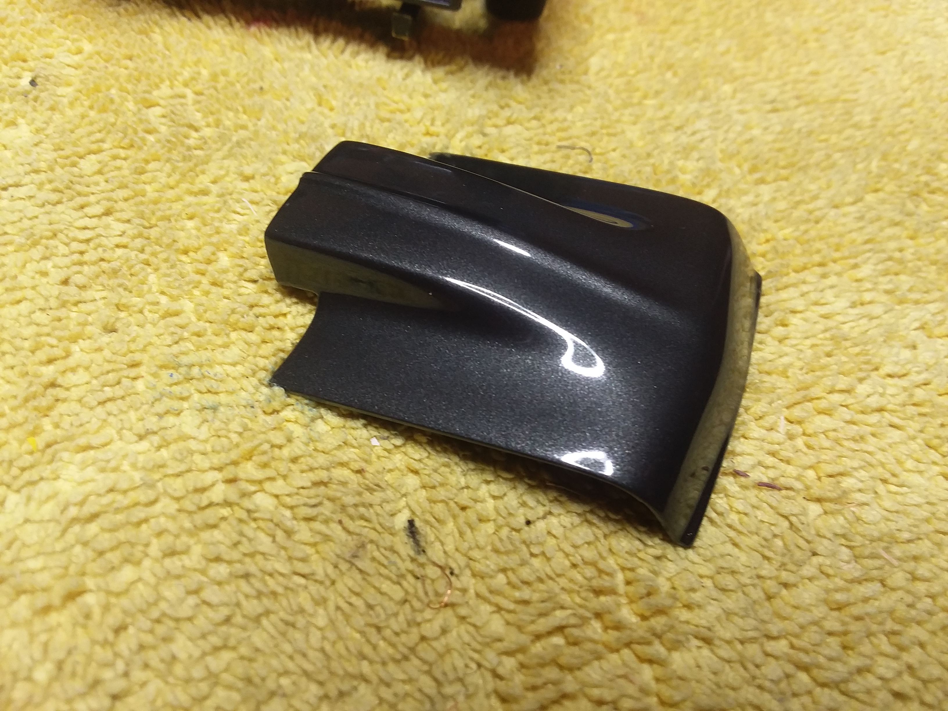

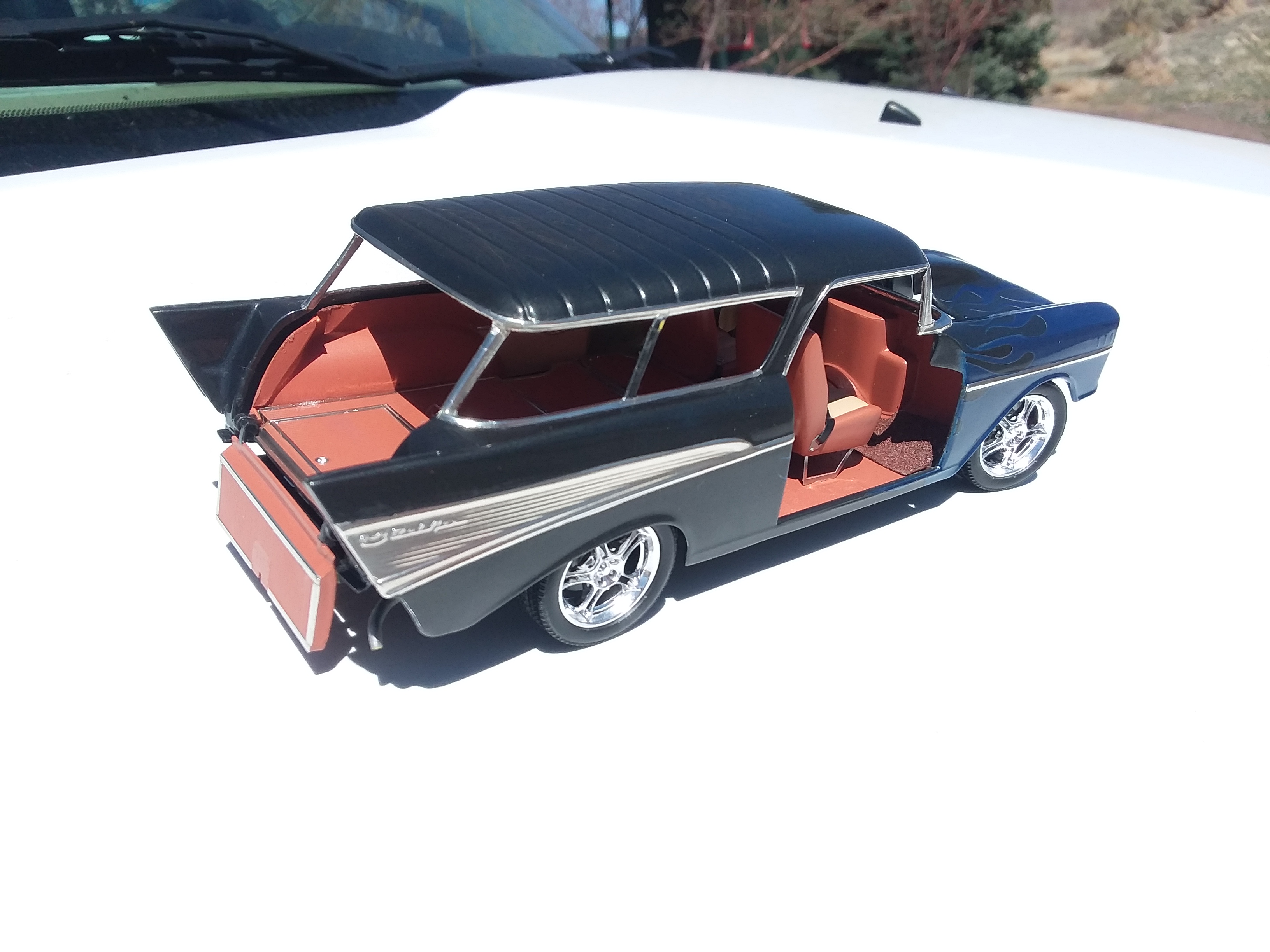

  13. A little more work done. Underside is pretty much done. I took liberties with the fuel line since it's a custom build. Final base coat on the hood. Two weeks it and the body should be ready for the flames. Wrapped up the shifter and found a better brake pedal from my leftover metal etched parts. Experimented with foil on the tailgate and super pleased with the result. The only downside is the nomad emblem like a lot of the other emblems wasn't molded well. I wish someone made metal transfers... google search proved fruitless for me. I can save the V but the nomad part may be more effort than it's worth. So now on to painting the seat insets, and fabbing up some floor mats.

  15. Beautiful work. Pagani's have been one of my favorite cars since the zonda.

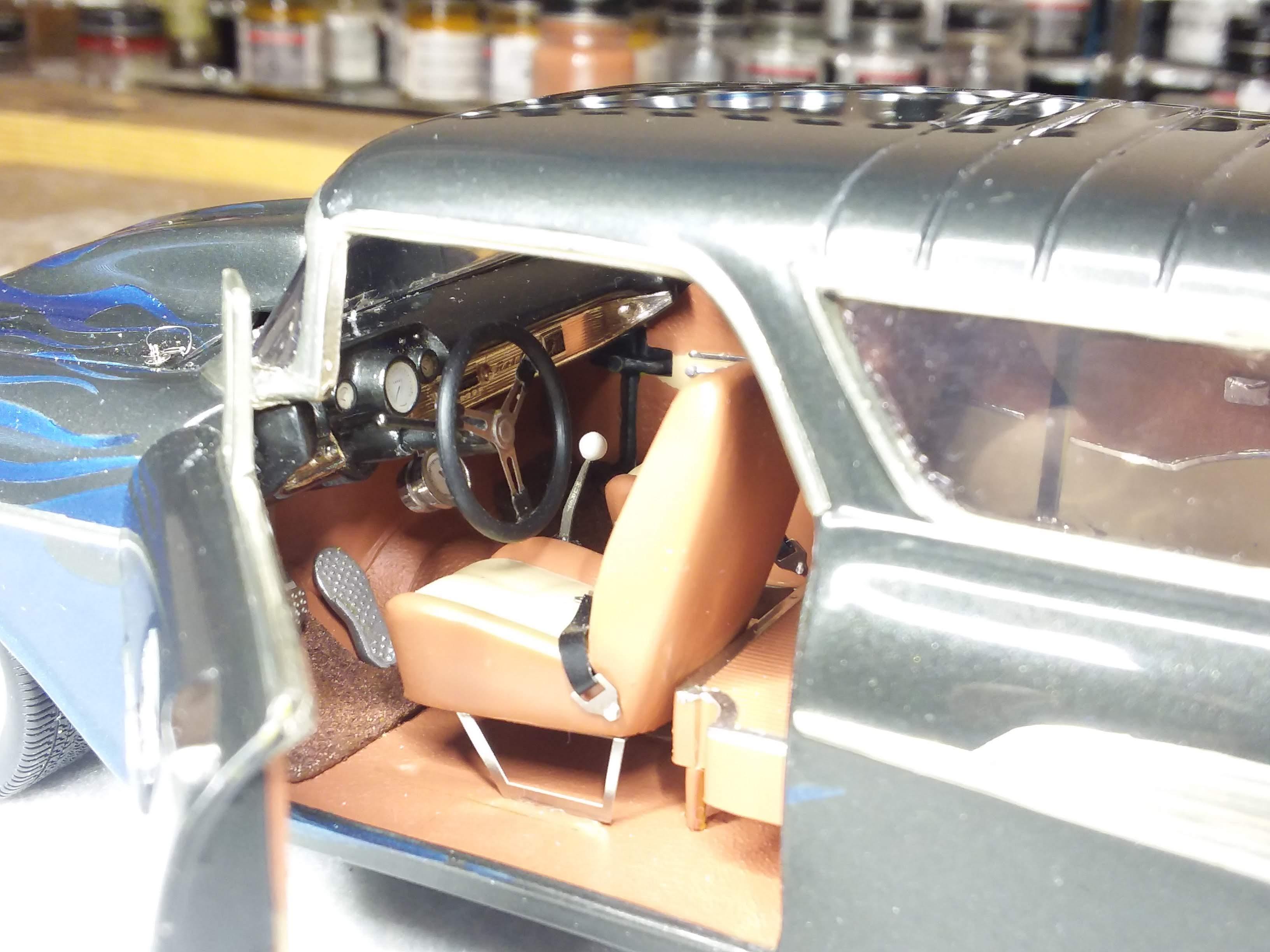

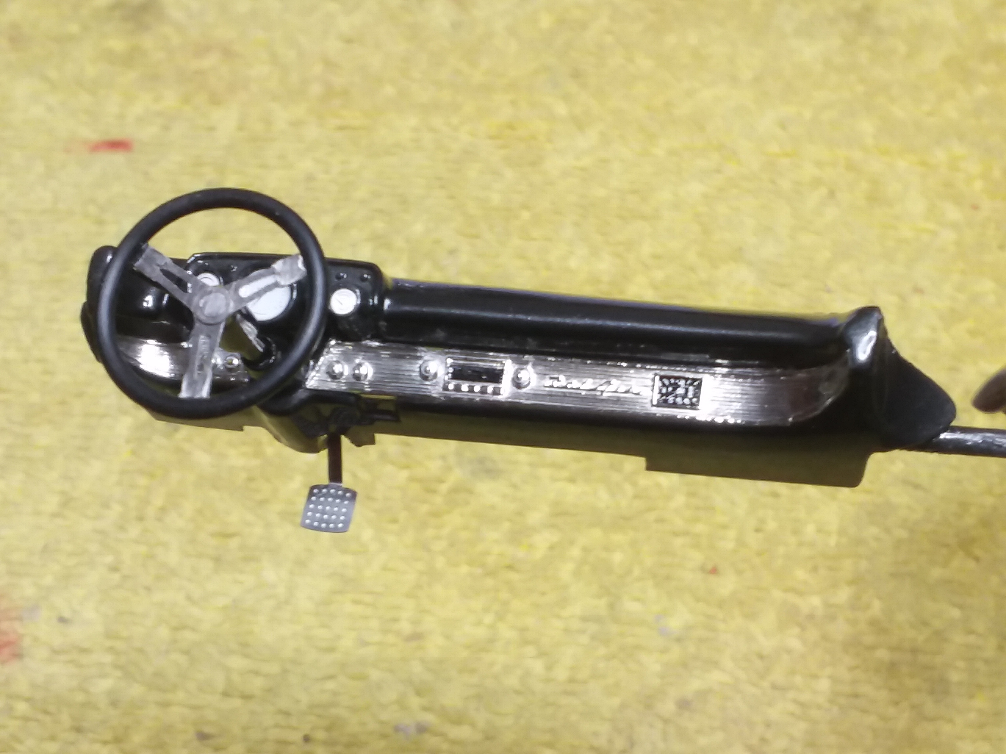

  18. Some more progress. The dash required a bit of work. Was hoping to use the one that came with the 57 couple but it was too wide to work with the functional doors on this model so I built up the thin spots/holes around the gauges with epoxy and fortunately the natural surface tension of the uncured epoxy almost did a perfect job filling in the holes and keeping the contour. I had to drill out the fuel and temp gauges then shape a plastic dowel to go in the holes then applied decals. Was hoping to show a mounted tach but as I was working on the mount from a detail masters kit I walked away while almost done and when I came back the tiny little bugger was not where I remembered placing it. Somewhere in the carpet now I'm sure so moved on to other things. Got the body base coat painted and applied foil to the trim pieces in the interior. Found the perfect bucket seat mounts from leftover parts of a revell 250 gto detail kit. Woo hoo! Then I needed a boot to go around the detail masters hurst shifter kit so I scratch built one by layering gradually smaller and beveled rectangles from a .030" inch styrene sheet. Engine almost ready for install. Dash temporarily glued into place with canopy glue normally used for RC airplanes but works great for glueing windows on models. I'm going to have to swap out the brake pedal with another I have that has a longer arm to get it lower and more to the left as this one sits almost over the gas pedal. These are the wheels that came with the newer revell california 57 chevy.

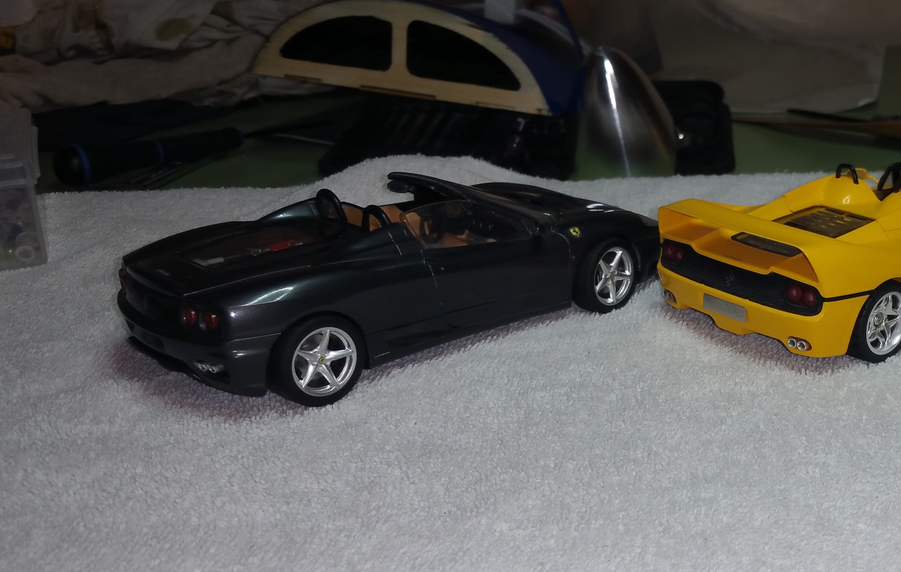

  19. Weather warmed up just right for shooting paint so that is what I did this weekend. Primer on the body showed up a few flaws so I need to do a little work there and hopefully be ready to shoot the body color next weekend. I still need to paint the interior panel insets once the brown dries. Thinking a light tan should work and planning on doing the insets on the bucket seats (pulled from a 68 camaro) the same. I also stripped the original chrome and re-shot with molotow chrome. Looks more like polished aluminum but I'm good with that so I'll keep it. Final base body color will be graphite metallic like I used on my Ferrari 360 spyder.

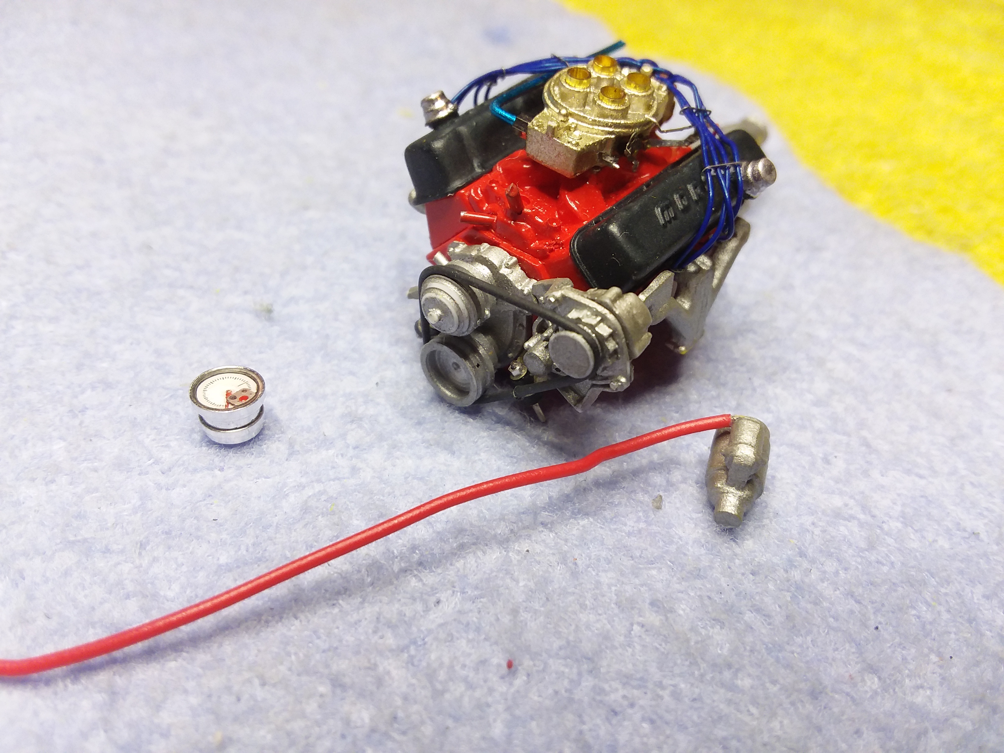

  21. Cold miserable weekend so a good time to dig into the build. I built the leaf springs for the rear using evergreen styrene strips .030 x .080 for the bottom two and .020 x .080 for the top two. Used some parts trees from a detail masters metal etched distributor kit for the baling. Ordered a 400 CI small block from BNL resins and am getting that ready for paint. Used some canopy glue to temporarily join the transmission to the block so I could test the fit in the car and it looks like it will work well. Did some detailing on the carb as well using the detail masters carb linkage kit and the fuel line kit that BNL also supplies.
