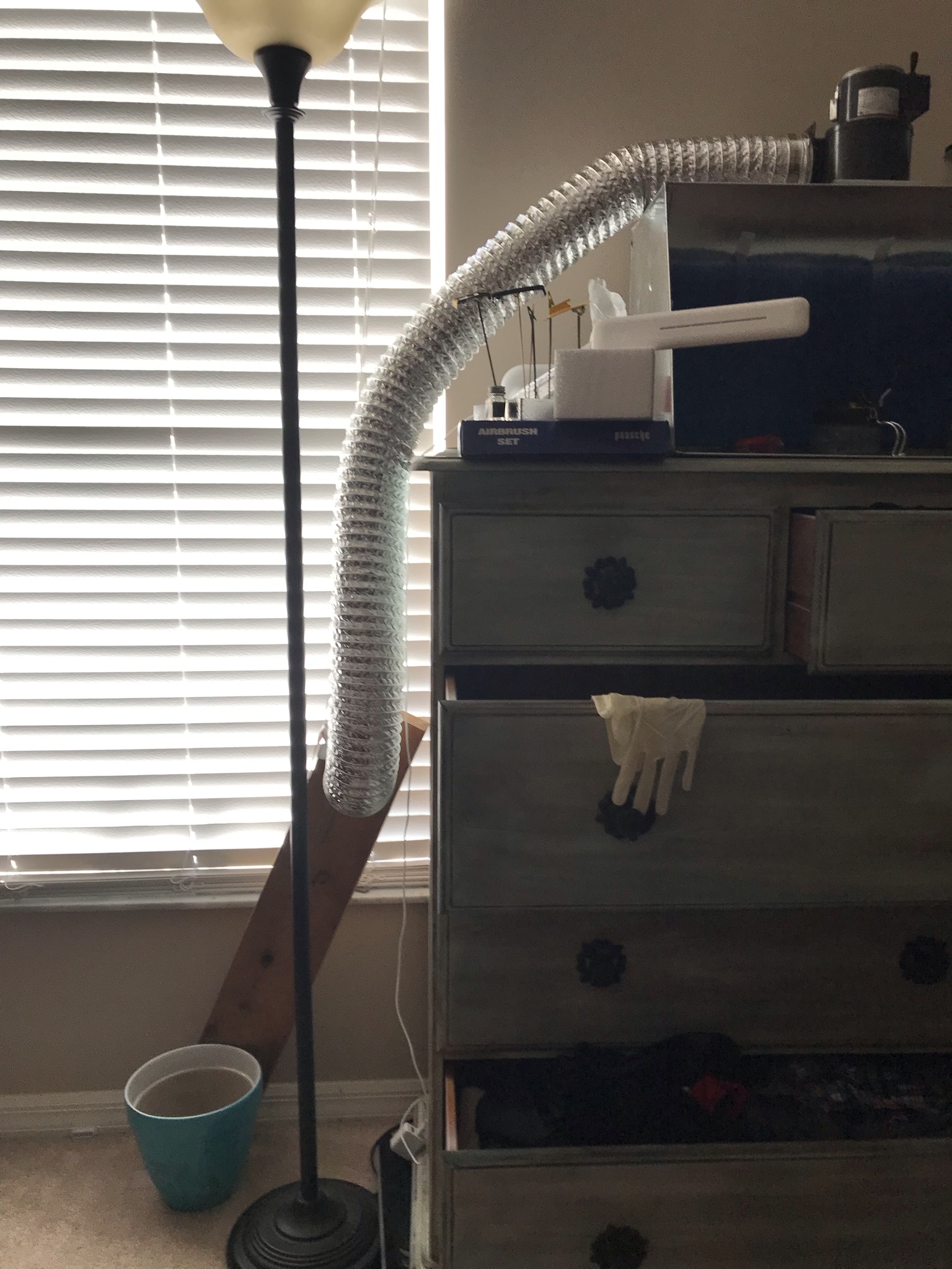

  21. I used my new Mini-Plus for the first time last week and it didn't have good airflow. I'm using the foil flexible duct (see picture below). I stretched it as tight as possible and cut off the excess and it improved a little but it is still not that great. When I took the duct off completely to test it had great airflow. If I got straight aluminum duct with two 90 degree elbows to get out my window would that help enough to be worth it? Because of the way I'm setup I have to go across to the left, down and then out the window. My window setup is through a 2x8 that I only set in the window when I need to use the booth. Also, there is not a lot of depth to the booth so it is easy to bump a car body on the filter in the back. If I had great airflow I could probably pull back outside the booth a little and let it suck in but as it is now it doesn't suck the overspray into the booth if I am not right up against the filter. The body was painted with the nose and rear in different pieces. If it was all one body it would have really been a challenge.
